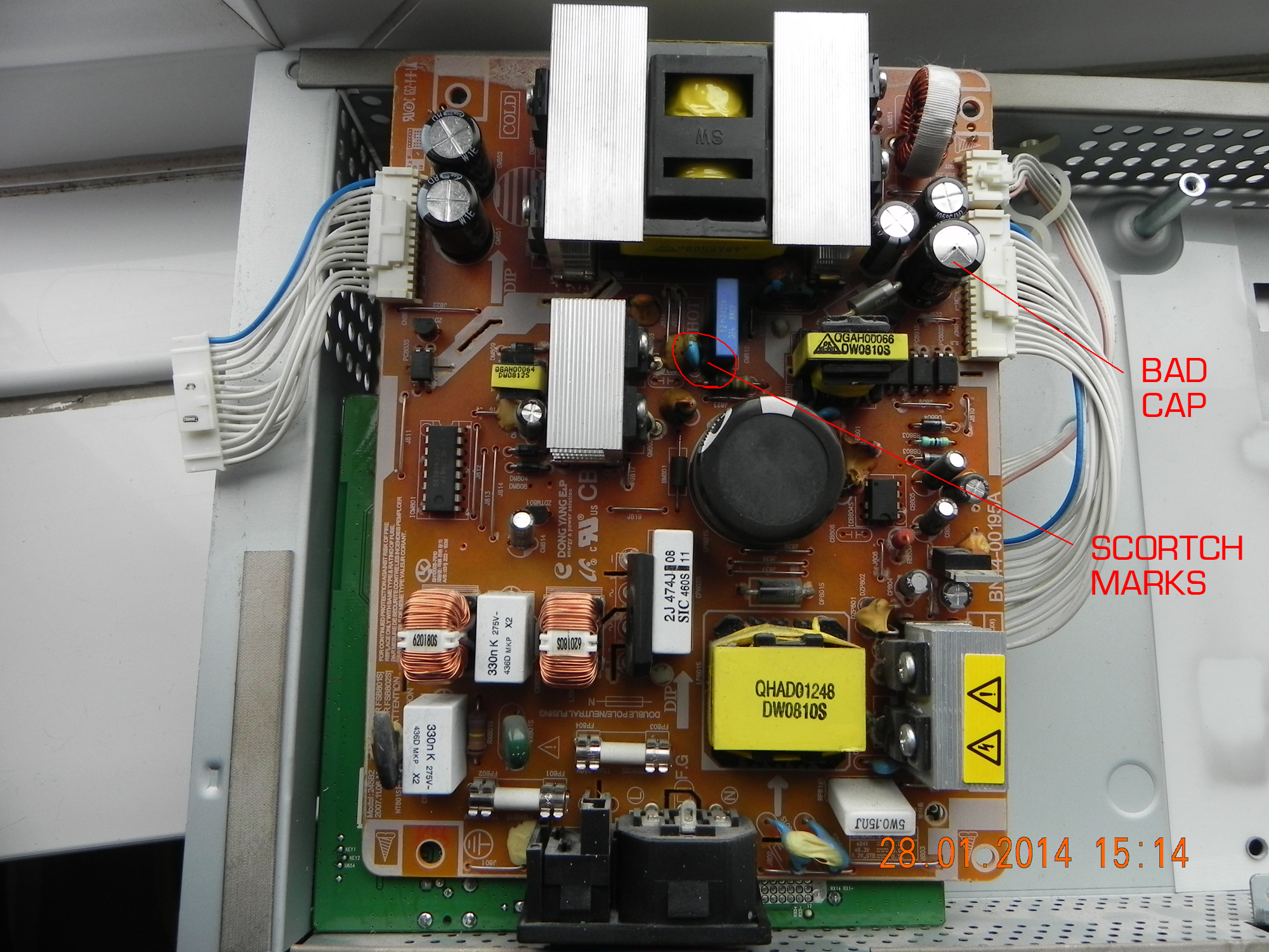

              Hi everyone, I found these forums and this post after my 245b went.
              I had sparks popping and a little smoke, taking it apart there was scorch marks on the power supply and on the plastic cover on the back
              looks like a capacitor is/has going/gone and the main short seemed to be from a resistor just below the 'hot' text
              unfortunately I am no good at soldering nor do I know anyone who is so replacing the caps etc (even is this is the main issue and is fixable this way) is not an option.
              From what I have read the glue can cause the short however I was wondering if anything else could of caused the short? my surge protector the monitor is plugged into is fine.
              The reason I ask is I am planing to get a replacement PSU for it, however I don't want to go waste £50 ~ £90 if it could be another component in the monitor that caused the issue in the first place, and thus would/could cause a replacement to blow too.
                Re: Samsung Syncmaster 245BW
                That blue cap is the snubber cap in the 400V circuit section, you can remove all the glue and inspect the components (MOSFETs, Diode, resistors) to see if they are shorted or the legs are corroded by the glue.

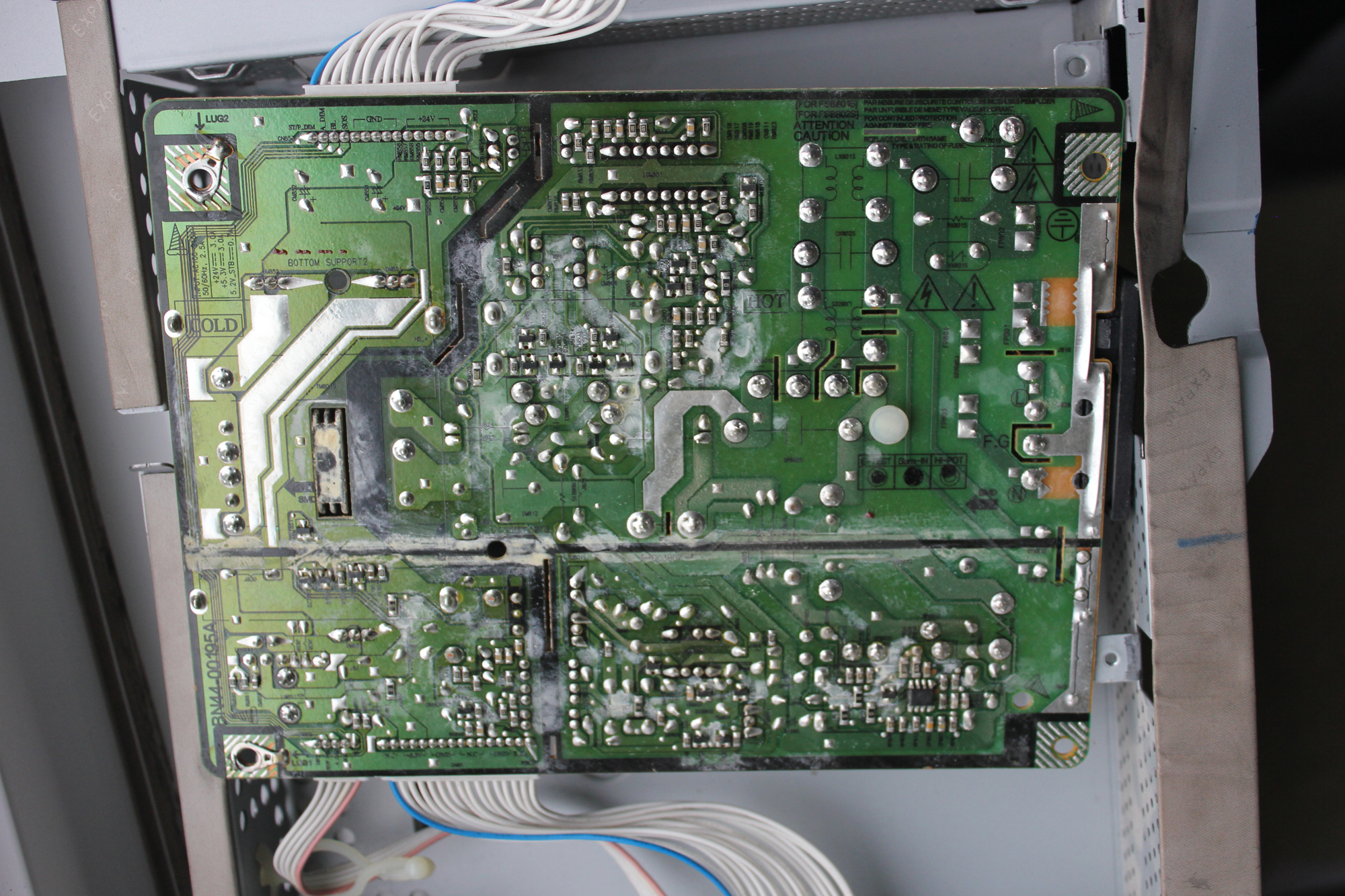

                        With regards to the issue above I posted, I have done some work towards fixing the monitor, I originally said that I would just get a new board however I thought whats the most I could lose from trying, so following budm's advice I removed all the glue from that area and the small blue capacitor's leg was terribly corroded and just came off with the glue, there was just enough left on the capacitor itself to re-solder it on so I attempted it and thankfully was a fairly clean area to work with, not much else around, so done a pretty good job of re-soldering it on, replaced the fuse and hooked everything back up.
                        Its now working better than before (possibly just because I replaced the fuse)
                        The blue power light now stays solid if there is a video cable attached or not
                        I have not removed any more glue as some of the components do look like they are on their last legs and attempting to remove the glue looks like it would easily pull of the resisters/capacitors and as the scorch marks are located in a different area I took the chance that the rest of the board might be fine, same with the bulging capacitor, as I can't get any locally and would take a few days to get some thats still there too.
                        With the pictures above and the new update of the situation has anyone got any idea where to start, also anyone got a list of the resistors needed/used with glue over half of them I can't tell and because of my lack of confidence to solder I want to avoid as much soldering as possible :P
                        Thanks in advanced and thanks budm for your reply.
                          You are probably just wasting your time if you dont remove ALL the glue - it is corrosive and conductive. You need to replace the bulging caps as soon as possible as they can cause collateral damage which is a lot more difficult and expensive to fix. You also need a good base to start testing.
                          Currently cpc have fee next day delivery for internet orders - caps should be Panasonic
                          FR FM or FC - check they will physically fit. We do not usually give lists of caps as the manufacturers make revisions to the boards and add or remove caps from time to time and also change the values.
                          Best way is to get a camera take a picture print it and write the values on the pic.
                          You also need to get these caps in the right way round

                              Check the capacitance of that blue rectangular cap right next to that small blue cap you circled, that is the common failure cap. Not removing all the glue will just cause more damages to the leads of the components and electrical leakage between circuits.
                                What is the best way to remove this glue? I used a small blade last time.
                                  Small blade - sharpened toothbrush handle- dental pick - lots and lots of patience.
                                  Glue may soften slightly with Isopropyl alcohol
