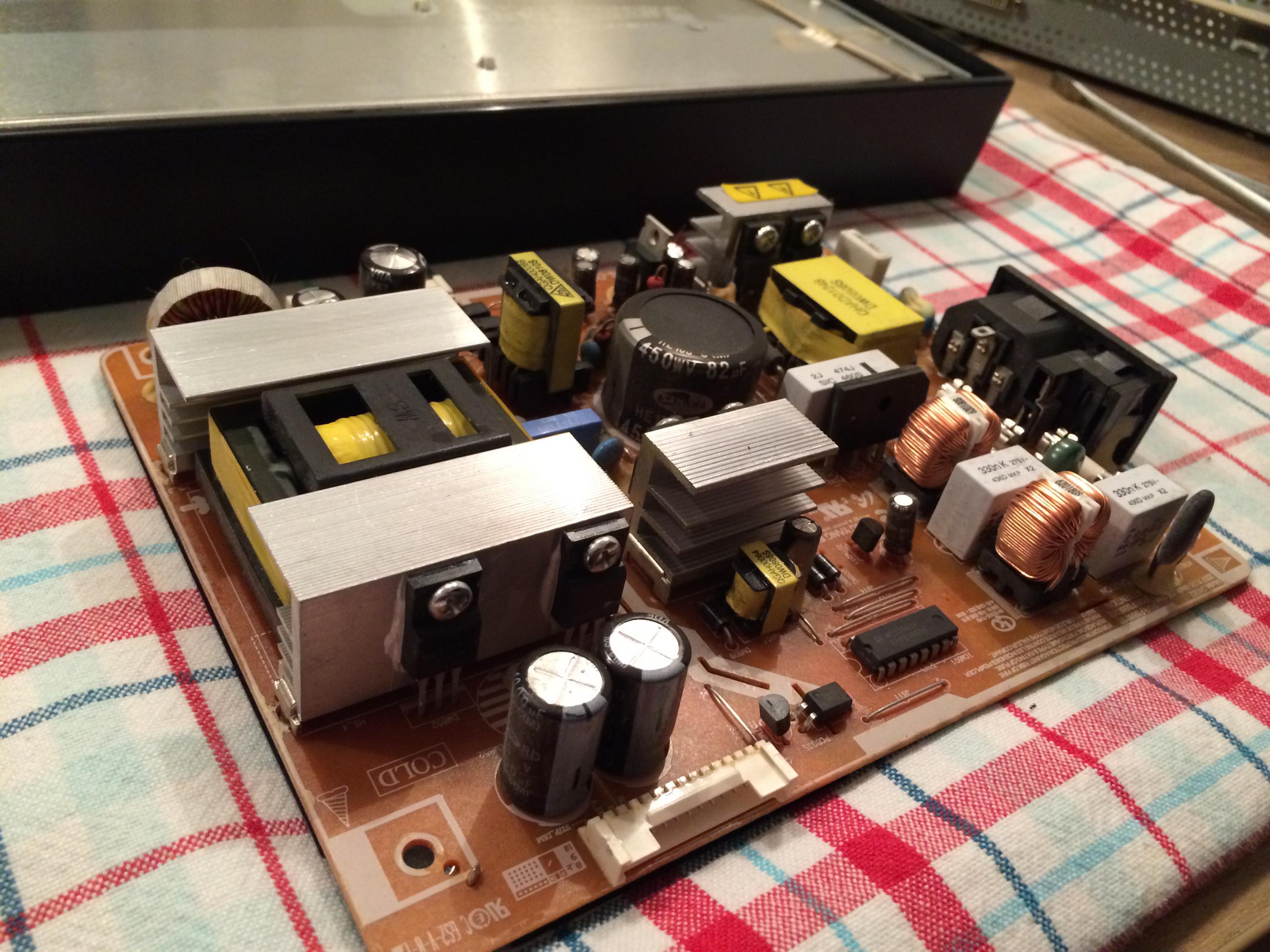

    Hello all,

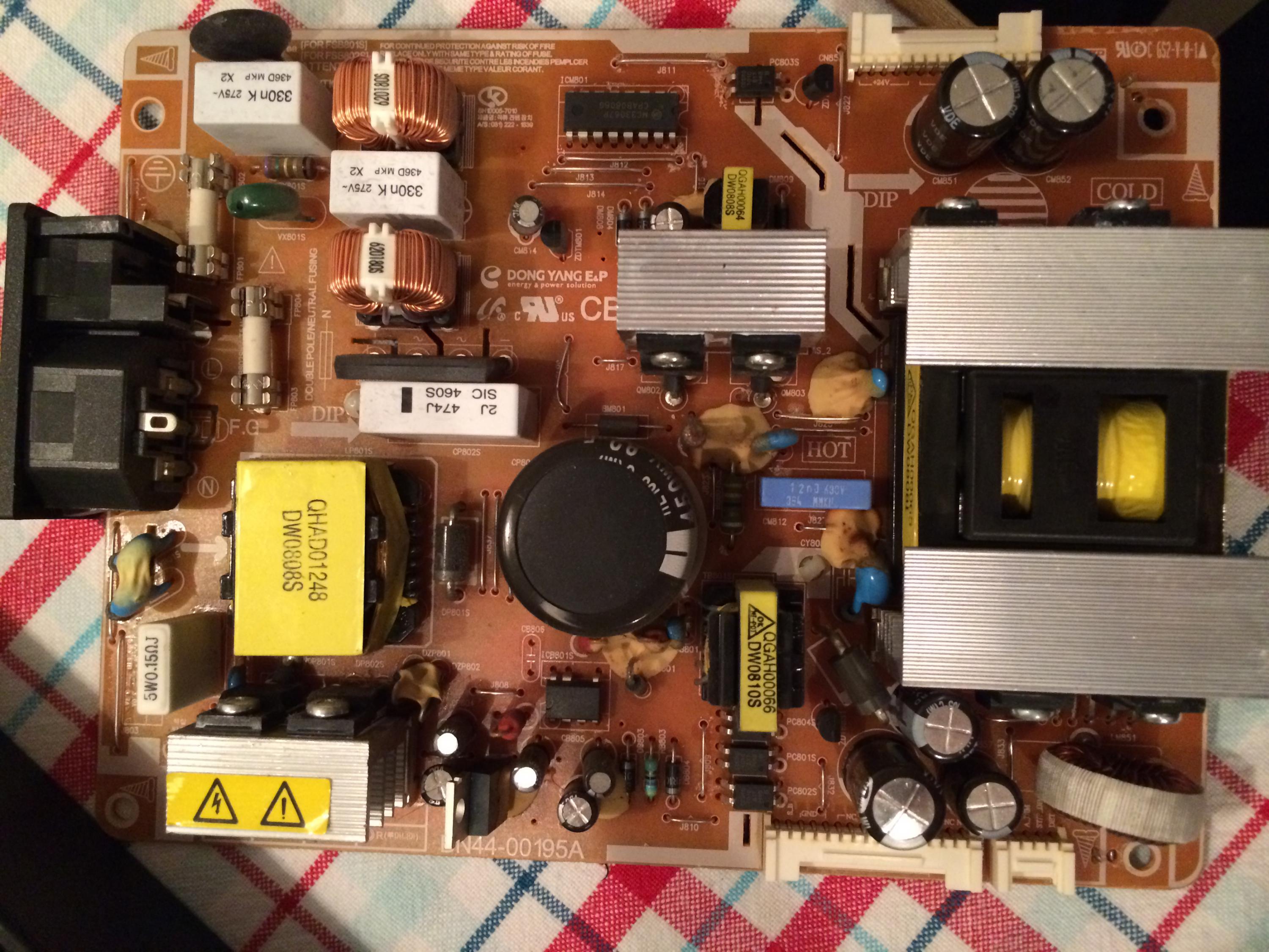

    Since a few weeks my screen turns black once in a while. The last few days it happens more often and it won't turn back on.. only sometimes when I wait long enough.
    I've opened the monitor, but I can't see to much wrong at first sight (I'm not an expert in this).
    Is there any chance someone else might know what's wrong or what I can try? I have attached some pictures.
    Thanks so much!

      Re: Samsung Syncmaster 245BW

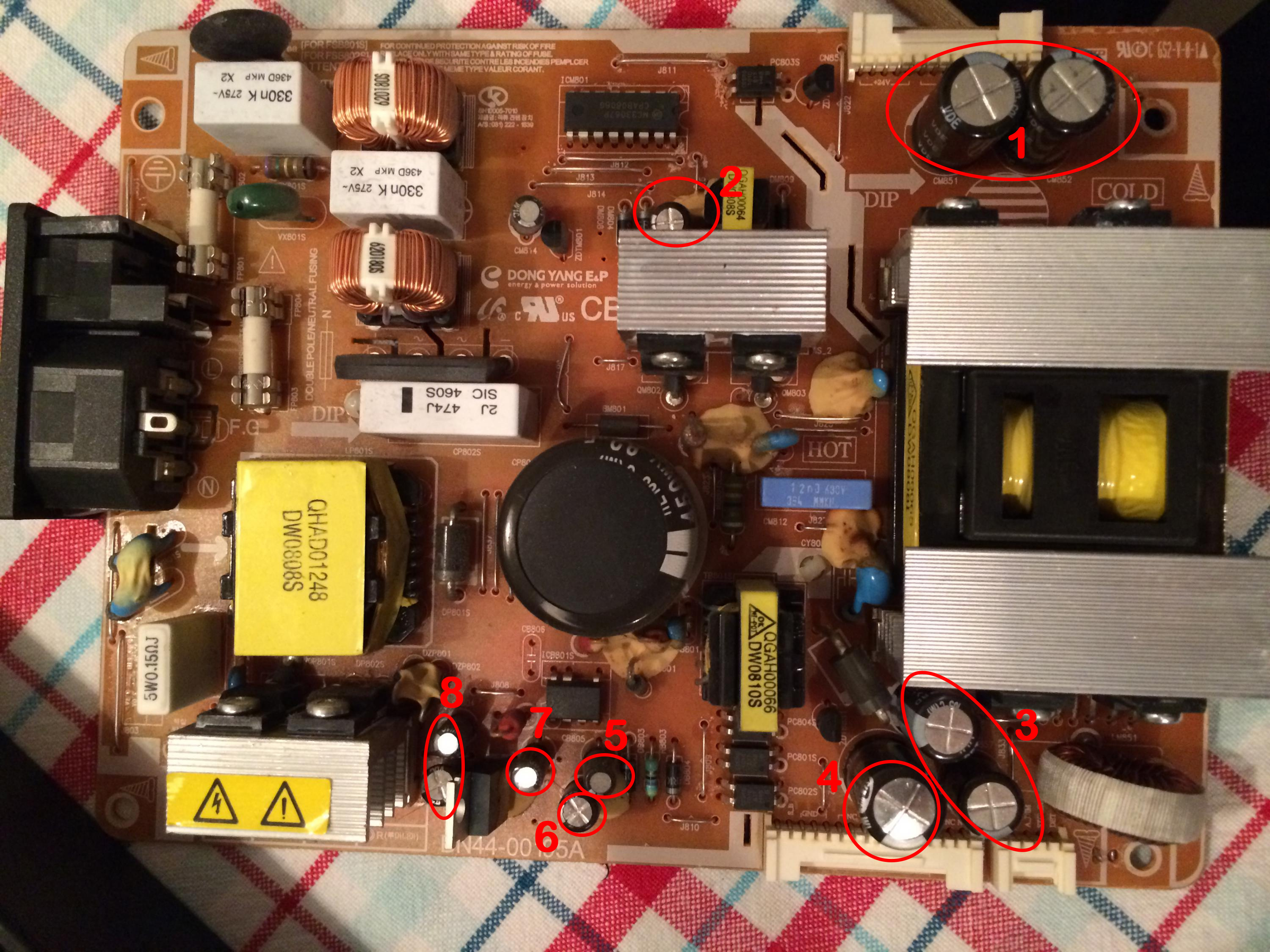

      "I can't see to much wrong at first sight "
      Have you not read the thread you have posted in???
      Your board is covered in the yellow/brown glue - first step is to remove it
      as it is corrosive and conductive.
      In Picture 2 you have a swollen cap so bearing in mind all the caps are in the same place and the same age it is prudent to change them all except perhaps the BIG Cap.

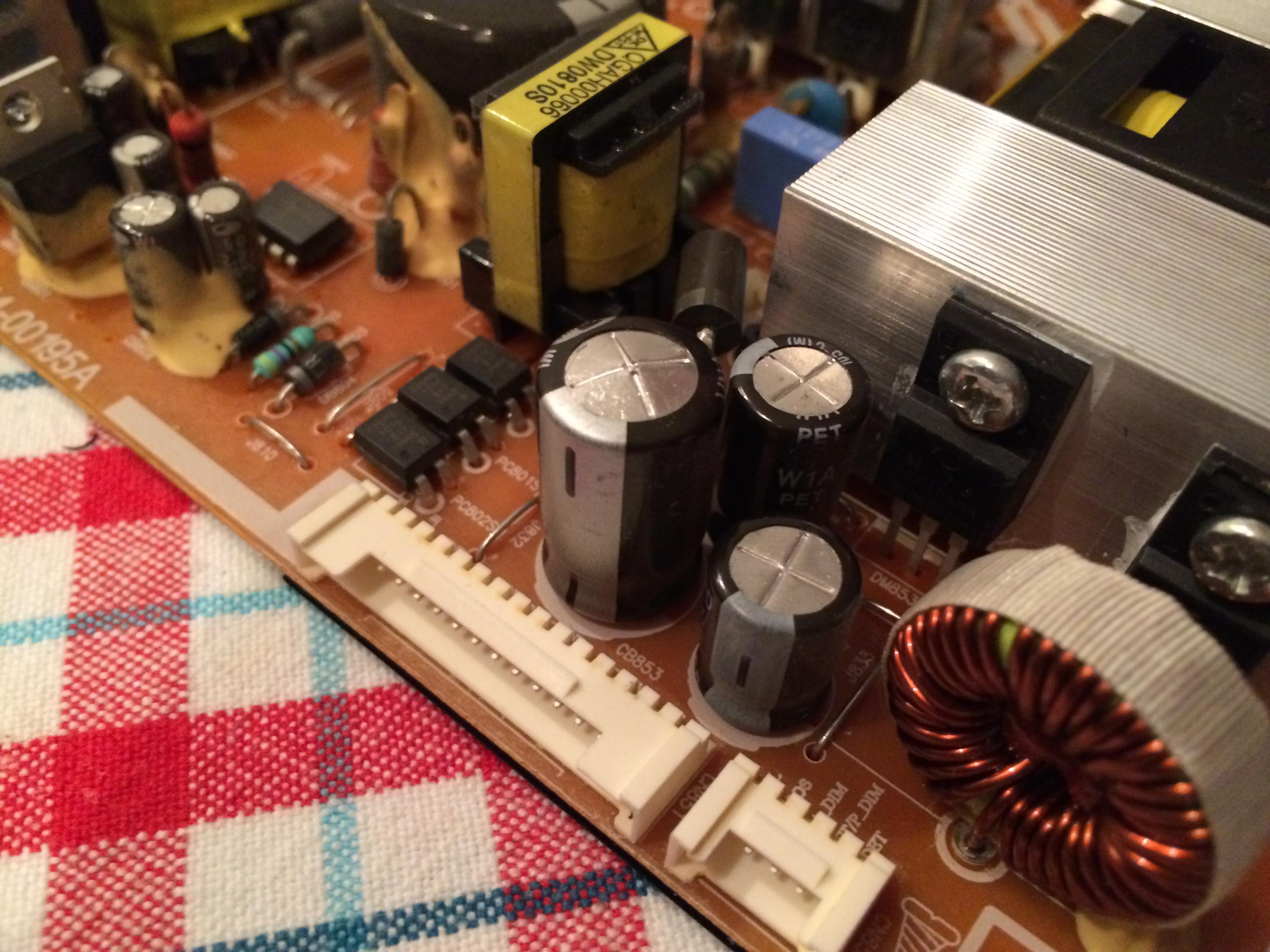

          I have eventually found the time to clean all the glue up and I also now have a multimeter and ordered another 2200uf capacitor to replace the circled capacitor in the picture.
          I have started testing some of the capacitors, the multimeter can only read up to 100uf so the larger caps are harder to test, however the 2200uf is returning 12uf
          I am just curios to know if you have to remove the caps and resistors from the board to get an accurate test or is measuring them from the soldered contacts underneath sufficient?
          My next question is with resistors, can they be partially gone, letting more current than they are designed to do but not completely open.
          Finally, with all the experience in this thread, any ideas what may be wrong? Could it be just the 2200uf cap?
          after replacing the 2 fuses, as stated in above post, the power light comes on and thats it, no picture or stand by mode.

                  ok, so that large cap came in the post a few hours ago, I have just replaced it, a bit of the metal ring that was on the hole for one of the legs had came away but half of it was still there, my soldering skills arent that great but its now held firmly in place.
                  what would be the next step? plug it in and test it or is it at this point worth while de-soldering resistors and testing them?
                  would testing at this point help to identify the cause? and thus order replacement parts with more capacitors.
                  also what capacitors would you suggest replacing, you said the big one should be ok and testing it showed the capacitance at 80uf-ish out of 82uf (it does have a bit of blackness that looks like it came from the same scorch marks of the picture, this may of been where some hot material had fallen as I did see a spark fall out of the bottom of the screen when it went)
                  one or two of the capacitors do show twice their stated capacitance when tested, this as you said could be related to the inaccuracy of the tester, or could this be a sign that they are going too? as I would of thought, if they where to go that they would get less capacitance.

                      #650
                      Hm.. actually it looks quite bad yeh
                      Anyway, thanks for your reply. I will try to clean the yellow/brown glue.
                      I'm still not really sure which caps I should replace, can you name the numbers (see attached picture - and some extras if needed) that need to be replaced?

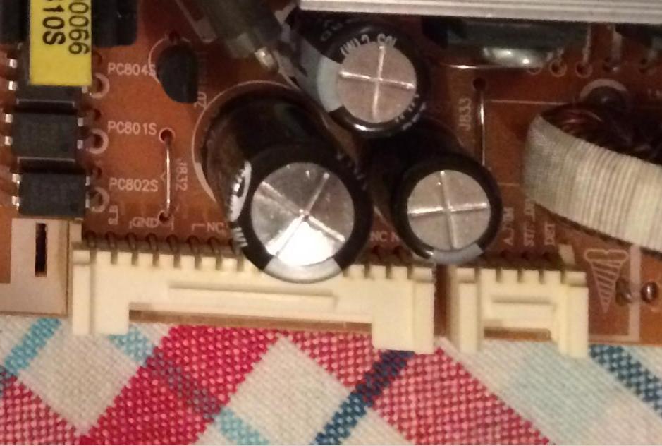

                        Badfor Cap no 4 is swollen (same one as SJones88 as it happens) A lot depends on whether you can easily buy good quality caps. Normally recommend for a power supply
                        like this Panasonic FR FM or FC you need to check the physical size and get the same
                        voltage and uf value. If you have to order by post - (perhaps Mouser or digikey or
                        RS components. but perhaps you have a more local dealer. ) then if you jsu buy the one cap the postage will be more than the cap. I would consider replacing 1,3 and 4
                        as a first choice then see how much more it would be for the smaller ones.
                        This is not an easy board to fix so cannot be sure that caps alone will fix it.
