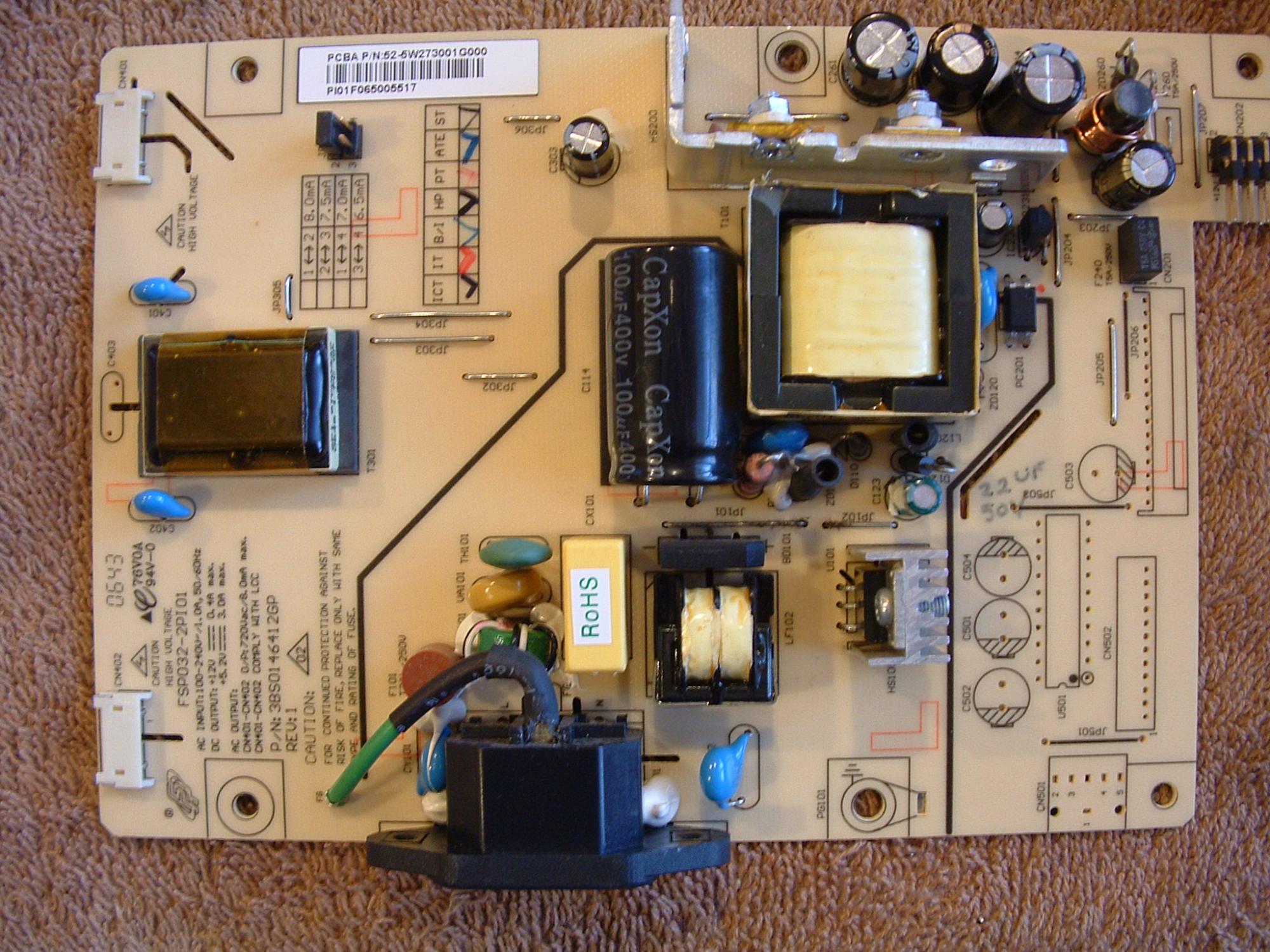

                            • alexanna
                              • Mar 2010
                              • 1346
                              #34
                              Re: HannsG HW173D dead. Recap = new fault.
                              Need a good pitcure of both top and bottom of Inv./P.S.
                              Whatever I do, I consider it a success, if in the end I am breathing, seeing, feeling and hearing!
                              • jetadm123
                                • 2169
                                #35
                                You have two diode packs mounted on the same heatsink. One diode should output 5V and the other 12V. Measure the middle leg of each diode for these voltages. Like alexanna suggested, we need some good focused photos of YOUR boards. Referencing someone else's board photos hinders the troubleshooting process.
                                • alexanna
                                  • Mar 2010
                                  • 1346
                                  #36
                                  In the first post I see a fuse F240 by the connector to the logic board,It would be a good idea to check it if it's not already been done.
                                  Well i mised you post about F240 you might want to check it with an ohmmeter
                                  Last edited by alexanna; 02-16-2011, 05:35 PM. Reason: Checking fuse with ohmmeter rather than diode test

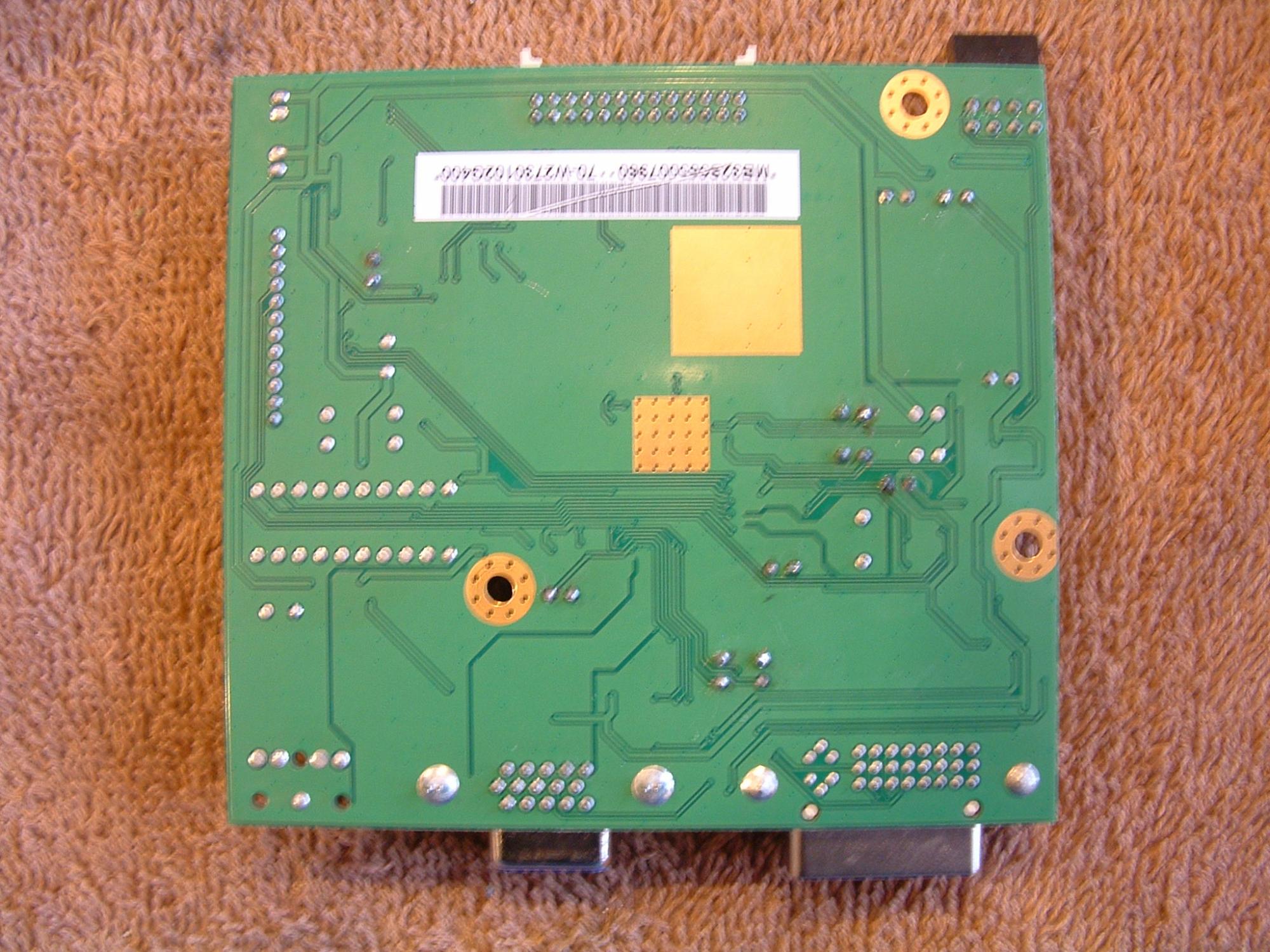

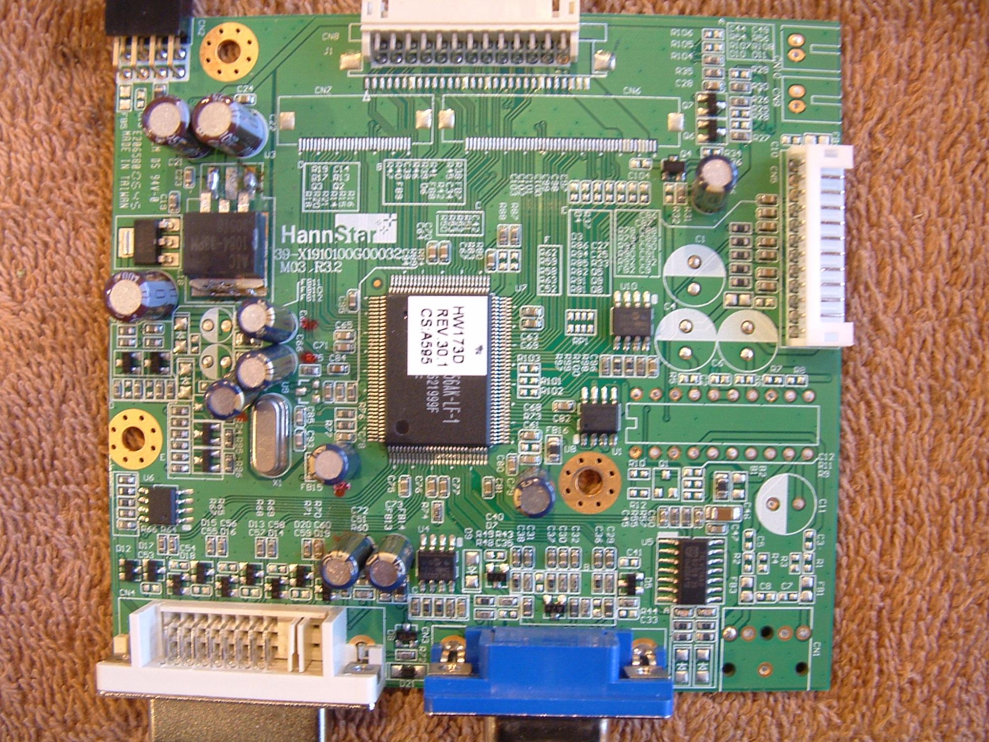

                                  • slvfox2008
                                    • Jan 2011
                                    • 28
                                    #37
                                    Attached are the pictures of my boards.
                                    I did check the continuity on both fuses and they check out.

                                      • jetadm123
                                        • 2169
                                        #39
                                        Originally posted by slvfox2008
                                        Are the diode's D240 & D260 and are we talking about 5DCV and 12 DCV? If so then I am getting a reading of 0V. Am I corrected by using the ground from the power cord?
                                        I just tried to use a different ground and got one diode to bounce between .4V and .6V and 0 on the 12V diode. When the voltage changes from AC to DC, does the ground change?
                                        I can't see the silkscreen on your photos for D240 and D260. On your third photo, they are the only two devices mounted on the same heatsink above the yellow transformer. You mentioned you read 5V on the connector on one of your previous posts. Well, that 5V should coming from one of those two diodes. Is your meter set to DC volts? Try the 20V setting. Place your ground probe on a mounting screw and place your red probe on the middle leg to measure output voltage.
