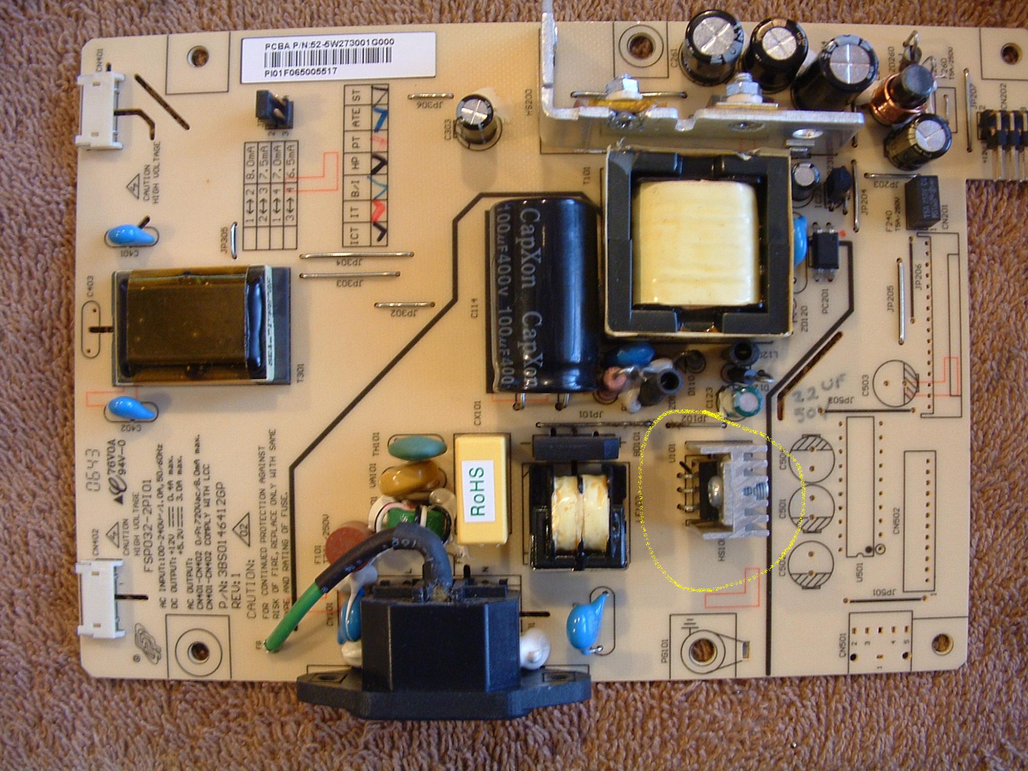

HannsG HW173D dead. Recap = new fault.

                #47
                Re: HannsG HW173D dead. Recap = new fault.
                1) Carefully measure the DC voltage across the largest capacitor (C114). It should be mains x 1.414. If you have 120V AC, then you should get 120 x 1.414 = roughly 165V DC.
                Careful, this is high voltage. Put your multimeter on 200V DC. Put your black probe on the negative leg of the capacitor and red probe on the positive leg.
