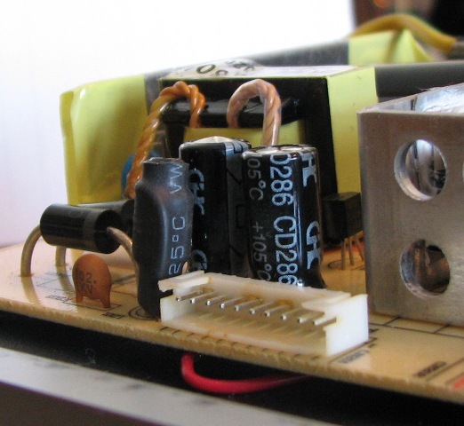

    When the power button is pressed, the power light will come on for about 2-3 seconds, then I hear a little audio pop and power goes off. Then, every 7 seconds or so, the power light will flash and I hear the audio pop again. Opened up the case and noticed I have one capacitor that is bulging. Could this be the issue? Any assistance for a rookie?

    <Cue the recording> Yes, that could be the problem. If one capacitor is visibly bad it is likely more are bad. It is recommended you replace ALL the capacitors except the very large one (typically 100 uF, 450 Volts). I recommend attaching pictures (top and bottom) of the power supply / inverter board. I personally recommend buying Panasonic FM series caps from Digikey, and taking advantage of their USPS First Class Mail shipping. If you are unsure of which caps to use, post a list, including Manufacturer, Series, Capacity, Voltage, diameter, and length for each cap and someone will reply with a list of recommended replacements. <End of recording>

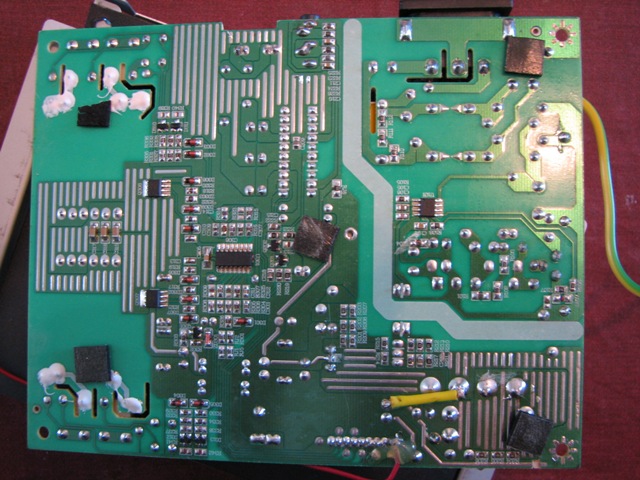

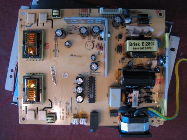

      I have attached pics of the top and bottom of the board, as well as a close-up of the suspect cap.
      Here are specs as seen on the cap, and measurements as close as I can on each of the 12 caps, less the big one:

        Yes, that one is definitely bad.

        Reordering your list, we get a much more manageable list.
        9 ea - 470uf, 25V, P12388-ND EEU-FM1E471 Double check the diameter, you may have to go with P10274-ND EEU-FC1E471L for the three in the audio amp section.
        #5 - 100uf, 16V, 493-1779-ND UPW1C101MED
        #8 - 10uf, 50V, P10316-ND EEUFC1H100L
        #12 - 22uf, 50V, P12927-ND EEU-FM1H220

            I've never seen that logo on a cap. But there are a LOT of bad cap brands out there. The rule of thumb is if one cap in a given application fails, replace all from the same manufacturer. I believe the most expensive caps on that list are about $.50. You may have different standards, but I'd rather spend an extra $3.00 today than have to tear the monitor apart again in six months to replace half a dozen more.
            Yes, Digikey part numbers, the three caps in a row are in the audio section.

                SUCCESS!! Got the new caps today, soldered them in, fired right up. Thanks for your assistance. Always good to hear "I knew you could do it!" from the wife AFTER I got it done
