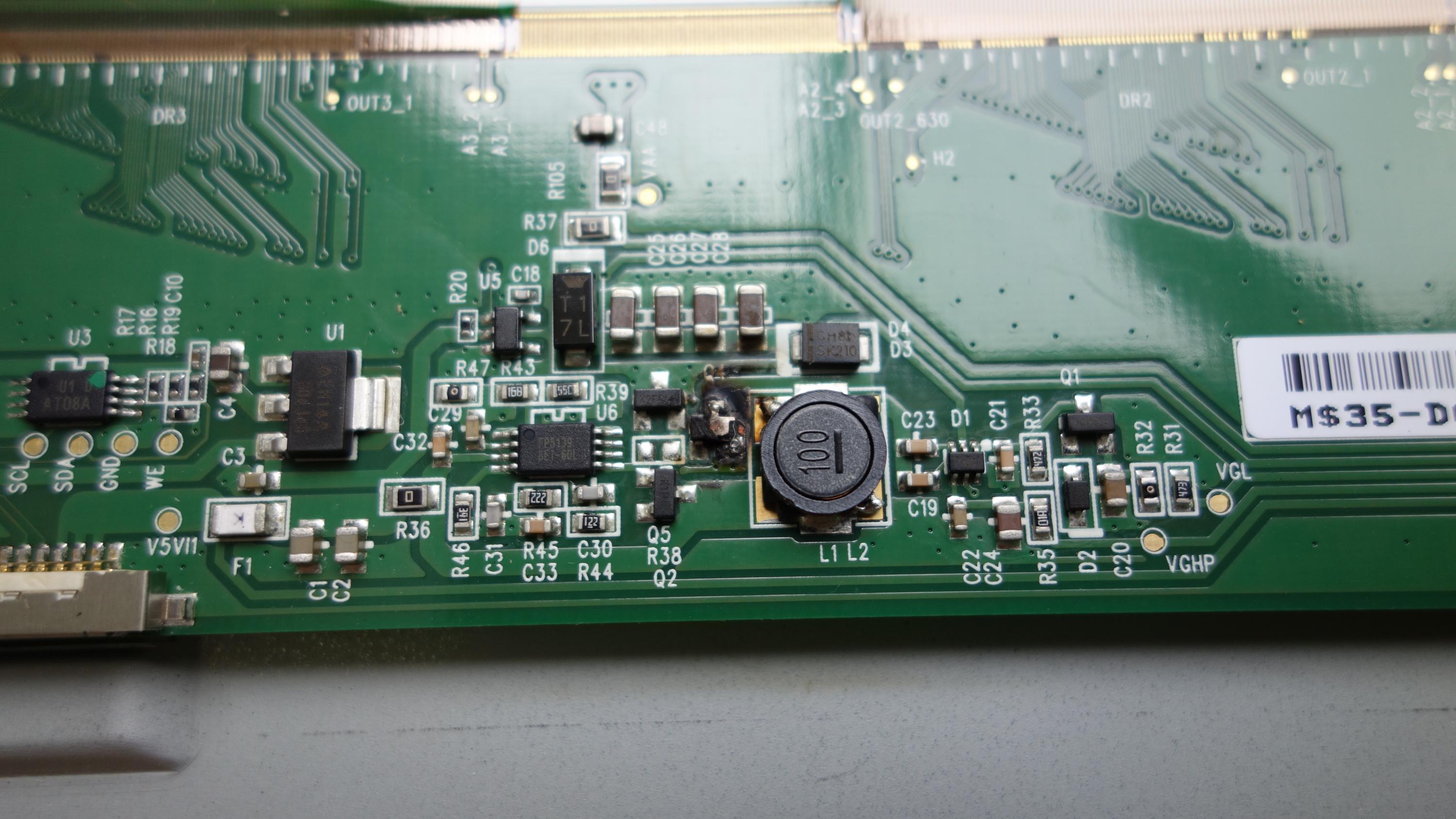

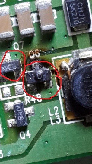

    Hi all.
    I have a burned out transistor on the integral t-com board of a Chimei TFT panel. The panel is a M220Z1-L03 and the board is labelled M$35-D024790. Since the component is burned out I can't read any ID on it. It is marked Q4 on the board.
    Any chance someone can ID this or direct me to a schematic? I googled all over the place, but could find nothing.
    Would also appreciate any views on the likelihood of having success by just replacing this transistor.
    Thanks!

    FP5139 is a boost converter, so that burnt out is the power MOSFET.
    https://cdn.badcaps-static.com/pdfs/...40c89c0962.pdf
    Do the serch for application circuits to see if some of them will give the spec for the MOSFET.

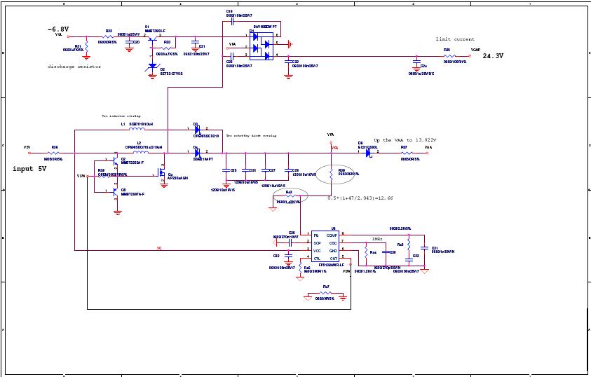

          I managed to find the attached schematic that seems to apply, but many of the labels are illegible. Posting here in case it helps others.
          Could be that the MOSFET is AP2306AGN-HF which is no longer produced. I just ordered some others having similar specs to try - PMV37EN2R, PMV28ENEAR, A03424.

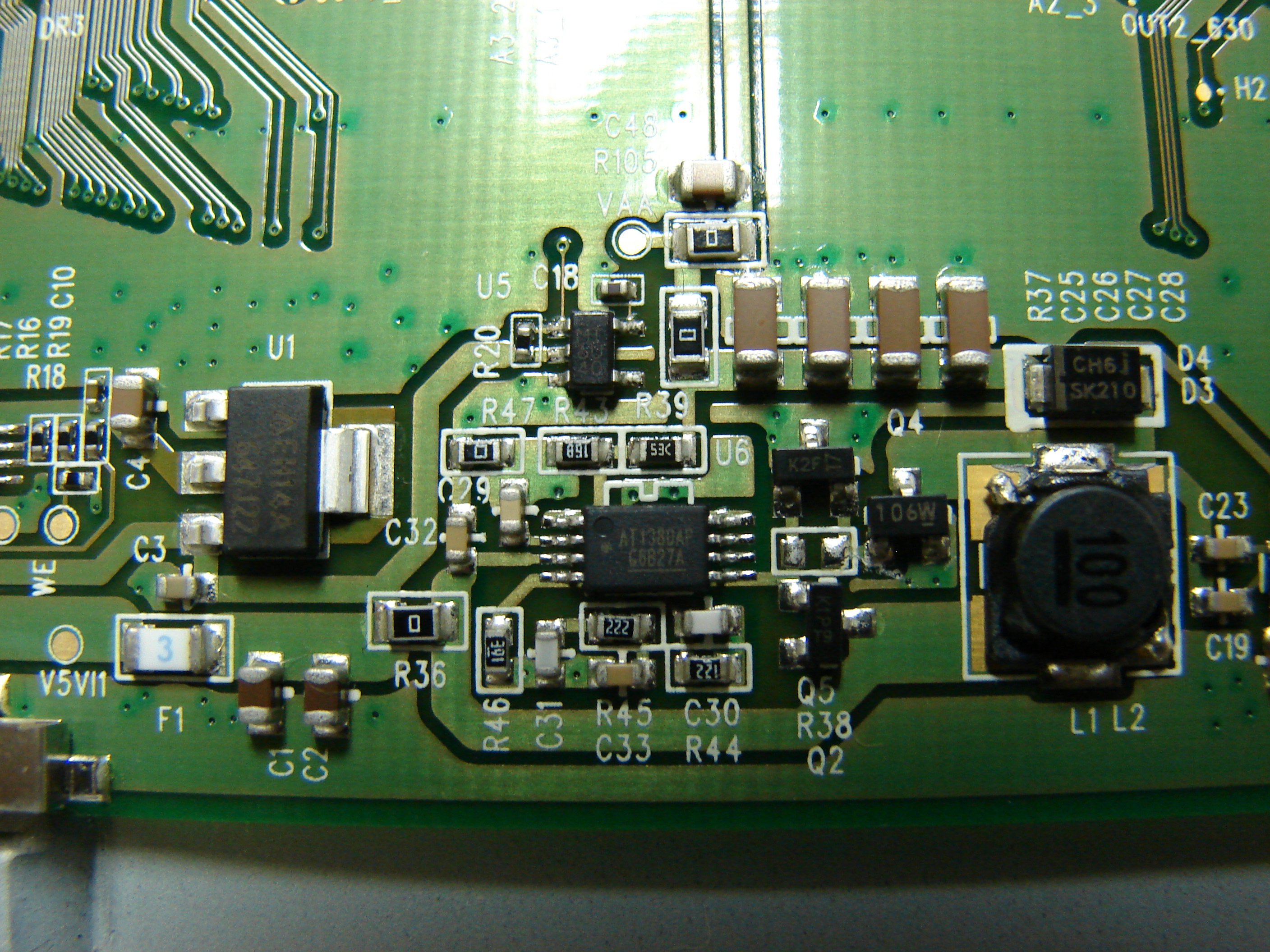

                I just checked a panel I have and it has a sot23-3 marked NAT3 for that transistor, and another panel with it marked 106W
                There are similar circuits that use a SOT-89-3L (CJA9452) mosfet
