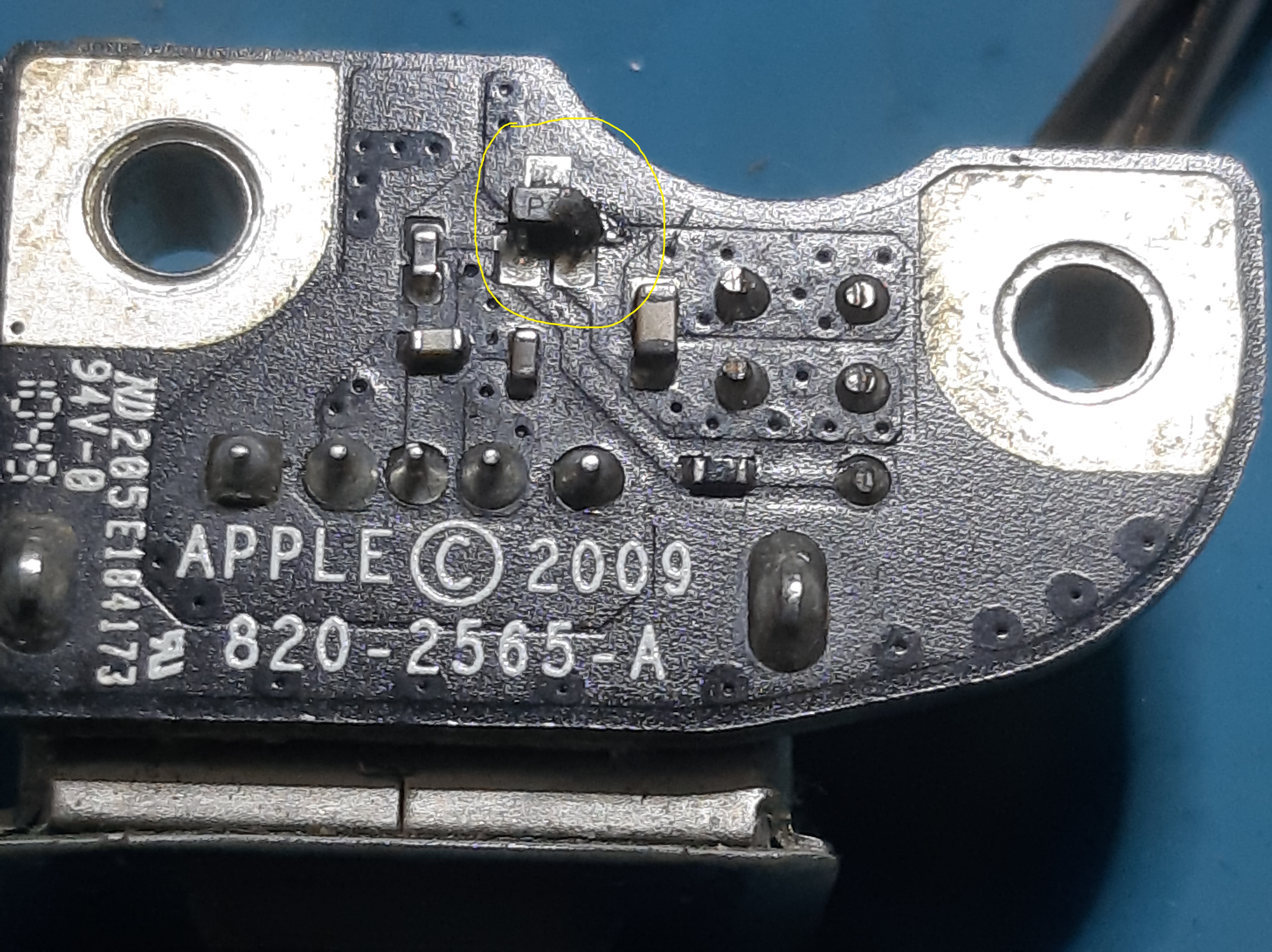

no green/orange light on charger and it has 12.67V on PPBUS_G3H & 3.38V on PP3V42_G3H but not power on
Please Help Identify The Burned Component 820-2565-A DC-IN magsafe
thank's for info
i did all the cleaning, using original charger but same result. but when i accidentally touch the screw hole on dc in board to metal parts on the motherboard, green light on charger turned on but won't power onComment
Confirm the voltage to ground at L6995 = PP3V42_G3H (should be 3v42 here).

thank's for info, but the owner decided to take the unit before i start continue diagnose using those flowchartConfirm the voltage to ground at L6995 = PP3V42_G3H (should be 3v42 here).
