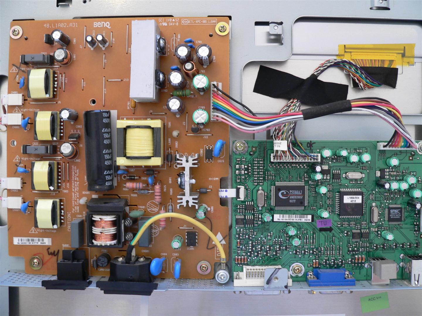

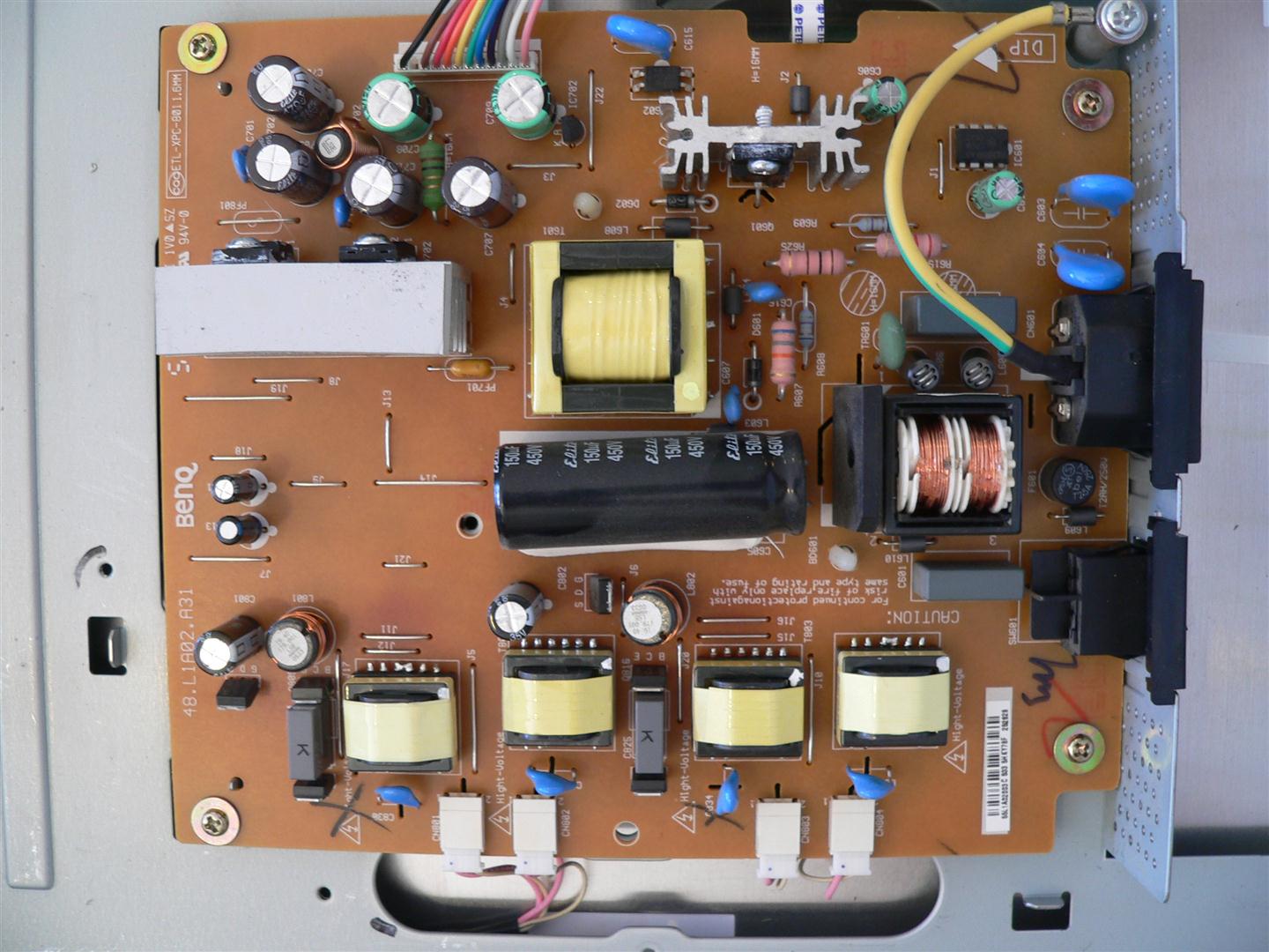

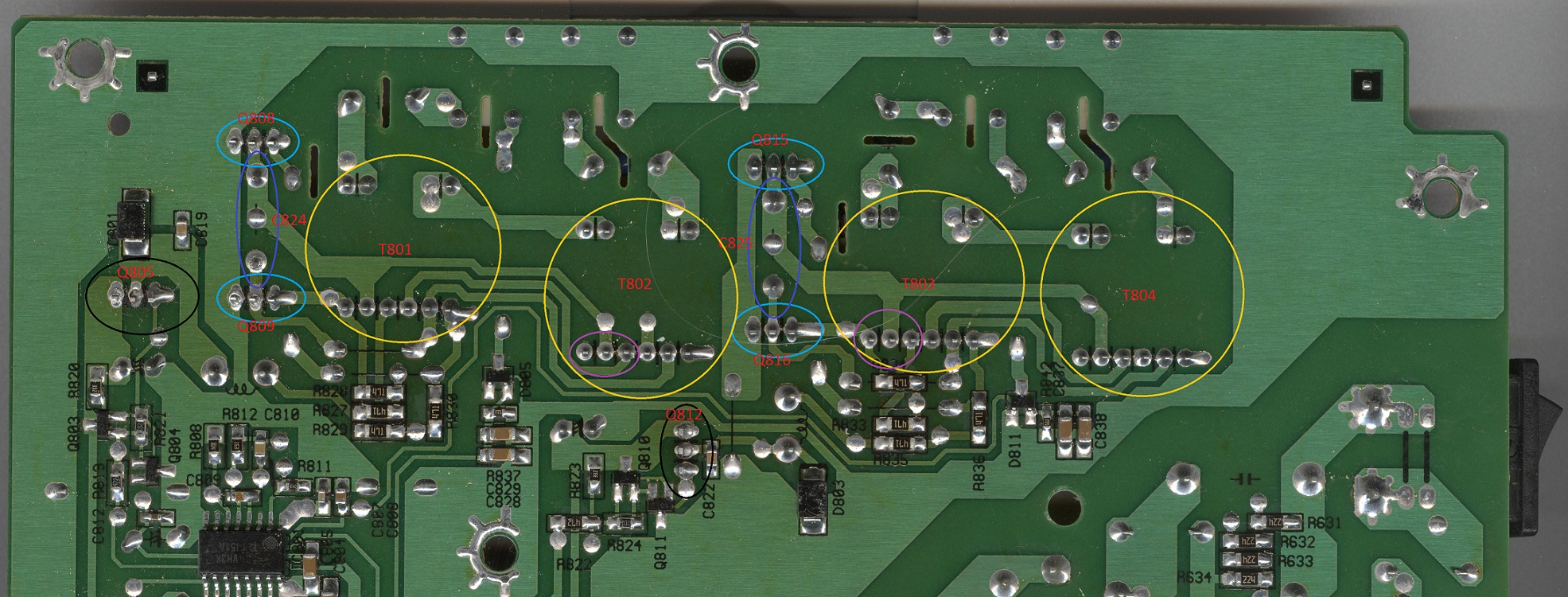

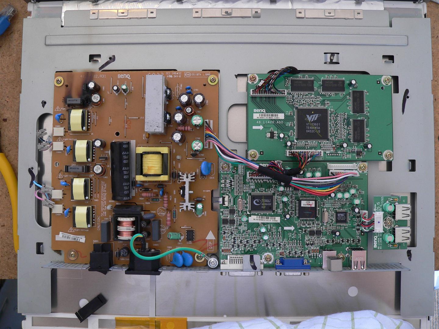

    One of my L1955 monitors has just started to not wake up from power save or sleep. I have been able until now to simply either switch off or remove the power cable then re-power which will make it work again until the next power save or sleep time. The green power led lights all the time (dims slightly when the display appears) then the backlight appear to turn off and the power led stay on. It now also just perodically dies, still with the green led lit with text visible by torch.

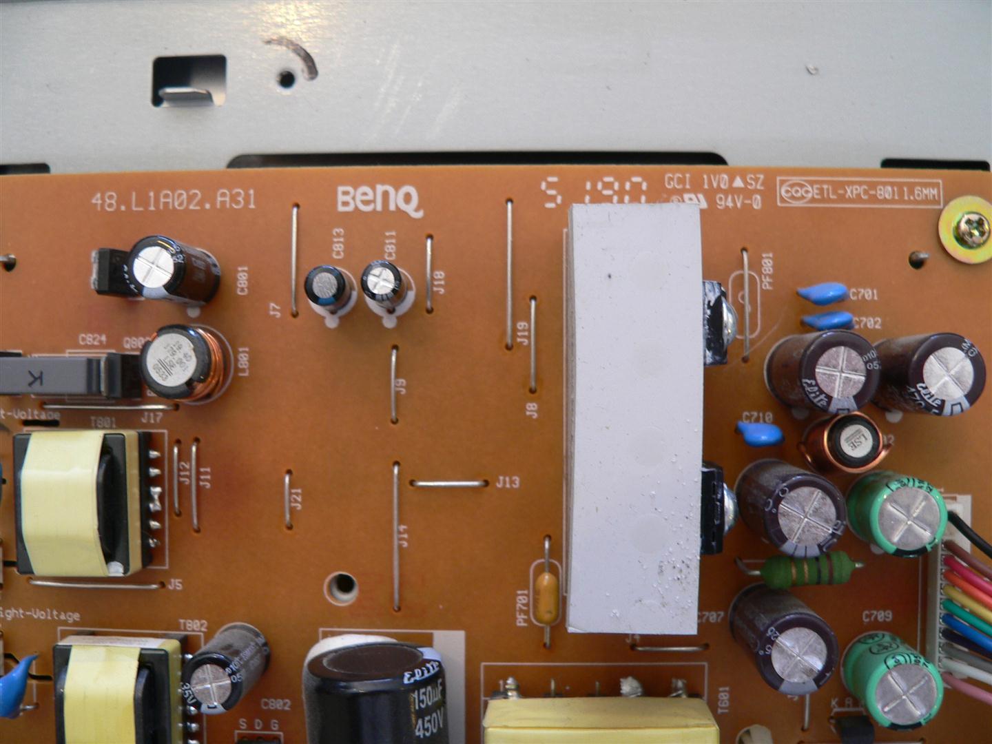

    I had another one which totally burnt something out on the power board (see attached P107490) and i swapped the power board out of a working display into that and it worked perfectly. I've since swapped the power board from this one into that and get the same problem so assume it is something wrong with that board and not anything else.
    Does anyone have any ideas where i should start? The CAPS as far as I can see are ok.
    Photos of boards attached.

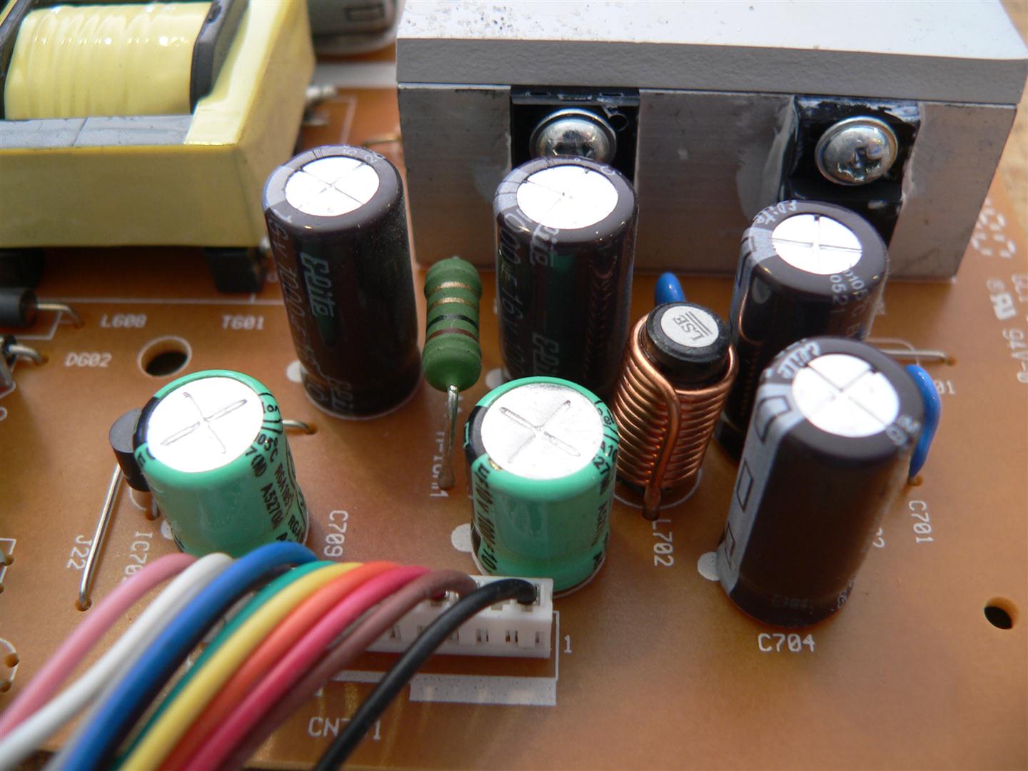

    replace all the brown and green caps on the power board. both of these brands are known to give problems.

      Burned c5707 is common problem of Benq power boards due to cold joint
      https://www.badcaps.net/forum/showthread.php?t=6692
        Re: HP L1955 no display following wake from sleep
        looks like the 5707's burned or the cap in between them.
        some of those plastic box caps were trouble too.
        but most blowups in these is brought on by bad solder joints on the ccfl transformers and the 5707's

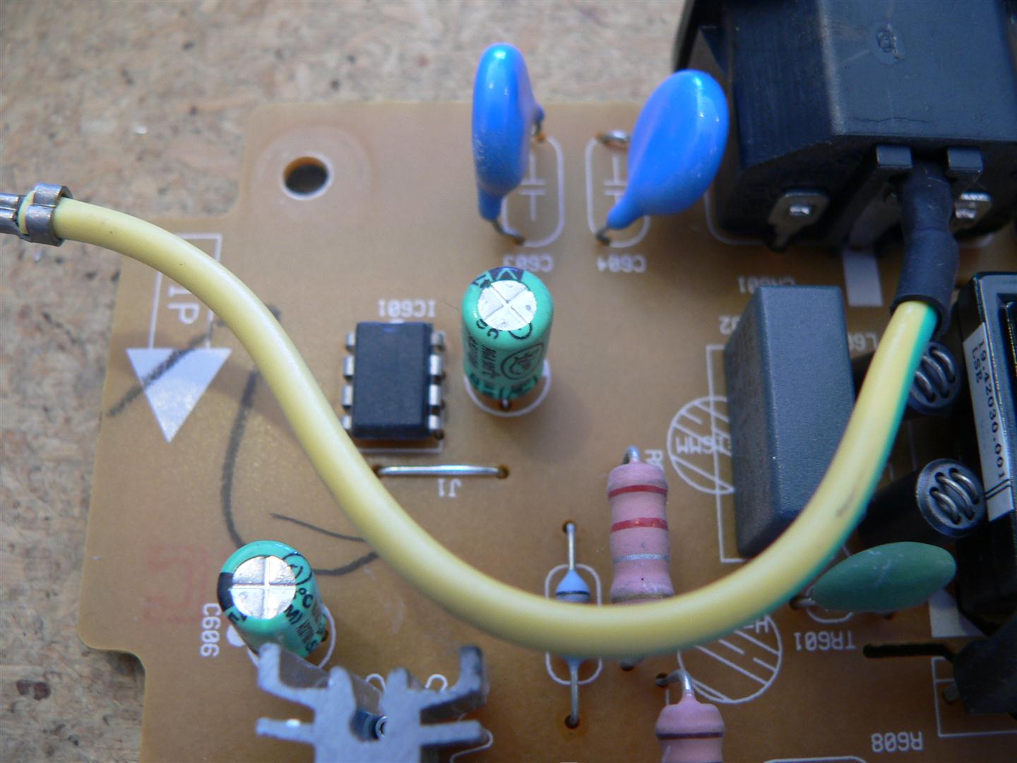

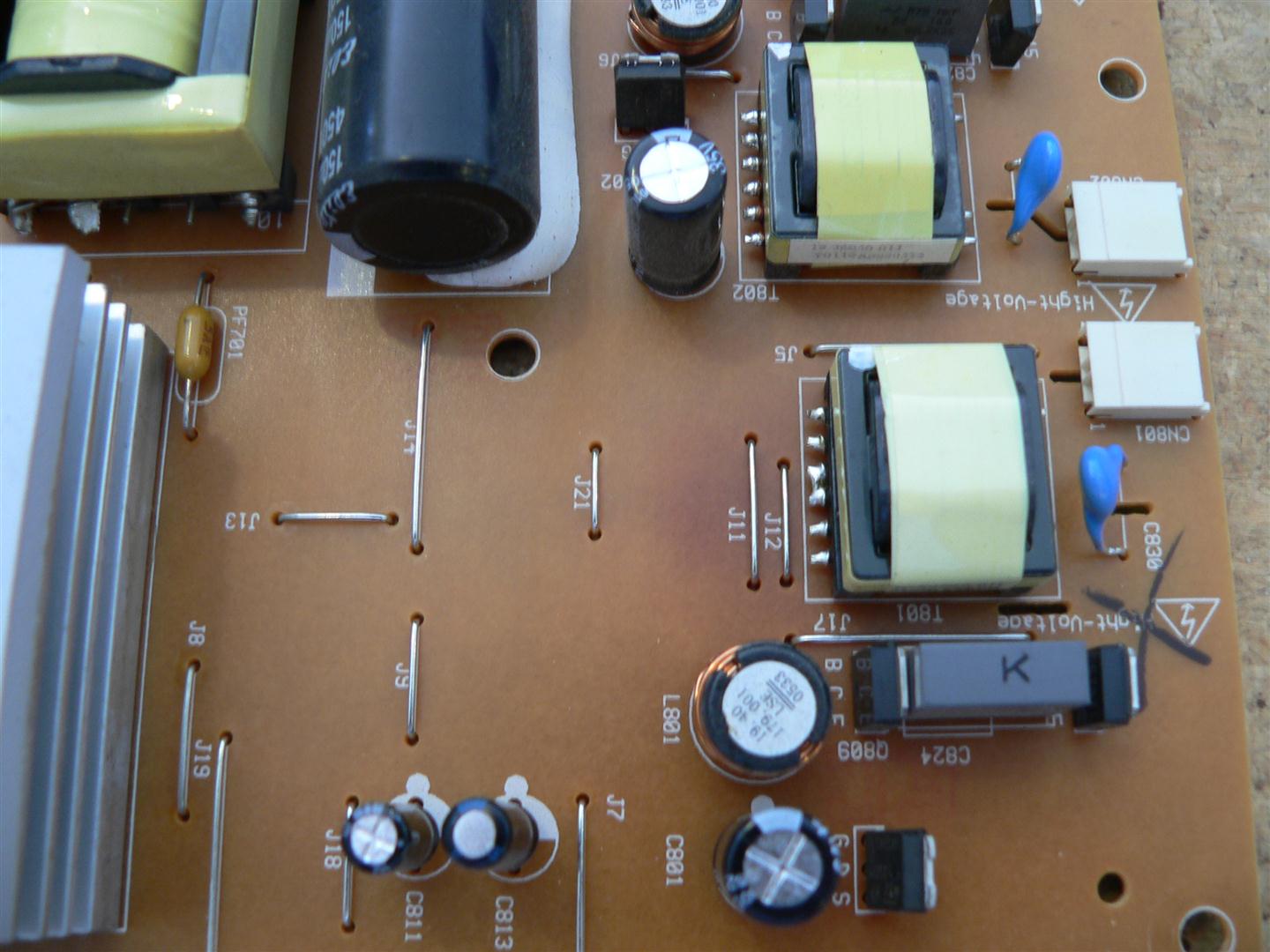

          Last nite following another switch on/off I got the burning smell and a puff of smoke, I quickly removed the power, disassembled and found the C5707s on Q808 & Q809, the R75 MKP on C824 and the D10pf on Q805 all with some kind of heat damage. The D10pf on Q812 also looks like its had some heat so I guess its just a matter of time until that goes along with the 5707's on Q815 & Q816 & the R75 MKP on C825
          On the previous board that had failed and had a major burn out right through the PCB it was Q808/9, Q805 & C824, so same fault, but others have mentioned that Q815/6 have failed on them.
          So to sum up, it would appear that I should
          Replace the 2x D10pf at Q805/Q812
          Replace the 4X C5707 at Q808/9 & Q815/6
          Replace the 2X R75 MKP at C824/5
          Resolder the 9 joints on T801/2/3/4
          and
          Replace all the brown and green caps?
          Sounds like a lot of work huh? Especially for a newb like me.
          If I do all this does anyone know if anything else is likely fail?
          Also any recommendations for the replacement components?
            Possibly Inverter transformer damage after that burn up
            I would add to your list C801+c802, also a few PF701 fuses as the one on your board is no doubt open
            Resolder all four of the Inverter transformers, and check the whole board for bad solder cracks etc

              Q805, Q812 - be careful, they are MOSFETs - sensitive to static electricity.
              I damaged them during resoldering
