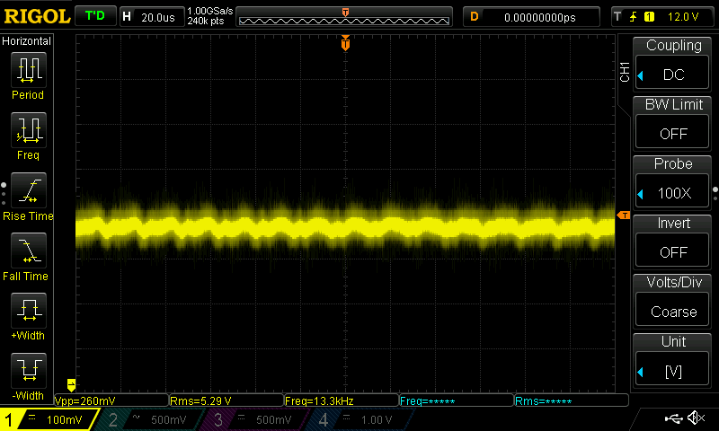

                      Re: SGI GDM-5011P CRT Monitor (Sony Trinitron) Help

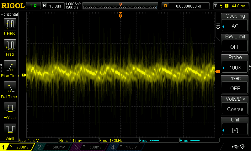

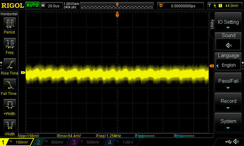

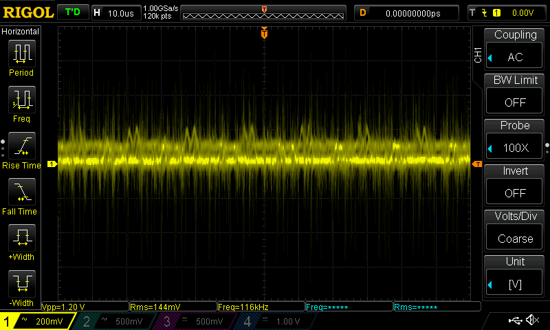

                      I have a Rigol 1054z with a 100x probe. I mostly bought it to help troubleshoot tube radios. I'm not very good with scopes in general though. So I usually need some pretty explicit guidance on how to set it up.

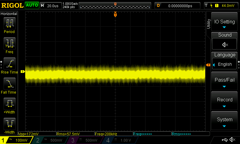

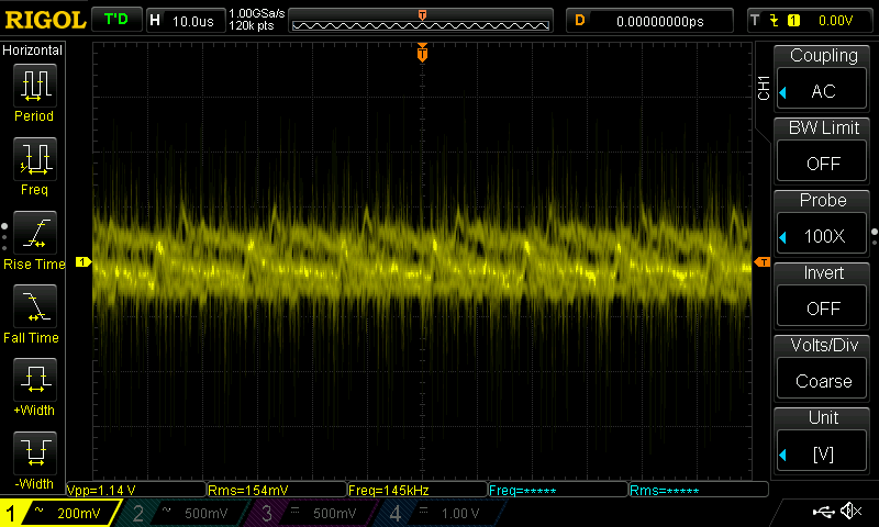

                      I gave a shot at taking some snapshots off the power board. Not sure how good or useful these are. If something isn't right, let me know what to change on the scope and I can try again. I clipped the ground from the probe to the cage, as I confirmed with my DMM it has continuity to the GND pins on the power board connector. I pulled the spring loaded clip attachment off the tip of the probe, and used it with nothing on it. The needle point on the bare probe was able to reach inside the plastic connector to take a reading. All readings done from CN671.
                      -15v rail (measured -14.5v)
                      +15 rail (measured 14.5v)
                      +80 rail (measured 78.2v)
                      +200 rail (measured 199.3v)
                        that amount of ripple is not that bad, You are not looking at the dC value, you are looking at the AC ripple. I would now check the A board, First check the regulator outputs, If there output cap goes bad they can oscillate, I would also just check all the electrolytic caps with the scope, If the cap is used as a filter, and there is lots of noise/ripple on it, it is likely bad.
                        I would check around IC402 & ic403 since both the video and osd show the problem.

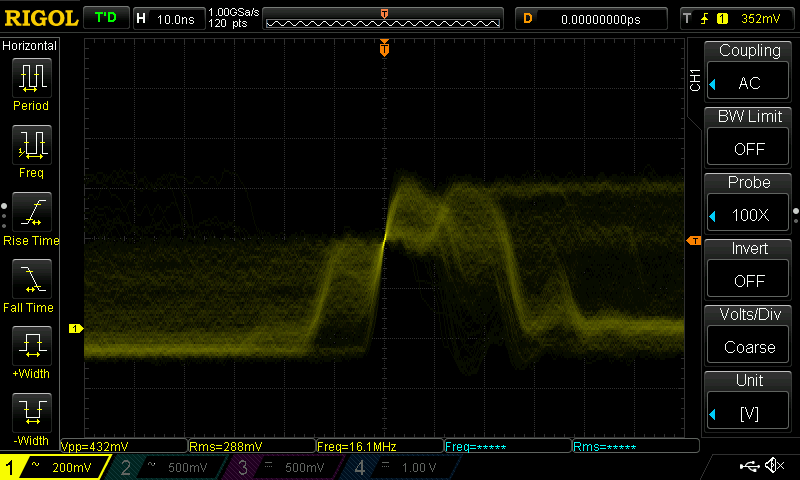

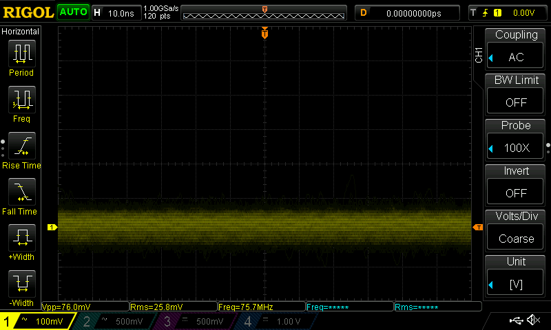

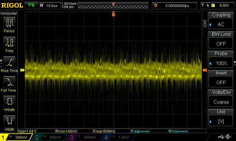

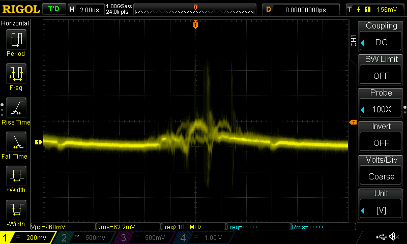

                              Hmm. I'm not sure I'm doing this right. I can't seem to get a stable wave form on the screen. Not sure if I'm supposed to though. For now I only did the red channel, before I go further with a bunch of useless/messed up screen prints.
                              IC401 can't really be scoped directly, as it is a surface mount IC, and it's facing the cage. There is no way I can get in there to probe it. So I figure next best thing would be the in pins on IC402.
                              Here is what I scoped for the red line:
                              CN401 - Pin 1
                              IC402 - Pin 17
                              IC402 - Pin 37
                              I apologize if these aren't right. Like I said earlier, I'm not all that great at using a scope. It's not helping I'm doing this on the floor as its the only place I have enough room to work on the chassis with a scope and laptop attached. Plus I'm one handed for making scope adjustments. Due to the fact I can't actually clip the scope probe, I have to manually hold it on the pin.
                                which input is connected to the pc? I guess it was not the 15pin vga connection and was there video on the screen when you scoped the pins?

                                  I had the 15 pin VGA hooked up to my laptop. The laptop was at the desktop screen. After work tonight I'm going to try resetting the input on the scope, make sure I get a nice clean waveform on the test terminal, and recheck the monitor. I'll post back once I've had a chance to do that.
                                  • R_J
                                    • Jun 2012
                                    • 9518
                                    well that would explain the first waveform, you checked the wrong connector, CN402 is the one for the 15pin vga. I am starting to think the video portion may be ok. and that it is the horizontal sync that is being effected more than the actual video.
                                    so it might be an idea to check CN511 on the D board (horz sync should be on pin 3 or 5, which ever pin it is on, it then goes to ic013 and then into ic007. there are a lot of small electrolytics in that circuit, I would scope each cap. if the caps negative is connected to ground, there should be no real noise on the positive.
                                    Have you tried changing the screen resolution to see how that effects the picture, a different resolution uses a different horz frequency.

                                      Looks like that was a typo on my part. I was actually probing CN402 for the vga connector. I'll still check again after work tonight to try and get some kind of stable waveform.

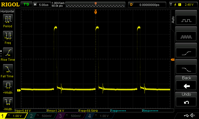

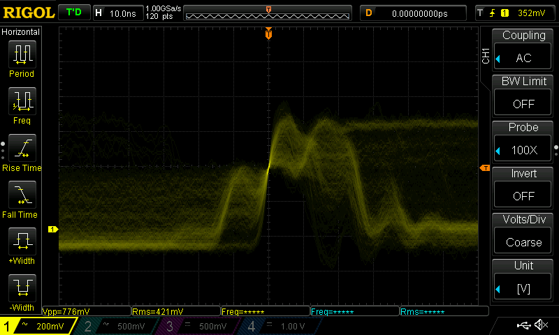

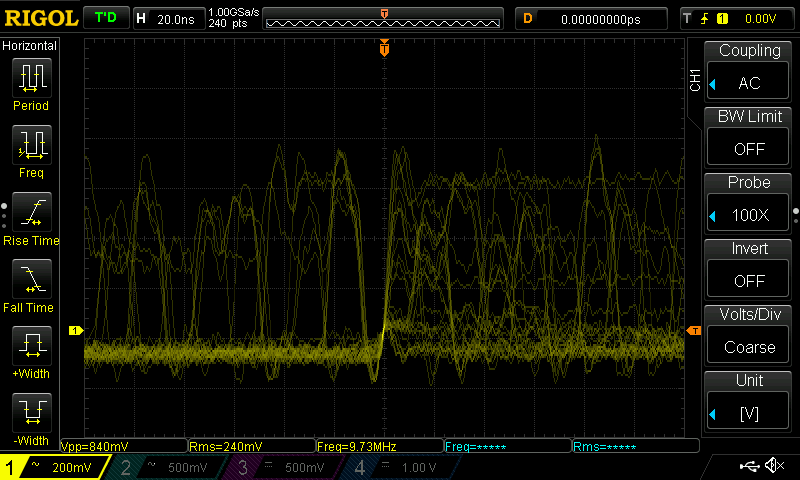

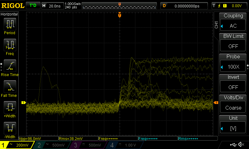

                                        OK, this time I used the auto function on the scope when taking measurements. I believe that does what it can to give you the best picture of the waveform instead of relying on me to try and set it right.
                                        I retook the red pins from the A board. And I was able to open the cage and swing out the deflection board. I was just barely able to get to CN511 this way. I took pictures of pin 3 and 5. Hopefully these make more sense than my last ones.
                                        CN402 - pin 1 - red
                                        IC402 - pin 17 - red in
                                        IC 402 - pin 37 - red out
                                        CN511 - pin 3 - c_sync_1
                                        CN511 - pin 5 - c_sync_2
