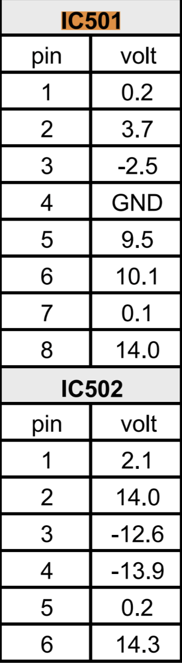

                    Plugged in the TV and checked the IC501as well as CN502 and CN706. I also re-tested IC502. No voltages.
                    Double checked the pins in the service manual and they are a little different than what you provided on IC501 (see attached). So I tested both ways.

                      I made a mistake, I meant IC502, the vertical output ic. Do you know if you have any high voltage to the crt?
                      Check if you have B+ on C654, should be around 130vdc
                      The +12 & -15 are supplied by T505 FBT
                      Check D504 and D505 to see if one is shorted

                        Thanks for being patient, I'm learning on the fly here and am a little embarrassed to admit my voltage checks have been incorrect. Sorry for steering you down the wrong path, but I am getting supply voltage at the IC502.
                        I was powering on the TV, which then powers off after 5 seconds (after the failed self check).So I was unknowingly checking for voltage when it was off...
                        Now I'm holding the probe at a contact with one hand, while powering on the unit with the other hand to get a reading. The negative lead is resting on the video input ground.
                        IC502 reading doesn't fully stabilize in time before the unit powers off.
                        Pin2: ~13.9v
                        Pin4: ~ -13.7v
                        CN502 / CN706
                        Pin1: ~13.9v
                        Pin2 ~ -13.7v
                        B+ on the C654: 136v
                        I'll test D504 and D505 in the morning.
