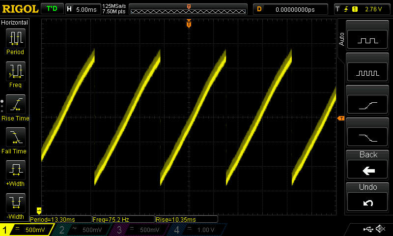

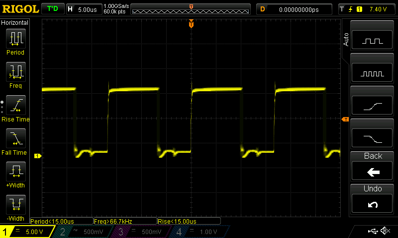

      Are you able to access the D board? I would look at the signal on Q501/503 emitter and also the Vshape signal on ic703 pin5

        Re: SGI GDM-5011P CRT Monitor (Sony Trinitron) Help
        I am able to get to IC703 and Q501/503 by using a piece of 22ga wire to extend my probe into the vent holes. I did have the wire pinched between my fingers when I took these, but I don't think it affected the reading at all. If they look funny, I can try to take them again without holding the wire to navigate through the vent holes.
        I took the IC703 print at 5ms like the others. But at 5ms Q501/503 just looked like solid line. So I backed down to 5us, and you get several square waves. Not sure how these look, as I have no idea how they should look. I did notice Q501/503 have a slight ripple or something at the bottom of the wave. I'm assuming its supposed to be flat there? Or is that normal?
        IC703 - pin 5
        Q501 - E

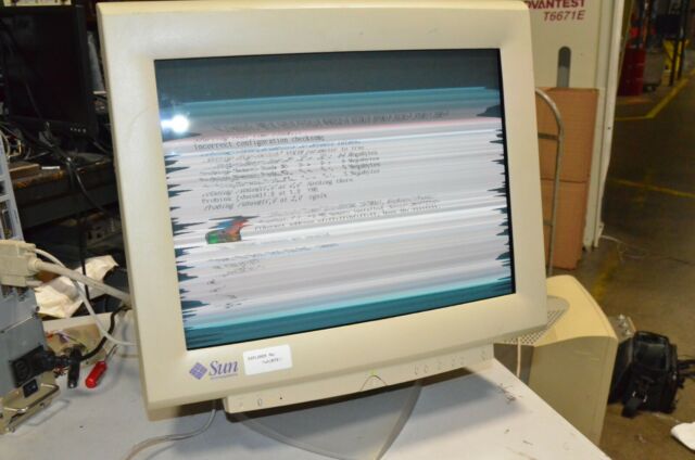

              Ok those voltages are good, I was looking for a picture I saw of another GDM-5011p monitor with the same fault https://www.ebay.com/c/13014969428, It looks like it might be a common fault.

                I was wondering if there might be a common fault in these monitors. When mine first started acting up, I had searched trying to find a solution. I never found anything, other than someone posted over on the CRT Gaming section of Reddit: "I bought this guy so I'd have something to play games on until I can either repair my SGI GDM-5011P's deflection board..." Which made me wonder if all these had some kind of defect on the deflection board. Maybe a bad batch of some part they used? Of course the million dollar question is, whats the defect? I'm not a member on Reddit, but maybe I'll join and see if I can message the poster to see if they had the same fault, and if they ever found the fix.
