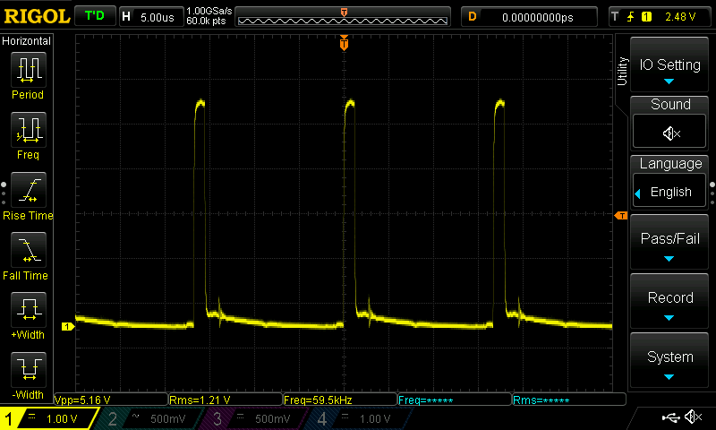

    the only signal that makes any sense in c_sync_2, which is correct for what the horz. sync pulse should look like, but this is entering the monitor, does it still look ok when it gets to ic010 pin 7

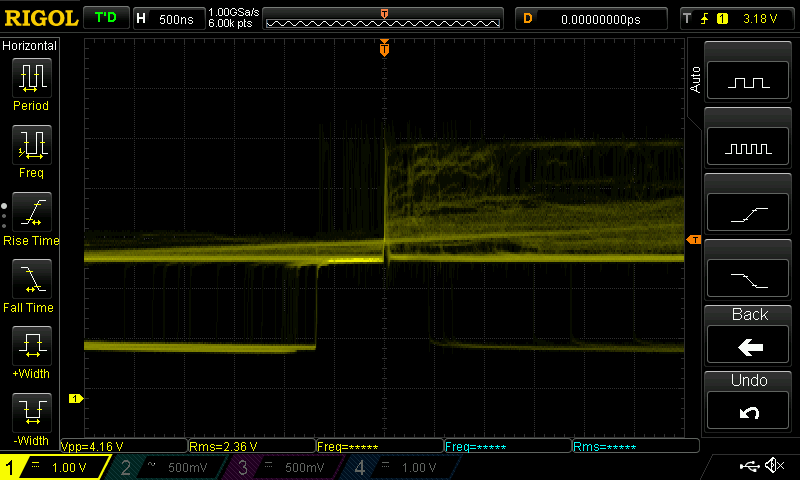

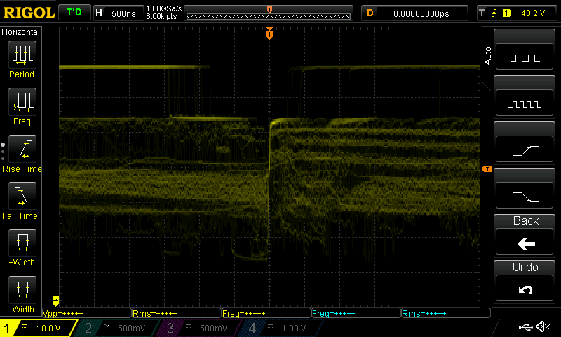

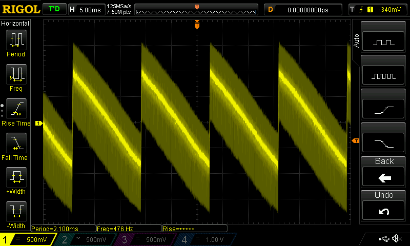

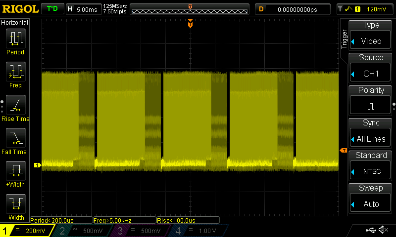

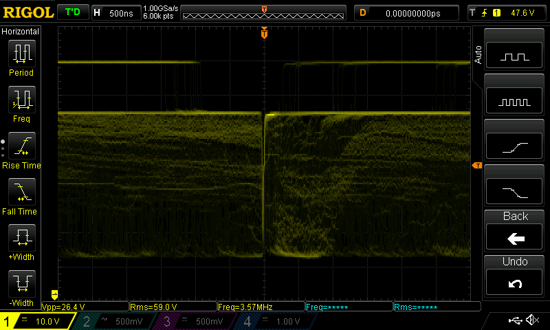

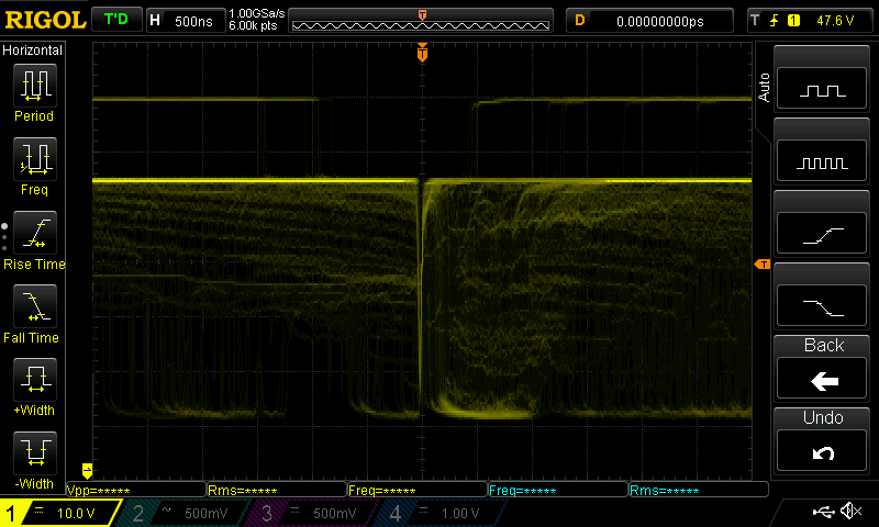

    It is hard to tell from those first 2 images, what it looks like is part of one scan line.
    I would have thought a similar signal would have been in picture 3 and would have an amplitude of about 3v peak to peak, but it is dc coupled so its hard to know what the ac video signal is at that point. I also see the scope measures 12vdc on pin 37? that seems to be close to the 12v vcc. I would expect the voltage to be more like 4vdc on pin37

        These are ideal waveforms and are also displaying a test pattern, the video from the pc (windows desktop) is very complex and you are also using the wrong sweep rate to display them.

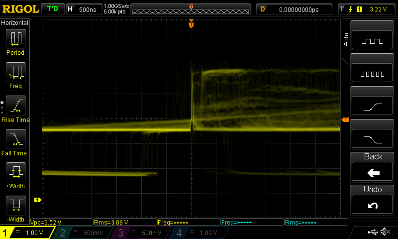

        in picture 1 the sweep rate is 5µs and displays 3 positive going horizontal pulses. The distance between one pulse and the next is one scan line. between the horzontal pulse is where one line of video is displayed.
        In picture 3 you are sweeping at 500ns, you have the horzontal (blanking) pulse stretched out and only the start of the video signal and no ending blanking pulse.
        Change your sweep rate to around 5ms, this will display the video at the vertical scan rate, you only need to check one color, like green.

            the horizontal sync pulse going to ic010 looks ok, I would find a test pattern that is very simple, SMPTE color bars might be ok, You could even use Paint at full screen and just draw a box that covers half the screen and fill it with black so top half is white and bottom half is black.

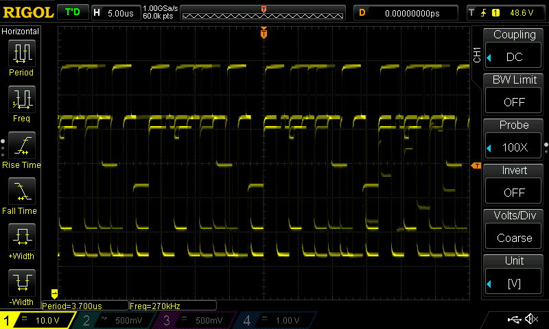

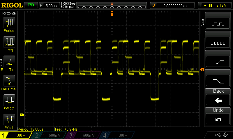

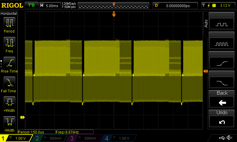

              I downloaded a GIF of the color bars, and ran it full screen on the laptop while scoping IC403 on the blue in and out pins. I made sure after using the auto function to change both to 5ms as suggested, but it didn't look stable. It was rolling horizontally on the scope, and just looked like some almost solid blocks. So just to be safe, I also took prints at 5us as well. Which look more like detailed waveforms. Hopefully at least one set of these is right.
              IC403 - 1 B_IN - 5us
              IC403 - 3 B_OUT - 5us
              IC403 - 1 B_IN - 5ms
              IC403 - 3 B_OUT - 5ms

                At 5µs you are viewing one line of video (one line from left to right) at 5ms, you are viewing on field (all lines from top to bottom)
                The video input to the ic has negative going blanking pulses, so the scope can trigger on them giving a more stable image, the ic's output is inverted and now the pulses are positive going and the scope is trying to lock on the video instead (and it can't) so the result is a image that looks like it does. It should look like the input but larger in amplitute and inverted.
                If the image is scrolling horzontally you need to adjust the scope's trigger level and maybe trigger polarity. (looks like there is a VIDEO Trigger type, I would use that and then depending on the video polarity, switch the video Polarity as required to lock the display
                How does the image look on the screen? I do see some thin lines in the 5ms images but I don't know if they are caused by the scope itself or are there in the waveform. have a look at the video right at the CN402 (at 5ms) and see what it looks like and if those lines are there.

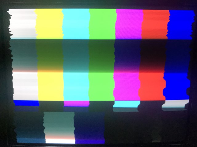

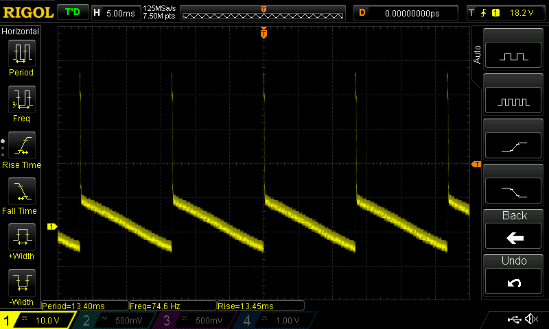

                  I took a snapshot of the blue pin on CN402. Despite changing the trigger to video, and trying to find the trigger, the best I could do is get it to be "twitchy". Meaning it was kind of stable, but looked like it would occasionally jerk left or right. Trying both polarity options didn't seem to make a difference.
                  CN402 - 6 B_IN
                  CRT Image

                    The actual video does seem to be ok, but the vertical sweep is being modulated by something. I think you need to be able to access the D board, Could there be a elect. cap you did not change on the D board?
                    Go into the monitors menu and adjust the geometry controls like pincushion, and see how it effects that ripple effect in the picture.
                    If you can get at the signal VSHAPE, that should be checked, IC703, pin5. It should be a nice clean ramp waveform. at around 5ms

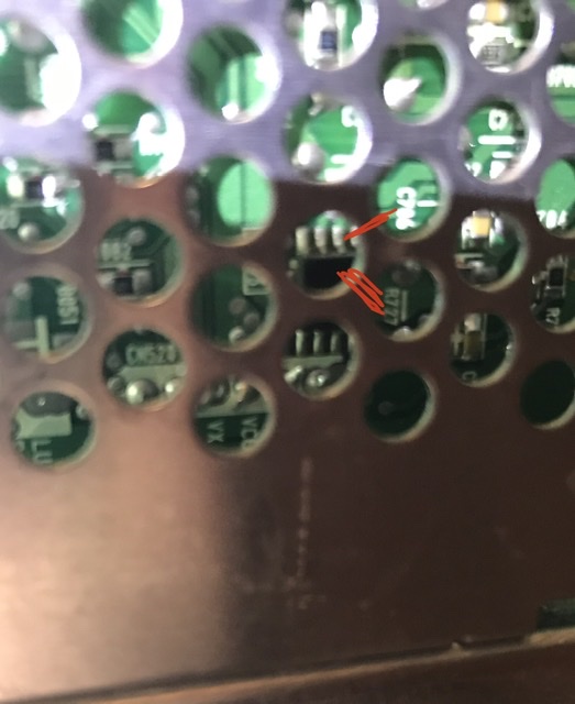

                      IC703 is a problem. It's an SMD chip located on the back side of the board. It is in an area where there are ventilation holes in the metal board holding D. So I can see it. But the holes aren't big enough to get the probe through. I hoped maybe pin 5 on IC702 would be viable, since it is a through hole part on the top side of the board. But it is mounted against a very large heat sink on the board. And has several components right in front. So I don't have a way to get to the legs.
                      If this is the only thing we can look at next, maybe I could use a tin snip to cut a larger opening on the metal tray under D. Unless there is some trick I don't know about to make the tip of the probe longer to get through the existing holes.

                        Why can't you just remove the metal shield, you may need to lay the board on something so it does'nt short to the chassis. I would'nt start cutting holes in the shielding

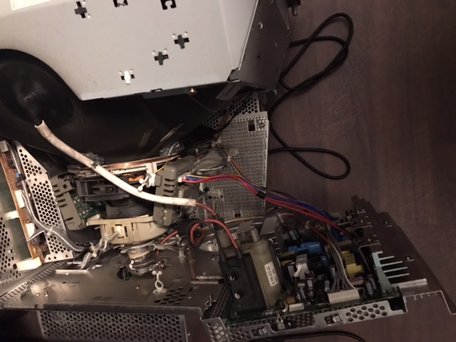

                          The deflection board hangs vertically, and the wiring harnesses are not really long enough to be able to lay it down. Trying to prop it up would be virtually impossible. Not to mention the fact it integrates the tray and another big heat sink in the back of the tray into the heat sink on the top side of the board.
                          I'll play around with the geometry settings tomorrow morning before work and report back.

                              I noticed when doing pincushion and horizontal size adjustments, the peaks and valleys of the ripple tended to go up and down. I noticed on the horizontal adjustment there were two larger valleys on the bottom half of the right side that never changed, even though almost every other part of the ripple did. Not sure if that points to anything. But it seemed odd given the behavior of the rest of the ripple.
                              Also, if IC703 is still of interest, this is where it is. I was thinking I could just make two snips as marked and bend back the shield to get the probe in. I can then bend them back, and either try soldering the gap to seal it up, or use some copper tape to bridge the cut. If it's important to keep continuity over the entire shield.

                                It does look like the problem is on the D board so you will either need to remove the shield completely to check various components or replace the board. IC703 was just a point to check the waveform, you can also check the waveform at the yoke plug but you need to make sure you check the vertical pin 2&3. But at this point I am sure the fault is with the correction signals that get applied to the vertical ramp. The problem is not with the vertical output but likely in the pincushion correction circuit.
                                Without vertical pincushion correction the screen would be curved in on the sides, so a correction signal is applied to correct the scan to make it straight, that correction wave is not correct.

                                  I can try and see if I can make up some kind of mount to position the deflection board so I can get to the back, if needed. But it's not going to be easy. And I'm assuming straight up replacing the board is out of the question, since it's probably made out of unobtanium these days. So repair is probably my only option.
                                  A friend of mine offered a suggestion if I need to probe IC703. I could just take a piece of solid strand wire and use it to probe through the hole in the shield, and connect the other end to my probe.
