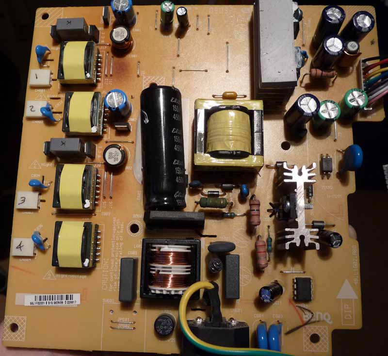

    I have a HP 1940 LCD screen which flashes on and off.
    I've checked the board and resoldered new caps on it - but it still keeps flashing the picture on and off.
    I've given up trying to fix it, does anyone know where I can buy a replacement board.
    The board is a BENQ 48.L1G02.A00

    Replacement for that board would be tough.
    Did you replace the C5707 transistors and the pico fuse?
    That's the common problem with these boards.

      Thanks for your reply!
      I'm a bit of a noobie at electronics...
      ... is the C5707 transistor the thing which is screwed to the heat sink?
      what does the Pico fuse look like?
      I've attached a pic of the board!

          Ah ha! Found the C5070 transistors - theres 4 of them.
          (Haven't found the pico fuse yet though).
          Are the C5070 transistors something you can get from any component shop - like RS?

              Good , easy fix
              fuse yellow just above large transformer
              c5707 =2sc5707 plenty on ebay

                  Suburb!! I replaced the c5707 transistors and the monitor work again!!

                    Bugger.
                    Just when I thought it was fixed it went again.
                    It lasted about a week of perfect usage, and then pop - same problem again.
                    It happened when I was turning it on.
                    The C5707 transistors were cheap enough to replace again, but I'm now thinking its something causing them to go.
                    Any of you chaps know what can cause them to go.
                    Also, is it possible to but 'better ones' which are more resilient?

                      This happens often if you have not resoldered the 4 inverter transformers also you need to check the rest of the solder joints on the board paying particular attention to anything on heatsinks and the 2 mosfets FU9024N (they look like the transistors)
                      best use a good magnifyig glass 8 or 10 X magnification
                      The 2SC5707s are the best ones for this inverter, plenty of recomendations for them from people like DAVMAX and alike, thats good enough for me

                      EDIT probably only one transistor has gone and the fuse again

                        I agree with Bob. Resolder all the transformer points. Or you'll be swapping the Qs again in no time ...
