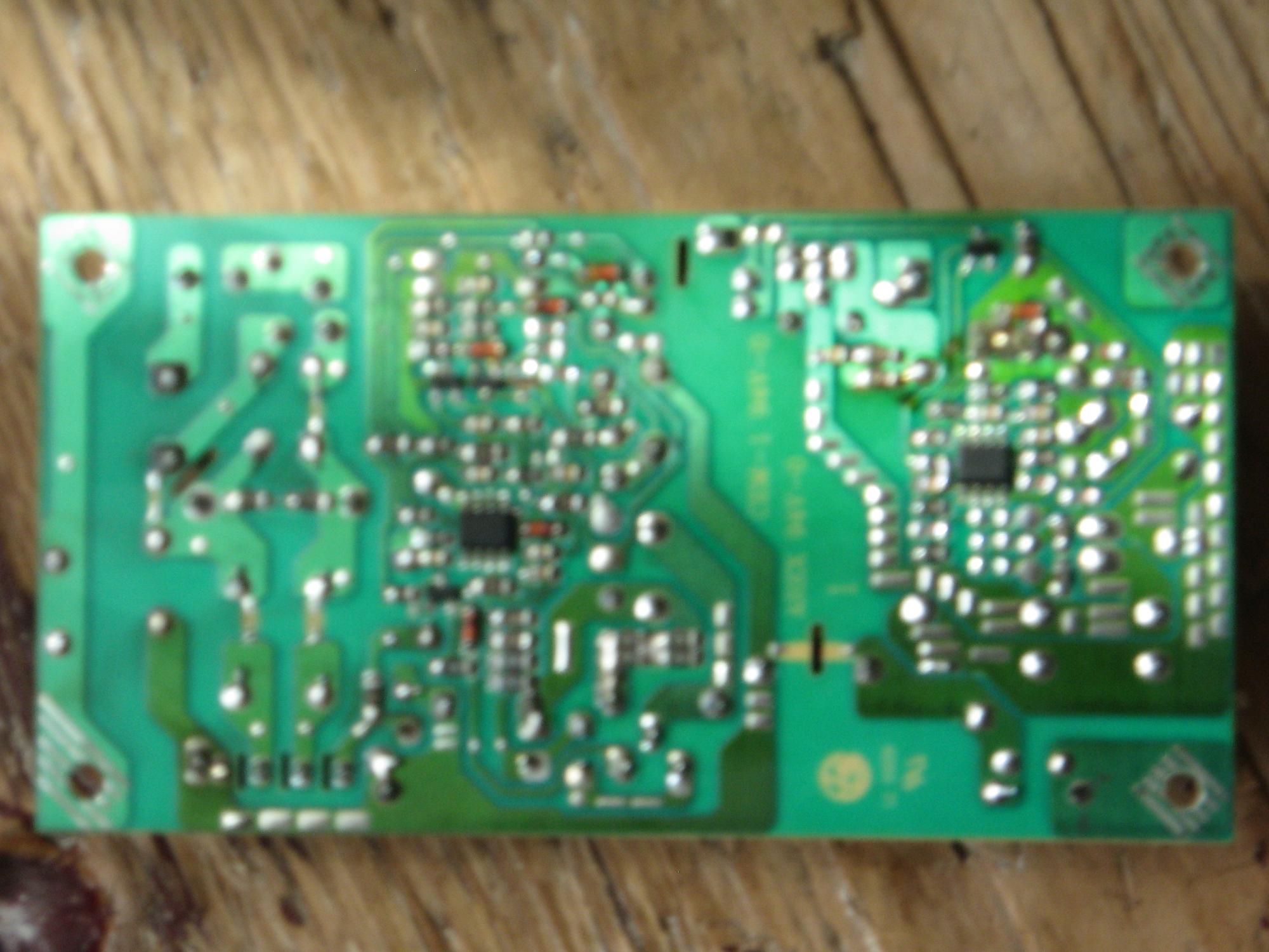

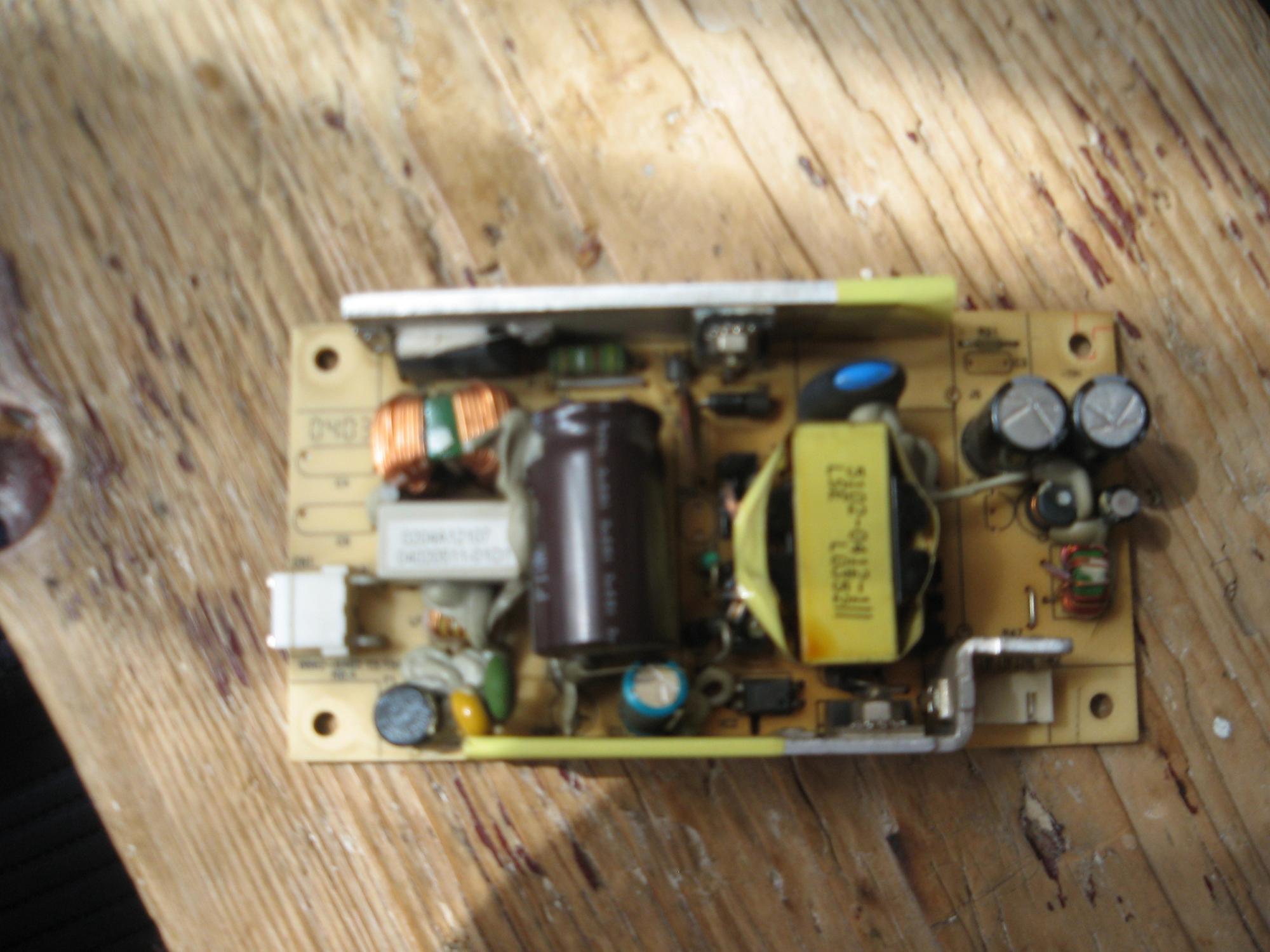

                              Re: Hp L1925 lcd monitor black screen
                              Here are the pictures with the power board. sorry for the blury qual but that`s preeety much the best in fast manner.
                              • selldoor
                                Slow Learner
                                • Dec 2010
                                • 7870
                                Pictures are almost useless. IF that white connector goes to the lamps then Power off, with a meter on 2000ohms test across the two purple circles and post result
                                  On the white thing is says 0204A1207
                                  040020511-01o1
                                  i have tested.. and shows nothing... no reaction
                                    We need the picture of the inverter board, not the power supply board. That white connector is for the AC input.

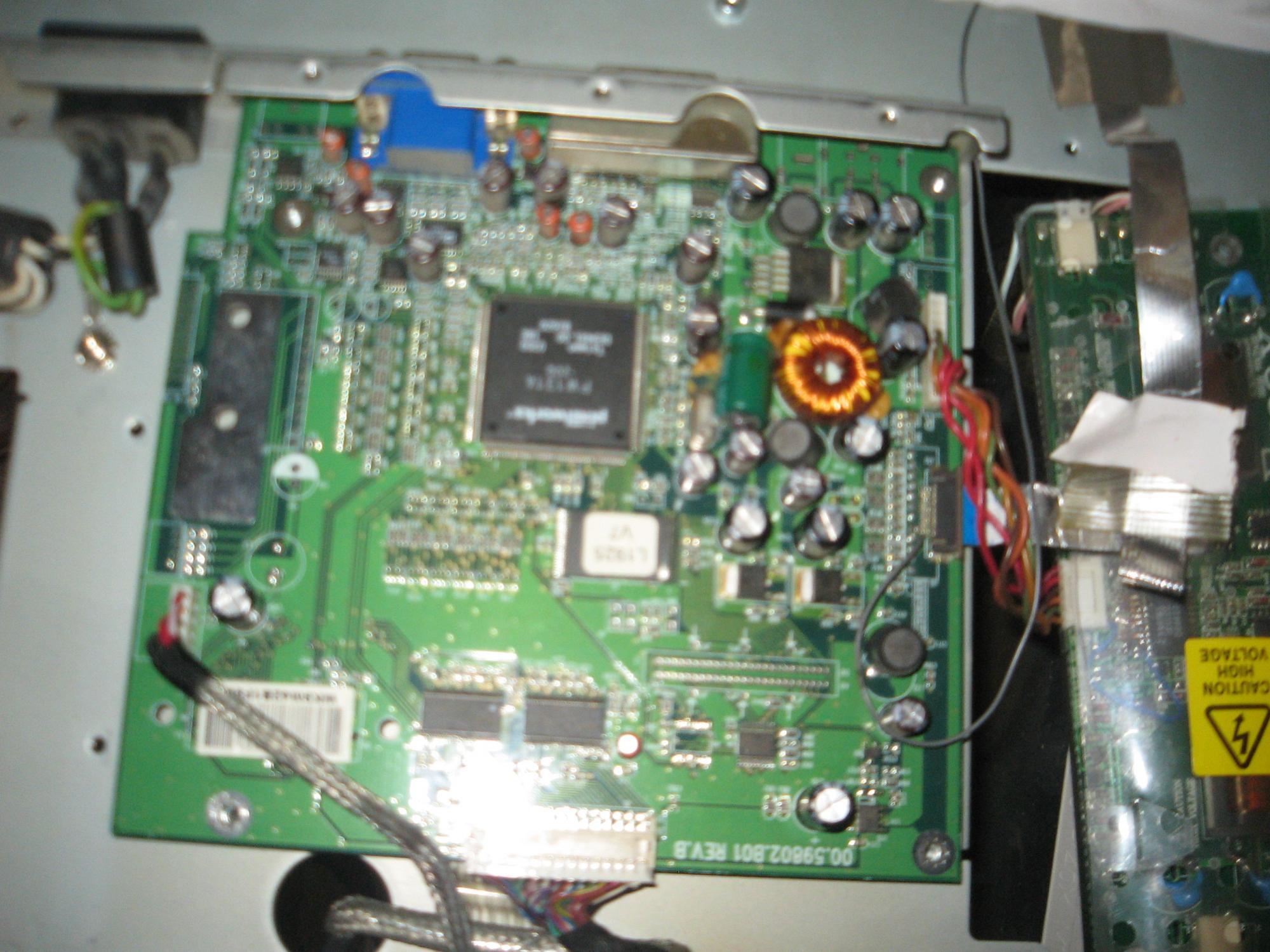

                                      Here is the inverter board.. hope this is the one.
                                      the thing is that the display is functioning... in the sense that i have seen image forming there.. but the pixels lack light...
                                        That the picture of the logic/video processor board, the inverter board is the one on the right of the picture, you can see the the lamp connectors with White and pink wires.
                                        There should be two transformers on that board and we need good clean pictures of both sides of the board, if the pictures are not in focus, we will not be able to see the pin outs of the inverter transformers.
