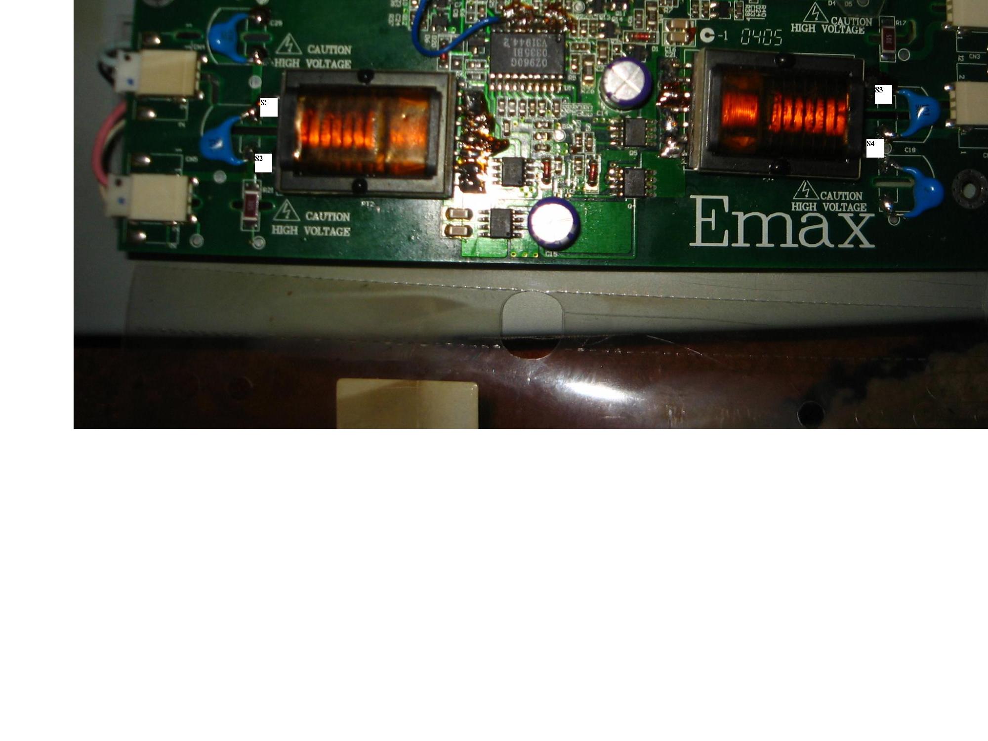

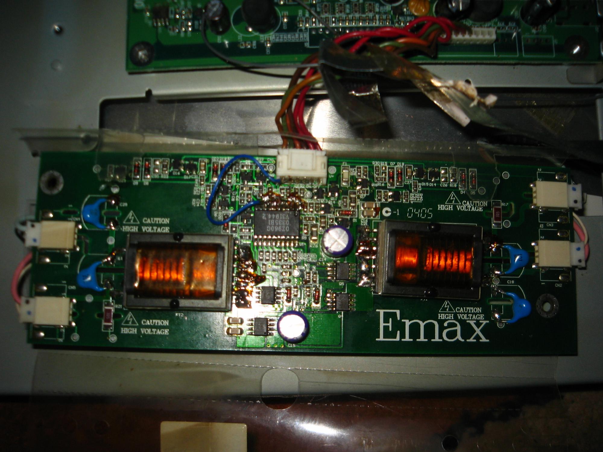

    Fine, I`ve took pictures from the inverter board now. it has been previously fixed.. or that`s how it looks.. the blue wire goes to pin no 3.
      Re: Hp L1925 lcd monitor black screen
      Well thats a bit of a mess can you clean any of it off with Isopropyl alcohol.
      Pins you need to check are S1>S2 and S3>S4
      Power OFF Meter on ohms 2000 - post results.

              Ok - it is fairly unusual for both transformers to be blown.
              Can you disconnect the inverter and take it outside and try to get some
              decent pictures of it - close up on the repair and the ends of the transformers where you are testing.
              Just as another test on your meter - in your picture of the power supply top left
              there is a big green resistor can you measure that and check with the colour bands if
              you get the correct resistance.

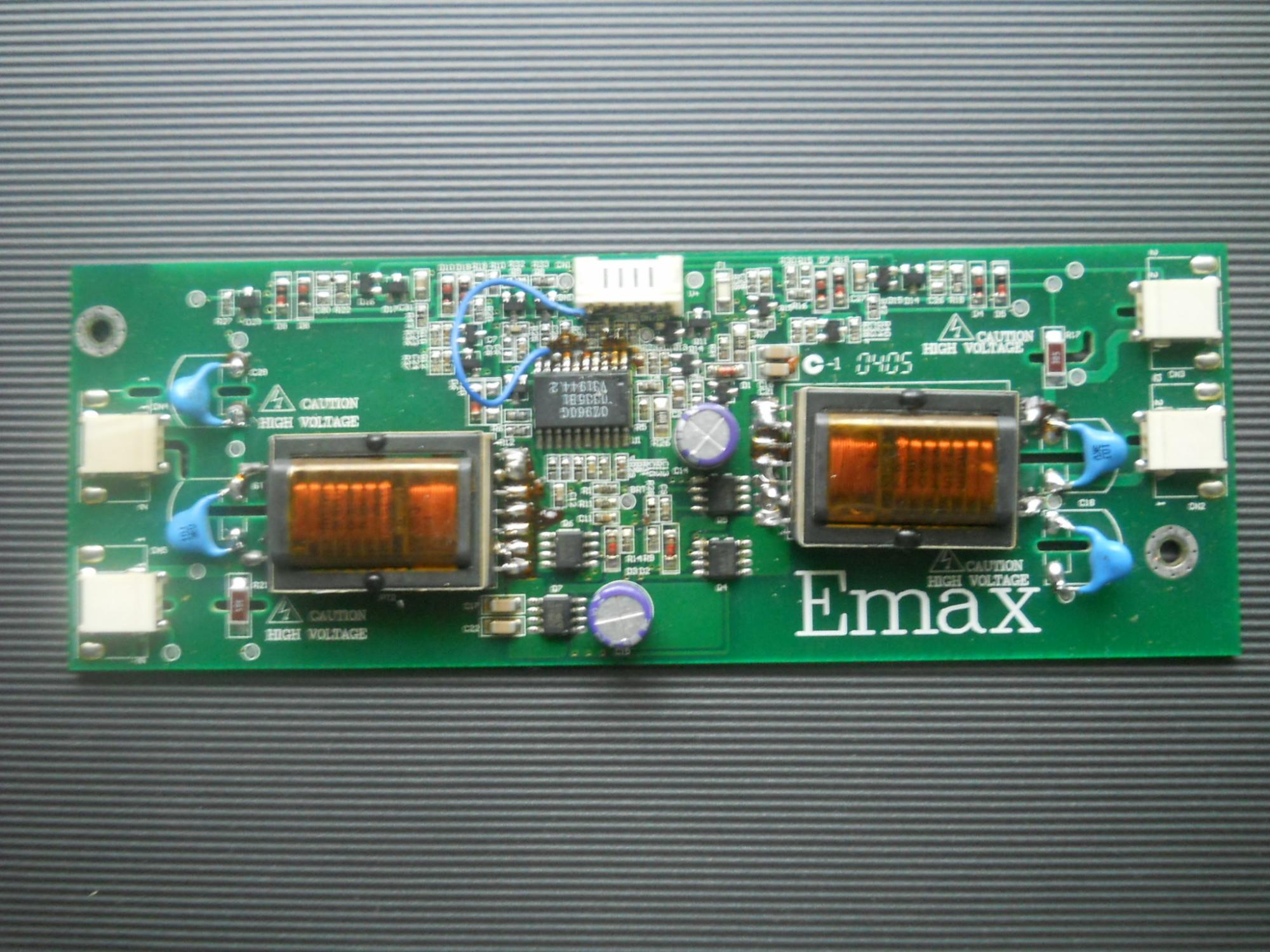

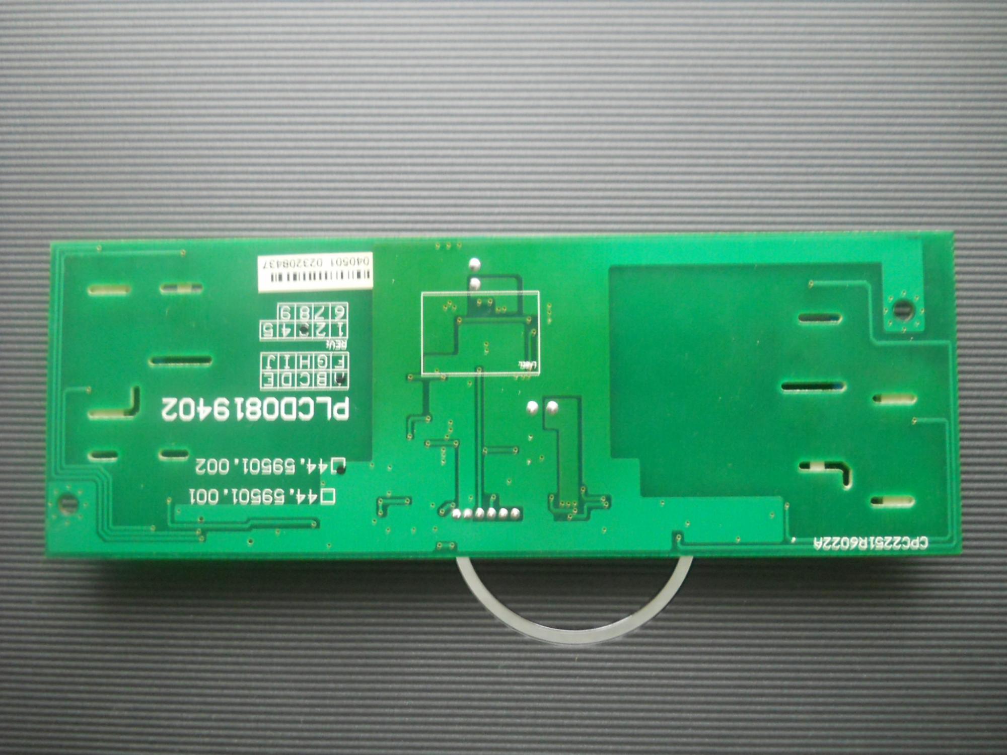

                      Here you go... the inverter board.

                        OK your meter is working correctly - try checking the transformers again.
                        you should be looking to get between 400 and 2000 ohms on the secondary
                        windings- if they are open then they are dead. - Have they got numbers written along the edges.

                                  Can you check the two brown resistors at each end of the Board One is R21 cant make out the other.
                                  Also can you check the repair using continuity from the pin in the socket to pin 3 (Use the pin not the solder) Also check it is not touching pin 2 or anything else.
                                  I dont know if It has been mentioned but there is a fuse on the inverter board as well - (see what a difference good pictures make) Can you test it- Ohms 20 probe on each end.
                                  Perhaps Budm will be back later and he might suggest where is best to do voltage checks on the board.
                                    #37
                                    If the backlight doesn't come on at all, not even a flicker or brief flash, it is either a blown fuse that selldoor mentioned or your mosfets (Q4, Q5, Q6, and Q7) are shorted.

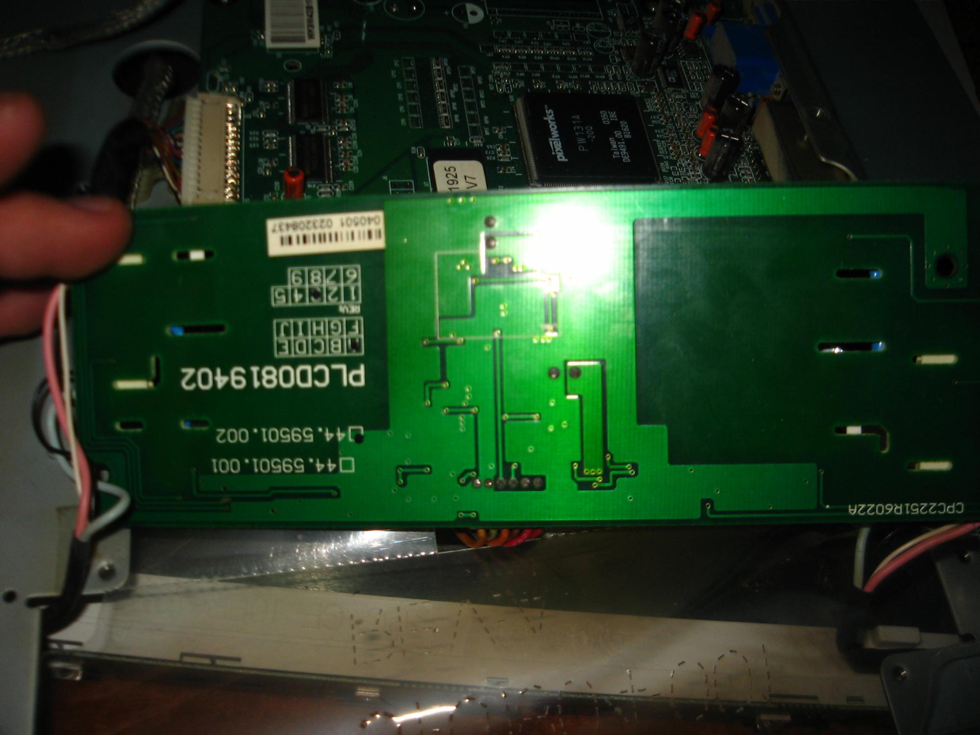

                                        Which one is it? can`t see it.
                                        Which is the mosfet?
                                          #40
                                          Attached Pic - What are the part numbers on the mosfets
