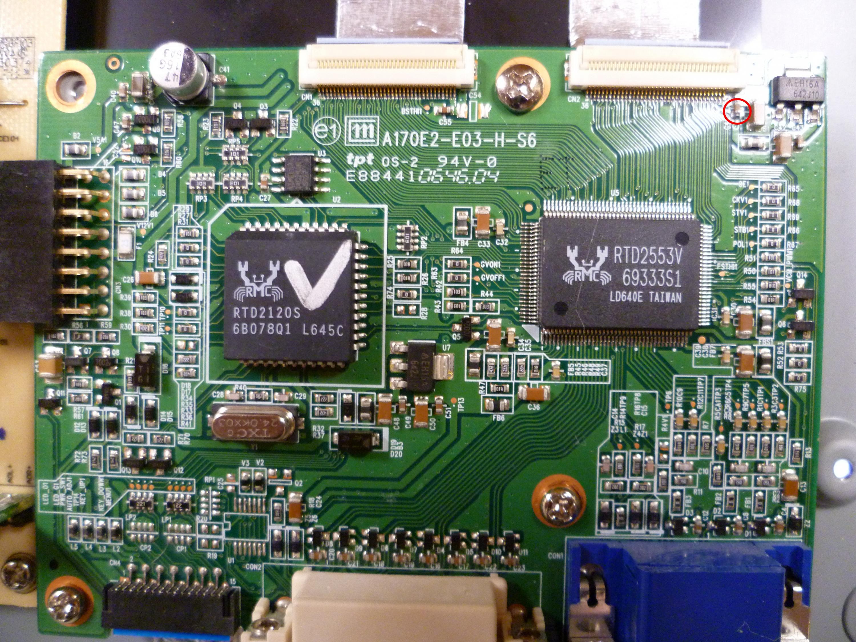

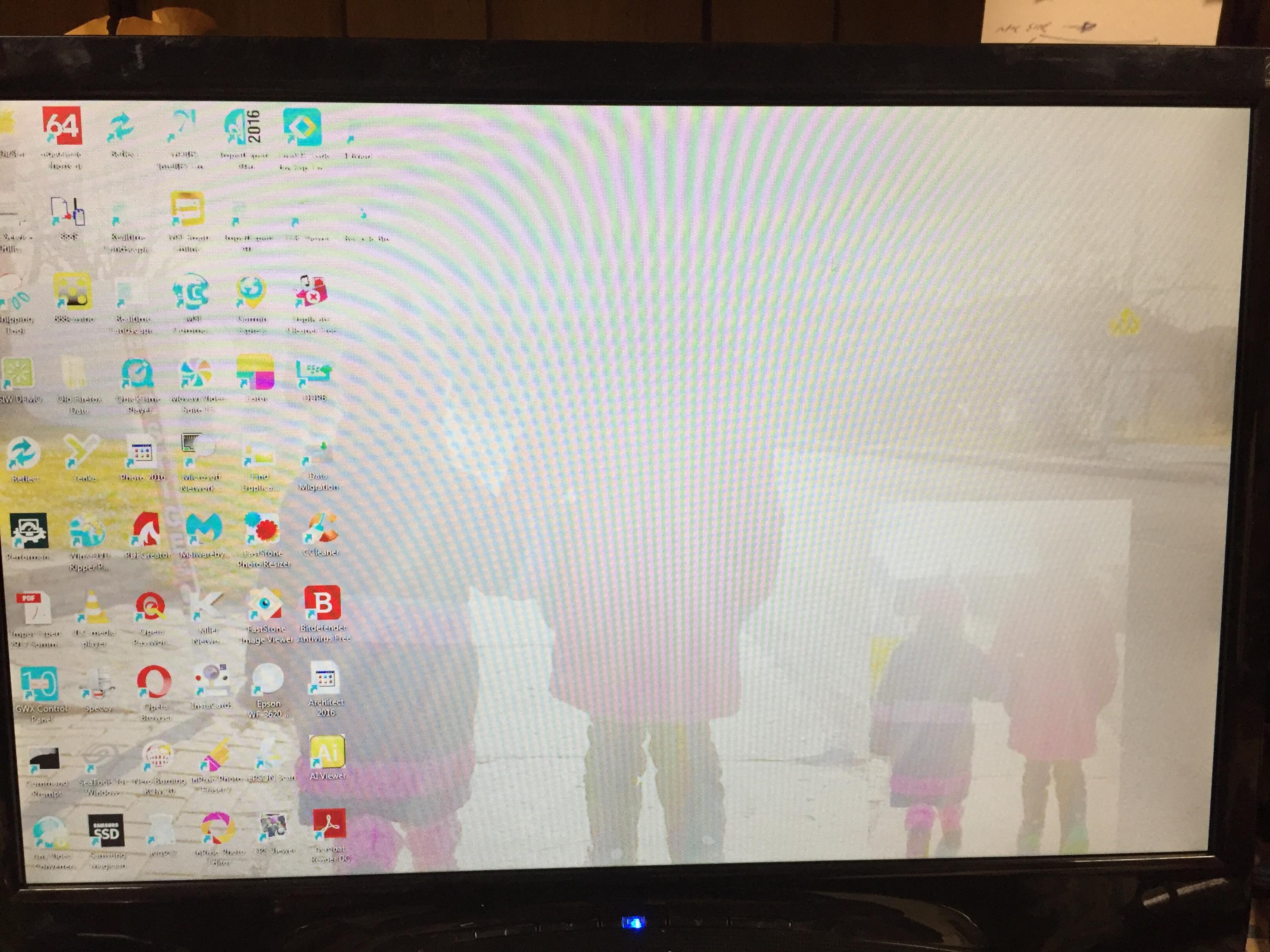

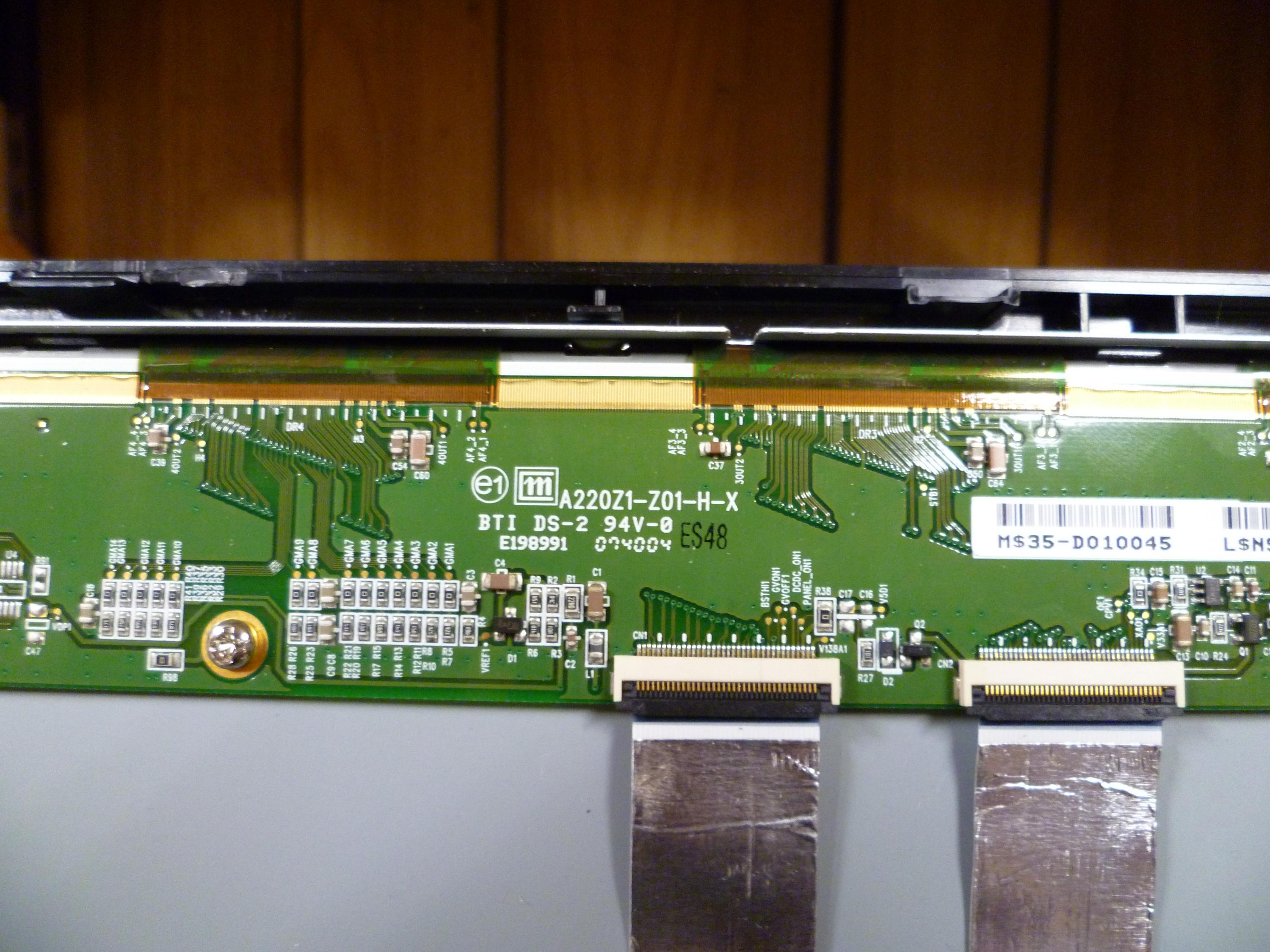

    I am experiencing a weird problem with my monitor in that after changing faulty caps on the power board (pictured) because my monitor was turning off , i reassembled and it power up but this time with the colors washed out when in Windows. I posted a picture of the actual monitor and the same image on my LG monitor for comparison purposes
    When opening up the menu, colors are fine it is only when entering into Windows.
    I read other posts and someone suggested to take the Voltage readings on the TCon board, here they are with monitor turned on:
    VDD - found AVDD1 12.80V
    AVDO - 23.42V
    VGH - 24.6V
    VGG - -6.98V
    I think they measure OK. I checked the ribbon cables (there are 2) each pin of both end of the connectors and I get a good connection - this was a long task!
    Also did a monitor reset which is Memory Recall on this monitor, nothing changed, still washed out display.
    So now, I really don't know where to look to get the vibrant colors I had. Any help would be greatly appreciated! Many thanks!

    It looks like the GAMMA ref Voltages are wrong.
    Check VGMA1~14 to see what you get.
    You did not touch the T-CON bd. at all, right?

      Re: Viewsonic vx2235wm colors washed out after power board recapping
      Hi Budm,

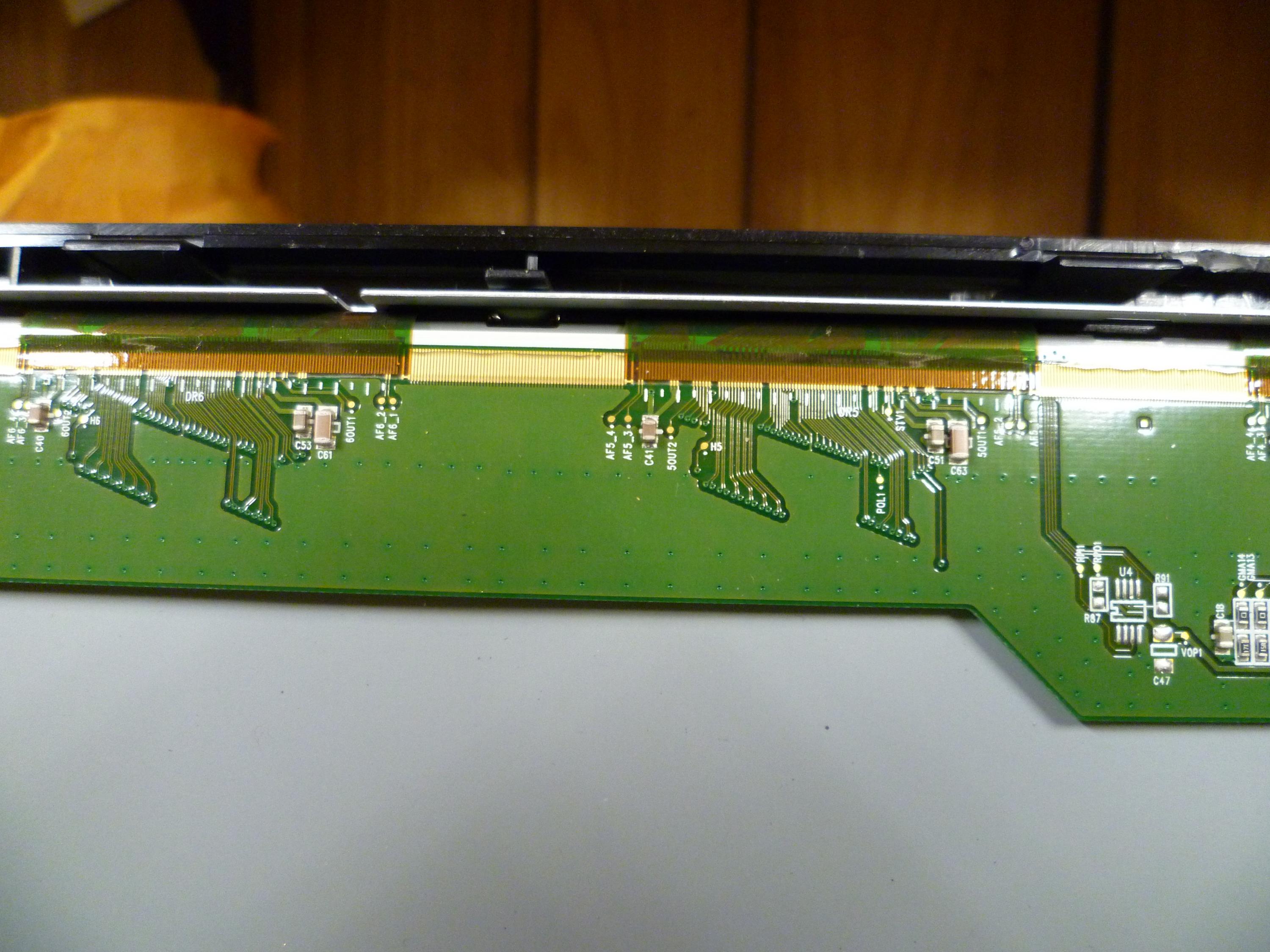

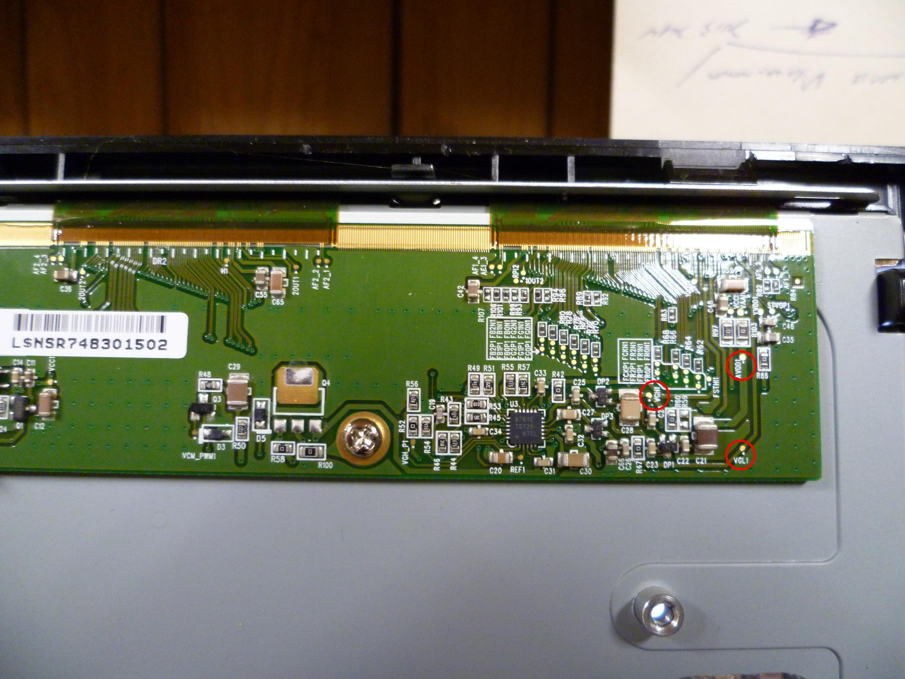

      Thank you so much for your reply! Ok, I think I might have taken these voltages wrong, not sure?
      I uploaded another copy of the right side of the TCON board to show where I measured voltages, as the labels were not exactly as mentioned in my post. Please bear with me I am a newbie in this area (I know a little electronics and can solder desolder pretty well, but that's about it).
      Now looking over my voltages:
      VDD - found AVDD1 12.80V - OK, this is good
      AVDO - 23.42V - I can't seem to find where I got this measurement?
      VGH - 24.6V - you can see circled VGH1 on the attached picture
      VGL - -6.98V - you can see circled VGL1 on attached picture - on original post, I made typo, not VGG but VGL.
      Can't seem to find VGMA1 - 14 anywhere on the TCON board - can you point it out for me?

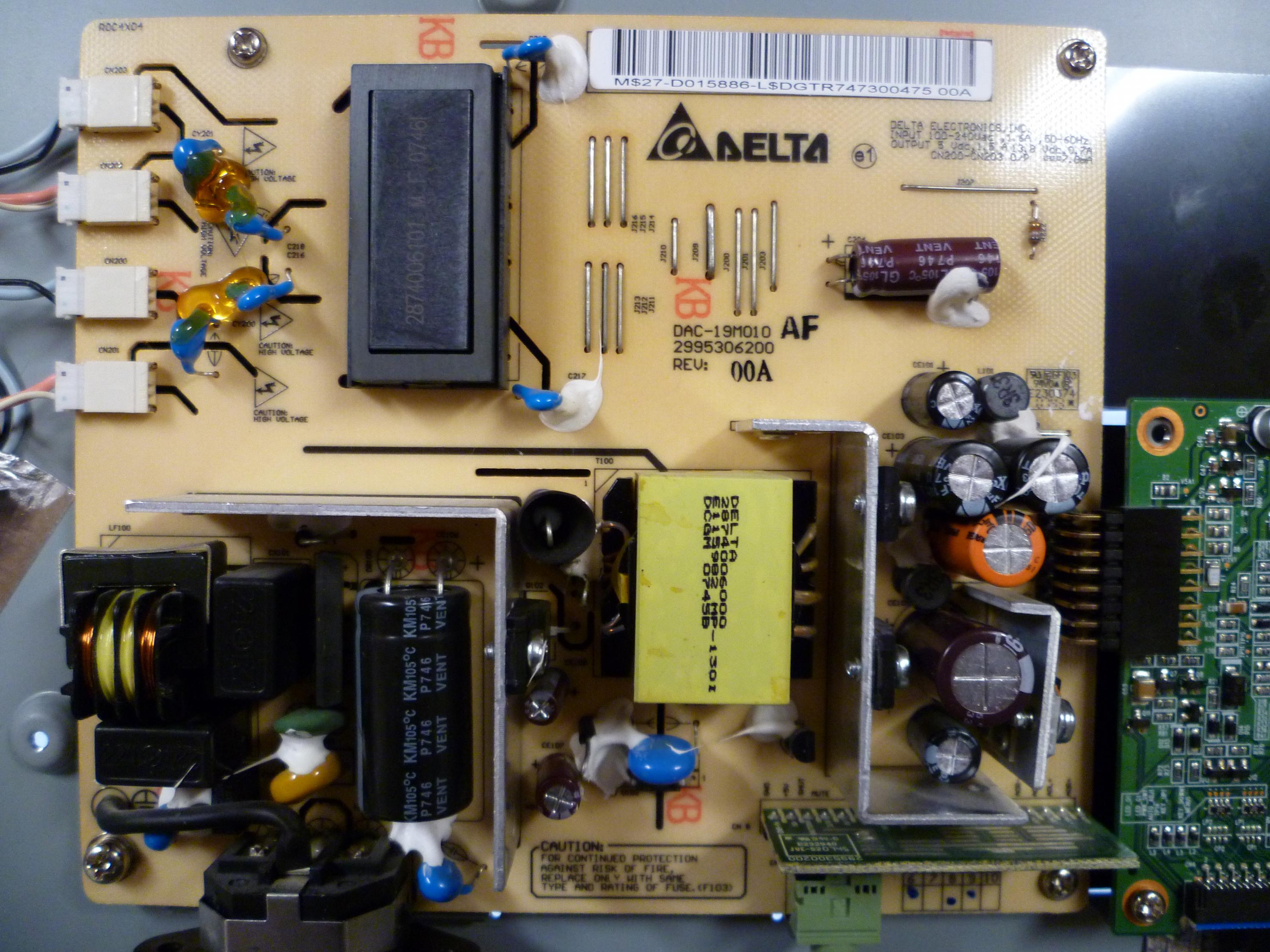

      Also, no I did not touch the TCON board, just the power supply board changed bulging CAPS and on the power supply board, when powered up, I get a clean 5.2V and 13.8 V.
      I should mention that when I powered it back on, it looked fine, but when I did a memory recall (which is factory reset) it came back with the washed out colours.
      One last thing when working on it, I noticed on the main board a ceramic cap which seem to have gotten loose (maybe because of opening the case). I resoldered it back to its place near the right connector. But only after it had given me the washed out colors, so I don't think it is related, but then again, what do I know.
      Many thanks for your help!
          Most likely test point AVDD1? Looks right to me anyways.
          Visible in the left center of this picture you uploaded:
          https://www.badcaps.net/forum/attach...9&d=1513655805
          Careful not to poke your eyes on them test points.
          By the way, what replacement capacitors did you end up using? I see a bright orange one on the PSU and I'm pretty sure that's not original. It also doesn't look like a known good Japanese brand to me. Hence the reason I ask. You should recap this with genuine Japanese low ESR capacitors from either Digikey, Mouser, or Badcaps.net store. Anything from eBay, Amazon, and Ali Express is very likely to be counterfeit or no-name Chinese junk. Slim chance that this is the reason for the washed-out colors, but still worth changing those caps just in case. Besides, your repair will actually last a very long time if you do use good quality Japanese caps. With cheap Chinese c[r]aps, you'd be doing this again in a year or two... if you're lucky.
            Sorry, they are labeled as 'GMA'

              Momaka, you are right I installed some spare caps I had from a junk box I had, but not before checking their capacitance and ESR (I have one of those multi function testers that measure caps) making sure they were good. The orange one is brand Sprague and the other is Nichicon.

                You have GMA1~14 that you need to report all the Voltages to see the pattern.

                  GMA1 11.56V
                  GMA2 10.86V
                  GMA3 8.98V
                  GMA4 8.57V
                  GMA5 8.28V
                  GMA6 7.65V
                  GMA7 6.43V
                  GMA8 6.13V
                  GMA9 4.93V
                  GMA10 4.16V
                  GMA11 3.75V
                  GMA12 3.21V
                  GMA13 1.24V
                  GMA14 0.122V
                  Tks!

                        Those voltages look ok, they should be like a ramp, which they are.

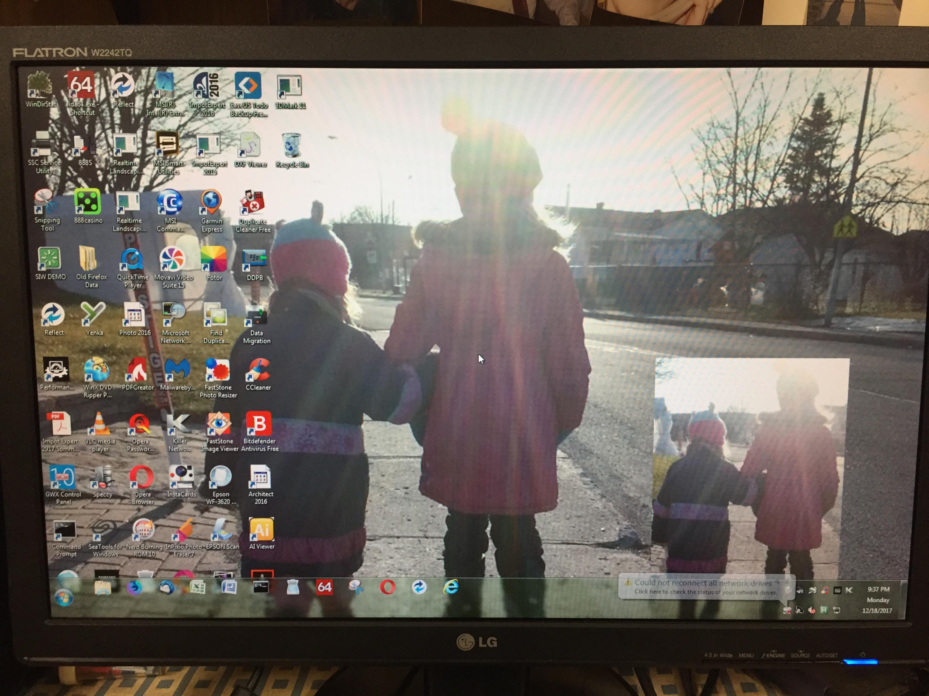

                                      I've been looking thoroughly through the forums and have not found a solution for a washed out display - seems that no one has been able to fix this type of problem? Should I toss this display out and buy another one, or someone thinks we could find (with a little help from my friends ) the problem?
                                        I just look at my PC NVIDIA Control panel, there is GAMMA setting that if I set it to Max (2.8) my pictures will be washed out.
                                        Did you try your PC with other monitor yet?
