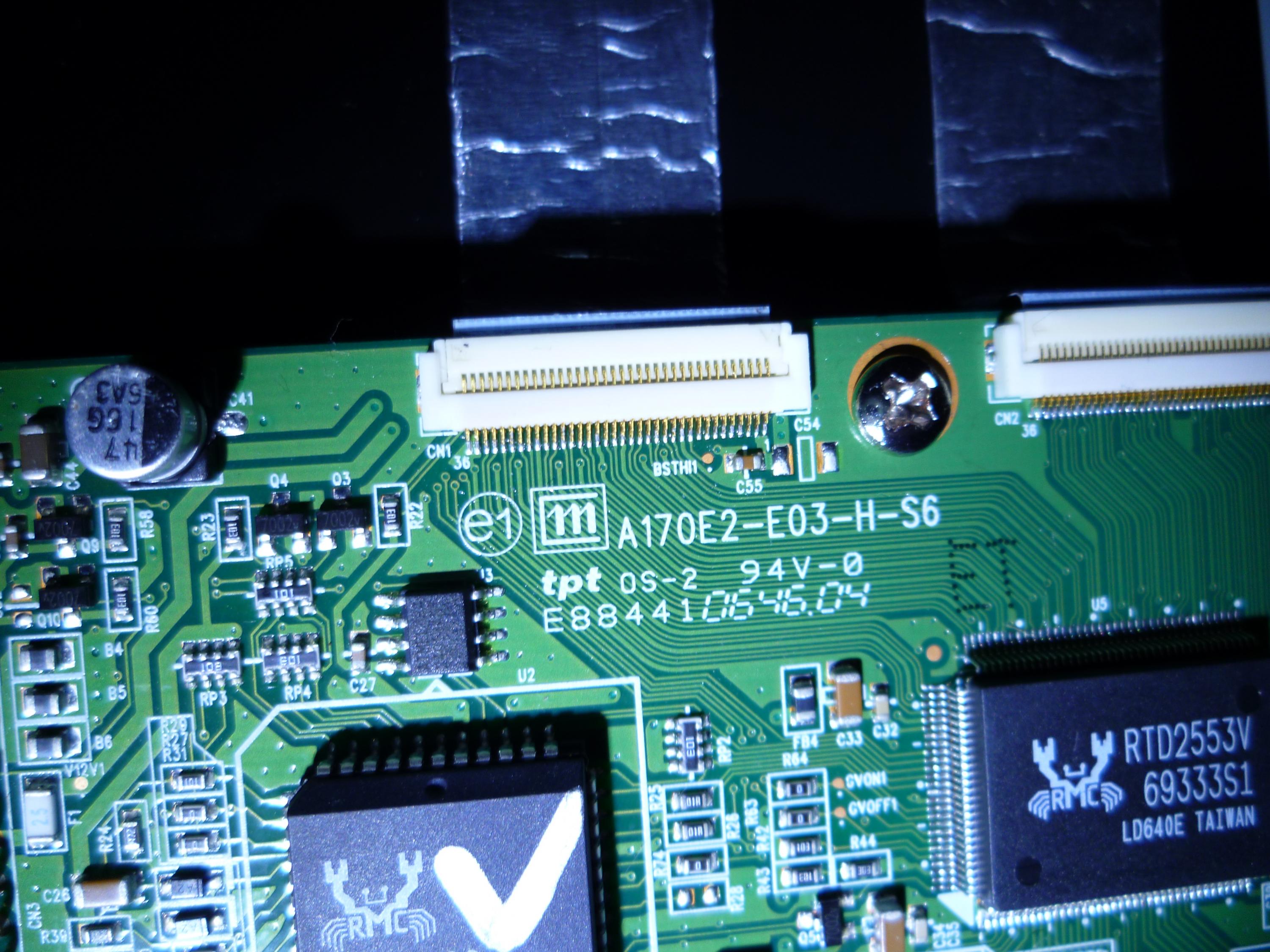

                    I took some close up photos of the connector I passed my finger along (the one on the left in the second photo) in case someone with professional eyes sees something.
                    I have a feeling there is something wrong with one of the cables (the left one). Where it is inserted, the connector has made a marking on the cable end. Looking with a magnifier, I can see a small aligned dent on each connection. Should I shave off (cut a 3mm edge) the end of the cable so that the connector would sit on a fresh piece of connections or is that a no no? They are 36 pin 125mm FFC cables that sell in China, but that would take weeks if not months to get new ones, and I'm not sure they would be the right quality. The original cables are sold on Viewsonic's website, but they are out of stock

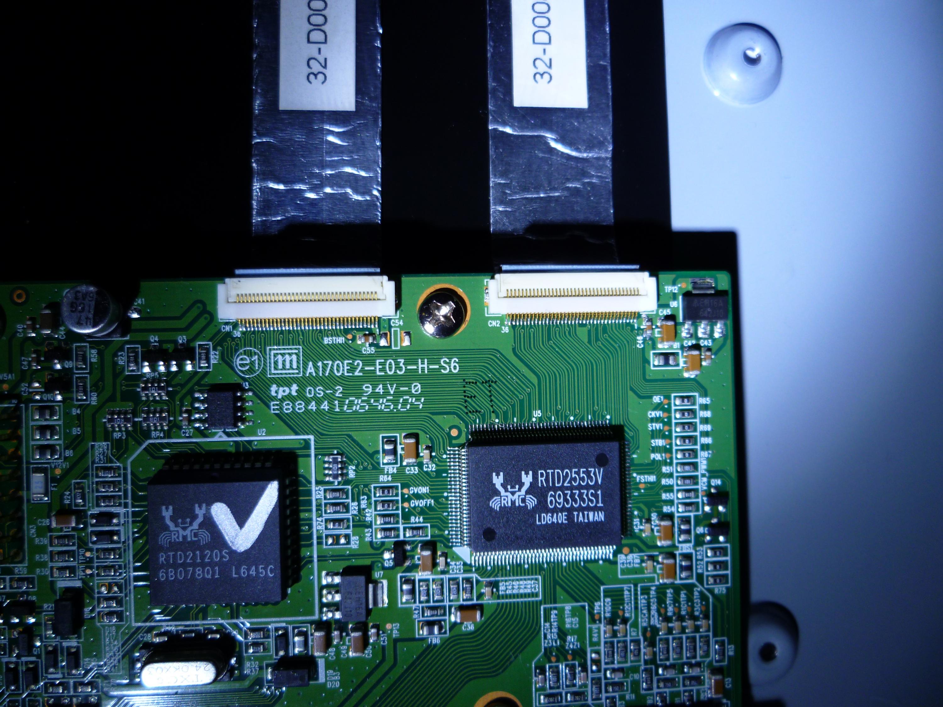

                              Continued to do voltage checking on the 2 voltage regulators U7 and U6. (see photo 4, U7 is in the middle and U7 is on the top right.
                              U6 input is 5.05V and output is 3.38V. That looks good.
                              U7 input is 4.6V and output is 3.3V. I was wondering why I only had 4.6V on input so I traced it back to diode D20. On one side I have 4.6V and on the other side I have 5.03V. Is that normal?
                                  Yes, those voltages are absolutely okay. Good that you checked them though. Same with the small cap. Slowly we are closing on all of the things that could be causing problems.
                                  Yes, that's normal.
                                  All diodes have a voltage drop when current flows from their Anode to Cathode. This voltage drop can be anywhere between 200 mV and 1.2 V (1200 mV) - it all depends on the type of diode. Schottky diodes usually have low voltage drop between 200-600 mV, and regular diodes between 400 mV to 1.2V.
                                  So what you are seeing there is normal.
                                  Unfortunately, I don't see anything wrong with the connectors either.

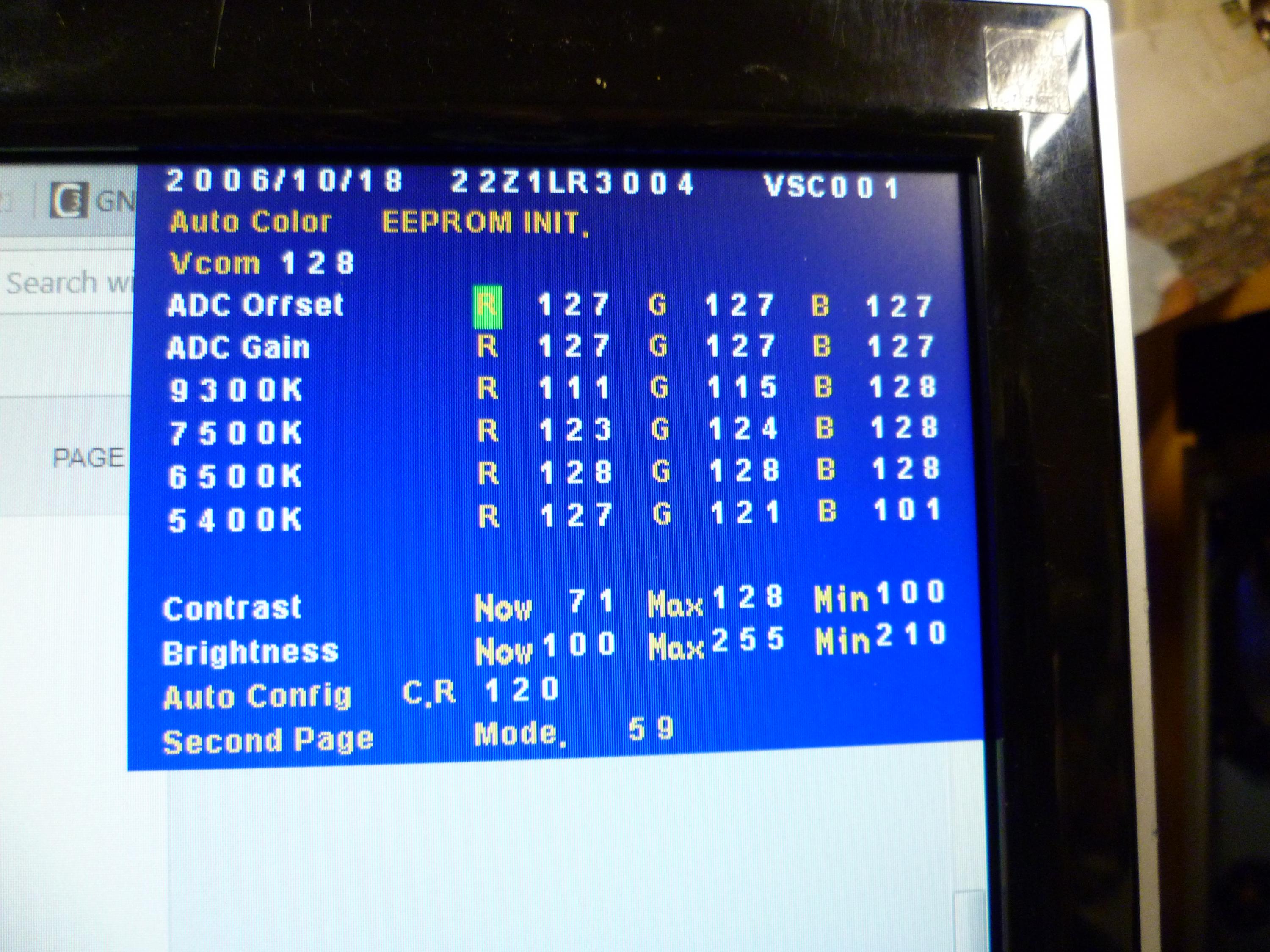

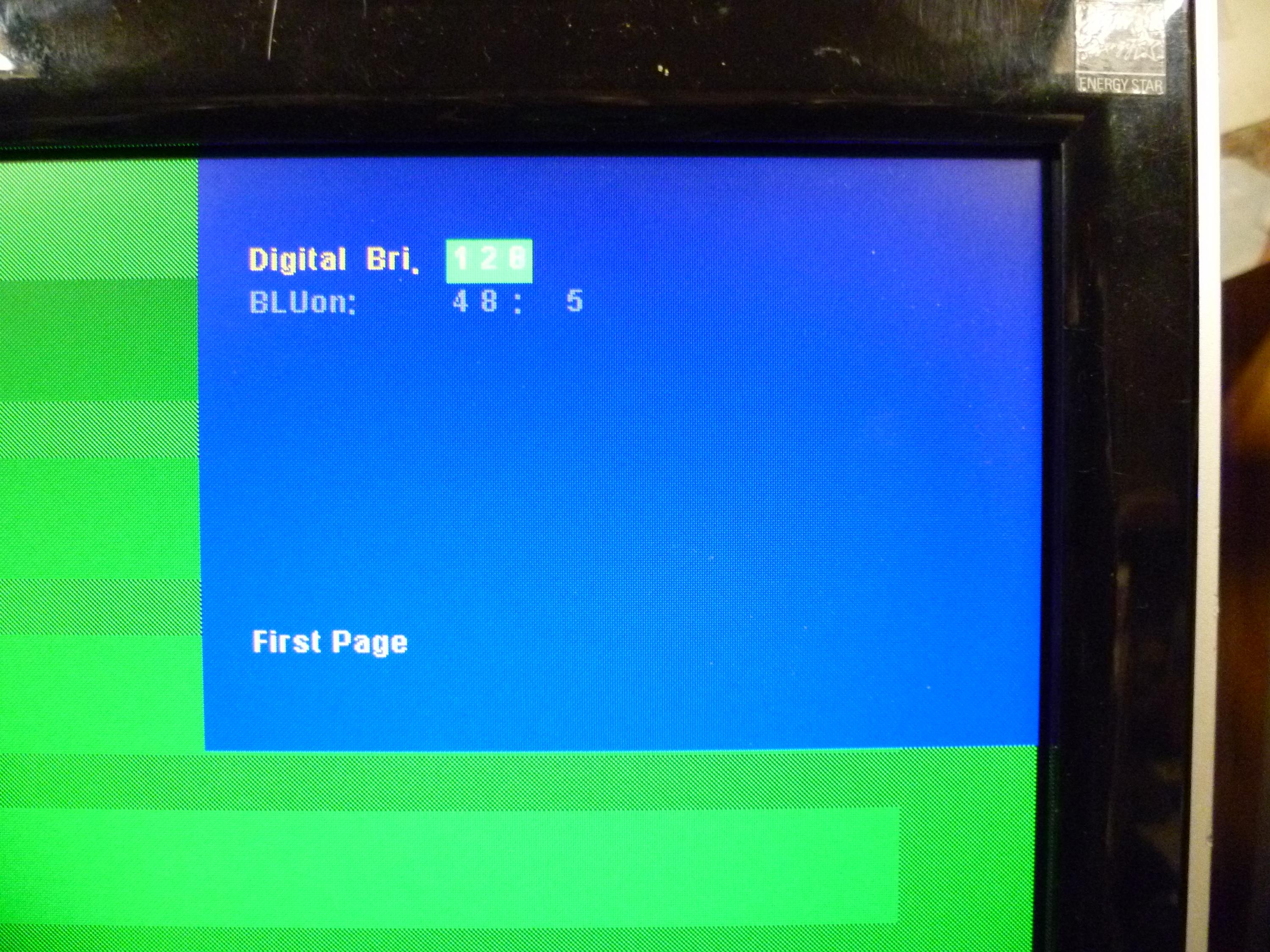

                                        You won't believe this! I decided to reinstall the monitor. Reading through the service manual, I noticed a key combination to call up factory settings. Tried the key combination as per the manual, but it wouldn't work..it says to hold the power button, up arrow and down arrow simultaneously. Tried many times but did not work.
                                        Then I decide to try other key combinations and at some point (I think I was holding the menu button and the up arrow), a factory screen came up! There were lots of adjustments but by luck I decided to fiddle around with a VCOM setting that was at 255. I lowered it and the screen improved...right around the 128 level was the peak best screem so I pressed menu again and the factory screen disappeared and the monitor was back to normal!

                                          Succeeded in calling up that factory menu again. Here's how:
                                          5.3.5 Factory Mode Introduction
                                          When input the signal, press "power key" to turn off the monitor. Press" [▼] +[▲] +[ ] "at the same time so as to enter factory mode. After power on, press ''Menu[1]'' key, you can see the Factory menu
                                          Attached are photos of this secret factory mode for anyone who has the same problem I had. There is page 1 and page 2 - page 2 I took 2 photos so to show what the selection was.
                                          You can see on the first menu Vcom is what I changed...initially it was at 255 and brought it down to 128 and bingo, that did it. Wonder what all those other settings are for?
                                          Many thanks to all of you and especially Momaka for helping me out in this super adventure!
