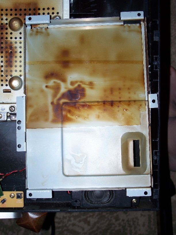

    I have a Hanns G 19" inch monitor i bought it second hand form a car boot. When I got the monitor home I plugged it in and the monitor worked for about 5 mins. Then it went blank. So I turned the monitor off and on and it then work for about 30 secs and then went blank again. So I took the monitor apart and saw that the power supply looked like it had got very hot as the metal around it was brown. I don't know if this is normal in a monitor. The power supply is 200-000-170DTL1 Version:A+. Also I have noticed that the 220uf 25 v capacitor is gone. What should I do, should I change the capacitor?

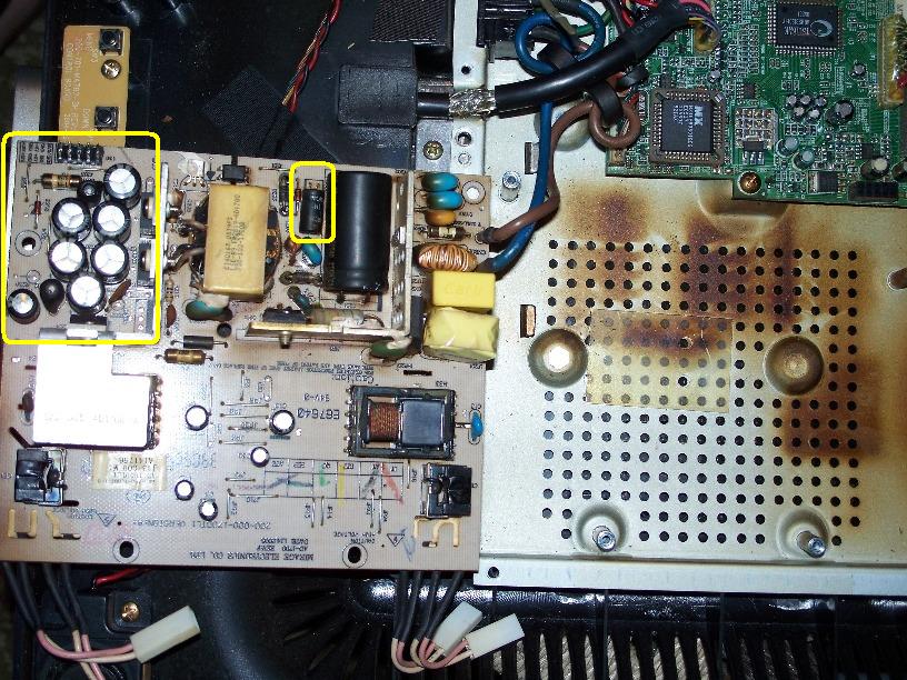

    Re: Hanns-G 19" turns off. PSU overheated and bad caps
    That Mirage PSUs tend to run hot, or so I've heard around here in the forums.
    I have a bad experience with one of those in a Proview 700P (Sylvania CL-722). You should change the bank of caps in the yellow marked areas as a first step. They will be Teapo, Elite or CapXon, if not worse.
        Looks to me like a combination of heat and cigarette smoke, does it smell of nicotine?
        • kc8adu
          • Nov 2003
          • 8832
          • U.S.A!
          looks like someones ashtray filter.
          recap it.
          then wash your hands.
          that thing would need a bath before i could tolerate it in my home.
          yechhh.

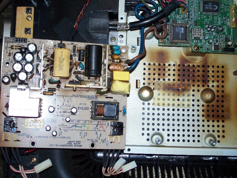

                Also the big 400 v 100uf cap looks like it has been very hot as the borad under it has gone browner with the heat. Should I replace it?
                    Man the heatsink design on the PSU must be horrid in order to cause visible signs like that.
                    From your pics the hot offenders look like the main switching transformer, the heatsink over the HV inverter transformer (an extremely stupid move IMO), and the switching FET heatsink.
                    The inverter transformers are already working at high voltage and high frequency you don't need to be throwing any more heat out at them. Not to mention the extra stress that this heat is putting on the winding insulation.
                    The secondary cap bank looks to be generating the least heat out of all three due to the lighter color.
                    Even if none of them look bulged any bad cap would be toasted in this heat. The tiny cap towards the front left in your pic looks bulged from the pic.
                    Panny FCs all the way on this one if they can't survive here no cap can.
