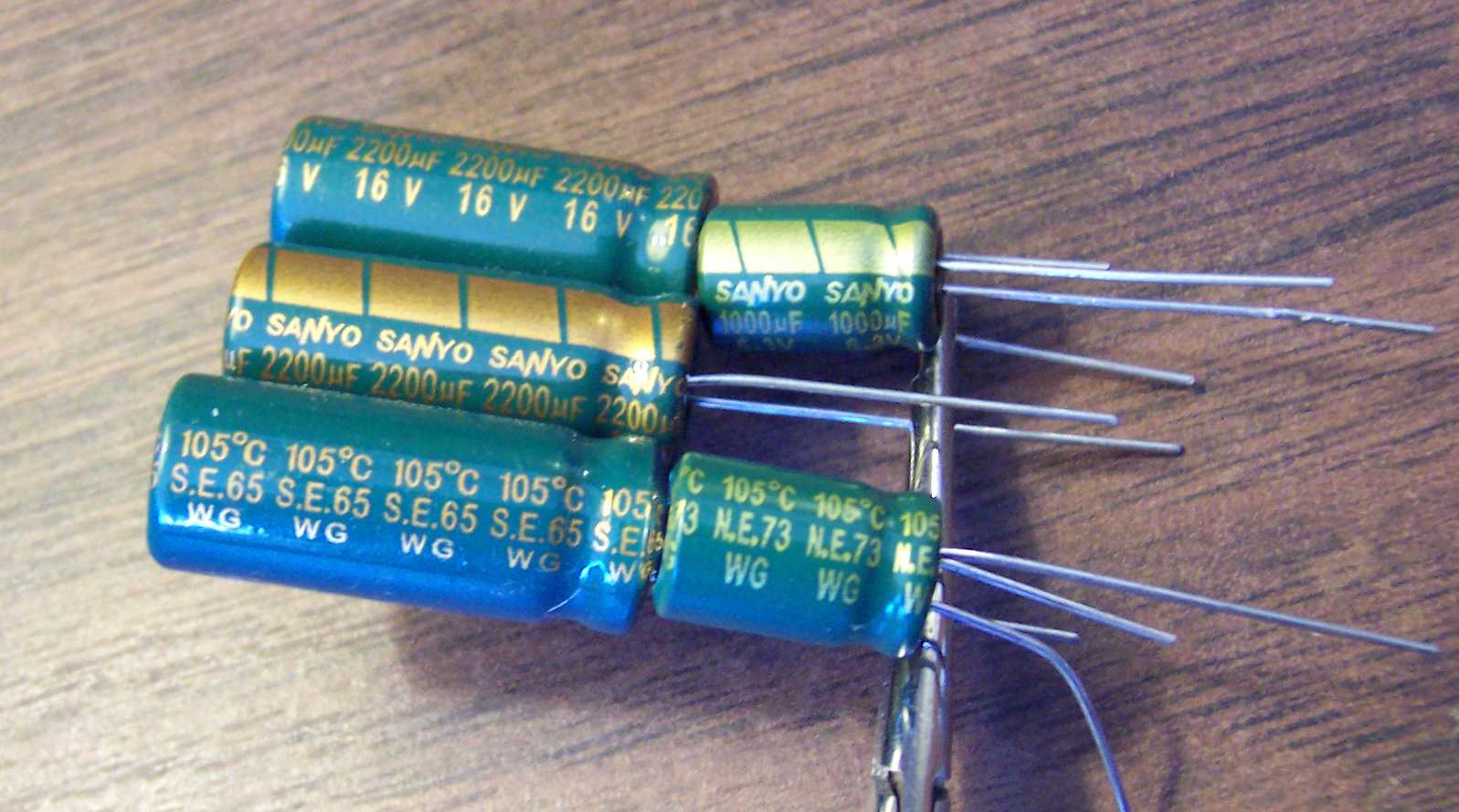

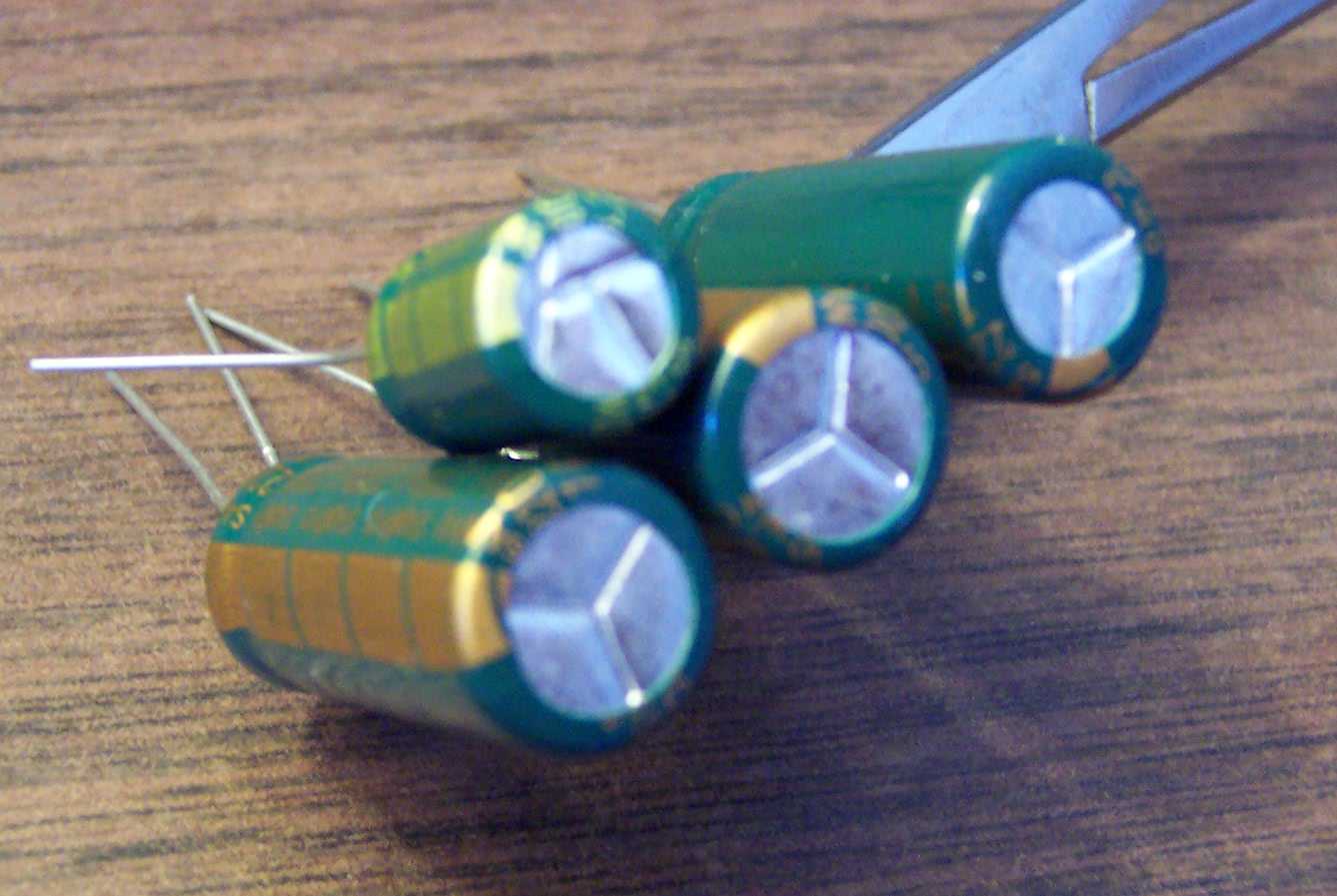

            Originally posted by PCBONEZ
            -> No
            Look for:
            Rubycon, Panasonic, Sanyo, Chemicon, Nichicon, Elna, Hitano, NIC Components.
            There are several dealers on eBay that sell counterfeit caps.
            Counterfeit Sanyo, Chemicon, and Rubycon are not uncommon.
            The dealer Scenic suggested is mostly a good source.
            I have bought there a few times.
            They do sell some crap brands but they don't hide the brand's name in the ad.
            They may have some Sanyo fakes and not know it. It's very hard to tell in ad photos.
            Fake Sanyo:
            [Color applies to WG series only]:
            The gold color is too dark and too solid. [But probably can't tell in photos.]
            - Real Sanyo WG have a lighter gold color and a 'washed out' looking gold stripe.
            Real Sanyo have a K shaped vent stamp but not the same K as Rubycon's.
            The "V" standing for voltage is the same height as the numbers on real Sanyos.
            On the fakes the V is shorter than the numbers.
            These came from eBay.
            I suspected the 2200uF were fakes so I sent samples to Sanyo for testing.
            I was right.
            The 2200uF in the photos are fake. The 1000uF is legit.
            (Note color, The 'V' next to 16, and the vent shape.)
            Seller is still selling these caps but he rubbed the Sanyo markings off.
            Doesn't state a manufacturer in the ad anymore at all.

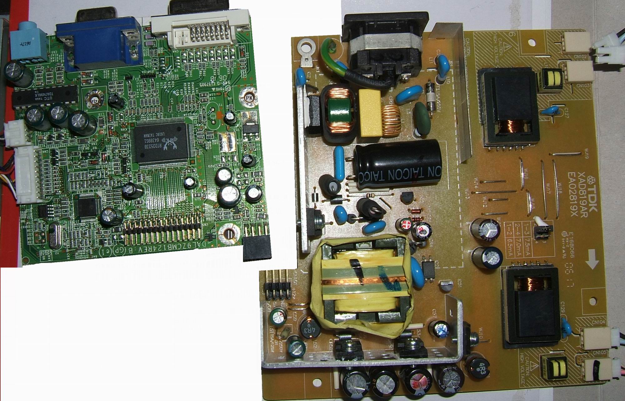

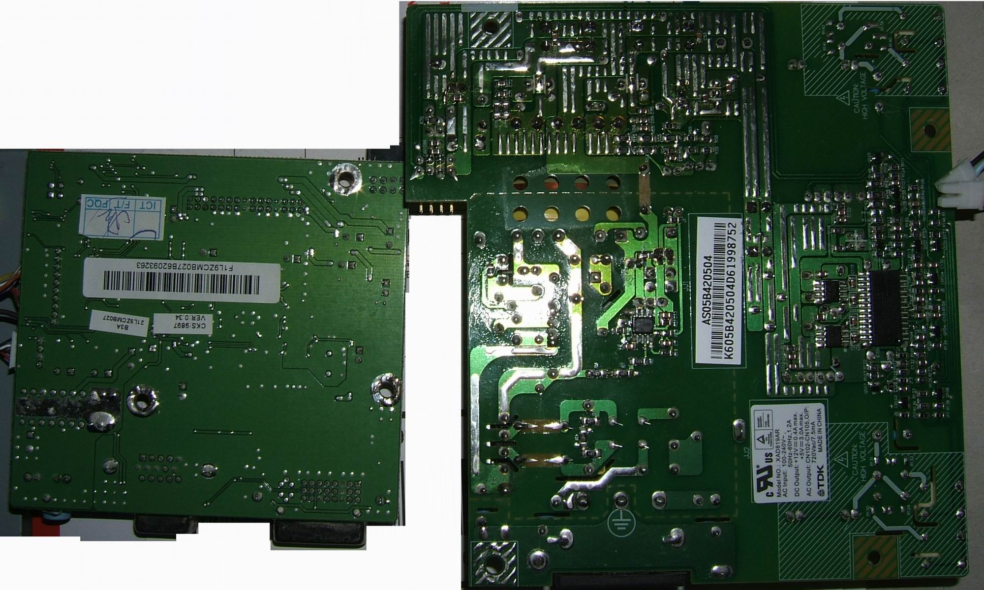

                                  Re: Hanns-G 19" turns off. PSU overheated and bad caps
                                  Hanns-G HC194D
                                  Panel: HSD190ME12-A10
                                  Panel Driver: 6P18V00013 A2 6032100A01
                                  Power Supply: TDK XAD819AR EA02819X MP1038EY BE6C16 SG6841SZ K3562 AS05B420504
                                  Inverter Transformer: 19LES-X65
                                  Video Board: DAL9ZCMB124 DAL9ZCMB124REV:B B3A-21L9ZCMB027 RTD2523B MTV512GMG TDA7496LK
                                  Bad CapXon GF caps in power supply
                                  C102,C101 220uf 25v
                                  C52, C51: 470uf 25v
                                  C54, C56: 1000uf 10v
                                  C57, C62: 100uf 25v
                                  C59: 100uf 10v
                                  Resolder transformer T1
                                  I bought one and bought two more 6 months later. All 3 have the same CapXon caps. The first one hasn't blown a single cap. The two later ones 10 serial numbers apart died.
                                  These often hiss before dying completely. Fortunately no bad inverter transformers in the mix. A few caps and a little solder and they are up for another round.
                                  This power supply has an adjustable current sense.
                                  sig files are for morons
