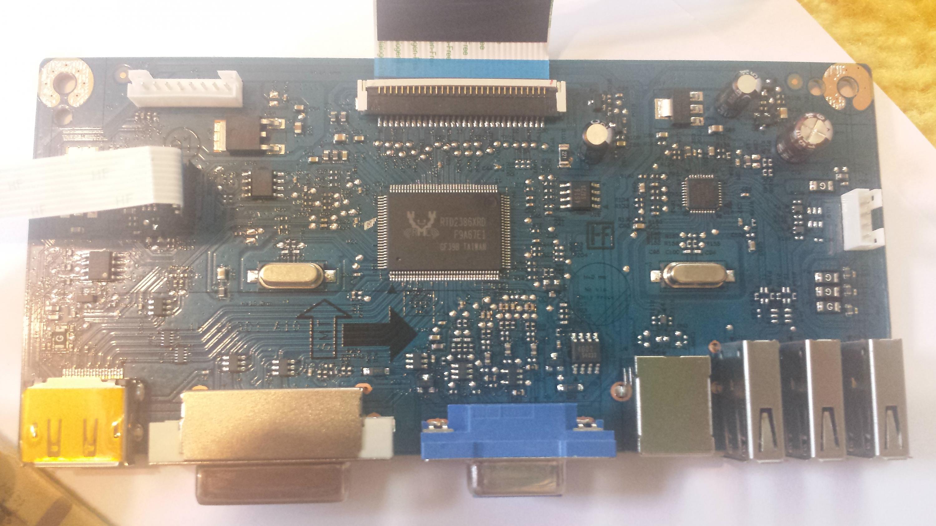

    Hi guys! Title says it all. My Dell monitor will not turn on. No LED lights, no nothin. All of the caps look good, no bulging at all. No cracks in the solder joints, although one joint looks a little rough. Any ideas? I don't know much about this stuff (obviously), however, I am fairly good at soldering. Figured I'll give it a shot fixing it. After all, it's not like I can break it I am limited to a multimeter when it comes to testing. Also, I can get better pictures upon request. Thanks, fellas!
    Monitor is a Dell P2214H
    Photos:
    https://ibb.co/eBVqh5
    https://ibb.co/n4Z5FQ

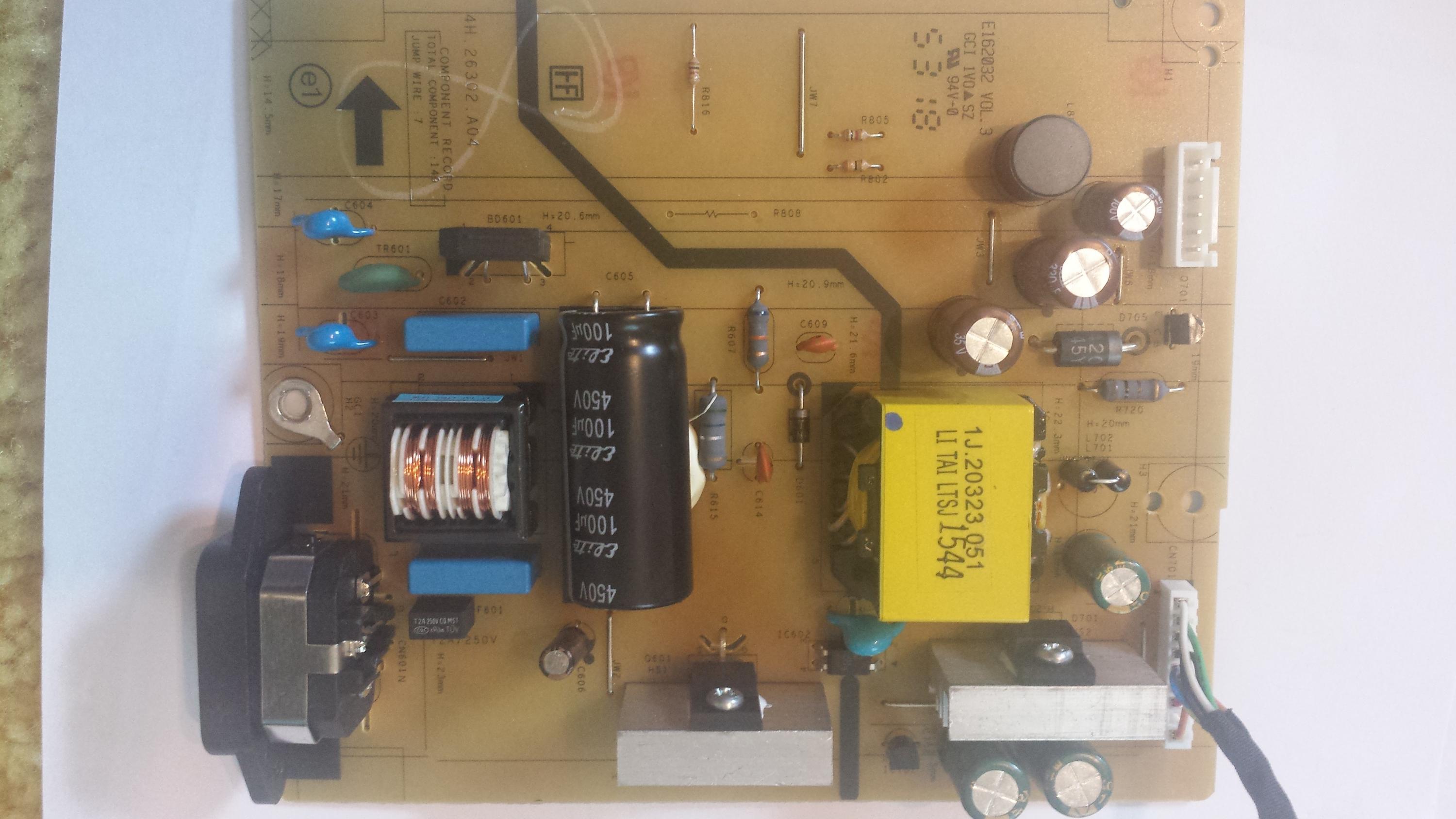

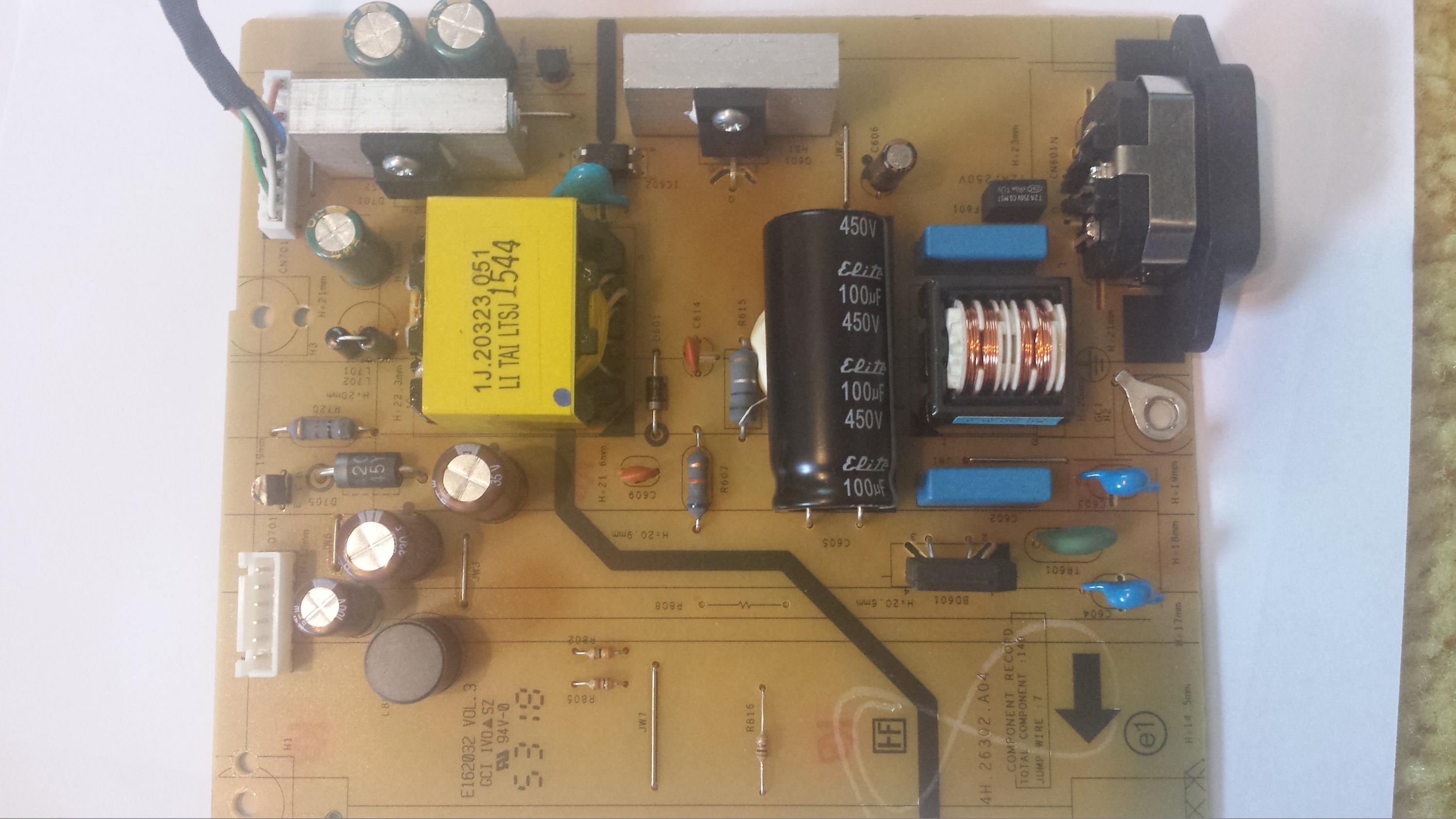

    What should the DC voltage be on this cap?
    This board came out of a monitor that won't turn on. The large cap in the picture says 450v, but when I check it with a multimeter while the board is plugged in I'm getting 160ish volts DC. Could this be the issue?
    I'm no guru with this stuff, I just figured if the cap says 450v, then it's strange I'm reading 160v. But maybe I'm wrong. Teach me something
    https://ibb.co/hwnzc5

      Re: What should the DC voltage be on this cap?
      Modern switching power supply use Active Power Factor Correction circuits which boost 90v..250v AC to 400..420v DC for better operation.
      In this case either the APFC circuit isn't working or it doesn't exist. You have 110v AC coming in, going in the bridge rectifier resulting in DC voltage with a peak of sqrt(2) x 110v = ~ 155v
      If your PSU has no pfc, then probably they kept the capacitor with such high rating in case the monitor was going to be sold in countries with 230v AC at the socket (those would have ~ 330v DC max... so any cap rated for more than 330v+~10% would do... and 420 or 450v rated capacitors are common and suitable for this.

        Depends on the PSU. This one looks like it's a non-PFC autodetect PSU, maybe a 384x design. The input needs to be able to deal with 120V and 220VAC mains, so the capacitor voltage needs to be able to handle both. While 120VAC is 160-170V, the 220V input would produce 320-340V which the 450V cap will handle.

          It appears to be 4H.0EH02.A04
          170VDC is what I would expect on the cap, there is no active-PFC.

              This power supply doesn't have PFC - no PFC inductor, only one transistor/MOSFET on the primary side. Going a step farther, it looks like a flyback design, since there is no output inductor. Finally, unless there's a SMT PWM IC on the underside of the PCB, I'd guess this is a self-oscillating flyback design.
              Since the OP is from the US, the ~160V across the input cap is correct, and means the input fuse is OK. That means the switch transistor/MOSFET is not shorted. If there's no output (especially if there is a clicking sound when it's powered on?), I'd look for shorts on the output side.

                    If it does nothing at all, you may have an open-circuit startup resistor

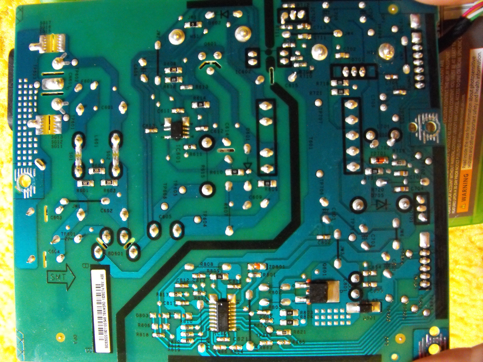

                      A picture of the underside of the power supply, if there are SMT components there might be helpful.

                        change c606

                          So are you getting any DC outputs on the connector at all (you did not indicate what DCV you are getting on those two output connectors)? It is just simple always on power supply (no PFC) with two outputs (one rectifier on the heatsink, and one axial-lead rectifier).
                          https://cdn.badcaps-static.com/pdfs/...ea2905eb95.pdf
                          It will work with incoming Voltage range from 100VAC ~ 240VAC, thus the 450VDC cap is being used.
                          Page 12:
                          AC input voltage/frequency/current: 100 VAC to 240 VAC / 50 Hz or 60 Hz + 3 Hz / 1.2 A (typical).

                            Whether self-oscillating or in the start-up circuit for a 384x PWM IC that would be a suspect.
                                  Here you go
                                    Re: Dell P2214H monitor is dead, not turning on.. Caps look good
                                    So 0VDC on the connectors.
                                    Try heating up C606 (or just replace it as suggested by STJ) with hair dryer for a minute and then power up the board to see if you will get any DCV on those two connectors.
