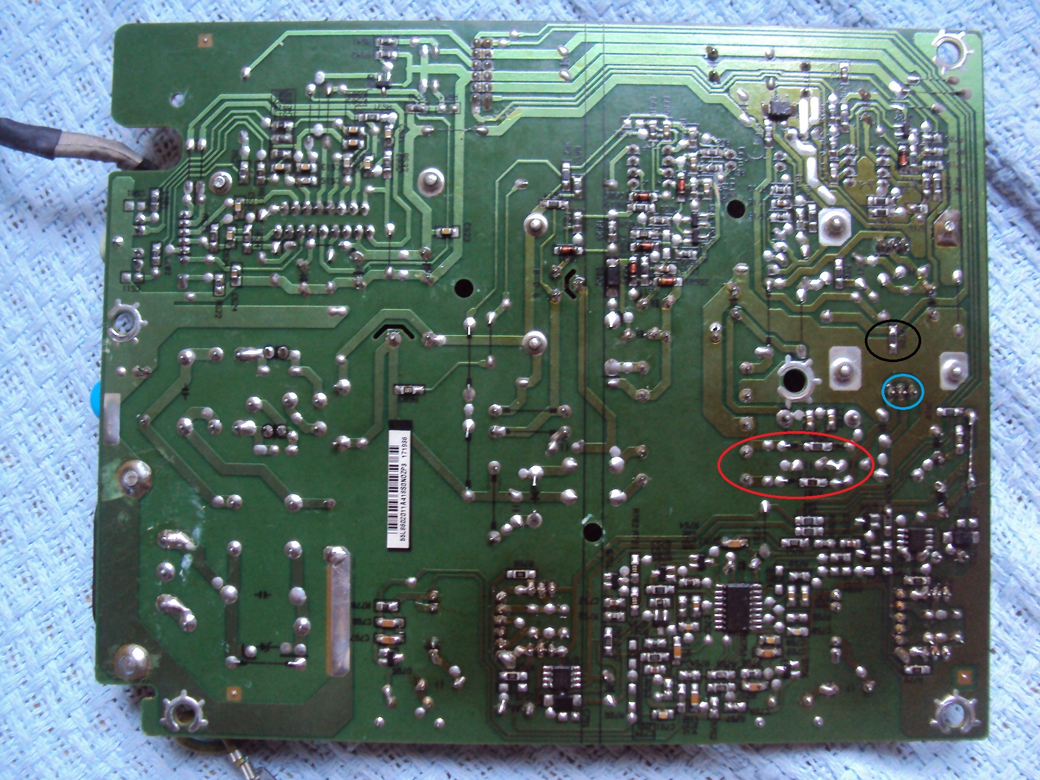

            Re: HP monitor clicking
            Originally posted by budm
            I wonder what the B is for, it's showing around 300 Ohms compared to A and C.
            Turns out that is OK, there is an SMD resistor between that rail and GND labeled 331. I circled that resistor in black.
            I did more examining on the power board, and found out this:
            The rails circled in red are shorted between them. One goes through big diode, and I traced the other to side pins of the regulator circled in blue. ( I think GND).
            However, if I desolder those two corresponding transformator legs, there is no more short between rails, but trafo legs are still shorted.
            I don't know if those trafo legs should be shorted, but my guess is NO, which would leave us with a shorted secondary.
            stay classy
              Transformer DCR will be very very low, it is normal. If the transformer was bad then you will not have any DCV on the secondary side when the main board is not connected to the power supply board.
              The part circle in blue is the Common Cathode dual diodes connected in parallel (the two outer pins are connected together), the center pin is Cathode.

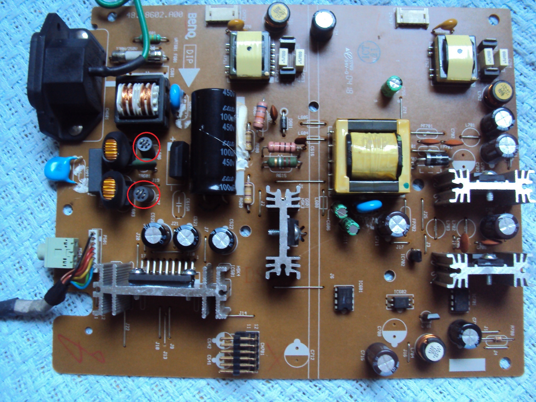

                    #29
                    Checked all diodes already, but not sure on startup caps since I don't know which are those...
                    And can you guys please tell me what are those on picture...?
                      https://www.badcaps.net/forum/attach...1&d=1467235478
                      Two small green sleeve electrolytics caps next to each other, one of them is C606.
                        Thanks again, budm. I have checked those with my ESR along with other capacitors; they tested out perfect; both capacitance and ESR rating.
                        Can you please tell me one more thing: those components I circled in red on that picture; what are they?
                        stay classy
                          • 31267
                          #32
                          inductors, ferite blocks with copper wire threaded through them a few times.
                          they should look like a short on a meter.

                            #33
                            They do, just never saw them before. Guessed they're inductors based on L markings, but thought I'd better check with you

                              #34
                              Alright, finally got the time to get back to this.
                              This short jumper (0 Ohm resistor - circled in black) had a hairline crack along it, and measured as OL. So I removed it and made a blob of solder there-monitor turns on, no clicking.
                              Now it behaves like this:
                              -Turns on, squeals a lot, flickers so badly you can't recognize the image.
                              -Eventually the BL turns off, and as BL turns off, image stabilizes nice and clean w/o BL, visible under flashlight.
                              -Sometimes it turns on w/o backlight, but squeals the same.
                              After more inspecting I noticed that I somehow managed to rip of diode circled in red, and lost it.
                              Are those zeners? Best I can do is take similar one from other board, how different do they get?
