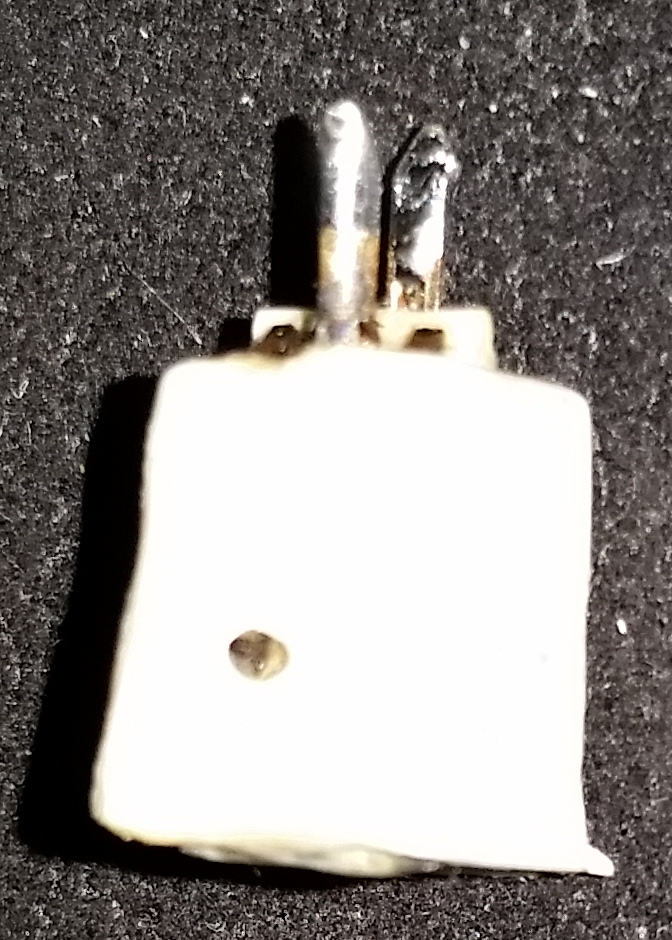

    no power I get nothing over 3v much past the plug. there was a small white cube that look very melted. no marking on it. seems to have infinite resitance.

      that looks like a degausing thermister.
      if it got stuck on, it will take out the fuse.
      is this an all-in-one or just a monitor? what's the exact model?

        the part is right behind the power plug, the the Hot side of the plug first goes thru a large resistor then to this.
        This is an old monitor the only reason I am trying to fix it is it is parts of a display for a museum and can't easily be replaced
        the fuse is intact

              Its most likley a current inrush thermister NTC. Is it in line with the ac circuit, are there any board markings for it (ie ntc1 or th602) it be could be connected between the ac line in and the bridge rectifier ac in.
              If you open the white plastic there should be a disc between two metal contacts, you could try measuring the the disc, it should be around 3-5 ohms cold.

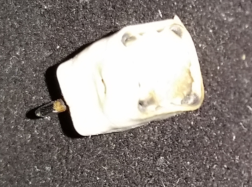

                  The ohm measurement is infinite. I popped the top off the component and there is 2 metal pads whatever was between them looks burnt to a crisp. like a lump of carbon
                  all of the resistors and caps have marking next to them but nothing next to this.

                    This is a schematic I have of an apple color monitor that shows the th602 thermistor, I suspect the mono monitor has a silmilar ac input circuit.
                    If you ignore the degaussing circuit. you can see where your thermistor would be located, It that is it you could place a short (piece of wire) in its place just to check the monitor, but don't leave it that way as it would eventually blow the fuse
                      Re: 12" Macintosh Monochrome CRT monitor
                      The inrush limiter burn up can be due to short circuit, I would check the rectifiers, check the resistance between the +/- legs of the main filter cap at least

                        I will check that. The monitor was running inside a plexiglass box and looks like it was overheating.
