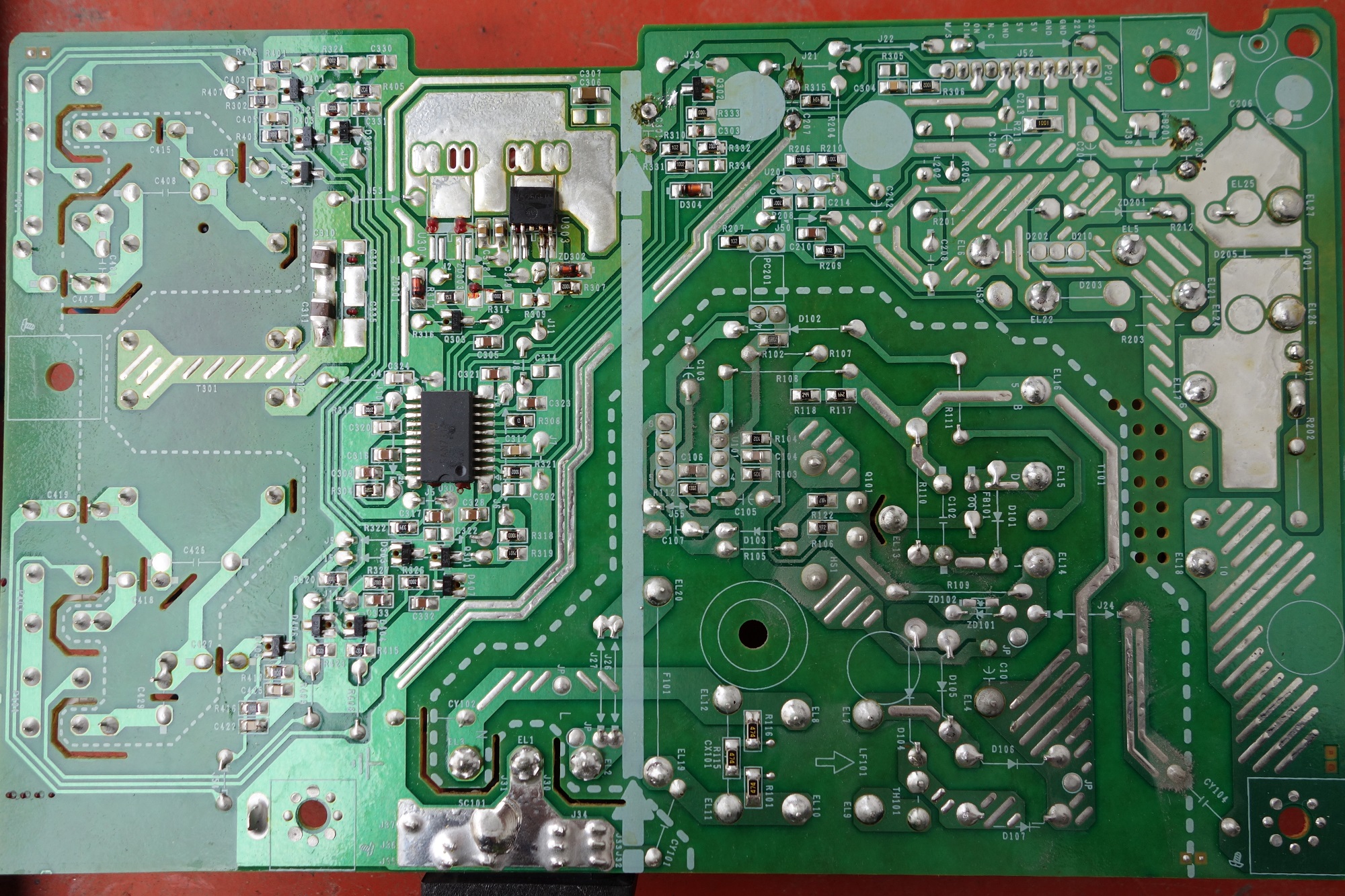

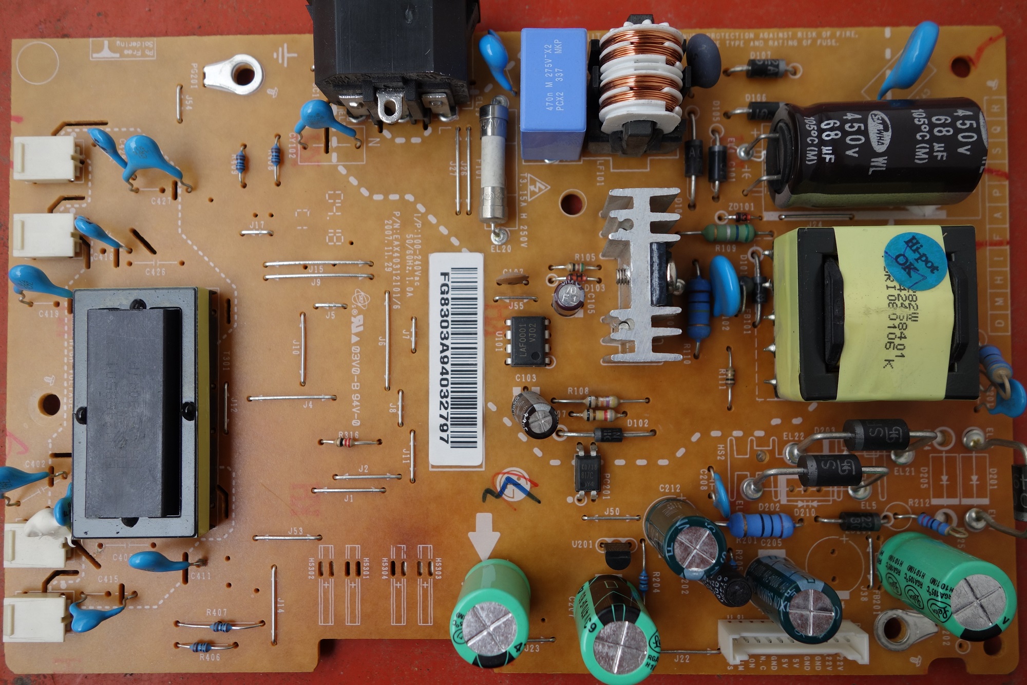

    After few years of calm, another LCD screen failed on me. An LG W1942S monitor needs my attention and repair. But I need your help, once more.
    I hope the photo are acceptable.
    SUMMARY
    This is a LG W1942S made probably in 2008. The backlight won't power on, at all. The LCD matrix shows the (faint) computer vga signal alright. When I press the power button the power LED turns blue, as normal. The rest of the buttons and menus seem to work.
    THINGS TESTED
    1) Measured steady 164V DC across main filter capacitor.
    2) With the power & logic board connected, the secondary voltages 5V, ON (3.3V) and M/S (3.3V) DC are present at connector location P201.
    3) Fuse FB101 & F101 on power board reads 0.1 ohms.
    4) All capacitors seem fine, apparently no bulge, cracks or fluid.
    5) Transistor U201 pins:1,2,3 measure 1-3 kOhm between them, seems OK
    6) High voltage transformer T301: primary winding gives 0.3 ohm, secondary1 1020 kOhm, secondary2 1020 kOhm, considered OK
    7) On the back of the power board, MOSFET U303 (type AP4525GEH) measures:
    S1-G1 OL
    S1-D1 2.5 MOhm falling
    G1-D1 3.5 MOhm falling
    S2-G2 32 ohm
    S2-D2 2.5 0.1 ohm
    G1-D1 32 ohm
    This doesn't seem normal to me.
    PROBLEM
    1) The backlight won't turn on, at all.
    2) The high voltage transformer buzzes like crazy when powered on.
    QUESTION
    Is MOSFET the primary suspect? Is there any conclusive test I should try?

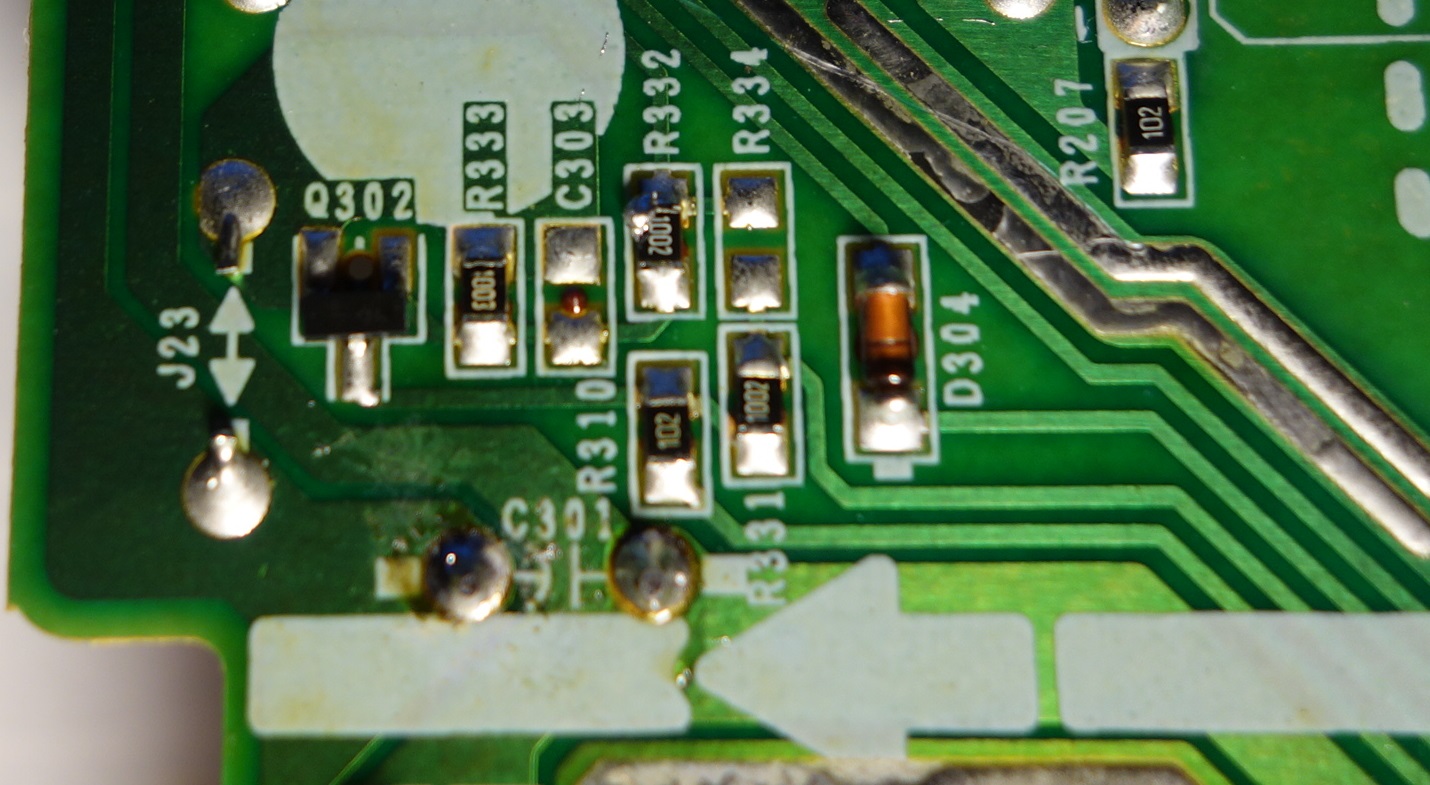

          Re: LG W1942S won't backlight, but LCD is OK
          BTW, there is some solder splash by Q302 (backside) that you should remove. It if comes free, it can cause a short.
              Sorry for the delay, I had been away for the weekend.
              @retiredcaps I cleared the the backsides' solder splash by Q302. See photo.
              @fzabkar thanks for the links.

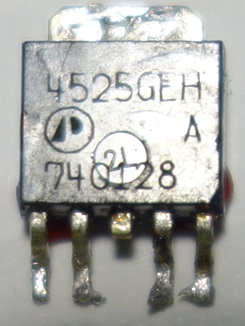

              I 've just desolder mosfet U303 (4525GEH), with some difficulty, i.e. little burned finger while touching the neiboghring large ground pad! Not really skilled on this task.
              Off-circuit dmm measurements:
              S1-G1 OL
              S1-D1/2 OL
              G1-D1/2 OL
              S2-G2 31 ohms
              S2-D1/2 0.3 ohms
              G2-D1/2 31 ohms
              Does it mean it is dead?
              I 've also tried following this guide http://itrepairguide.com/how-to-test...th-multimeter/ however I cannot conclude which part of the chip pins is the N-Channel and which the P-Channel.
              How can I definitely test the functioning of the this fet?
                MOSFET #2 in the package is shorted.
                AP4525GEH, Advanced Power Electronics Corp, N AND P-CHANNEL ENHANCEMENT MODE POWER MOSFET, 40V, 15A and -40V, -12A:

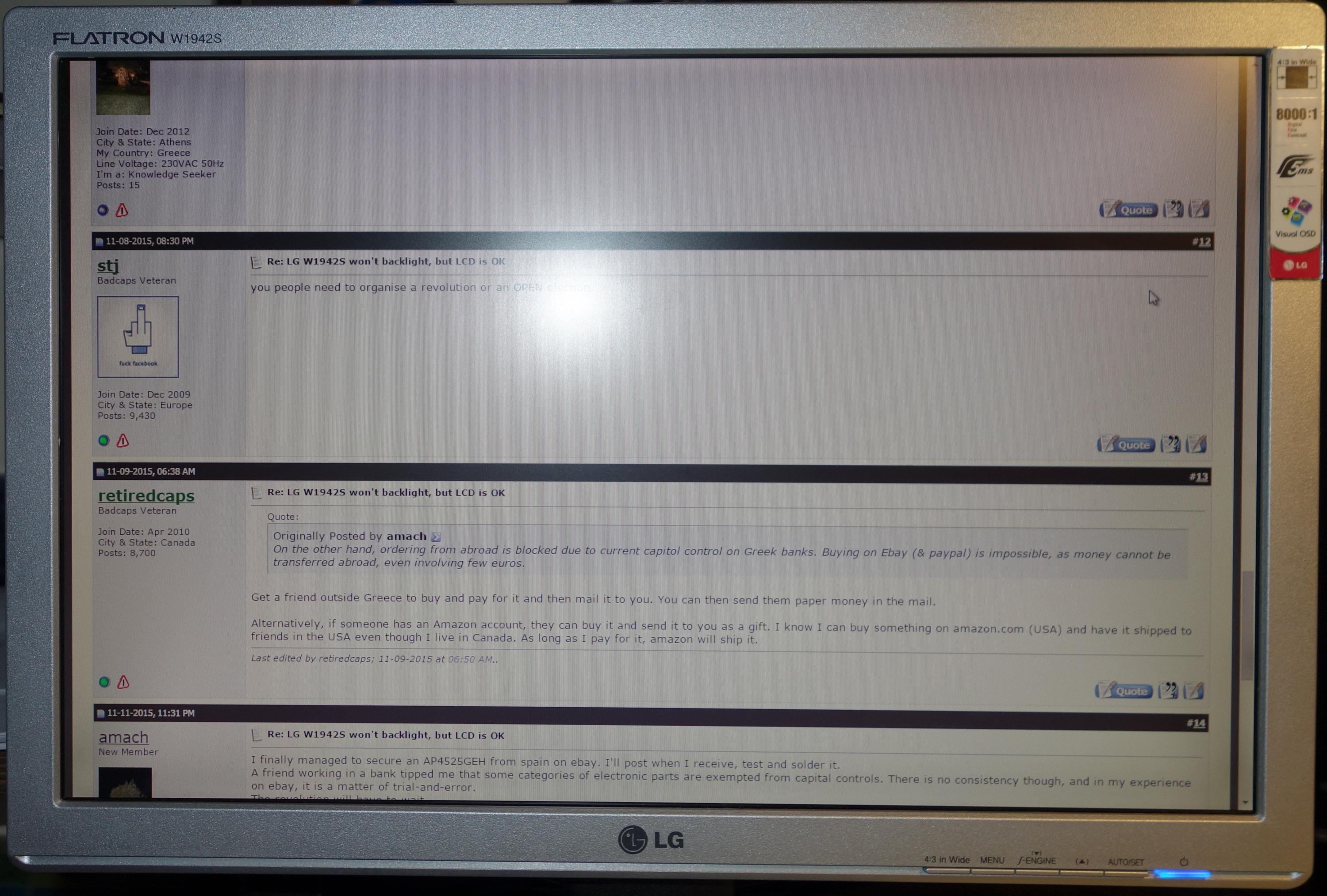

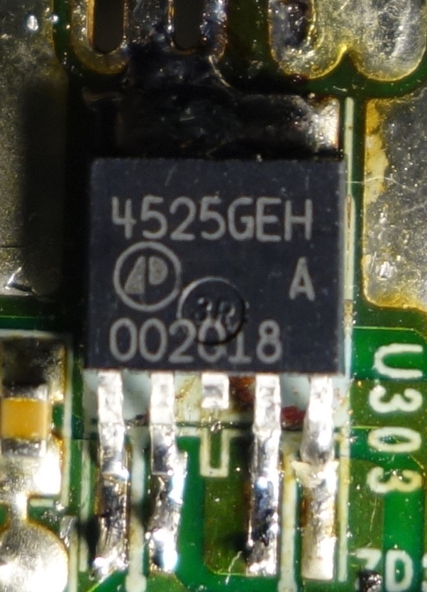

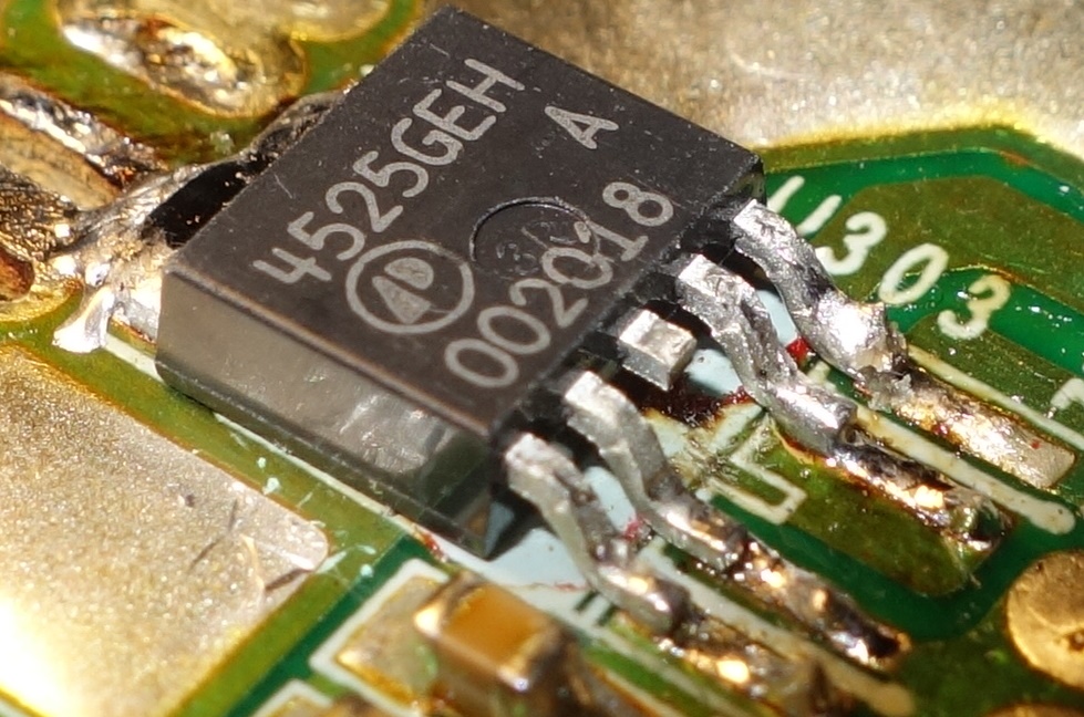

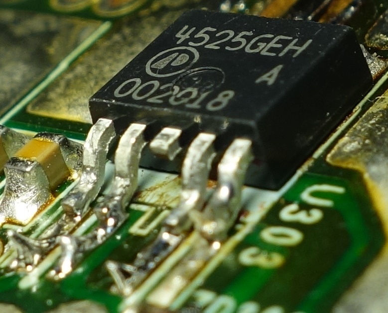

                              Finally, I replaced the faulty mosfet with a new one bought on ebay. The P-channel tests fine now.
                              Not being skilled on soldering, I post a few close-ups for you to comment on.
                              The backlight now comes on and the screens works as seen on the last photo. No buzzing transformer as well.
                              Congratulations!
                              Thanks to all the forumers who contributed to this thread, especially selldoor who offered to help sourcing the mosfet.
                              • retiredcaps
                                • Apr 2010
                                • 9271
                                It isn't the greatest, but as long as it works, it is not a big deal.
                                There are lots of soldering tutorials online (including eevblog 3 part one) and with more practice you will get better.
