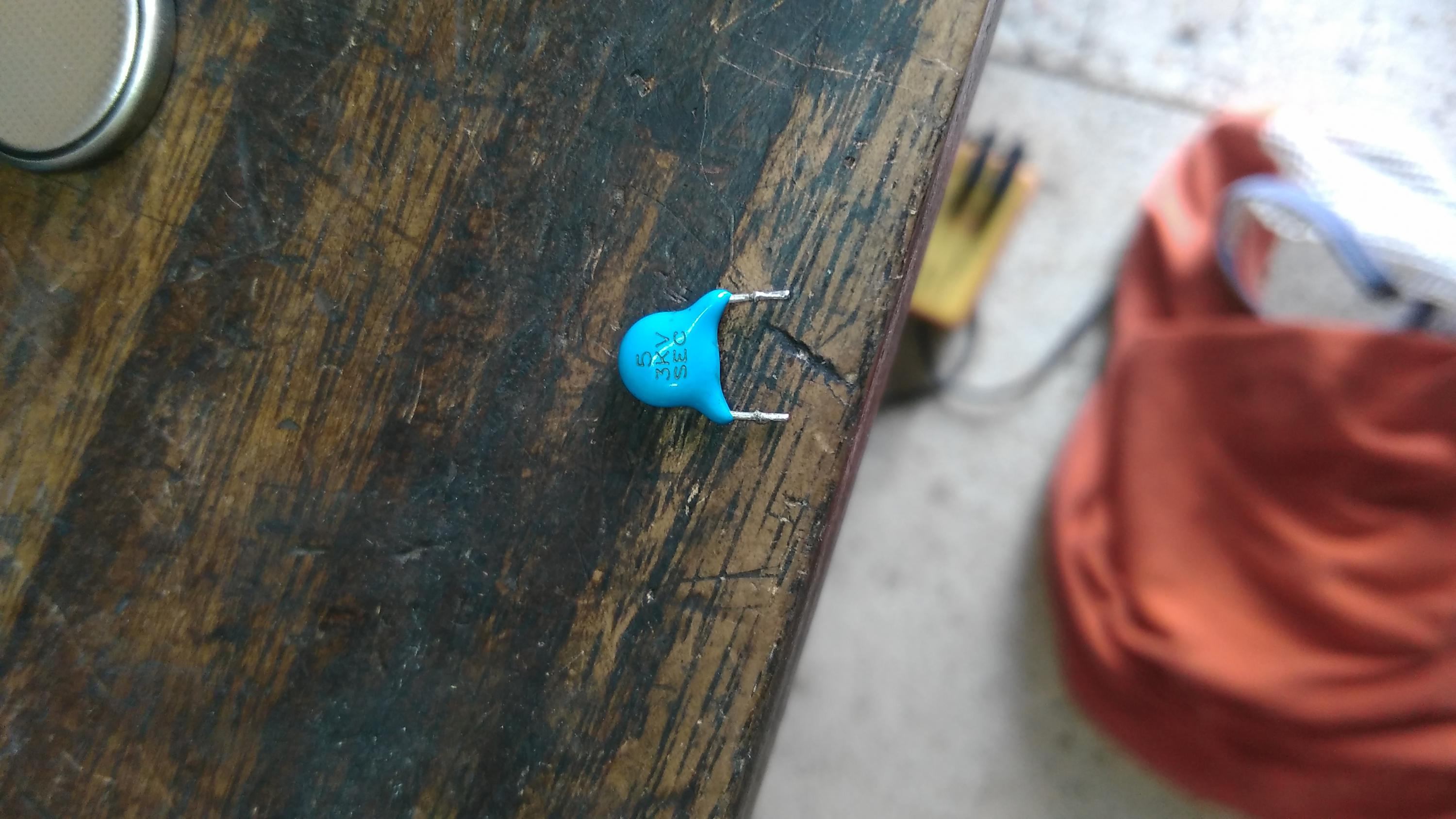

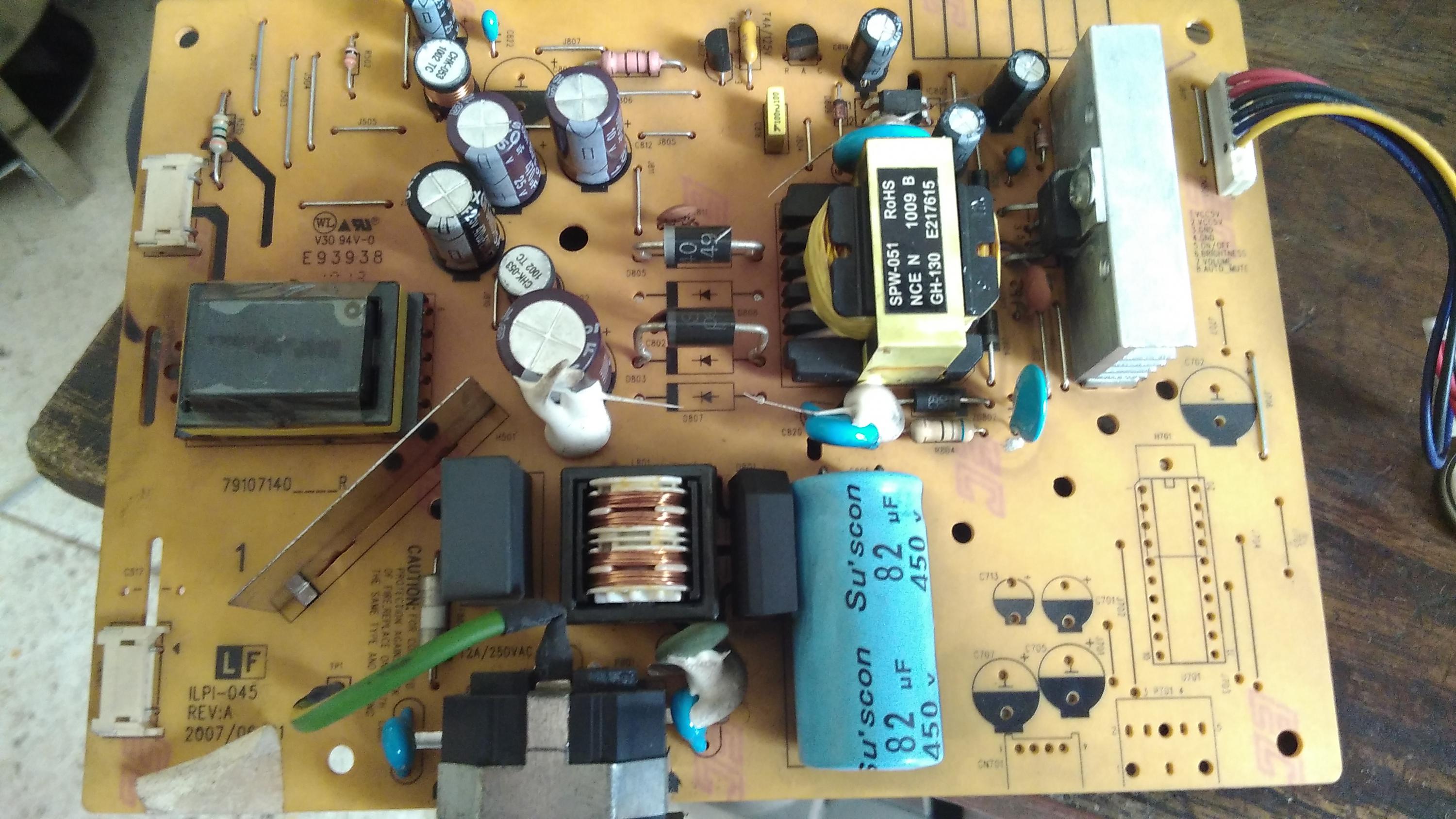

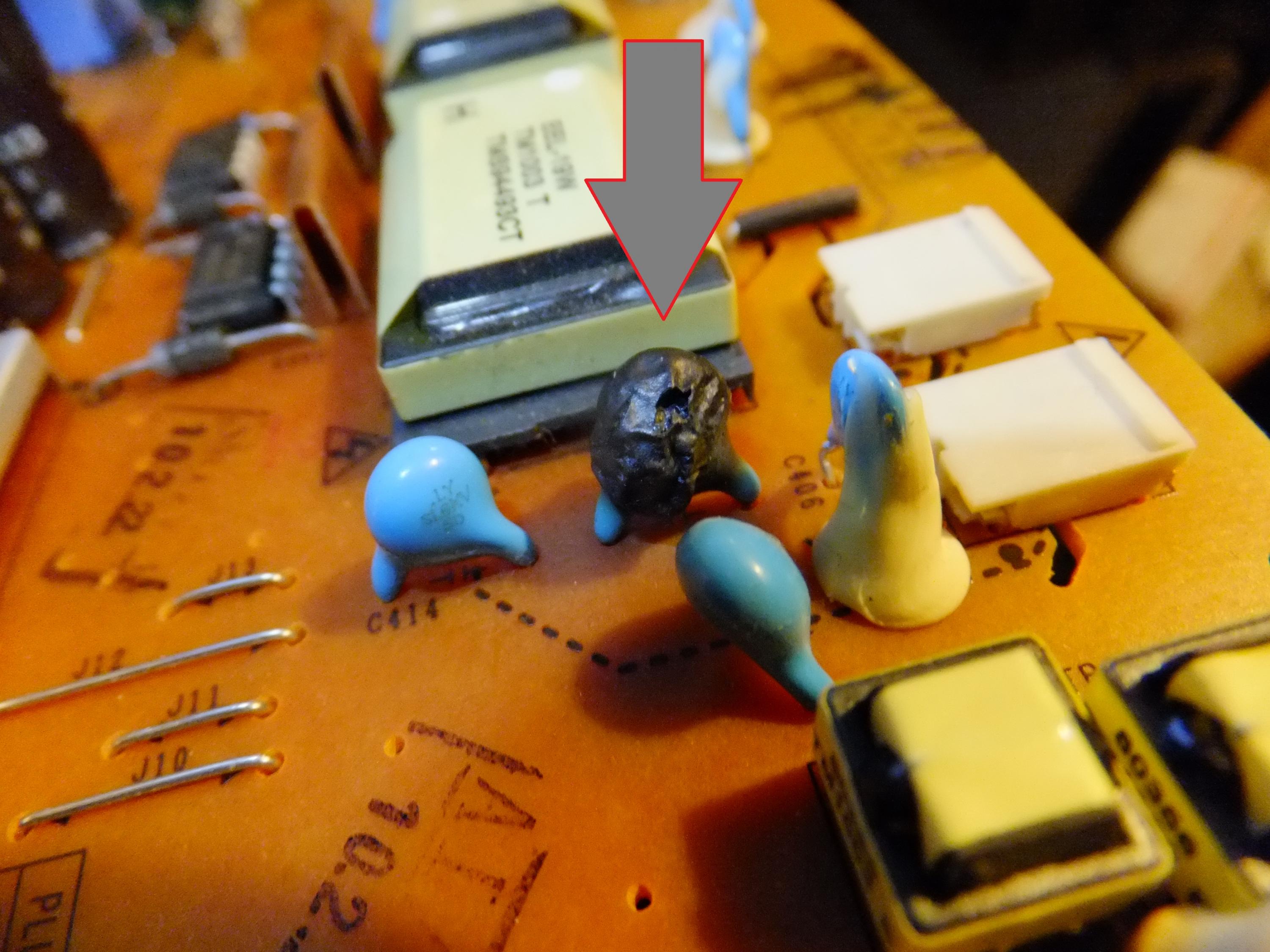

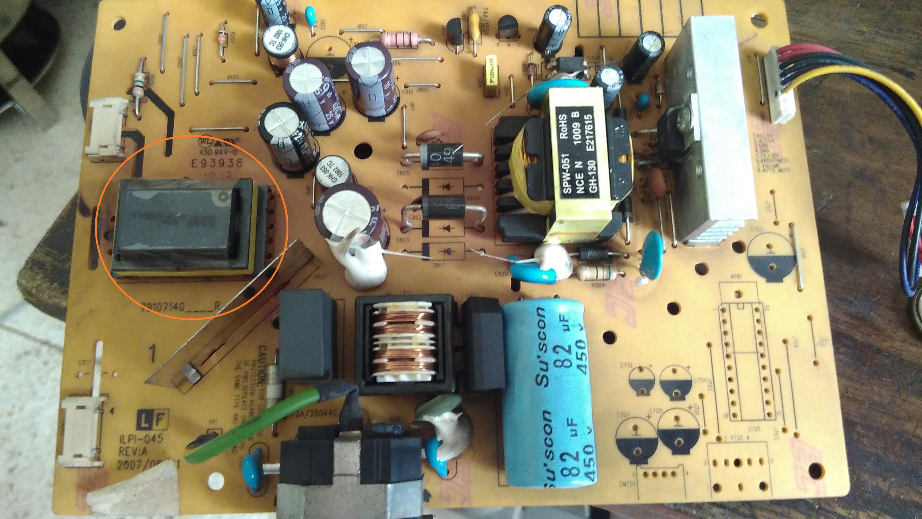

    Hey guys. could you help me identify the value of this ceramic capacitor coz I search over the internet and found no real answer as to what the correct value is. This is from an 17 inch LCD monitor from HannsG. It has two of this but the other one got burned so I need to changed it. I would also want to know what may have cause for it to burn. Please see the images attached. Thanks

    If a ceramic cap failed means that the voltage at its ends has exceeded the ranged voltage insulation. Some times they fail because the material has suffered stress over time and cannot handle the voltage peaks that some times may also occur. Anyway yours seem to be 5pF and insulation range of 3000 volts.

      thanks ilkatek. I examined the burned component and it revealed that it has a mark of "10 3KV SEC" The owner mentioned that it was previously repaired. I'm not really into lcd's but I think of it as and additional knowledge for me. What do you call this rectangle shaped component circled in orange? its the one conected to that ceramic and the other one is a resistor.

        I don't understand what component you mean but if its the one that connects both sides of the cap then most probably is some kind of transformer or most probably a coil which together with the cap creates some kind of oscillator. You say that the cap is 10pF but I don't know how you arrived to that conclusion, anyway even if you place a cap with close to those values, lets say 5pF to 15pf I think the thing will function without problems. Of course always better if you replace with same value as the original.

            ""10 3KV SEC" "
            That is just the ballast cap for the CCFL, 10pF 3000V.
            They do fail due to the high Voltage breakdown.
            http://www.mouser.com/ProductDetail/...8TXx1wJSYfA%3d
            http://www.mouser.com/ProductDetail/...XgPAy5MifX0%3d
            The one in the picture is 5pF.
            You need to use the correct value since it will determine the amount of current flowing through the CCFL.

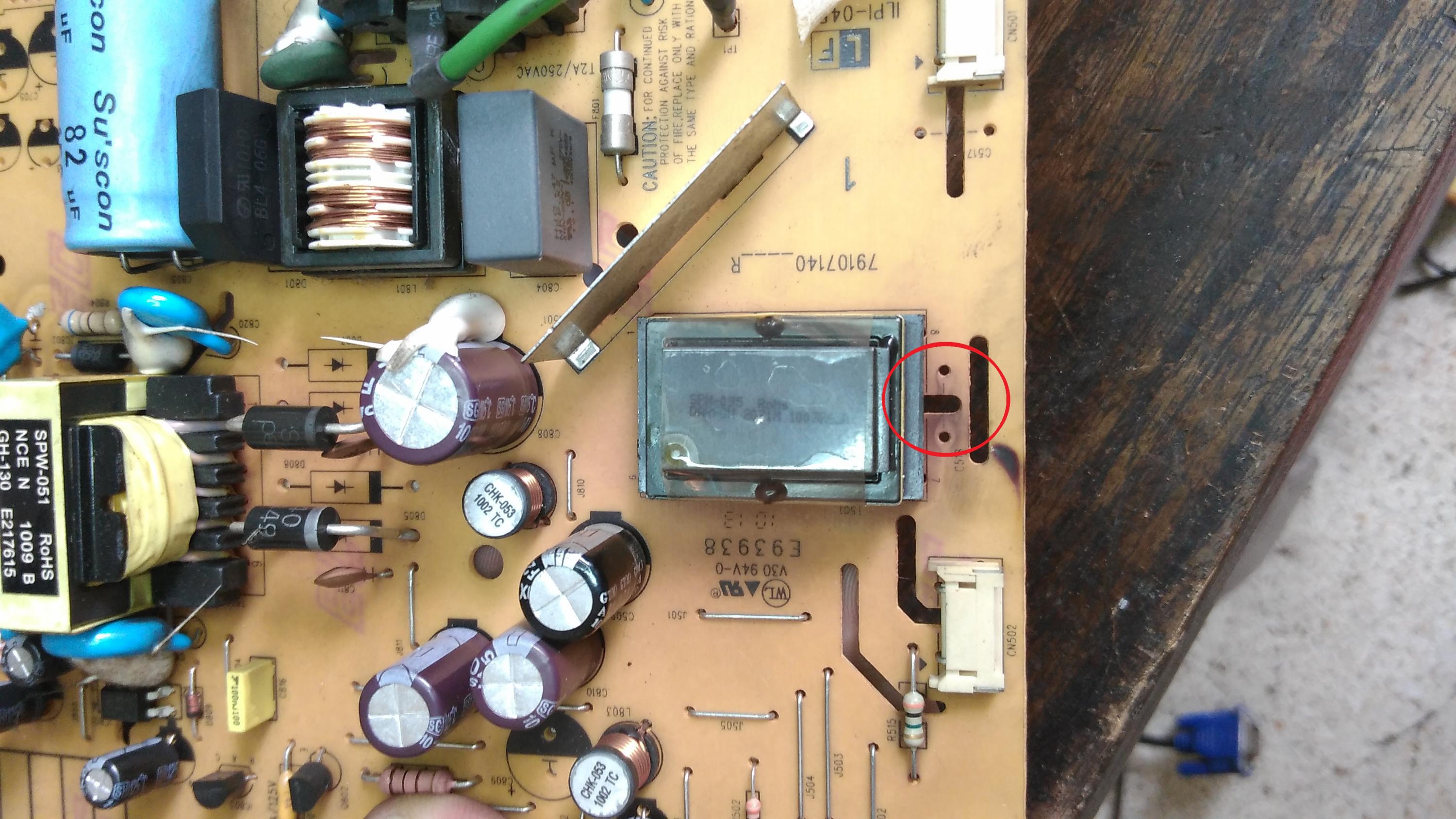

              Oh sorry I forgot to attach the pic. Here's the component circled in orange, I don't know what's it called.
              There's another question, is there a possibility the that previous technician who worked on this didn't use the same value? Or maybe he did. The other is 5pf and the burned one is 10pf.

                  in orange is the invertor transformer.
                    Re: Ceramic capacitor

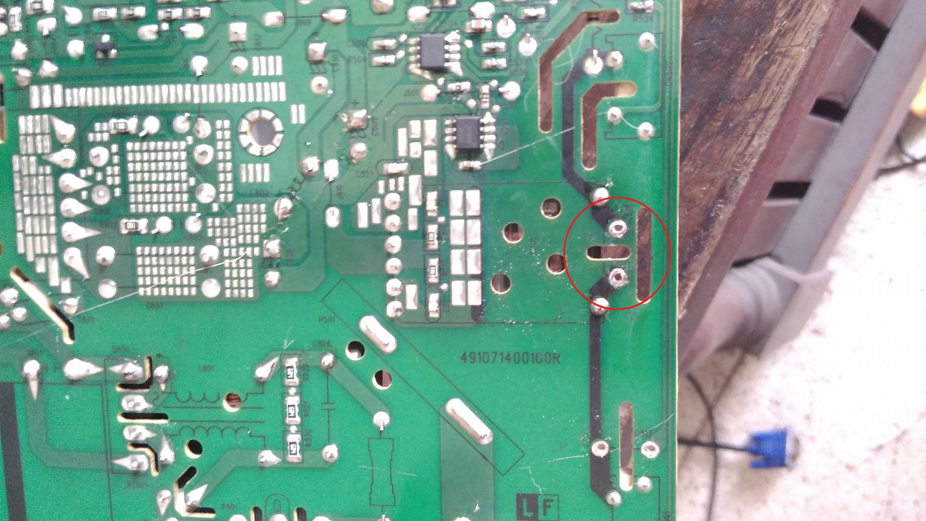

                    OK, looking at the connections on the bottom side, those two caps do not have the same value.
                    If I remeber it correectly, the 5 pf should be the one that is connected in parallel with the high Voltage winding of the inverter transformer as shown in the red circle in your picture:
                    https://www.badcaps.net/forum/attach...8&d=1442564246
                    The 10pF will be the other one in another location.
                    The 10pF is the one that burnt out, right?

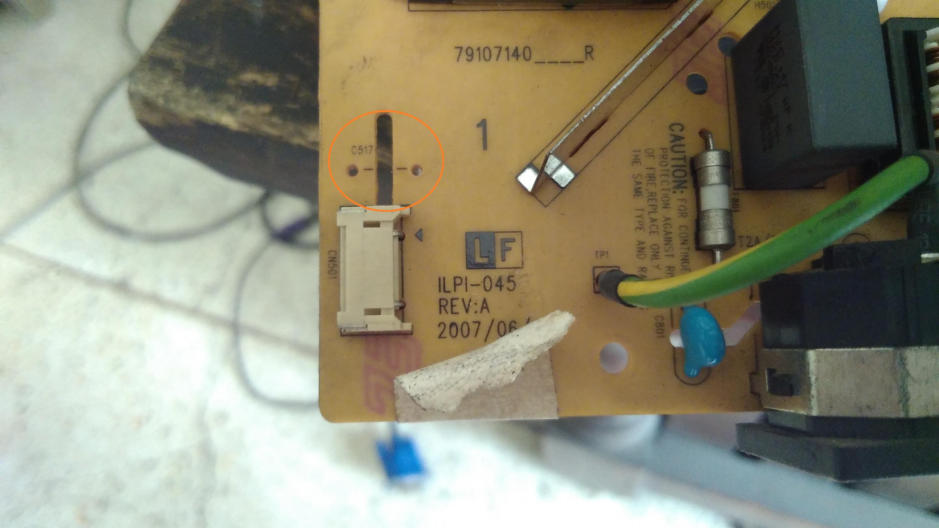

                      thanks stj. yes the burnt component is marked as 10 3kv sec. So what I need to do is acquire same value caps then put the 10pf one on the circled orange spot? thanks again
                        The picture #1 in post 1 is 5pF, so where did you get that 5pF from then?

                          Here's where it was soldered circled in orange. I took it out so I can show it to a store and maybe they have same type, but sadly none was around.
