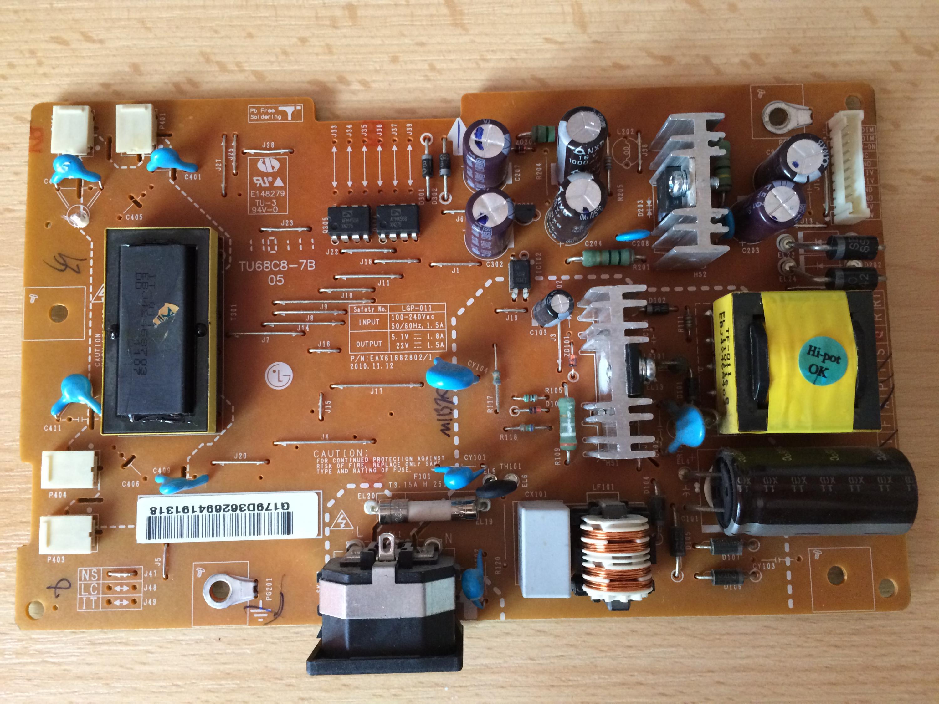

          Re: LG FLATRON W2240T-PN Backlight works only for 1 sec.
          Hello, i have now two pcs of these monitors with the same failure.
          I think its bad transformer for ccfl tubes.
          When i cut-off inverter protection it works, but the transformer heats up rapidly.
          I leave for test one monitor running for 30mins, transformer gonna melted.
          May i buy 2pcs of this? http://www.ebay.com/itm/IT-011-EBJ42...-/151287502952
            • 31095
            check any high-voltage ceramic caps around the transformer & tube connectors.
            • BeginnerLVL1
              • Apr 2015
              • 58
              • Czech Republic

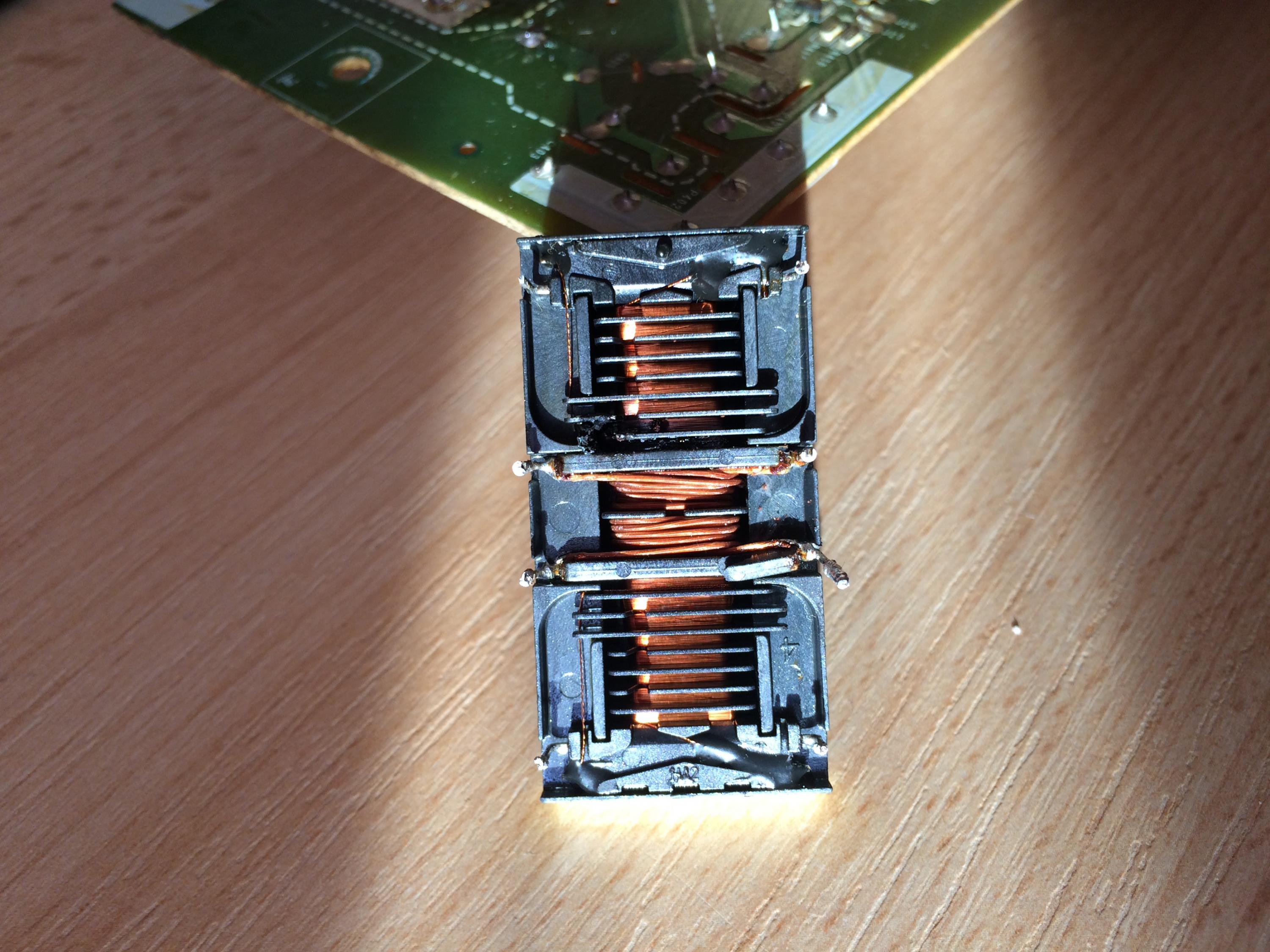

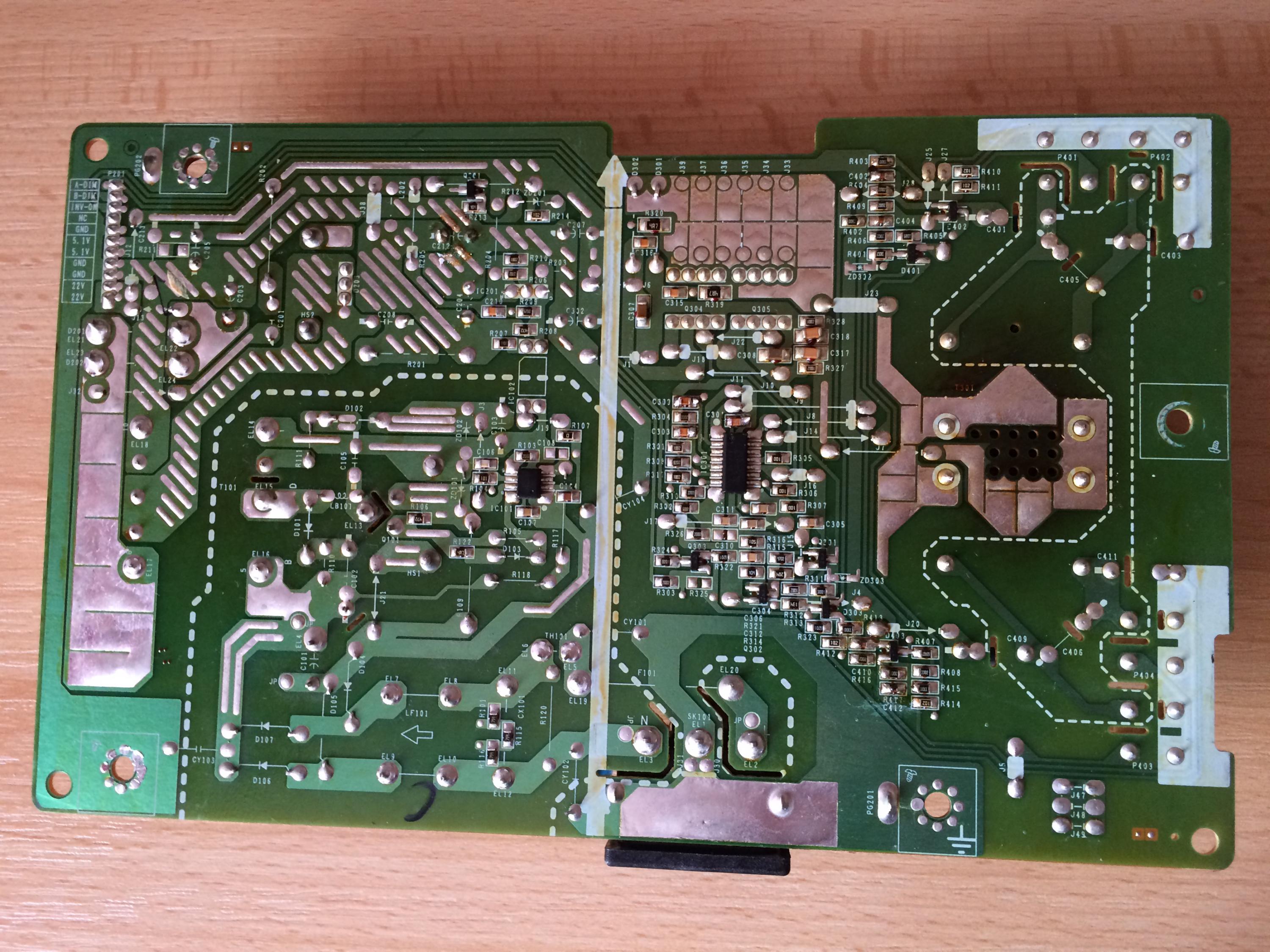

              Thanks, I try it here is 4x 3kV 10J, all of them is OK, tested with capacity tester.
              I tested windings on the transormer, primary has 0,3Ohm and secondary1 has 1kOhm, secondary 2 is probably bad... It has infinity resistance.
              Look at pictures, secondary2 looks burned.
