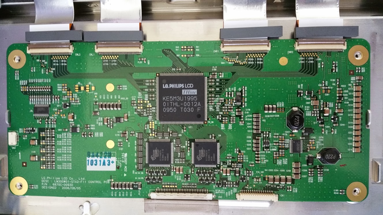

      TCON:
      https://lh5.googleusercontent.com/-M...421_100008.jpg
      No obvious blown components on any of the 3 boards.

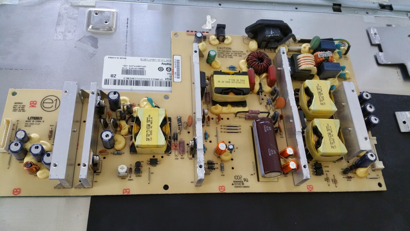

          Re: Dell 3007wfp screen flicker after warmup
          After inspecting the power supply board, it appears several caps (orange ones in the image) here have also been replaced with UCC caps. Should I bother replacing the rest of the LTec and Taicon caps or is the nature of the failure more indicative of a bad TCON?

            I have looked at the video again and it is not flickering in normal sense.
            By pausing it every few seconds it appears it is redrawing the picture not necessarily in the same place. I dont know but it suggests a tcon fault.

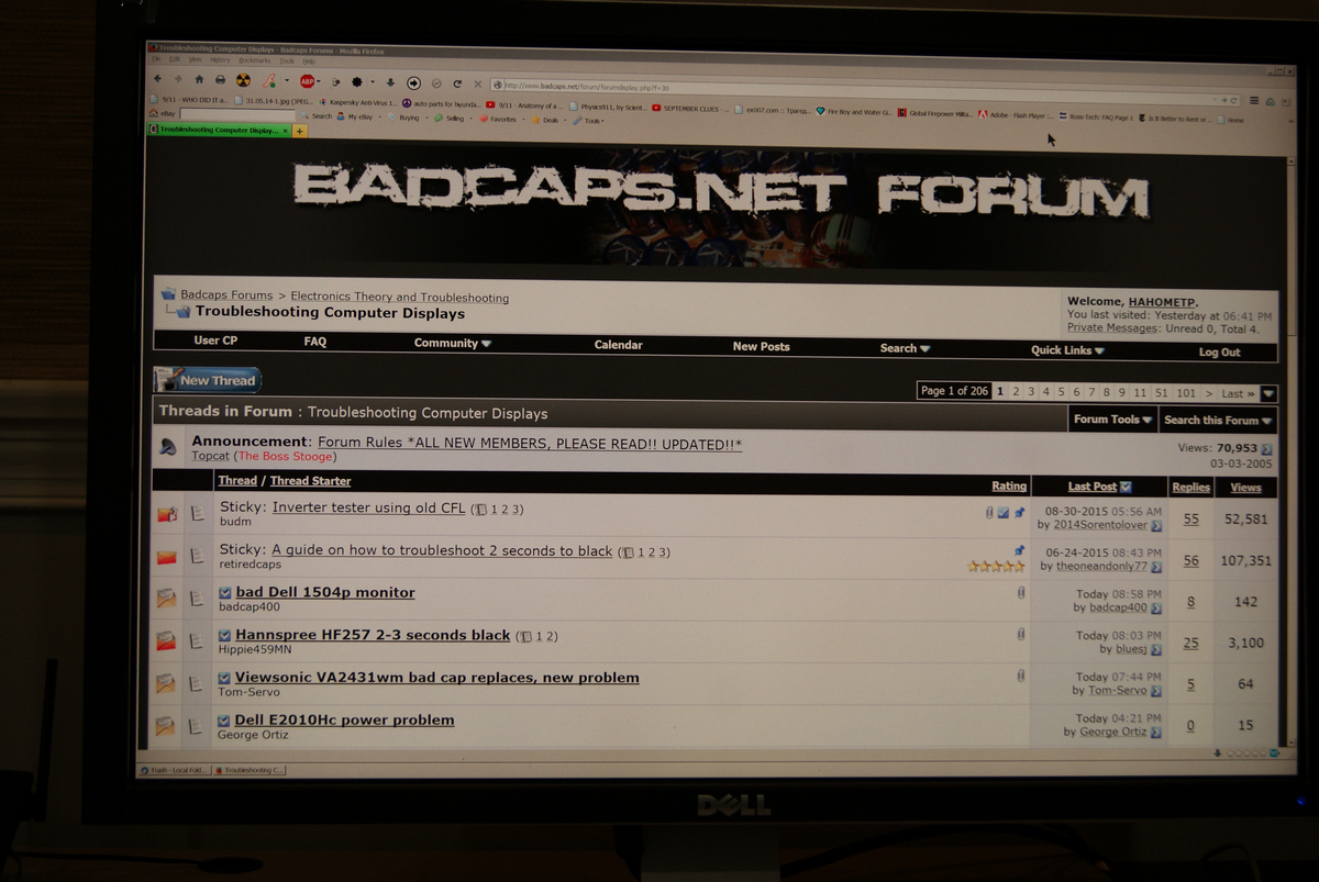

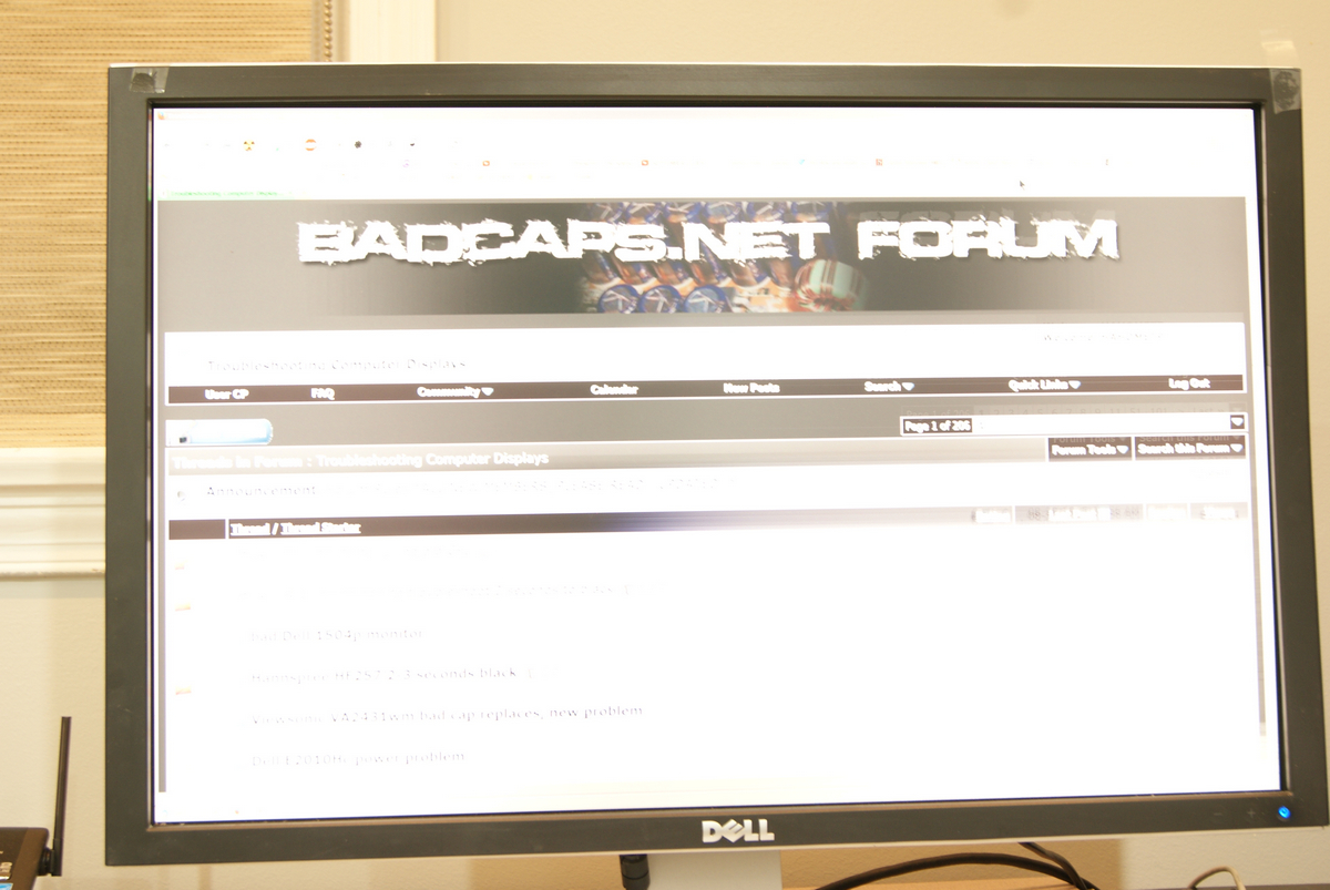

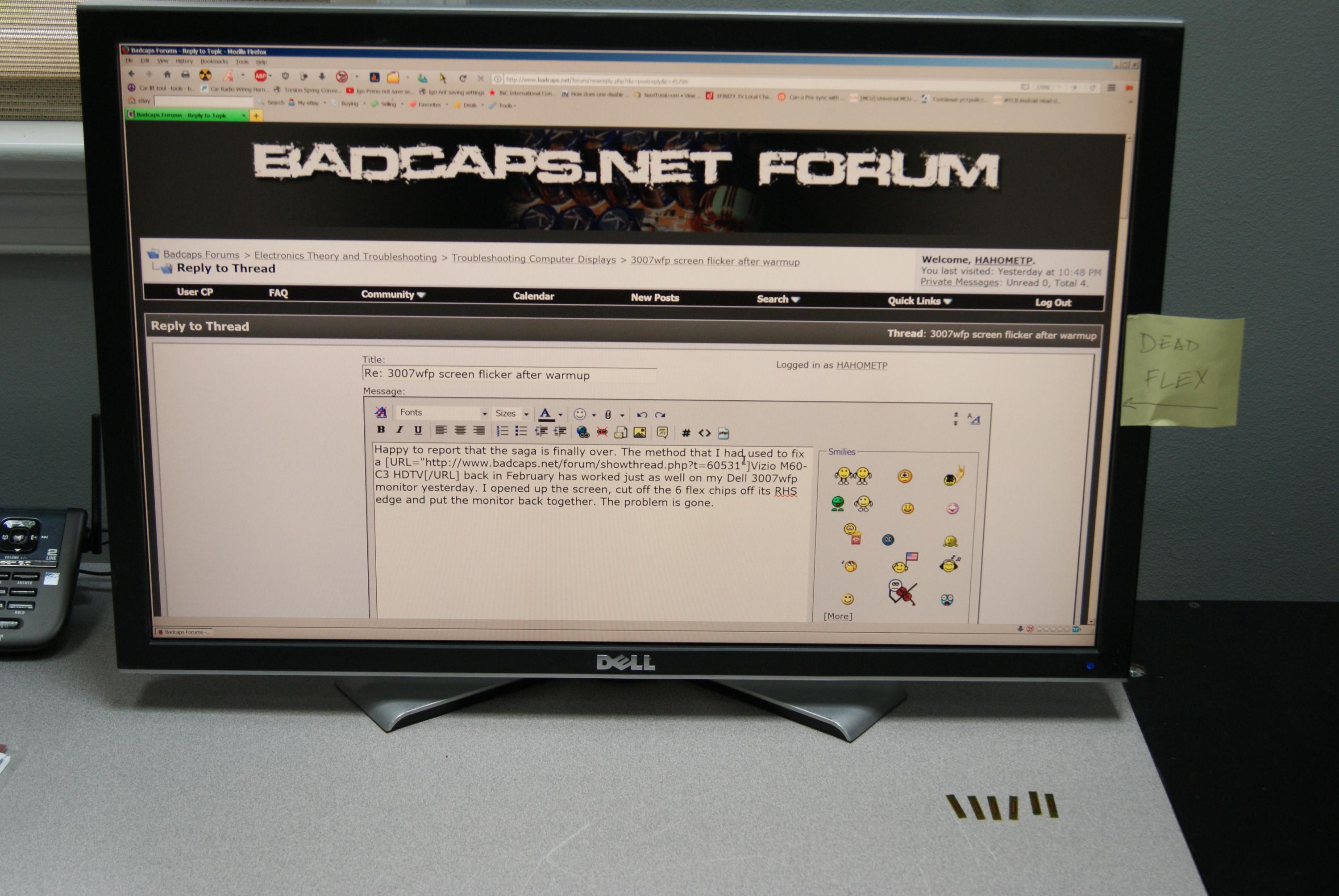

                        Happy to report that the saga is finally over. The method that I had used to fix a Vizio M60-C3 HDTV back in February has worked just as well on my Dell 3007wfp monitor yesterday. I opened up the screen, cut the 6 flex chips off its RHS edge and put the monitor back together. The problem is gone.
                        I have attached a few pix.
                        1. This is how the bad side flex IC chips manifest themselves.
                        2. My two 3007wfp monitors, the bad one and the good one, side by side.
                        3. The once bad 3007wfp after I cut the side flex IC chips off its LCD.
                        4. The close up look of the side flex IC chips after they have been cut off the LCD. No discoloration, no burnt spots.

                                in the fist two pictures attached to my post 12 you can see that on the left hand side the monitor shows the bright blue desktop which is the true colour. The middle of the desktop is dark and the right hand side fades into grey. That's the telltale sign of burnt flex chip(s) on the right hand side of the monitor.
                                The 3rd picture shows the same monitor after the flex strips were cut off the right hand side of the monitor. The colour is now true and even on the whole surface of the desktop.
