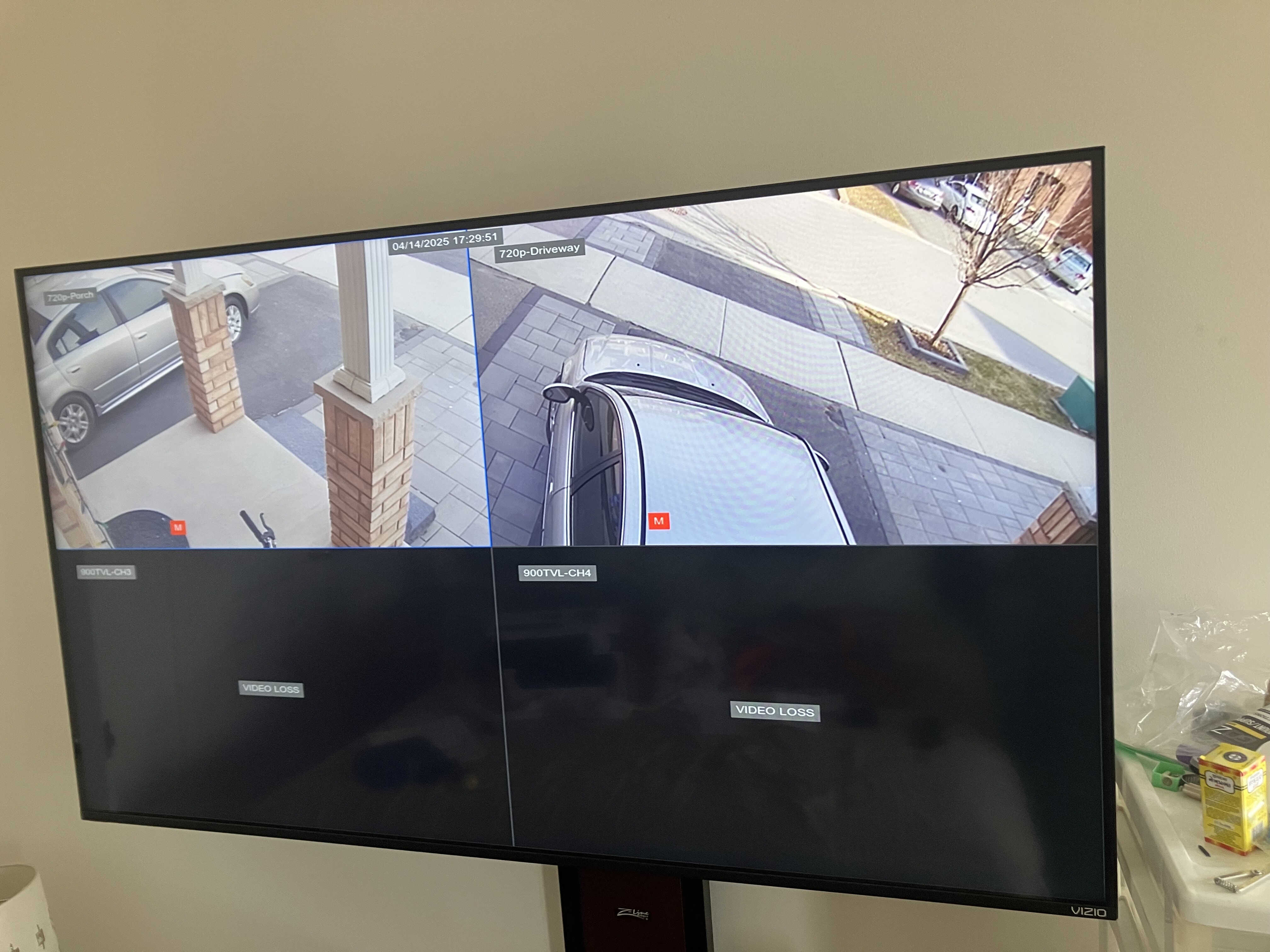

        I am facing similar issue in my Vizio M55-F0. One photo is when its not flickering and the other one shows with flicker. Is this TCON or main (power) board issue?
        • Adubey
          • Oct 2020
          • 21
          Update: I found a swollen 22uF cap on the video board that I replaced. This has led to reduction in the frequency in this jitter. I noticed that 4K videos on Youtube work flawlessly for almost 6 hours, however upon playing regular videos from Youtube, the jitter appears back again. This behaviours persists unless the tv is turned off for some time and then restarted.
          Please let me know if you have any ideas on this.
