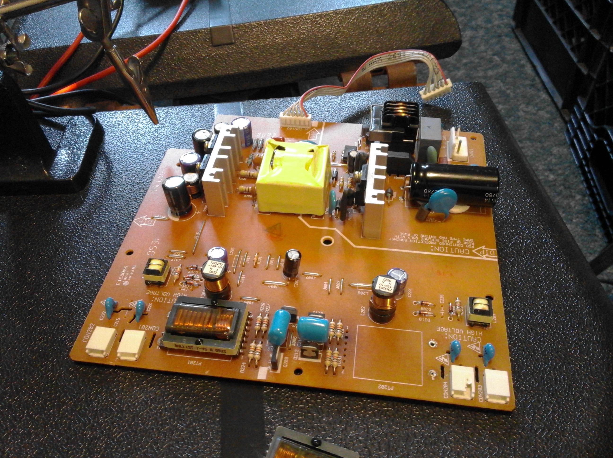

      Hi budm thanks for replying.
      whith regards to the tuning cap I think my board is different here's my board
      are the tuning caps the 2 blue ones where the 4 transistors im gonna replace are... in-between the drivers on the left side of the pcb board?
      also I checked out the C5707 transistors. am I right in thinking they are an improved model on the c5706 ?
      as I seem to be able to get the c5706 in the UK would it be the preferred replacement and better for the ccfls lamps in the long term due to the small difference in specs ? or just go for the c5707 as there better all round spec wise for the ccfl lamps?
      http://pdf1.alldatasheet.com/datashe...I/2SC5706.html
      http://pdf1.alldatasheet.com/datashe...O/2SC5707.html
        Re: Buying transistor advice Dell E173FPc - 2 Seconds to Black
        "are the tuning caps the 2 blue ones where the 4 transistors im gonna replace are... in-between the drivers on the left side of the pcb board?" Yes.
        5707 has better spec but 5706 original is fine.

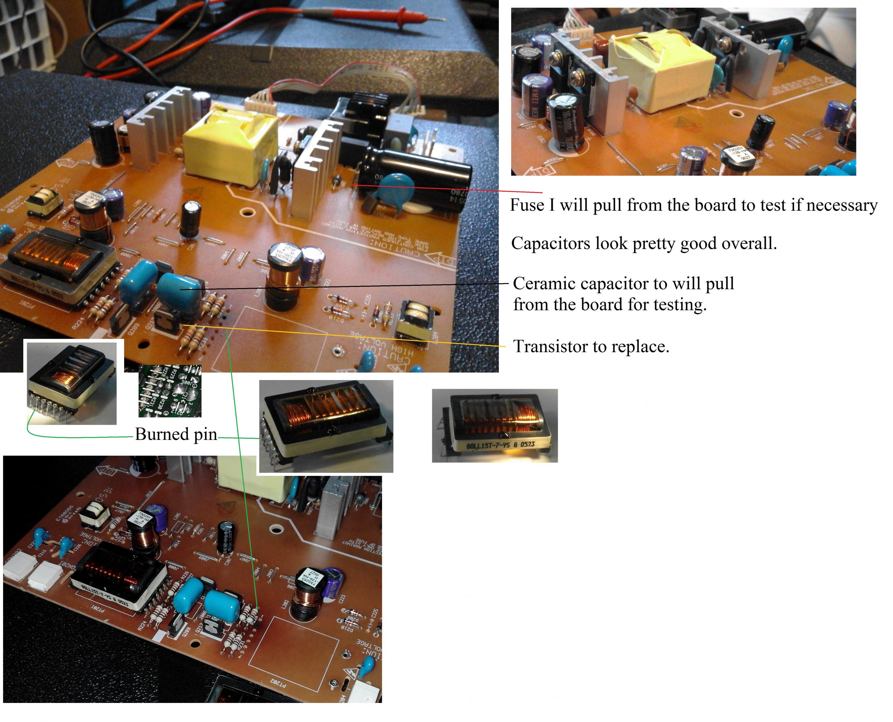

                        I am new at this. I am a second year EE student at LeTourneau University and don't know the best places to look for parts.
                        I have a monitor, Dell E173fpc which won't stay on, it sort of fades out. No blinking of the power light. I could just buy a used monitor for 20-30$, but I'd like to troubleshoot this one for practice. The power supply board 715L1283-4. Regular capacitors seem fine. No bulging etc. However,
                        1. C5706 5G Transistor bad? Can use C5707?
                        2. 7C184J 250V 0F ceramic capacitor Shorted. Tested by ohmeter while on circuit board (which I know is a no-no, but looking for any continuity). Looked at Mouser and found only a 50V, but not a 250V. Puzzling. Checked other sources too.
                        3. 80ll15t-7-ys g 0523 Bad transformer, 1 post blackened some solder missing. Already de-soldered and removed.
                        I don't know which happened first, the transformer went bad or the capacitor, or maybe even the transistor. I think FB901 is a fuse, but uncertain. It is very small. Anyway, it appears to be good. Of course, its a Dell, so I think they're pretty tight with proprietary parts breakdowns,etc though not certain. So just winging it really.
                        Thanks,
                        Scott
                          1) 2sc5707 is OK to use, see post 4.
                          2) Take the cap out of circuit and check the resistance.
                          3) Upload the pictures of the bad transformer and the board.
                          4) FP901 is the fuse and it should show <1 Ohm, so check that out first, it is 3A FUSE (BELFUSE).
                          Board is know for bad solder joints and bad caps in the Royer Osc. section.

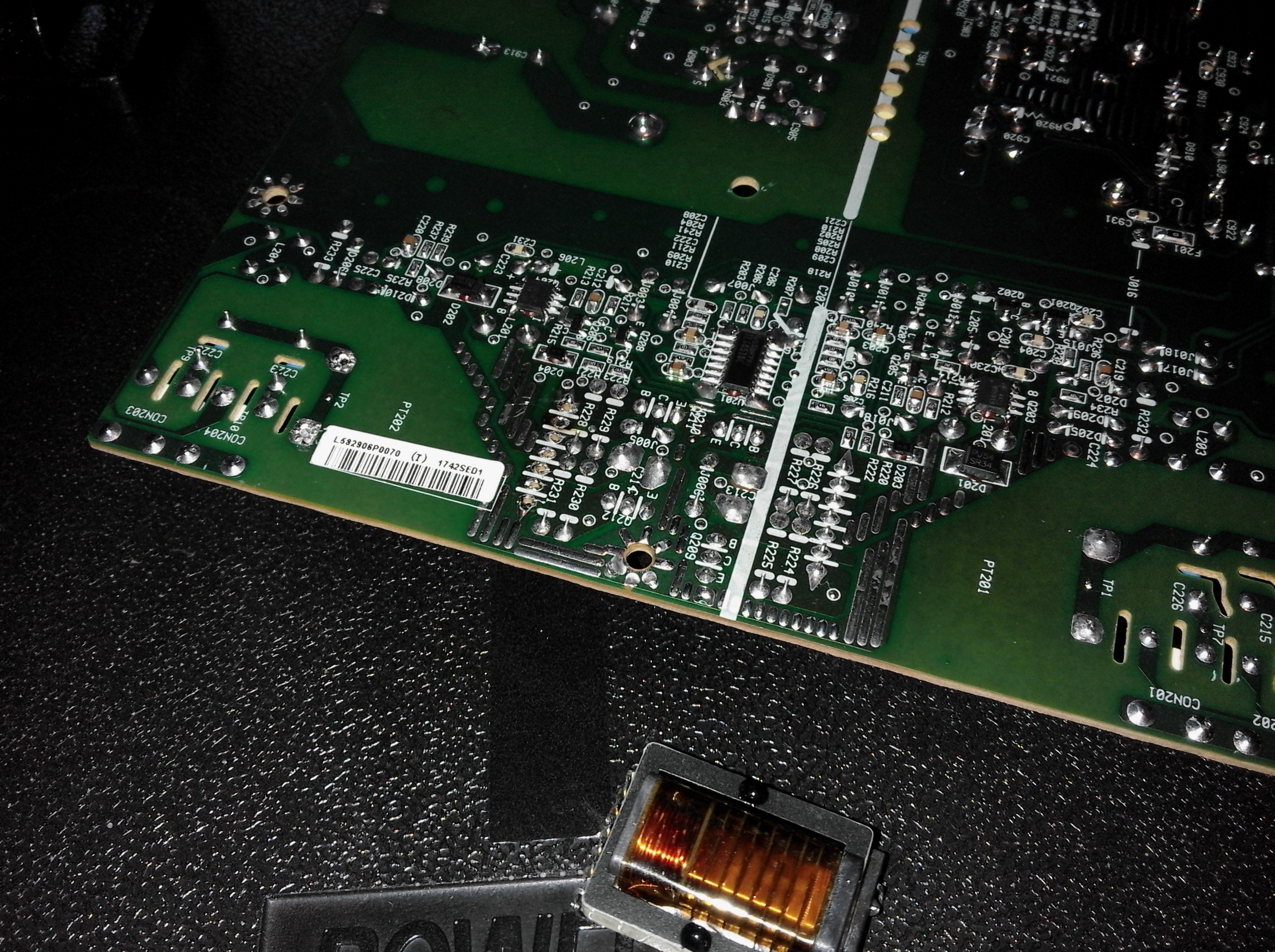

                                Diagnostic picture.
                                • 3Focus1
                                  • Dec 2016
                                  • 8
                                  A couple more.
                                    The brown spot at the transformer leg is due to poor solder joints so it develop contact resistance which will heat up. As indicated, that board is known for lots of bad solder joints, just look real close at the legs of the parts for cracked solder ring around the leg of the parts.
                                      BTW, those two blue tuning caps will show low resistance because it is connected in parallel with the transformer primary winding which has low DCR. You need to check the capacitance to make sure it is still within tolerance.
