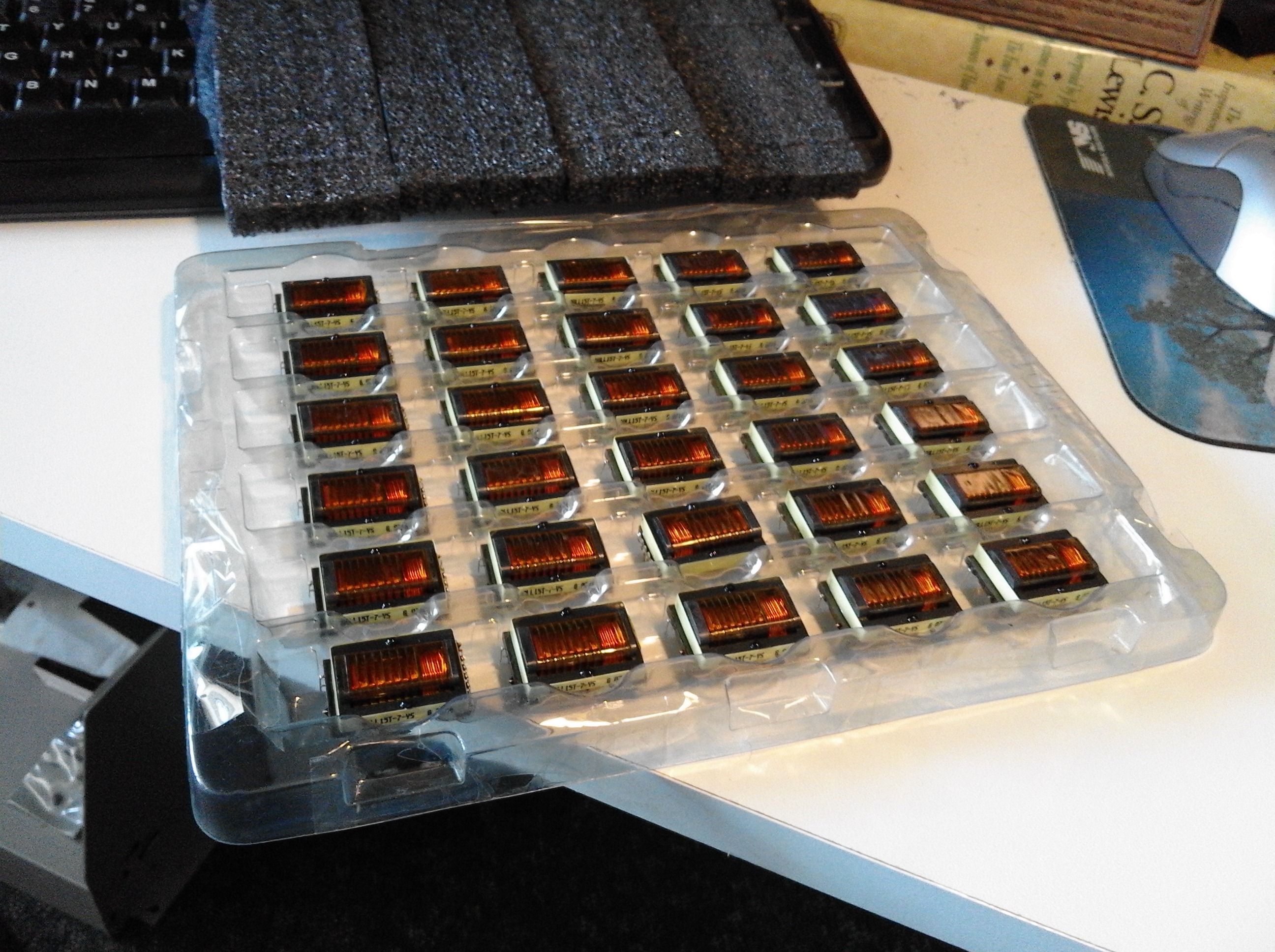

      Just got back from holiday leave and finally received 30 of these, the old one is: an 80LL15T-7-YS G 0523, and all 30 of these are:
      80LL15T-7-YS G 0716.
      Though if that was simply a bad connection as you said then the old one is possibly still good.
      I am working to line up a DMM (to check capacitance), frequency generator and oscope (the university labs are closed currently) to work through those service guides you graciously forwarded. Though, I noticed that the service guides sent are -2 and mine is a -4. It appears you all have been doing this for awhile and that these are likely all that I will need.

        Re: Buying transistor advice Dell E173FPc - 2 Seconds to Black
        I didn't really want 30 of these inverter/ transformers, but the parts which they used to make this old monitor are hard to find and you almost have to go with whatever you can find. If I do end up using this part, I think it is good judgement to replace both of them so they will match.
          Originally posted by budm
          I would think the College will have all type of caps in the lab for the students to see what various type of caps there are.
          I finally got onto a DMM, the capacitor is giving 0.018 microfarads. I'll try to find a stats sheet. Wait, I think somebody else talked about this in this string.
