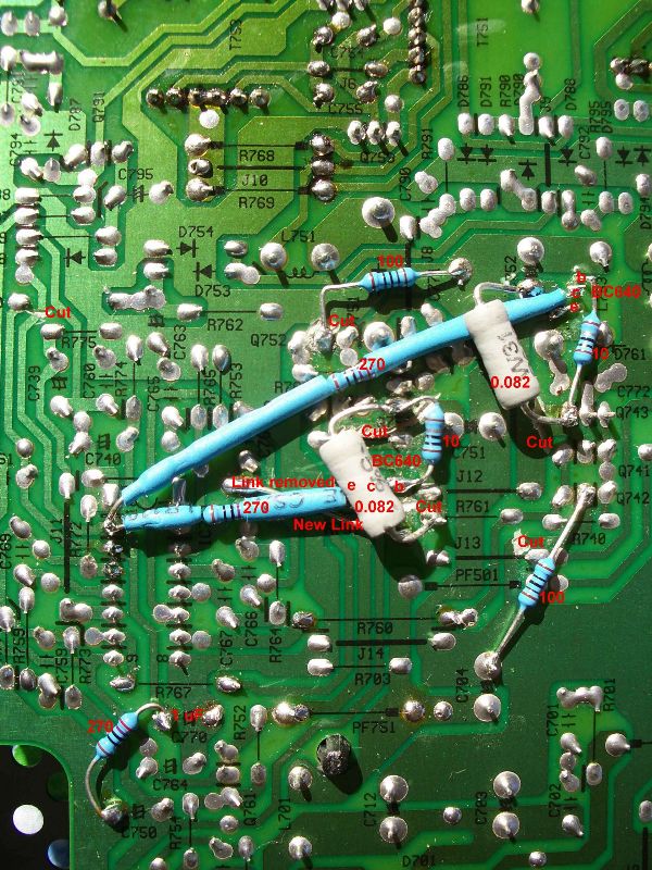

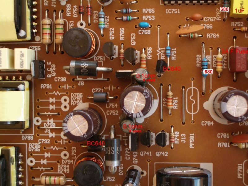

    Some have asked for PCB photos. Well I have just fixed and modified another monitor and taken photos.
    This monitor was received with a damaged ribbon connector. This is usually because the release mechanism is not understood. To release the ribbon cable lift /rotate the black locking bar outward from the centre of the top edge. Do not force.
    Update: My PCB board matches this one exactly. So I have the same model as the one here. Whats the full model number of this screen?

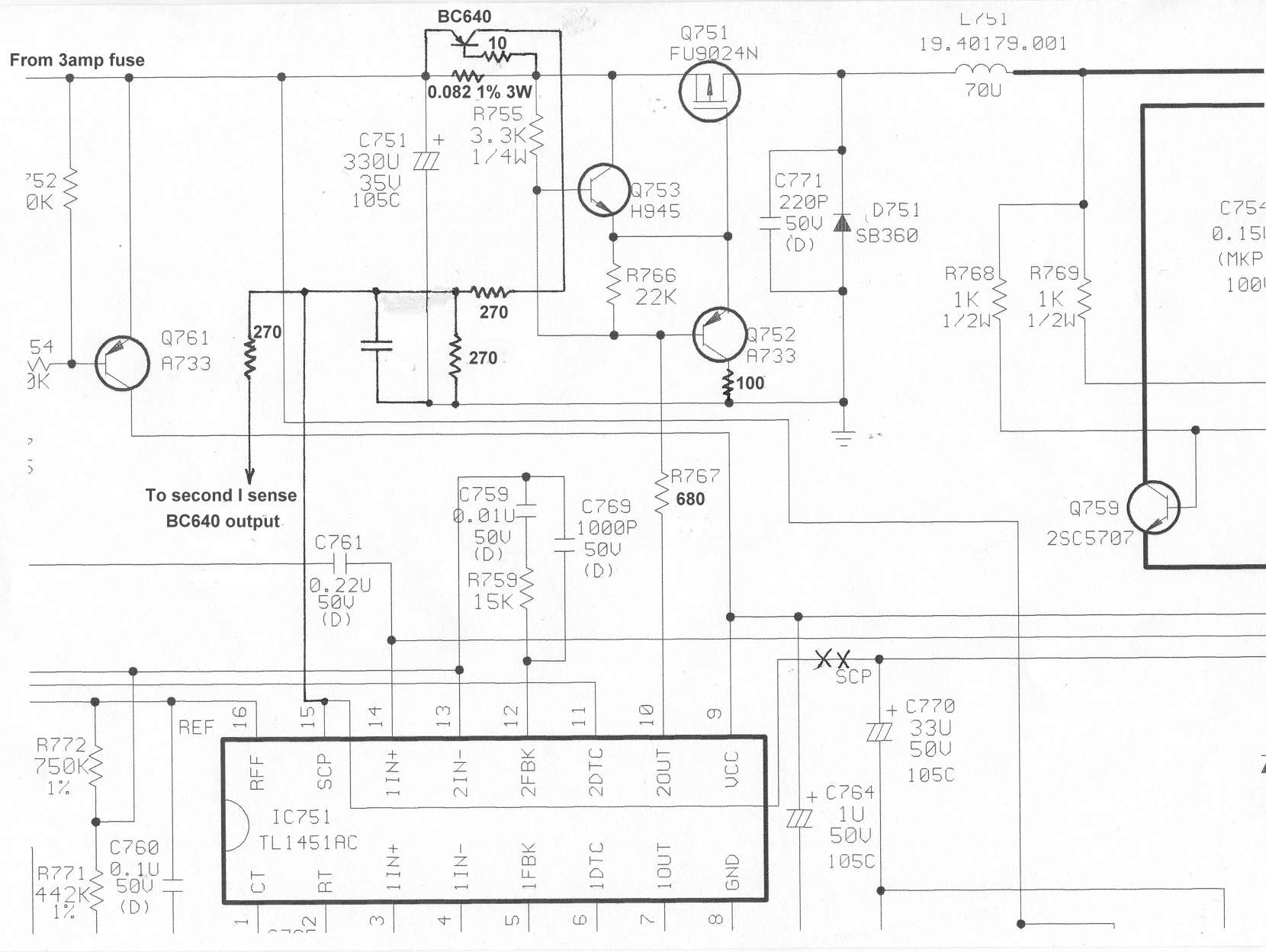

                    Re: Fix for Benq FP737s 17" (Q7T3)
                    I have recently discovered that a slight change in my current limit modification is required to better cover variations in the BC640 transistor.
                    The latest mod diagram is attached together with the parts list.
                    Note the current sense resistor can be one 0.082 1% resistor or the first two resistors in the parts in the parts list.
                    I will post the new component layout tomorrow.
                      The new layout detail is attached. Note the original value for R767 of 2.2k need not be changed to 680. See circuit diagram.
                      To Freegeekvan
                      If you do the current limit mod you will not blow the transistors again. If for some reason the current limit is exceeded the controller chip will lock out drive to the MOSFET transistors suppling each inverter. It can be reset by power removal or loss of video signal.
                          Jim,
                          If you following the latest small change to the mod you should have great success. Just a matter of connecting it all correctly and cutting the right tracks.
                          I found it more convenient to use one 0.082 resistor for the current sensing than the two in parrallel (0.1 and 0.56).
                          The original circuit with a 2.7K resistor in parallel with the 1uF cap (now 270) tended to trip easily making it appear that there is a monitor problem.
