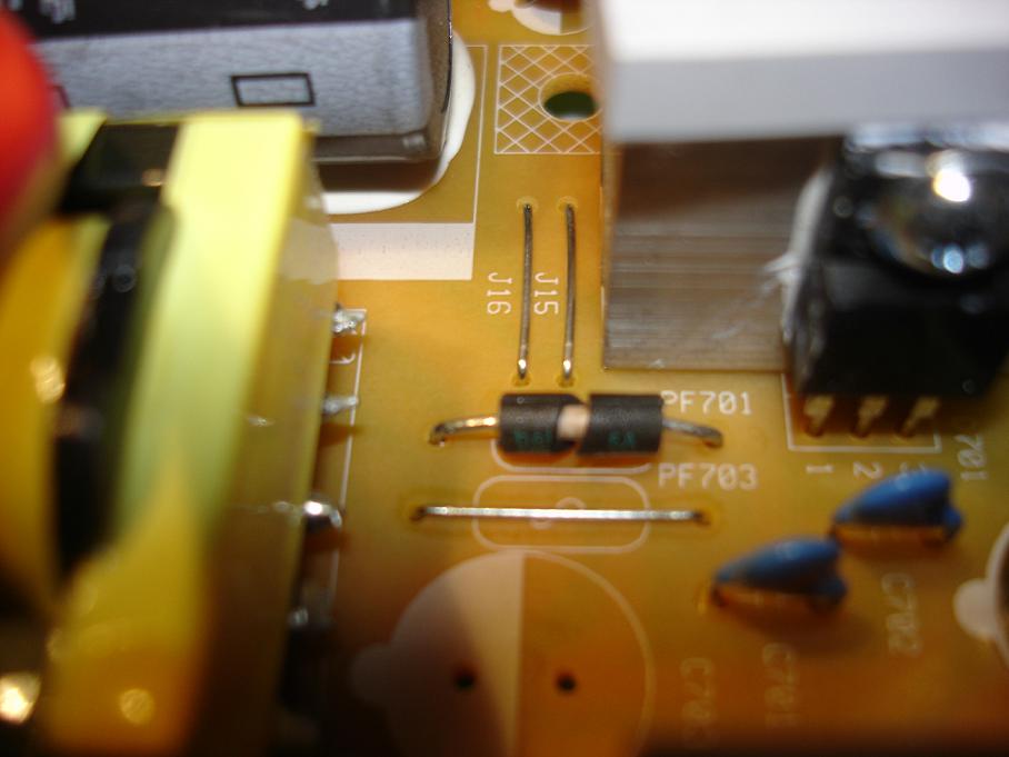

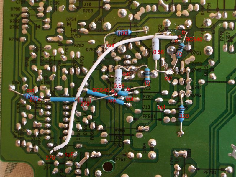

                  Some have asked for PCB photos. Well I have just fixed and modified another monitor and taken photos.
                  This monitor was received with a damaged ribbon connector. This is usually because the release mechanism is not understood. To release the ribbon cable lift /rotate the black locking bar outward from the centre of the top edge. Do not force.

                    Having now repaired and modified two Q7T3 monitors I can say with reasonable certainty that the failure of the 2SC5707 transistors is due to a weakness in the transistors. Testing of inverter transformers has found no shorted turns and no other cause of failure.

                                    And low and behold one of them was shorted no voltage drop with the diode testing function of my DMM 0.00 volts. Ironically enough the other 3 of the 4 transistors tested just fine.
                                    I will replace them all but you say that the cause of their failure is due to an internal flaw. In that case would you be able to recommend another transistor to substitute it?
                                    Also another thing one of the pico fuses was cracked it still had continuity but it was cracked. Its 5 amps buy what voltage should I get?

                                      From my experience the failure is only the 2SC5707 transistor. See my most recent posts in this thread ie I have not found any other component problem , only two design problems.
                                      1. The transistors are not protected from excessive current.
                                      2. Excessive current can occur or rare occasions. See my posts from 6th Nov. There is a time window that can allow corruption of the soft start circuits.
                                      Re fuse. In 17" monitor the fuse is a 3A fast PCB fuse. I use a TE5 fuse (125V) available from RS Components.
                                      Fixing problem No.1 will protect the transistor circuits. It requires some skill. Details including diagram and board photos are posted in this thread. It will protect against problem 2 which I believe is the hidden cause of these transistor failures.

                                          Well I have completed the modification that overcomes the likely hidden cause of the transistor failures.
                                          It works a treat. There is no evidence of slowstart corruption causing excessive transistor current.
                                          To summarise the monitor problem of blowing transistors.
                                          1. Only transistor failure has been found, no shorted turn transformers. Why?
                                          2. It has been discovered that if the video signal to the monitor switches OFF and then rapidly ON again the two softstart circuits are corrupted and excessive transistor current occurs. This can typically occur at post time (computer start) in fact I can recall my monitor failing right at that point of time.
                                          The best fix is to protect the transistors from excessive current with a 10uS current trip. See design detail in this thread. This protects against all fault conditions and it was this protection that enabled the detection of the cause described in 2. above.
                                          For my better understanding a 1 sec clamping circuit was introduced to stop the video signal returning rapidly and disrupting the softstart circuits ie allowing them time to reset.
