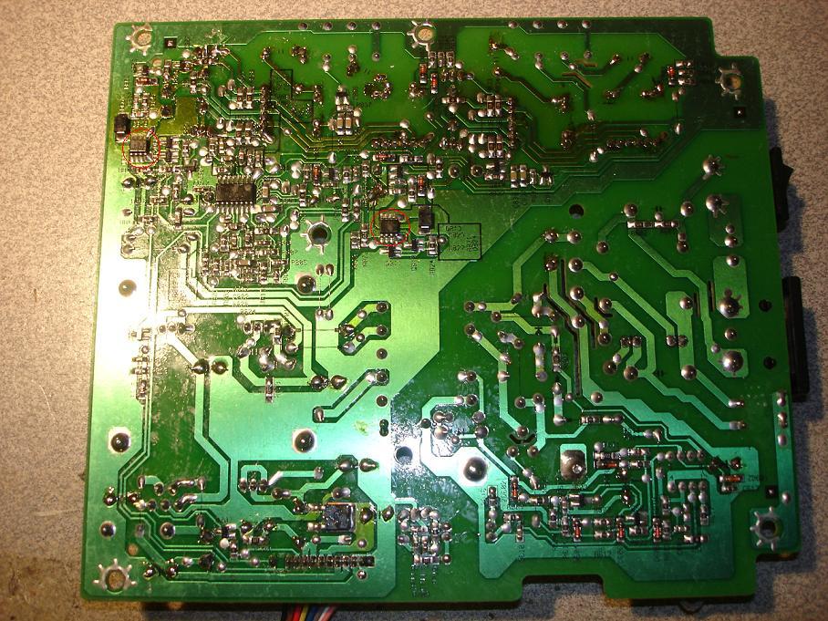

    I have read elsewhere on the Internet that another theory about the transistor blowing is that the joints on the HV transformers are cold which causes the transistor to come to an early demise.
    Other sites are simply saying remove the old solder on the transformers and resolder the joints and you're all set.
    Does this sound possible or is it just crap?
    I do agree that at least on my board the solder joints are all crap. Yesterday I gently bent back a transistor (like I've done many times before) to read its number and before I could even get a little pressure on it snap the solder joints just cracked.
    So I don't dispute the fact that the solder joints are below average.
    I attached a picture of my inverter board to this post its manufactured by Benq 48.L1A02.A00. I'm just curious if it looks familiar.
    Also if you look at the picture the board is a little darker around the HV transformers I hope thats normal and doesn't mean that the HV transformer got cooked.
    FYI I took this pic before I started recapping I will be getting rid of all those Elite and Lelon Crapacitors very soon.

      Krankshaft. The PCB photo shows a number of similarities like the same inverter transformers.
      Re Soldering. I can only go from my experience in that the two monitors I have processes have not had soldering issues and the transistors have failed. But the PCB quality is poor in that the copper track too readily lifts off the board when a soldering iron is applied. There will be plenty of speculation about the transistor failure but few, if any, have witnessed the excessive transistor current problem that I uncovered due to the implementaion of the fast overcurrent protection circuit. It would be rare to have bad soldering in the tightly controlled one pass flow soldering process used on these boards.
      Do not be concerned about the colour change of the board, it may indicate a hot spot, but leave that for the moment. Changing out those caps will be useful but there is no link to the transistor failure (caused by either excess voltage or current). The transistor failure seems to occur for no apparent reason, this is supported by what I have discovered, an occasional excessive current in the transistors caused by a limited set of conditions exploiting a weakness in the softstart circuitry.
      A fast overcurrent protection is the complete answer.
      The Benq number you quoted does not bring any results in a search. Are there any other numbers that could help? An HP number willl not , they do not provide service info.

        Well I took another look at the board and I snapped three more pics of what could be part numbers. It looks like the number I gave you was probably a revision number.
        I believe E157925 in the first pic is the part number.
        Thanks for the help.

              Krankshaft. Those photos were helpful. The one on the left shows 94V, this is a Benq model number. Unfortunately I have searched for service manuals that give circuit details. So far it would seem that I am lucky in that of all the models the FP737s (Q7T3) that I own does have such a manual.
              Therefore the simplest option for you, if a transistor is blown, is to replace the pair of transistors and the fuse. The fault only occurrs rarely, hopefully it will be some time before it happens again. It would seem that the computer post is the most hazardous time, particularly if the bios is being changed. One precaution therefore would be to turn the monitor OFF after pressing F10 and Enter following a bios change. Then ON again once Windows boot is well in progress.
              The 2SC5707 transistors can be found on eBay.

                                      For future reference I have circled the FETS that shut down the inverter circuits there are two one for each circuit which drives 2 CCFL lamps.
                                      Well now I've found my shutdown problem now here is my question.
                                      I think I've found a replacement MOSFET IC but would like an opinion. I have plenty of experience soldering these things so its no biggie for me.
                                      The IC has the following numbers on it.
                                      4431
                                      BP (Triangle) Probably Vishay's Logo
                                      L47C (Probably A Lot Number)
                                      Here is a link to the datasheet of what I think is a suitable replacement:
                                      What do you guys think?
                                      Thanks for any help in advance.
                                      • Krankshaft
                                        • Jan 2007
                                        • 2328
                                        #59
                                        Re: Fix for Benq FP737s 17" (Q7T3)
                                        Also please note that the Source To Drain diode next to each FET IC checks out good.
                                        And yes that is a lifted trace above the defective FET I scratched off some solder mask off of the board and soldered the new caps leg onto the trace itself.
                                        I have never lifted a trace while recapping before the traces on this board must really be crap.
