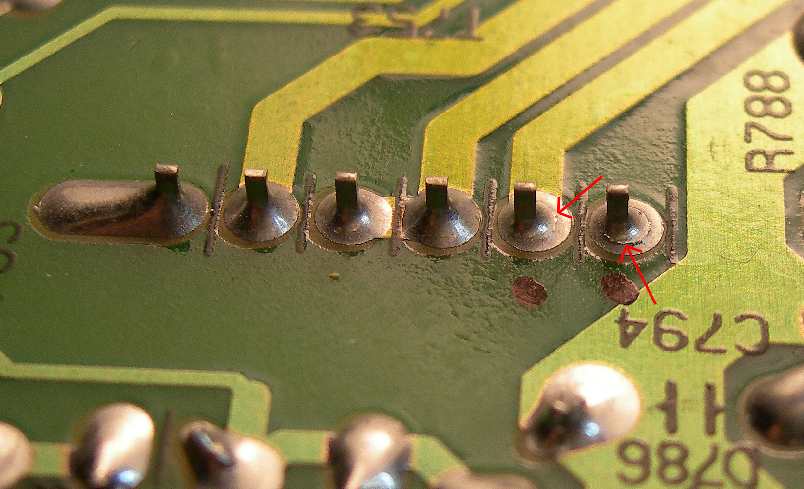

                        LOOK people! 9 times out of 10, Cold solder joints DO exist on the board. Looky what I found on mine! BE SURE TO REMELT OR (better yet) RESOLDER THE TRANSFORMERS!!!
                        btw, this is from a Dell E172FP / E172FPb

                          Well CRAP!! It didn't work! I got the kit on ebay and replaced all 7 parts and resoldered the transformers as well as resoldered a few other suspiciously lame looking solder joints. Nothing shows up on the screen now, just the power LED blinks about every 1.5 seconds AND I can hear a faint tick sound. Like what HelpQuick experienced... What is this a symptom of? what can I try next? replace all/most of the caps? Btw, I'm not an electrical guru, I just have a A. W. Sperry AMM to work with so don't ask me to test this or that if I'm not capable of doing so. Thanks
                          HEEEEELLLLLLLLP!!!!!!!!

                            That ticking sound is a symptom of the power supply shutting down and restarting. Have you checked the transistors you installed?

                              Check them, how? they're brand new...from the 7 piece kit on eBay. Would they fry instantly? Solder looks good.

                                Use an ohmmeter.
                                Yes, they can short instantly if the problem that caused them to short is still present.
