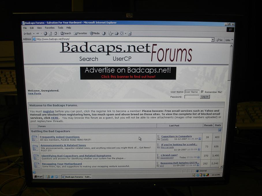

          Well I replaced the shorted MOSFET and the other working one just to be safe and the monitor is back in business.
          Both inverter circuits now shut off when I hit the power button .
          This thing is great with a 1000:1 contrast ratio.
          The only better device contrast wise that I have is my DLP projector at 2000:1 and the DLP panel on that is only 1/2 inch wide!
          The MOSFET IC was an exact replacement all of the manufacturer symbols were the same as the ones on the old IC.
          Alldatasheet.com was a lifesaver as well which found the IC for me just by typing the four numbers .
          Yet another perfectly good monitor saved from the landfill with just a few bucks.
