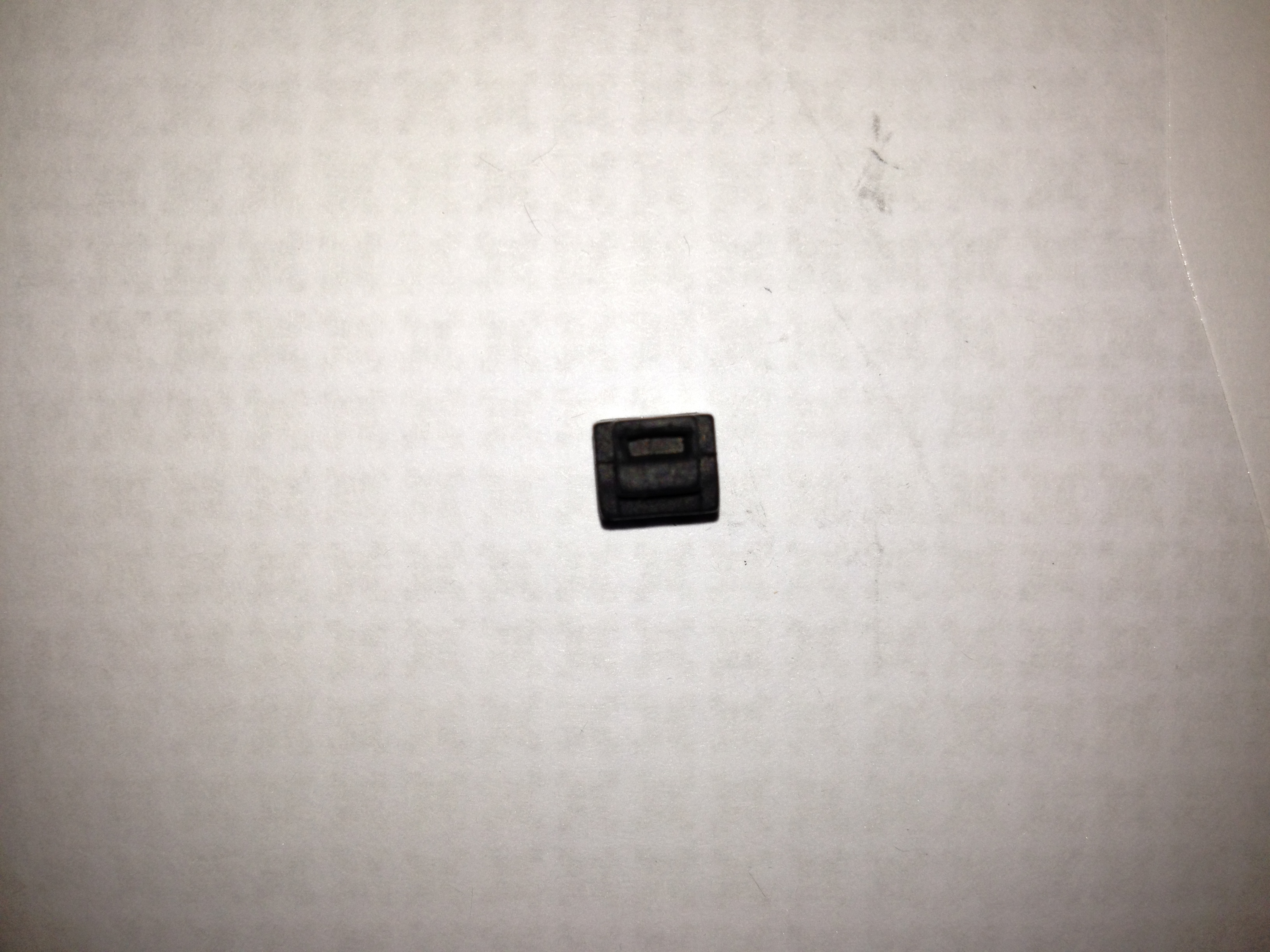

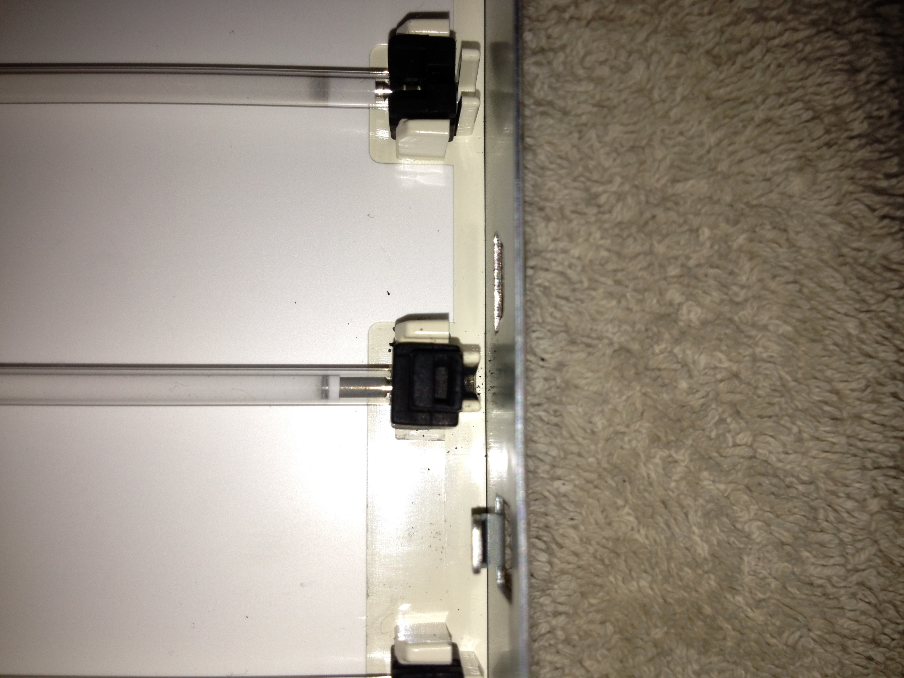

        Sorry for the delay guys.
        So it seems that this Dell is another design.
        I didn't see any wire and to be honest I can't figure out how this rubber thing is supposed to make the connection between the bulb and the inverter.
        Have you ever seen somthing like that ?

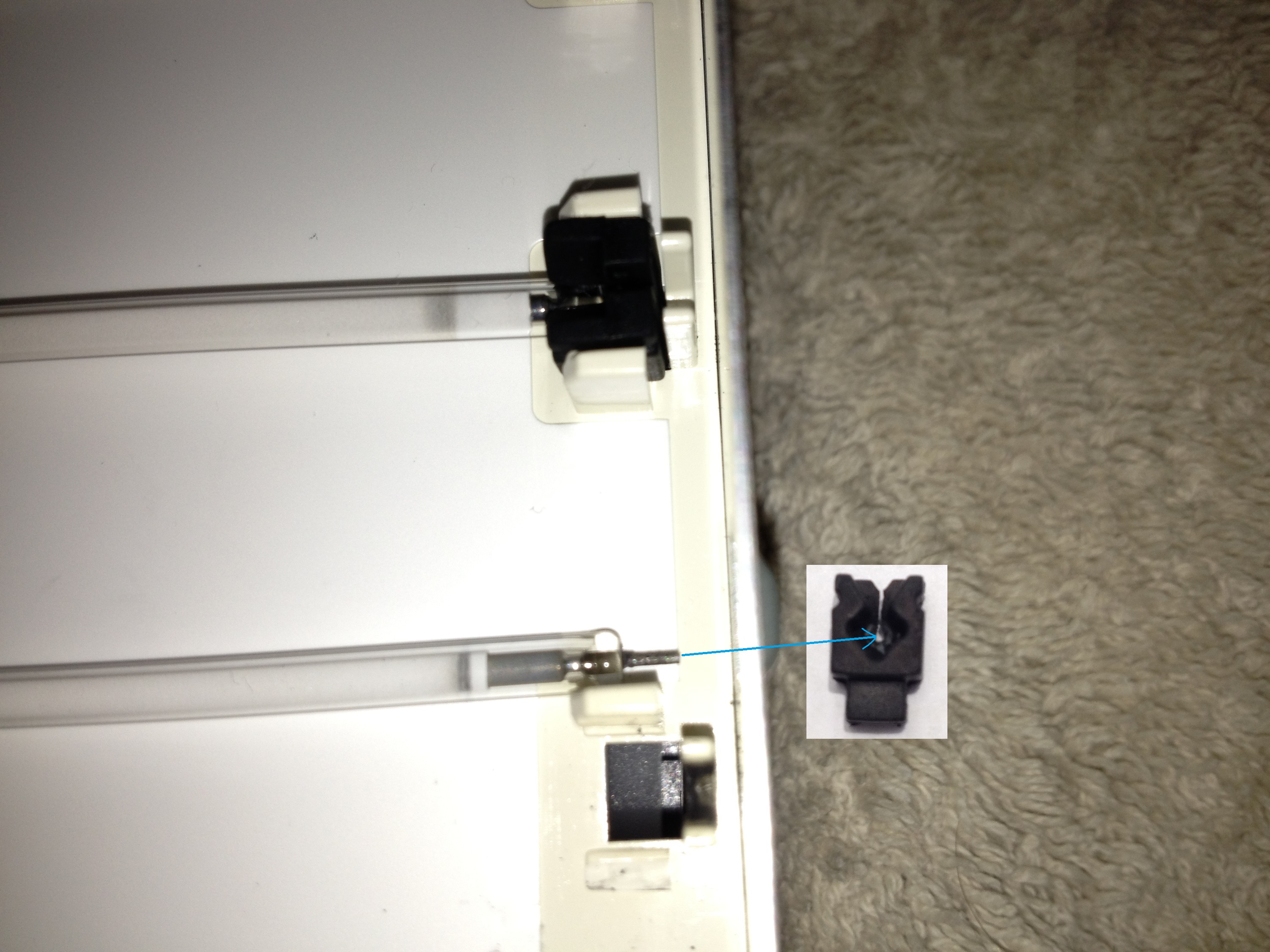

          Was there no metal on the end of tube - maybe it has just burnt away, Can you see
          metal on the other tubes. I have never seen one but putting together all the pictures it looks like the end of the tube with either a metal end or wire protruding sits in the square hole in the rubber as seen here https://www.badcaps.net/forum/attach...9&d=1415024241 then the metal pegs (shown here https://www.badcaps.net/forum/attach...0&d=1415024241 (attached to the inverter) push in at the end and touch the wire /metal end.
            Re: Troubleshoot a Dell 2209wa (will not stay on after flickering)
            Yes there is metal at the end of the tube.
            But on this picture I don't see any space where it can connect with the inverter's metal pegs.
            I think I should disassemble another rubber tube connector to figure out the difference but since I broke another plastic attachment , I'm still wondering how I'm supposed to do so. (see 2nd pic)

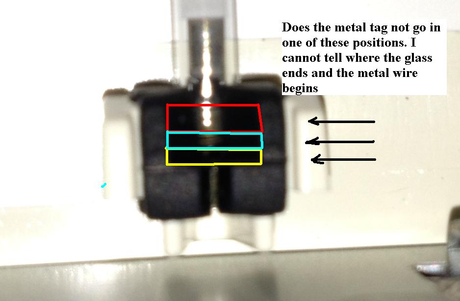

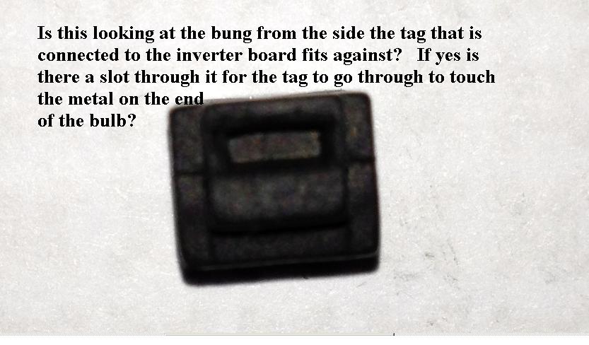

              Ok in this pic looking down onto the end of a lamp in its socket< does the tag that is connected to the inverter board slot into it. Cant tell where the glass ends and the wire begins but I am thinking it will just push in and touch the wire or push down between the end of the wire and the back of the rubber bung.

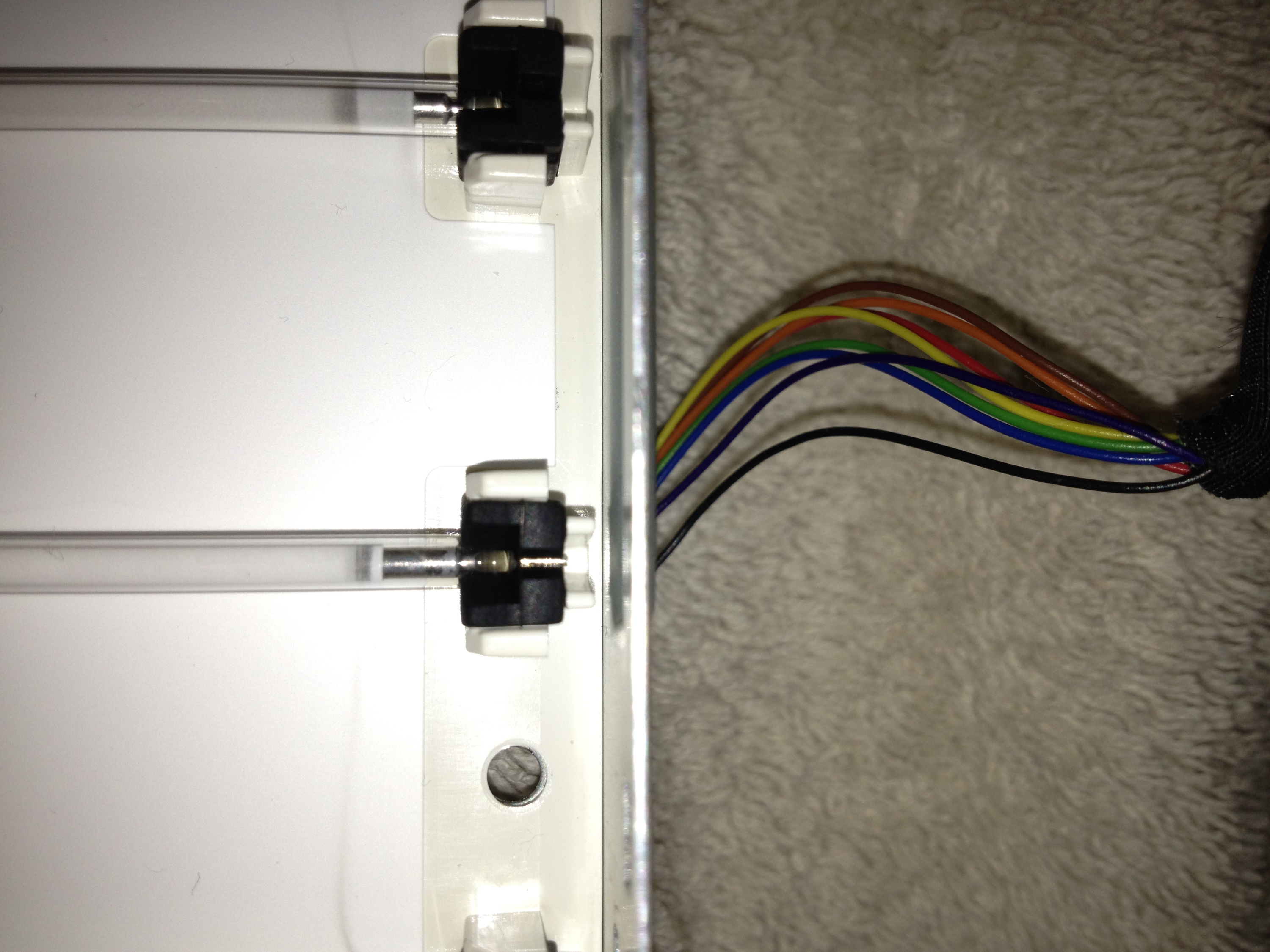

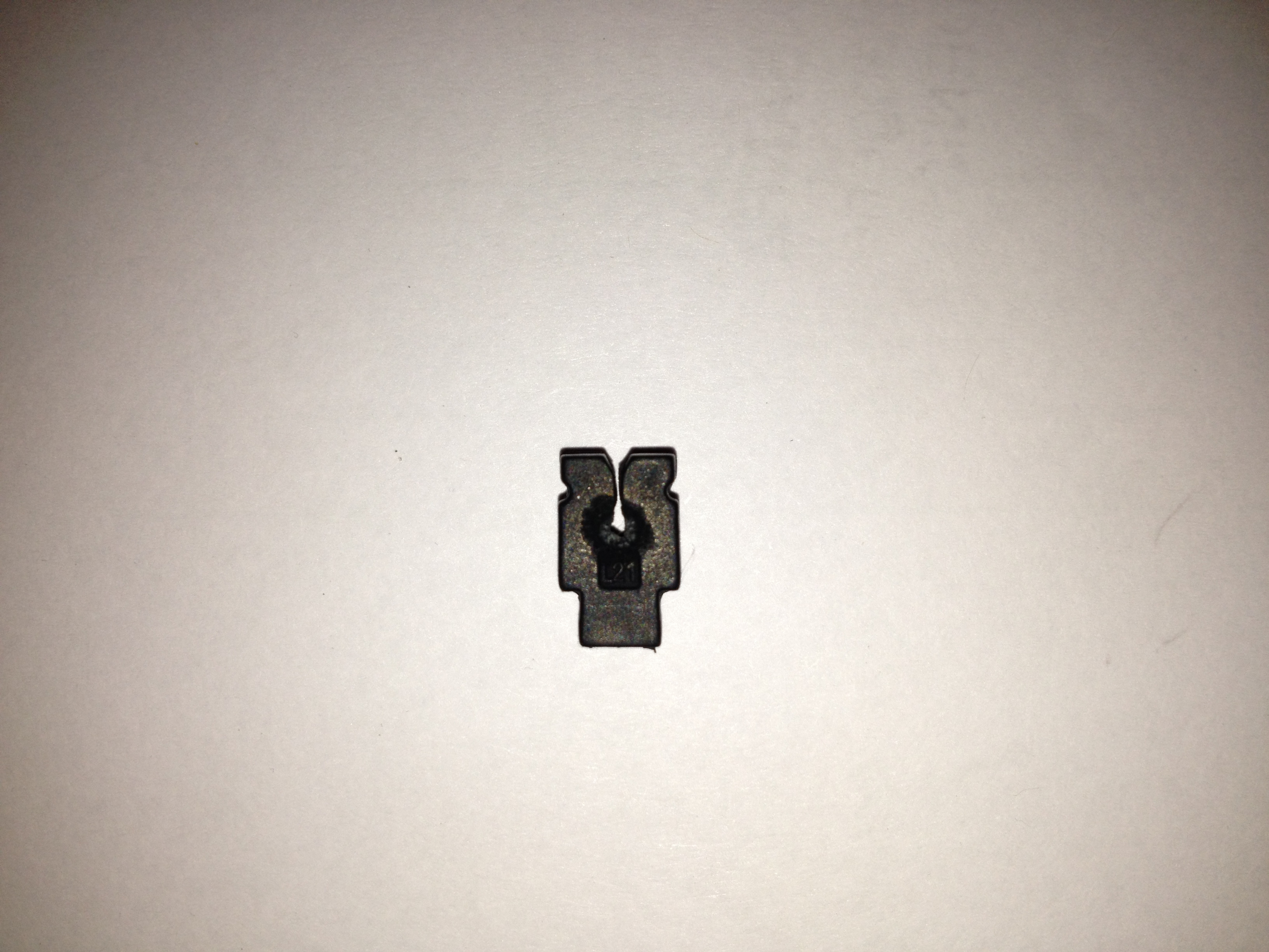

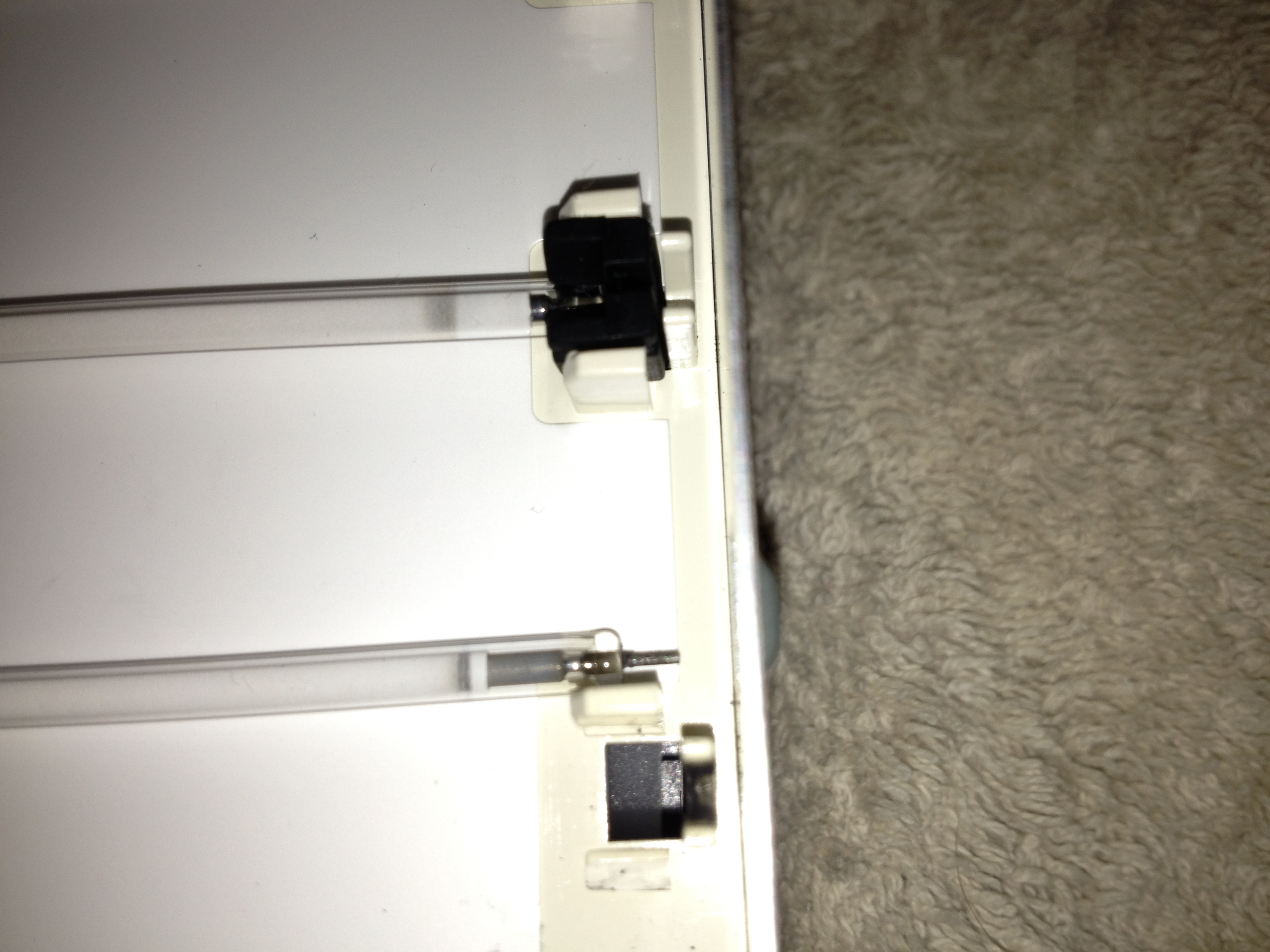

                Not sure to understand your question so I took two more pics.
                On the second picture, its the rubber slot upside down.
                By "wire" do you mean the metal end of the tube ?
                  OK Sorry you must understand I have never seen one of these before
                  The pics in the above post are from the panel side and the white moulding with the black scorch goes over the end? yes?
                  If so the metal tags must come through from the other side?
                  Yes by "wire" I mean the bit that sticks out of the end of the tube. I will refer to is as metal from now on.

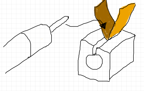

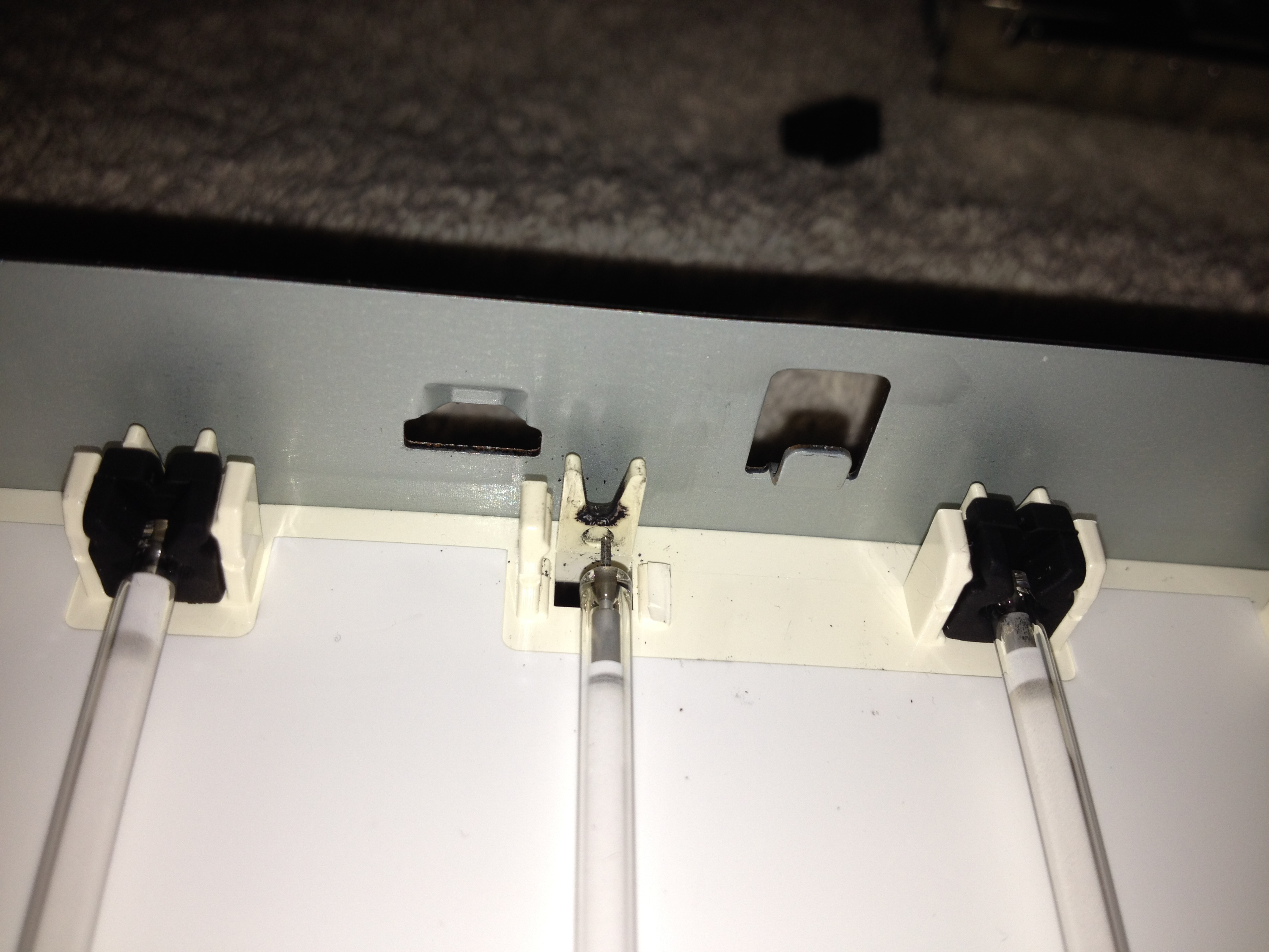

                    I totally understand It's hard for me to explain with my bad quality pictures and new vocabulary for me.
                    I drew some sort of schema with my amazing paint skills , let me know if that answers your questions.
                    LATE EDIT : I added a pic to show where the metal end of the tube fits. The problem is, I don't see how it can contact with the inverter.

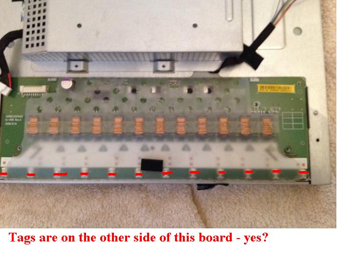

                      Ok your pictures are great its just hard to explain when I didnt really know how it fits together .
                      You now know how the tags on the board go through frame through the rubber and touch on to the metal ends of the lamps - Yes? or No?
                      The tags (I believe ) are on the bottom of the inverter board - under the opaque plastic Yes? or No?
                      See Pic
                        And it seems to be a very uncommon design
                        I don't know how the tags* can touch the metal ends of the tubes no.
                        Unless this "rubber" slot is actually made of conductor material Is it possible ?
                        *here we are referring to the metal connectors on the inverter board, right?
                        See Pic
                        Yes !

                            #33
                            Actually I tried with the inverter tag itself to see how the contact was made, and couldn't see it goes through.
                            I don't have a multimeter at the moment so I hope elagil can help us on this
                            EDIT : Damn, we had the solution since the beginning
                            Originally posted by elagil View Post
                            Yes actually the connectors are made of a special type of rubber which is conductive. This rubber might lose contact over time and cause arcing which leads to audible noise and charring.
                            Now, I will take a picture tomorow, but I'm afraid the faulty connector is too badly damaged...

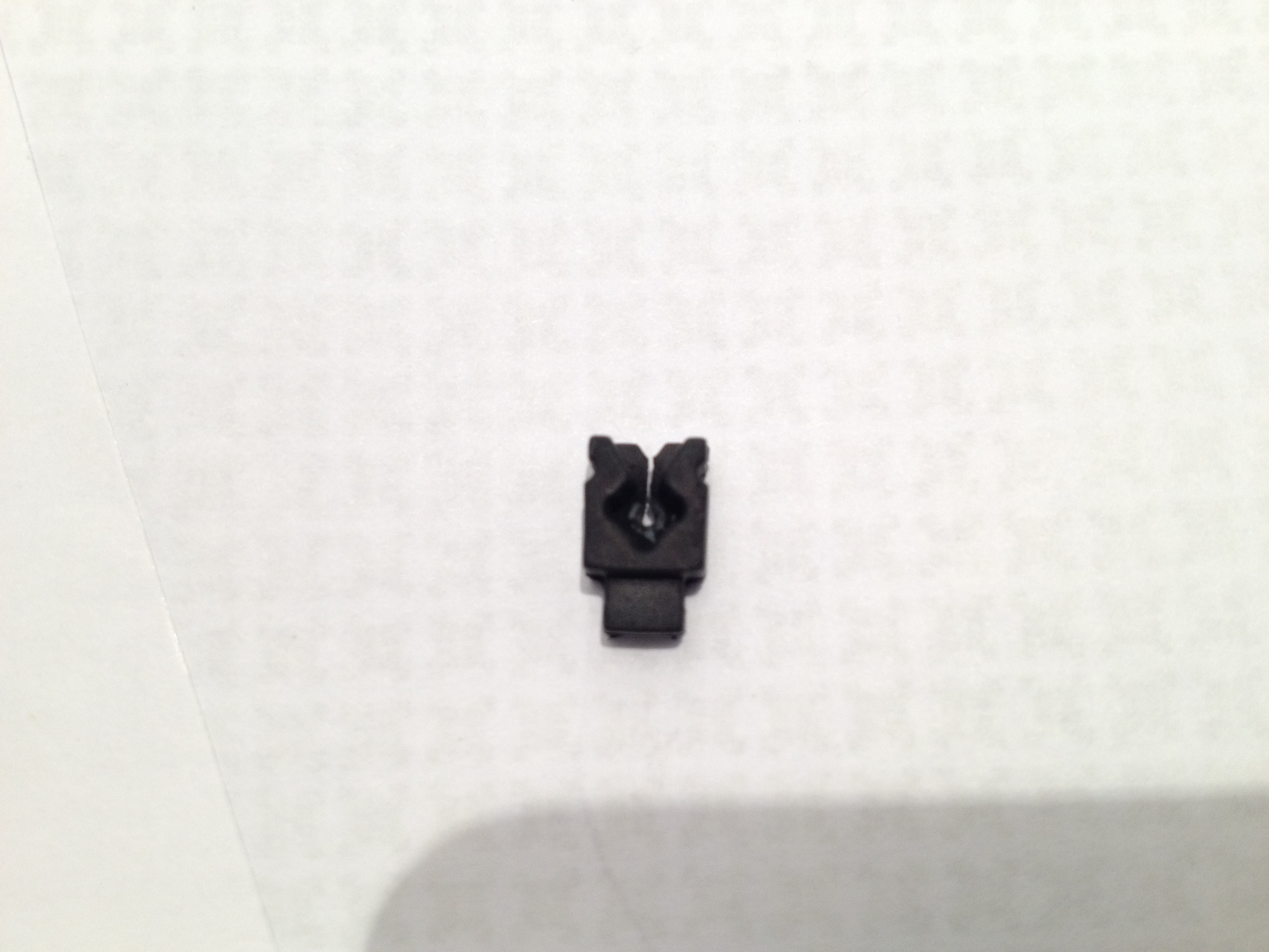

                                Sorry for the picture quality again. Basically, the arcing damaged the part where its touching the metal of the tube.
                                So you think I can fix this with epoxy ? I never used this before.
                                  #36
                                  I thought you meant the plastic bit - I can see that is broken in one picture.
                                  Whilst you can buy conductive epoxy, I dont think it would work.
                                  There is this: http://www.ebay.co.uk/itm/Wire-Glue-...78f71#shpCntId
                                  Perhaps send a message and ask if it will stick to conductive rubber.
                                  Other ideas - is there any way you could solder a wire to the metal on the bulb and
                                  get it out through the frame to the inverter board ( to supplement the rubber and tag
                                  not replace it)
                                  Does the damage mean the metal on the tube doesnt make contact with the rubber.
                                  do you thing wrapping the metal with wire and soldering in place would increase the size
                                  enough to make it have better contact with the rubber.
                                  Did you test the rubber get - meter on ohms to see if it is still conductive between where the metal on the bulb touches to where the tag touches.

                                      #38
                                      Sorry for not paying attention.
                                      I used some solder wick: http://www.hobby-bastelecke.de/bilde...loetlitze1.jpg
                                      I cut a small piece (like 1cm) and folded it so that it formed a "V". I placed that piece of solder wick on the rubber part with the point of the V facing towards the cutout from above.
                                      Then I took the tube and pressed its wire inside the piece of solder wick until both the wire and the piece of solder wick were hidden inside the rubber piece. This added material helps to make better contact.
                                      I hope the explanation helps you imagine how it can be done. You can use any other conductive material. Copper might not be the best choice as it oxidizes quite quickly. Still the resistance of the piece of rubber is quite high (around 10k if I remember correctly) so this is not too critical.
                                        #39
                                        I drew something awfully ugly but it might help.
                                          #40
                                          It's some beautiful piece of art
