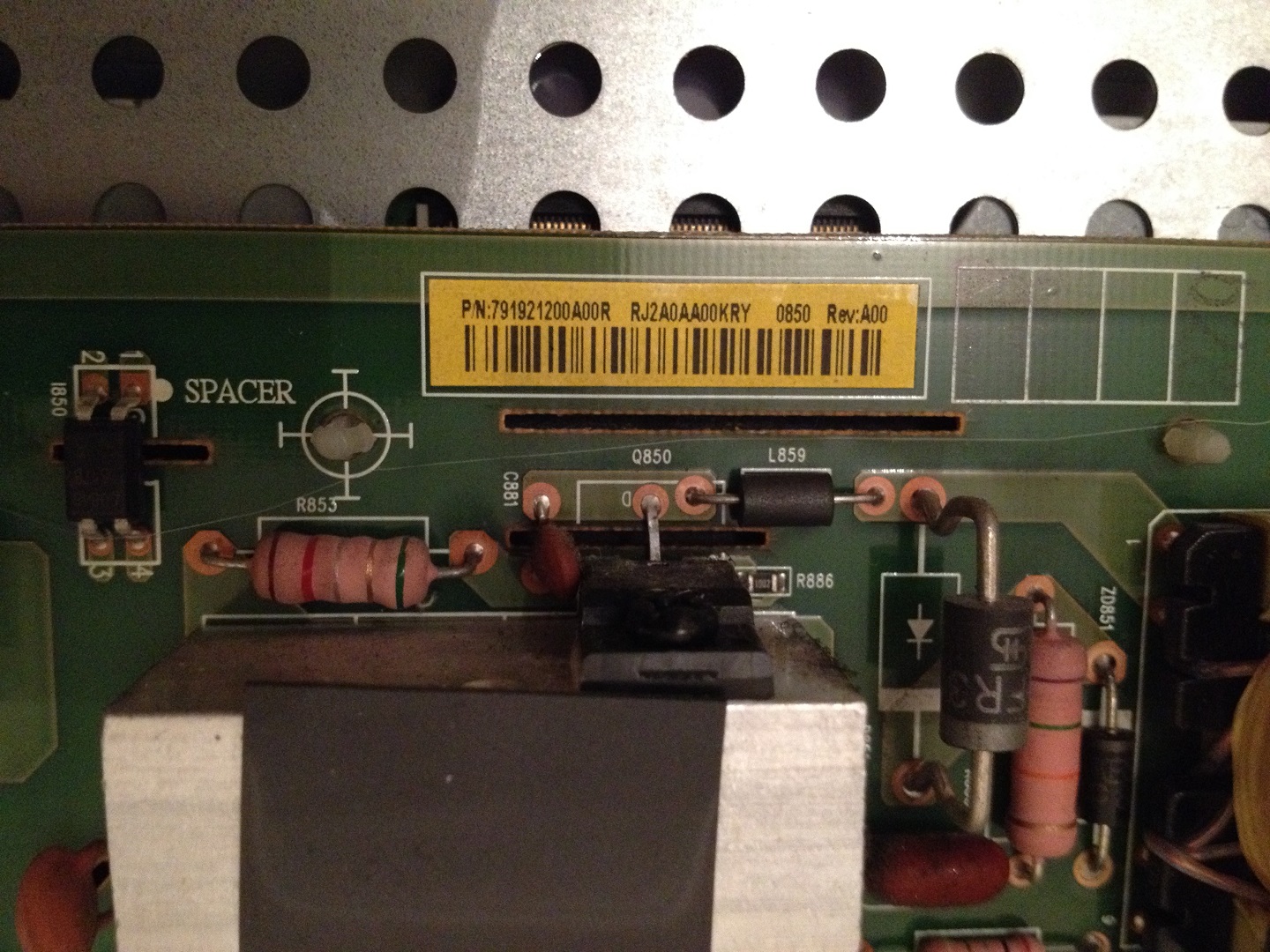

    Hello to everyone,
    I'd like to know if someone could help me troubleshoot a Dell 2209wa.
    First minor issue I had a while ago : http://nsa33.casimages.com/img/2013/...2213214990.jpg
    Then the screen started to "flicker", and few days ago I could hear a strange noise on the top right corner.
    Now the screen will only stay on for like 2 seconds (with a perfect image) before shutting himself down. (power button's led still blue)
    I have read retiredcaps's guide but I couldn't see anything on the screen by shining a flashlight on it. (iphone's flash is enough ?) and I still could hear a strange noise on the board.
    I've disassembled it to see if there was any melted capacitor but I couldn't see any. Maybe some "burned" areas on the power board (orange circle) ?
    Here are the pictures : http://imgur.com/a/v8etk
    How can I troubleshoot this ?

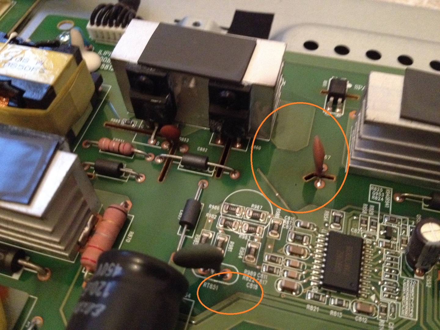

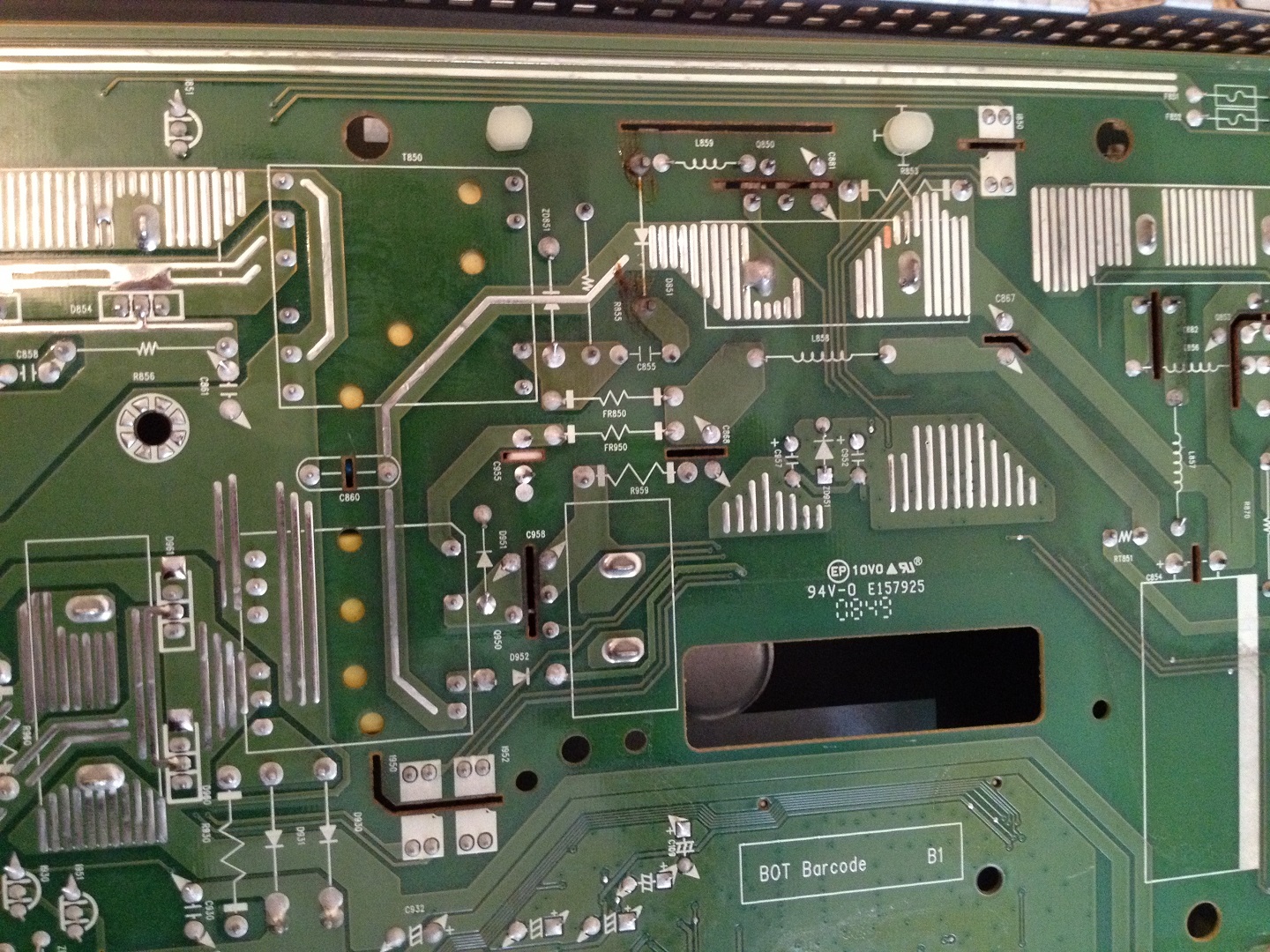

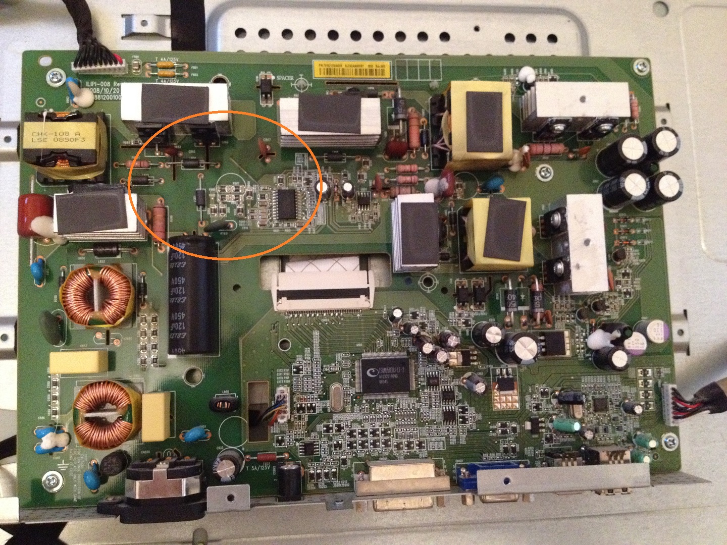

    I'm pretty sure there is an issue with the power board, but I don't know how to find the problem.
    Since I don't own an ESR meter, should I replace the capacitors (if yes, which ones?) or can I test the power board with a multimeter ?

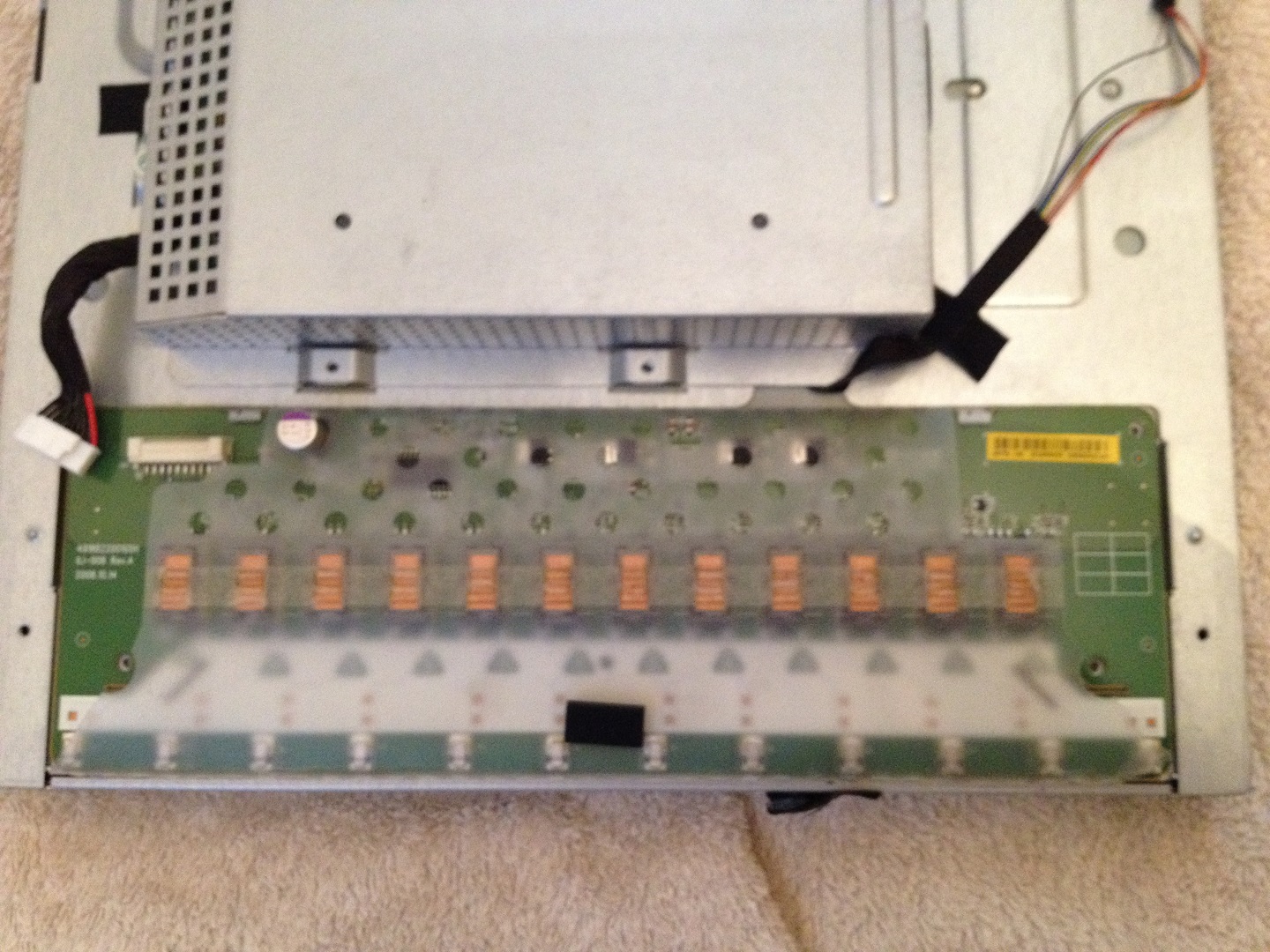

        I added the inverter picture. Correct me if I'm wrong but other pictures are the main board (power&logic).

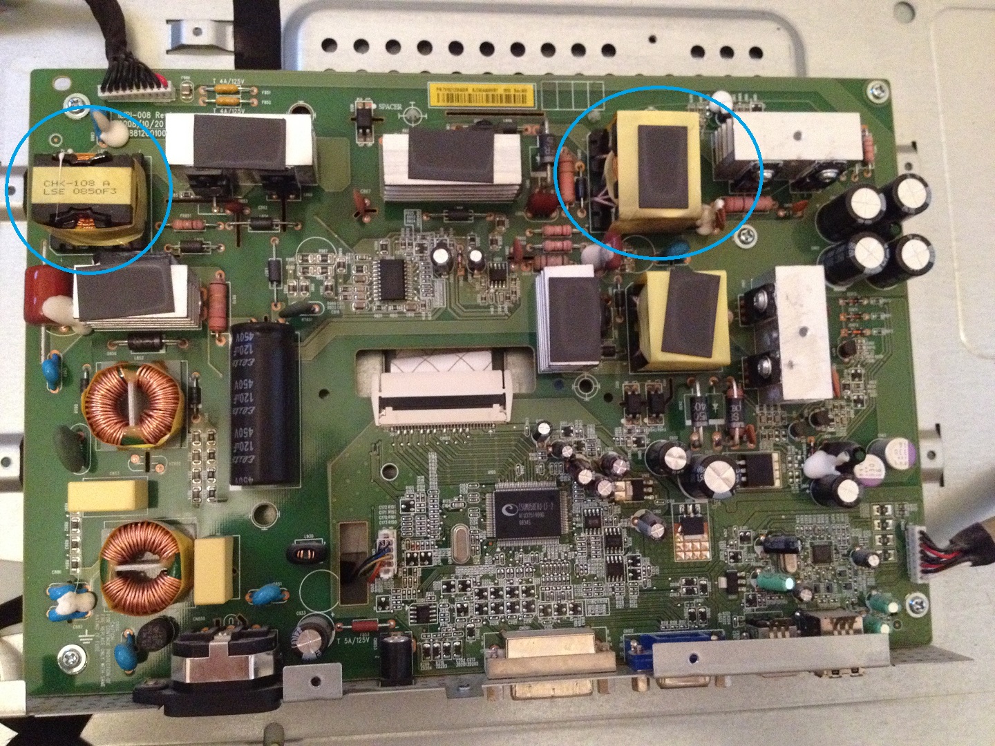

        I recorded the sound (.zip attached file) :
        @~3s : The "click" is the power button, then you can hear a high pitch hissing sound for 2 seconds until the screen shuts down, then a "buzz" the rest of recording.
        If I had to say where it's coming from I'd say from the two components circled blue, but I'm not 100% sure.

          If the hissing IS from the transformers you have marked this is sometimes because they are outputting power that is not being used as the lights are not working.

          The picture of the inveretr board is not clear enough - can you list the board numbers
          for each board.

            Also, on the 3rd picture of post #2, the "burned" diode's bounds is usual ?

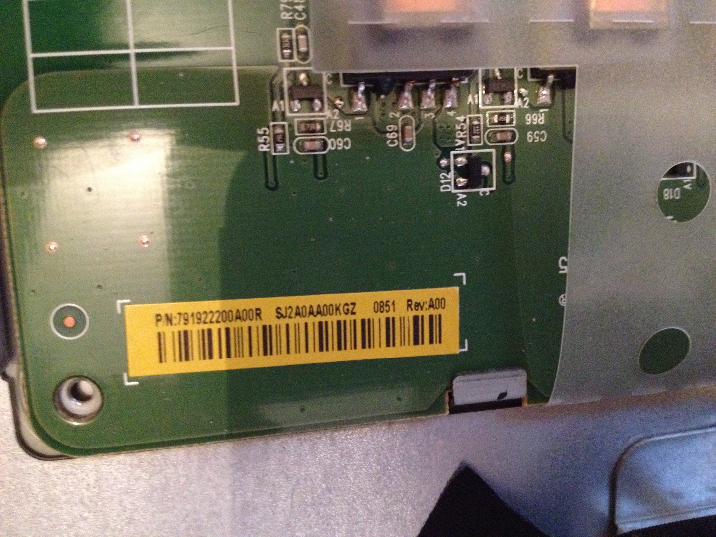

            PS : Main board and inverter numbers attached.

              Re: Troubleshoot a Dell 2209wa (will not stay on after flickering)
              Not sure they are the numbers you are looking at though.
              Here are the other refs :
              Main board = 491881200100h
              Inverter = 491882200100h

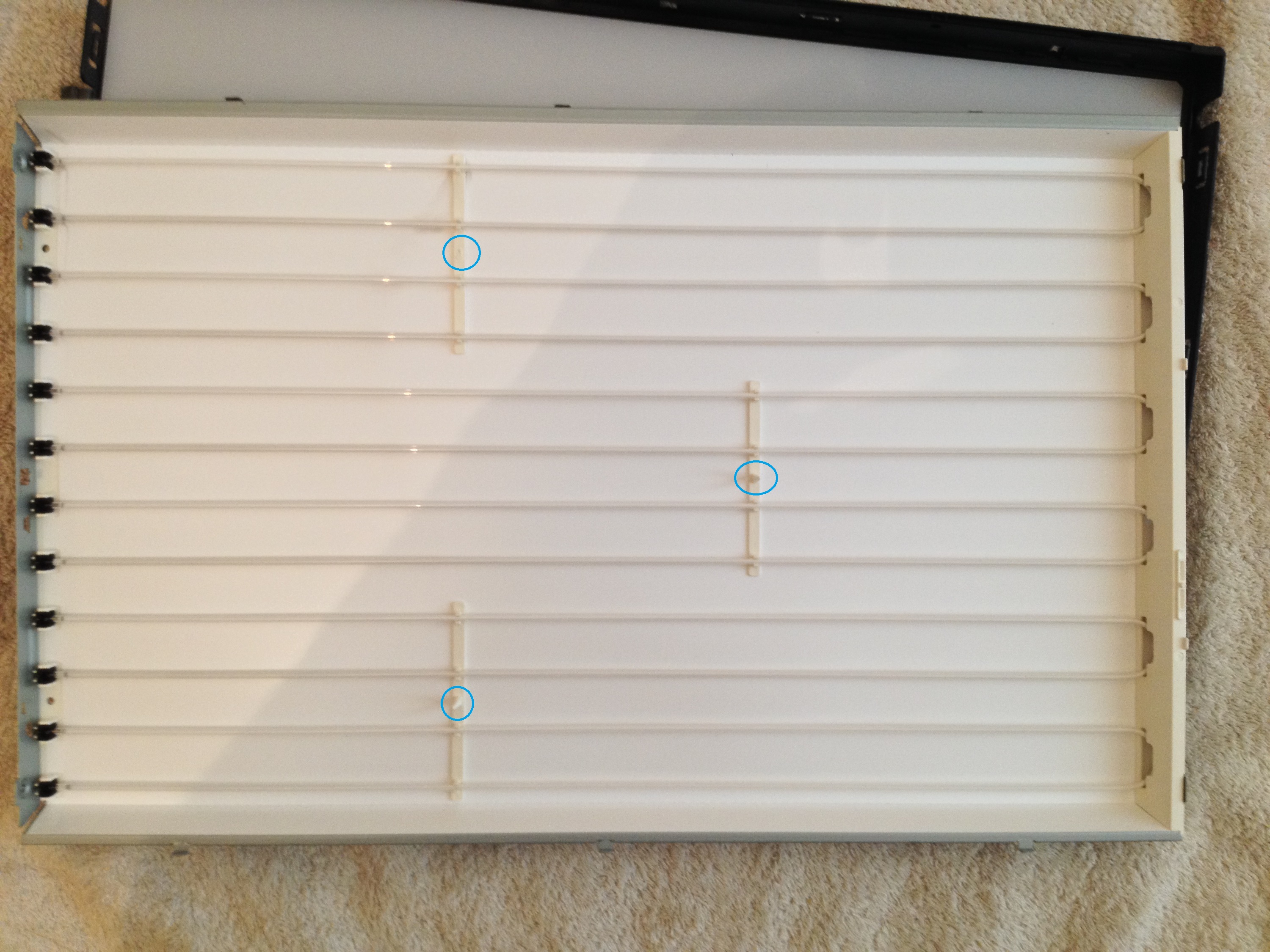

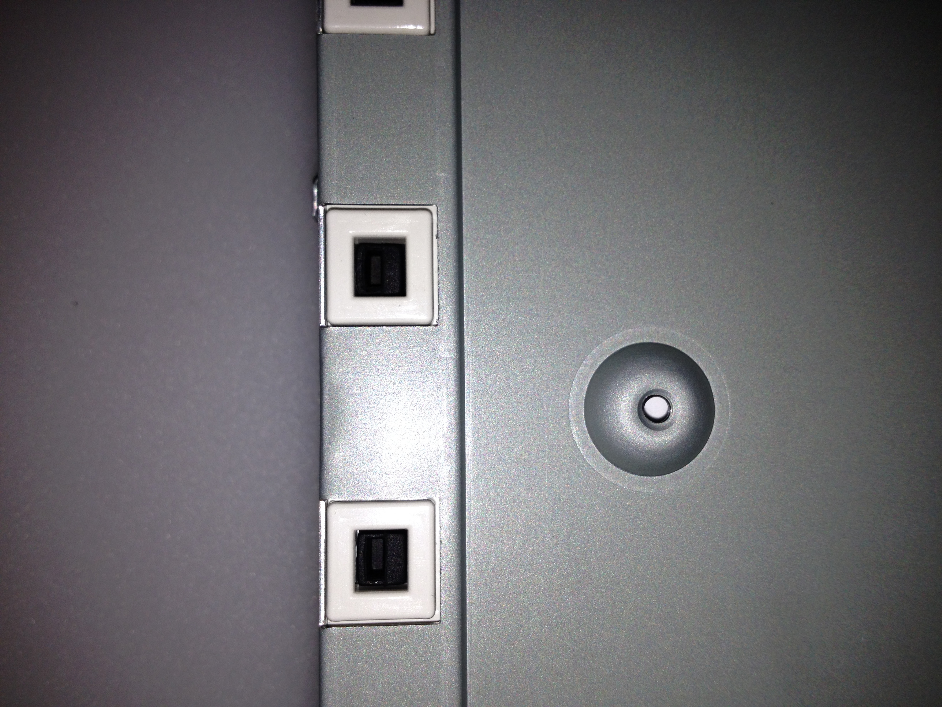

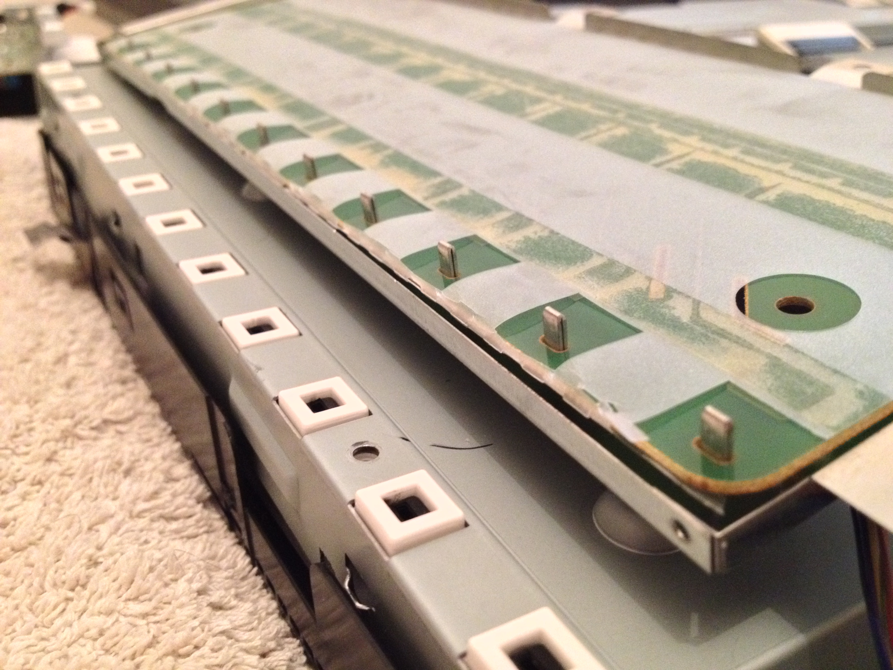

                              Ok so I've reached the backlight part and unfortunately wasn't able to spot anything suspicious...
                              Worse, I think that if it's an inverter/backlight connectivity issue, there's not much I can do due to the design.
                              See the attached pictures.
                              Maybe it's an inverter issue ?

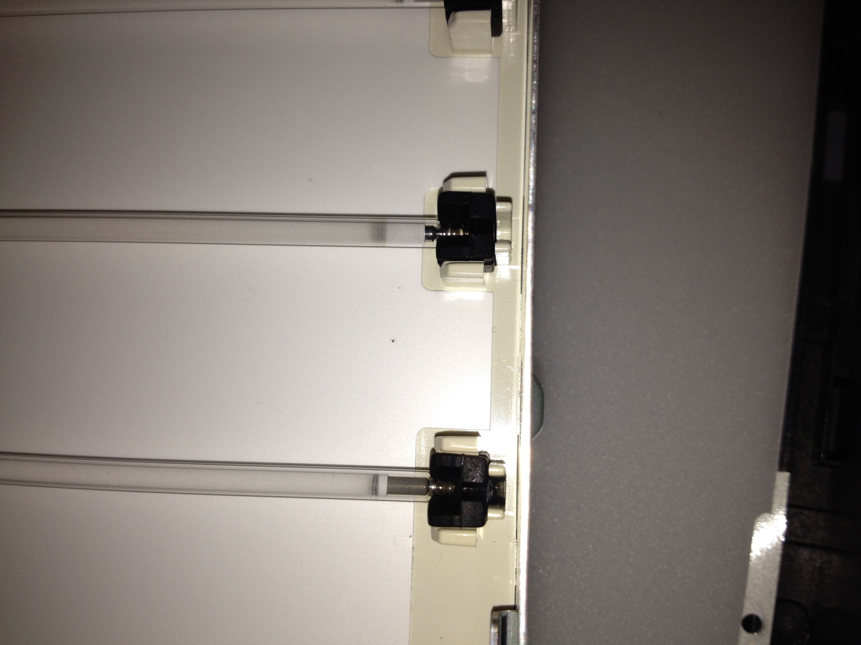

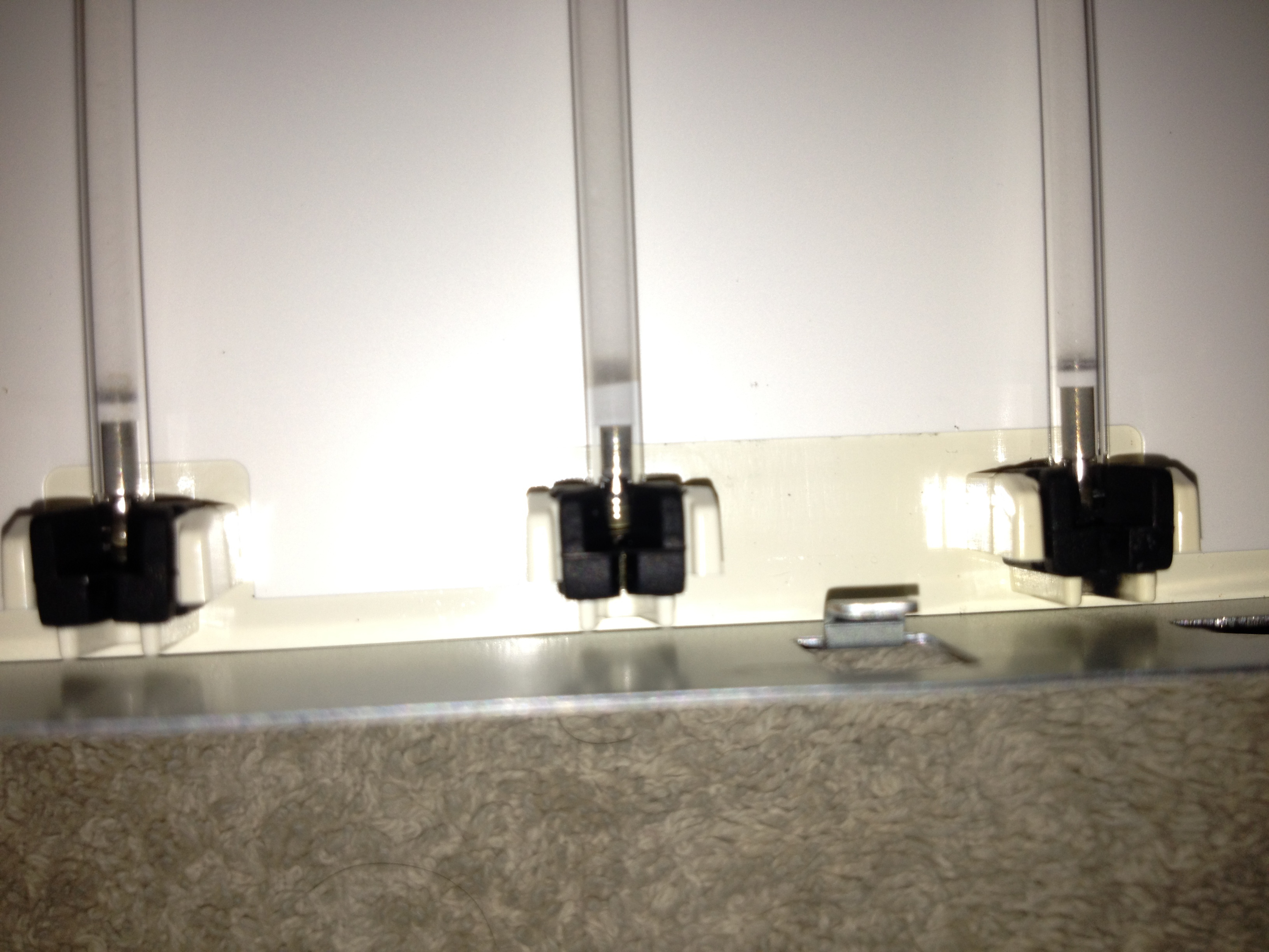

                                Guys, I think I just spotted something very interesting, and you were right since the beginning
                                On the 1st pic you can see underneath the connectors's plastic protection.
                                On the 2nd, the corresponding connector compared to another one.
                                Problem is, I have to idea how to fix/clean it
                                  Very nice! Just lift out the tube that is affected (lift close to the rubber socket for the least stress) and clean the connector with a cloth and some alcohol or something similar (I used acetone). You can (and should) also lift out the rubber pieces and clean them with water or something that does not harm the material.
                                  I advise you to lift out all of the tubes and briefly check the wire that comes out. If one is already charred, it might cause the monitor to fail again.

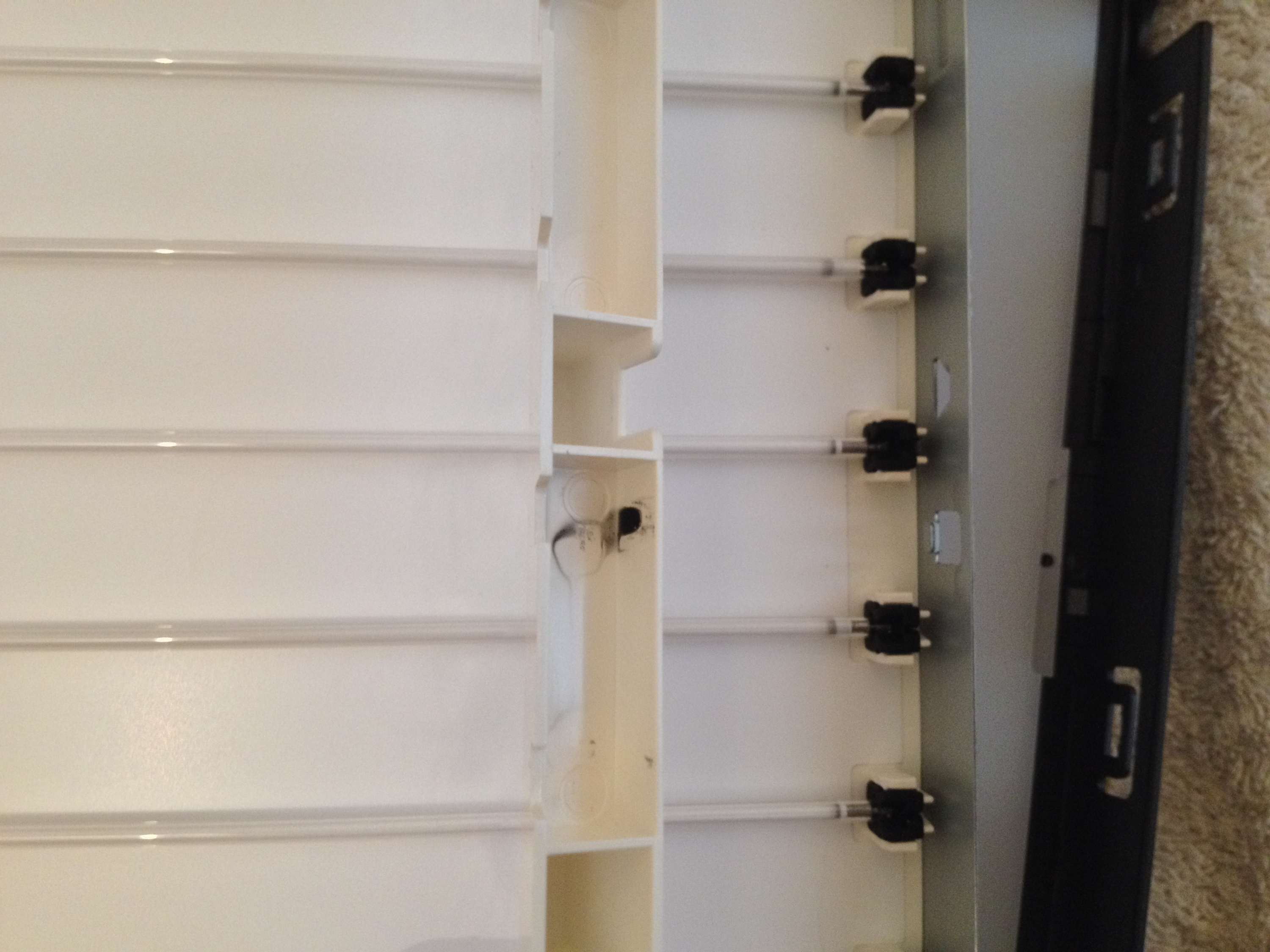

                                        Two quick questions before I proceed to the actual fix
                                        1/ I broke one of the plastic "thing" on the backlight part. (See attached file)
                                        Is it ok to fix it with some super glue ?
                                        2/ Living in Paris, there was no way that no dust comes in. What's the best way to clean it ? (I'm worried to use compressed gas because it could spray some "frozen liquid")
