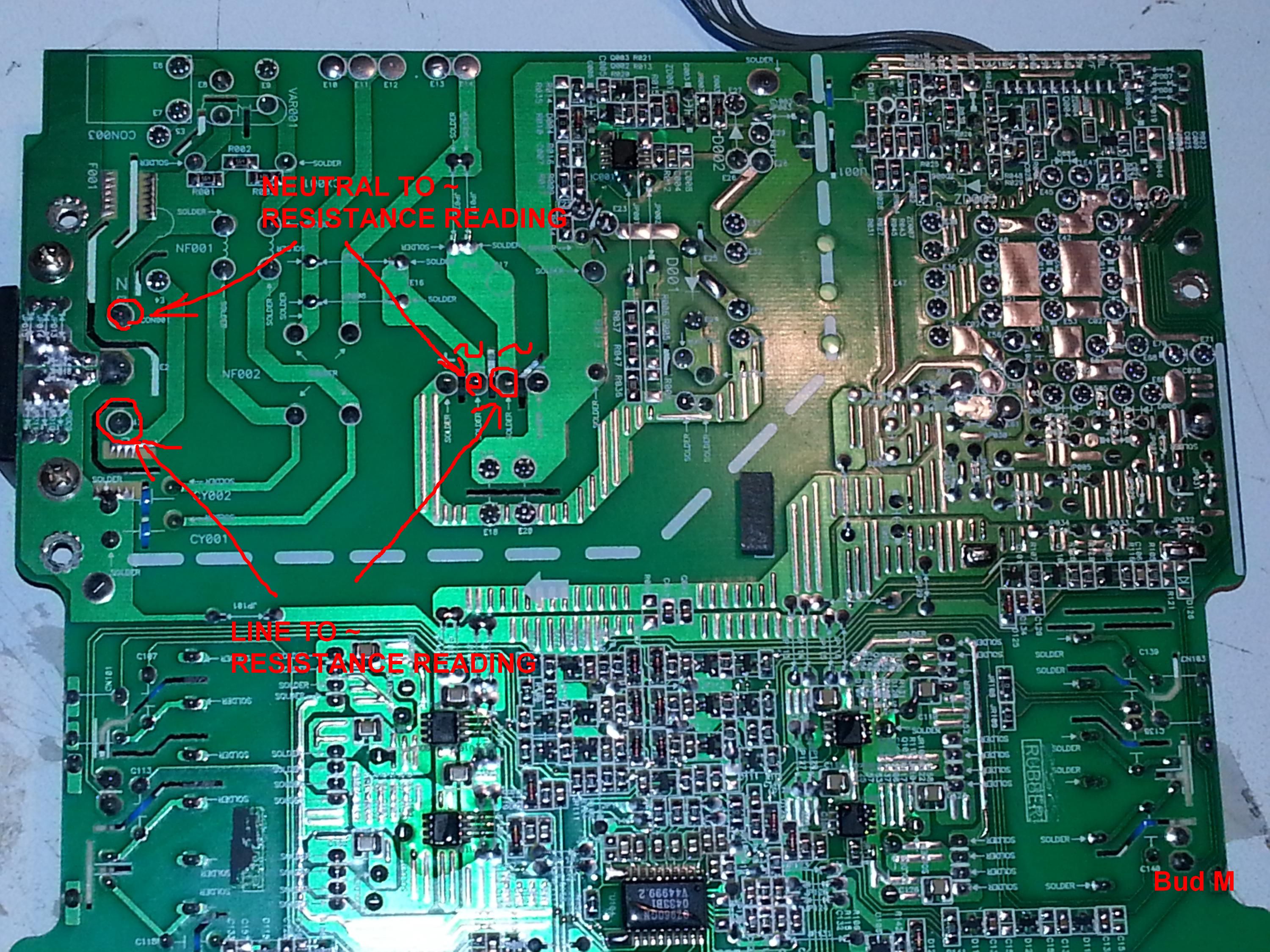

    Or just do resistance reading from the L on the IEC inlet all the way to the ~of the bridge, same for the N on the IEC inlet all the way to the ~ of the bridge.

      OK I tested just to 2 points on the bridge rectifier ( between + and -) and I dont get any reading at all.
      Didnt see your post budm, I did check resistance between those 2 points
      Live resistance 10.0
      Netural resistance 1.6

        "OK I tested just to 2 points on the bridge rectifier ..." i don't understand, tested how, voltage, ohm? between which points?
        "Live resistance 10.0
        Netural resistance 1.6"
        ohm? Megaohm??
          Re: IBM Thinkvision 6736-HC9 No power
          I hope those are in Ohm, if that is the case you may be OK. The Neutral to ~ of the bridge is good.
          The Line to ~ of the bridge is 10 Ohms is due to the Thermistor (I do not know the value, you need to look at it) is may or may not be OK, but since we do not have open circuit between Line or Neutral to the ~of the bridge, then you should be able to see 120VAC on the two ~ pins of the bridge at this point.

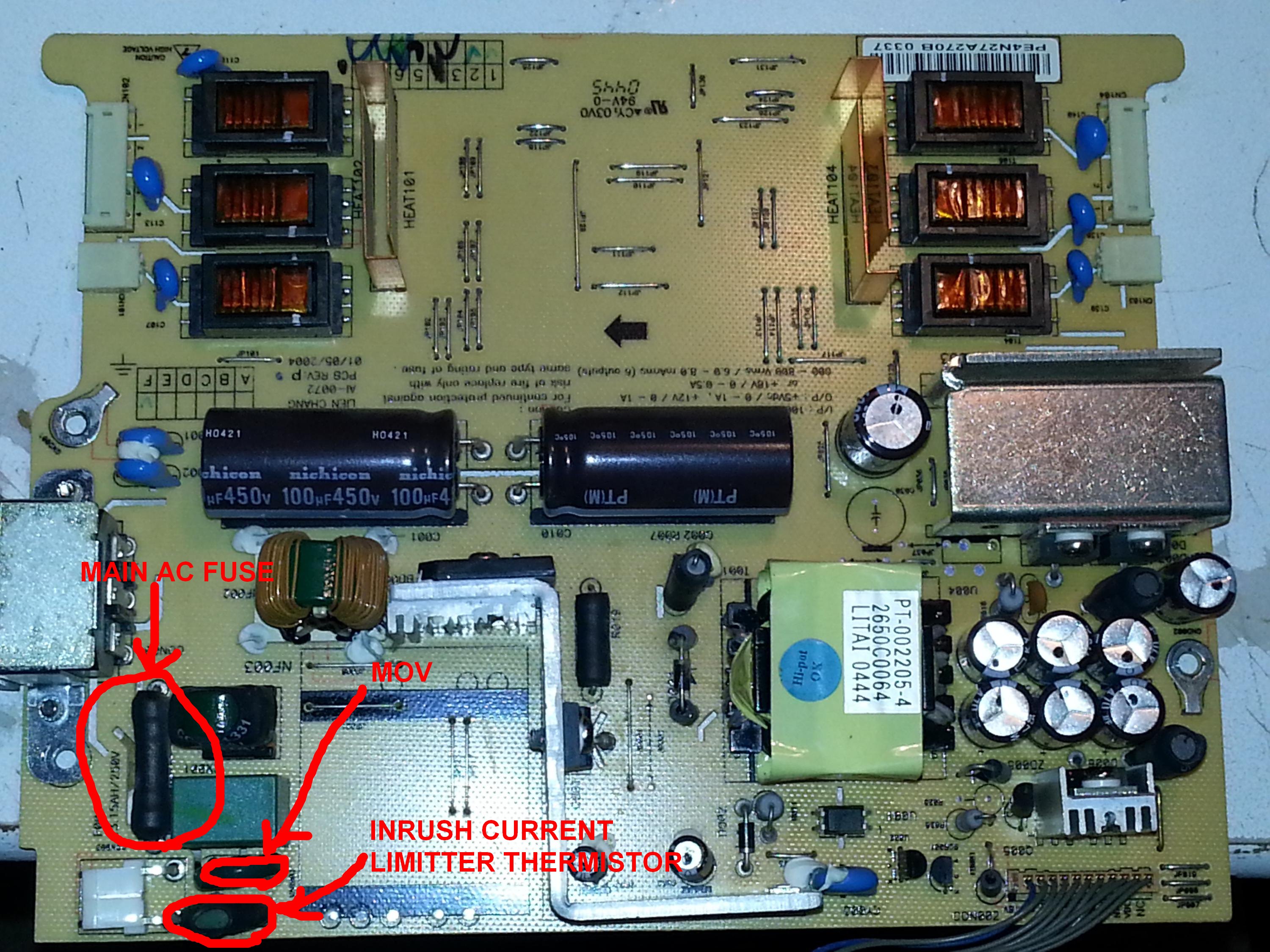

            yes that's ohms, I had the DMM set to 200. I flipped the board over to look for the Thermistor (TH) I couldn't locate. Where about should it be?
              Thermistor. So at this point, do you get 120VAC at the ~ pins?

                I removed the heat shrink wrap from the thermistor and this is what is printed on it-
                SCK
                086
                I am getting about 117VAC at the ~ pins. It jumps around a little but not much 116.8-117.4 VAC

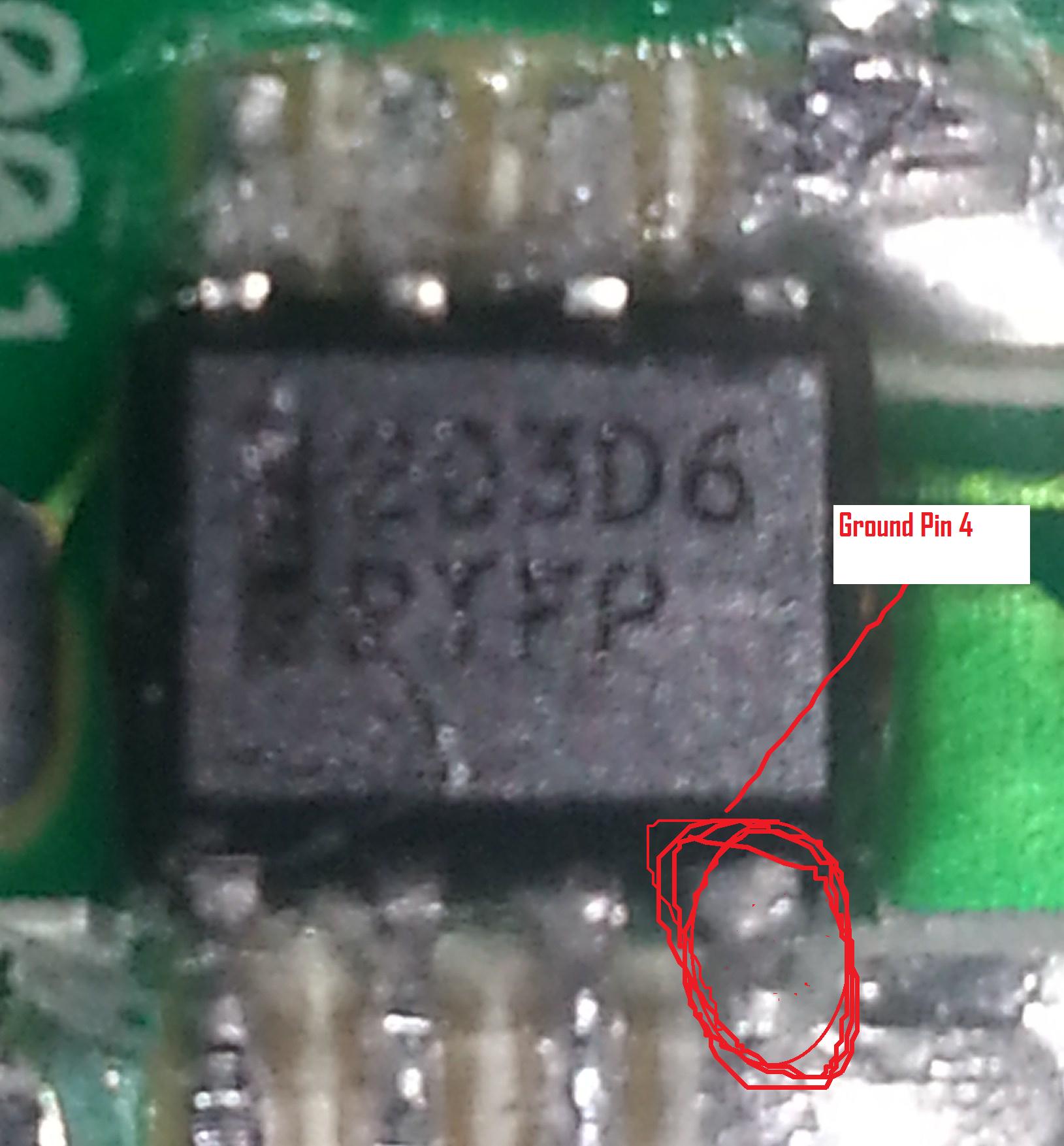

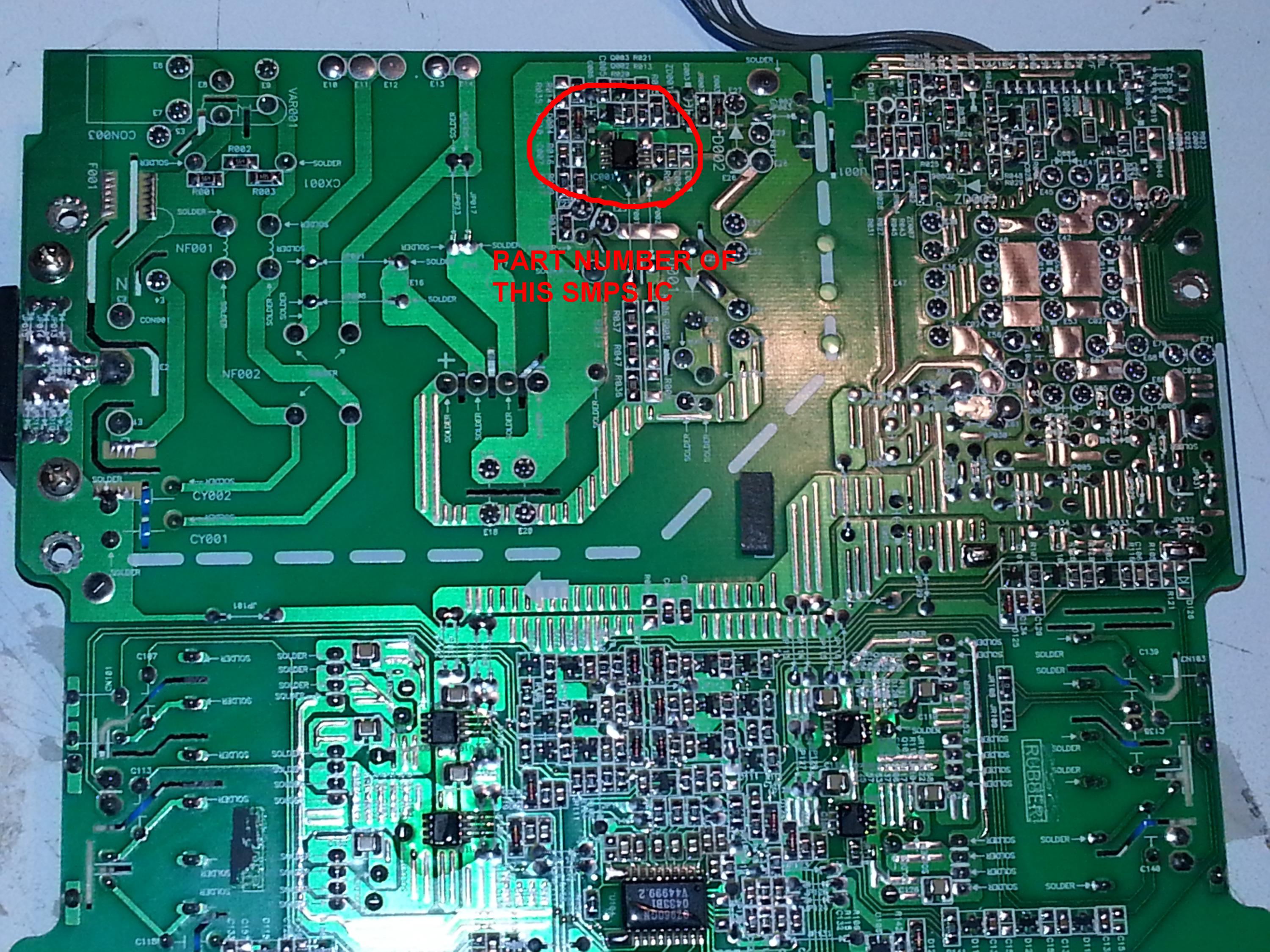

                      OK, that was a long tail chasing to get to this point, we now need the P/N of that SMPS IC so we can start check voltages. You also try heating up the two small caps next to the S shape heat sink where the MOSFET is mounted on to see if the power supply will start up.
                        IC-
                        203D6
                        PTFP
                        I will try to heat them up with my heat gun and report back.
                          #32
                          That numbering system does not look right, is it 1203?
                          https://cdn.badcaps-static.com/pdfs/...93618ef001.pdf
                          If it is, then check the resistance between GND PIN 4 against 7 other pins and report the resistance readings, make sure to put down if the resistances are in Ohms, K Ohms, or M Ohms. No power to the board, of course.
                                      SMPS IC is what I'm testing, that I cant get any reading like its shorted. I have cleaned the probes and still the same thing. I posted a pic of the IC so you can see the part number. I believe the data sheet Budm posted is correct for this part.
                                      I still have to try heating it up and checking it for voltage.
                                      as far as the MOSFET i did re-test it still shows as being shorted.
                                      DMM set @ 200 Ohms
                                      blk probe
                                      pin1- pin2=1
                                      1-3=1
                                      2-3=1
                                      all on the left side of the DMM
                                      I changed the setting on the DMM to 2000K ohms and I am getting somewhere i hope....
                                      all done with back probe on PIN 4 Ground.
                                      1-004
                                      2-046
                                      3-001
                                      5-002
                                      6-329
                                      PIN 7&8 just a 1 one the left no resistance.
