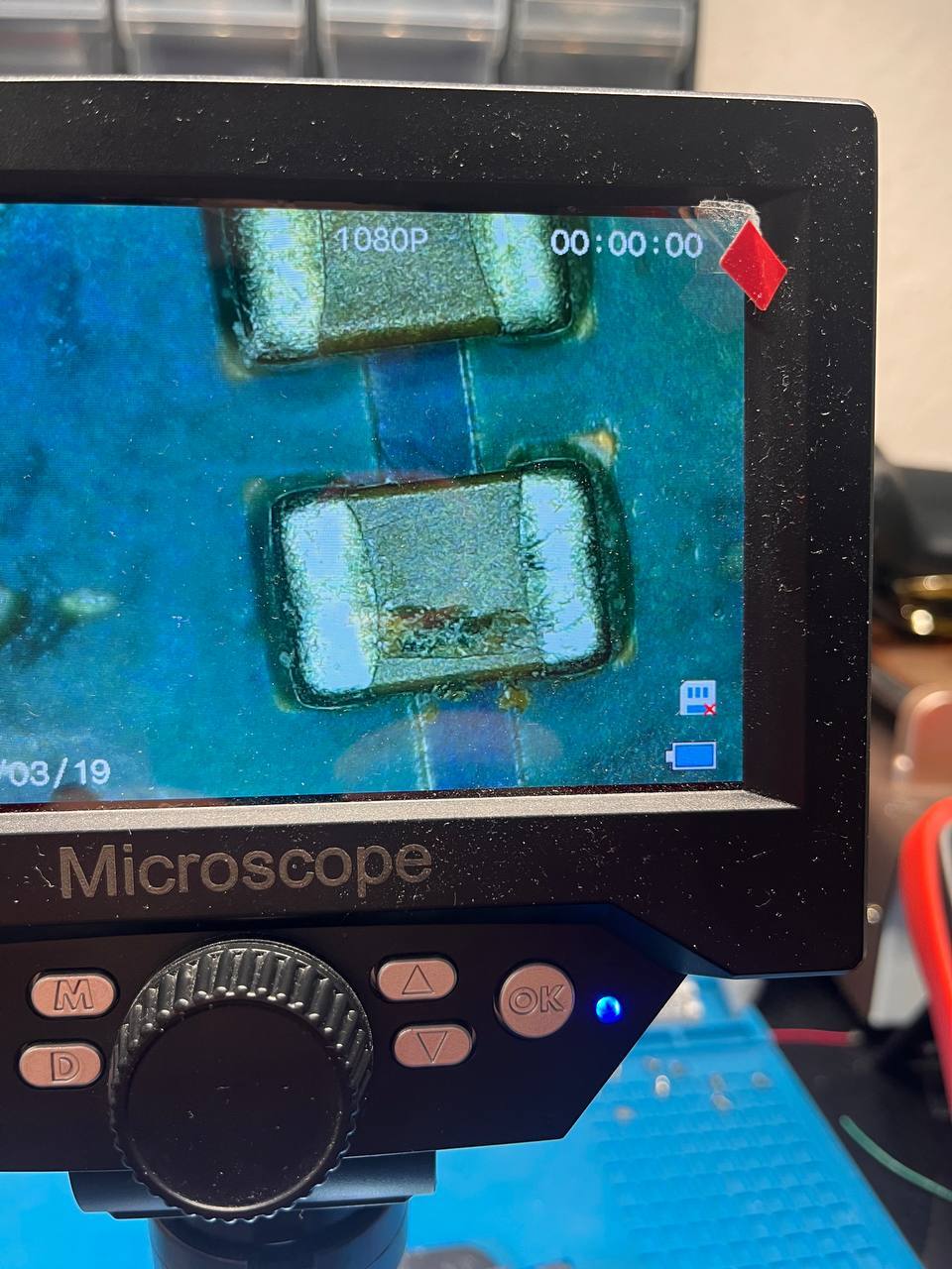

    small update. I cleaned the board again and saw that the capacitor near the mosfets of the video chip was damaged. I unsoldered it, now there are kiloohms on the shunt. But the nvdd resistance (inductors) is still the same low 0,3.
    Could you tell me what to do next?

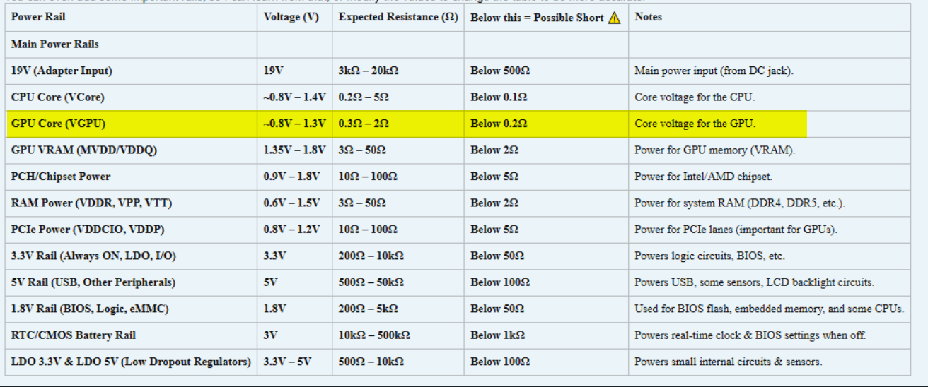

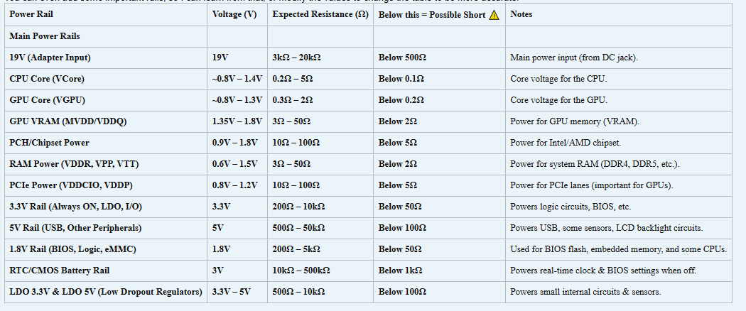

                      I found this spreadsheet on the forum. Well, this is normal resistance, right?
                      • mon2
                        • Dec 2019
                        • 14664
                        Looks normal to me.

                              People, thank you so much for your help! Everything is working now!
                              I ended up resoldering the original BQ24780 back in because I noticed that the new one wasn't soldered properly, and the original was actually fine.
                              I really regret not spotting that faulty capacitor earlier. I did so much unnecessary work... but I guess I can blame it on my lack of experience 😅.
                              Tips for anyone dealing with this laptop:
                              🔹 Tip #1: If your laptop hasn't been exposed to liquid damage or other major issues (aside from dust buildup), carefully inspect the contacts of components that may have overheated. In my case, the damaged capacitor was near discolored inductor contacts (see photos).
                              🔹 Tip #2: Always measure the standby current first. Then check the resistance on all major power rails.
                              🔹 Tip #3: Check the MOSFETs. If one isn't switching on, verify the contacts on BQ24780S (or similar controllers). A non-working MOSFET doesn't always mean it's faulty—it might not be receiving the correct signals.
                              🔹 Tip #4: Don't rush your decisions! Start with the easiest solutions before moving on to complex repairs. This will save you time and effort.
                              And of course, always check the boardview and datasheets! 😁
