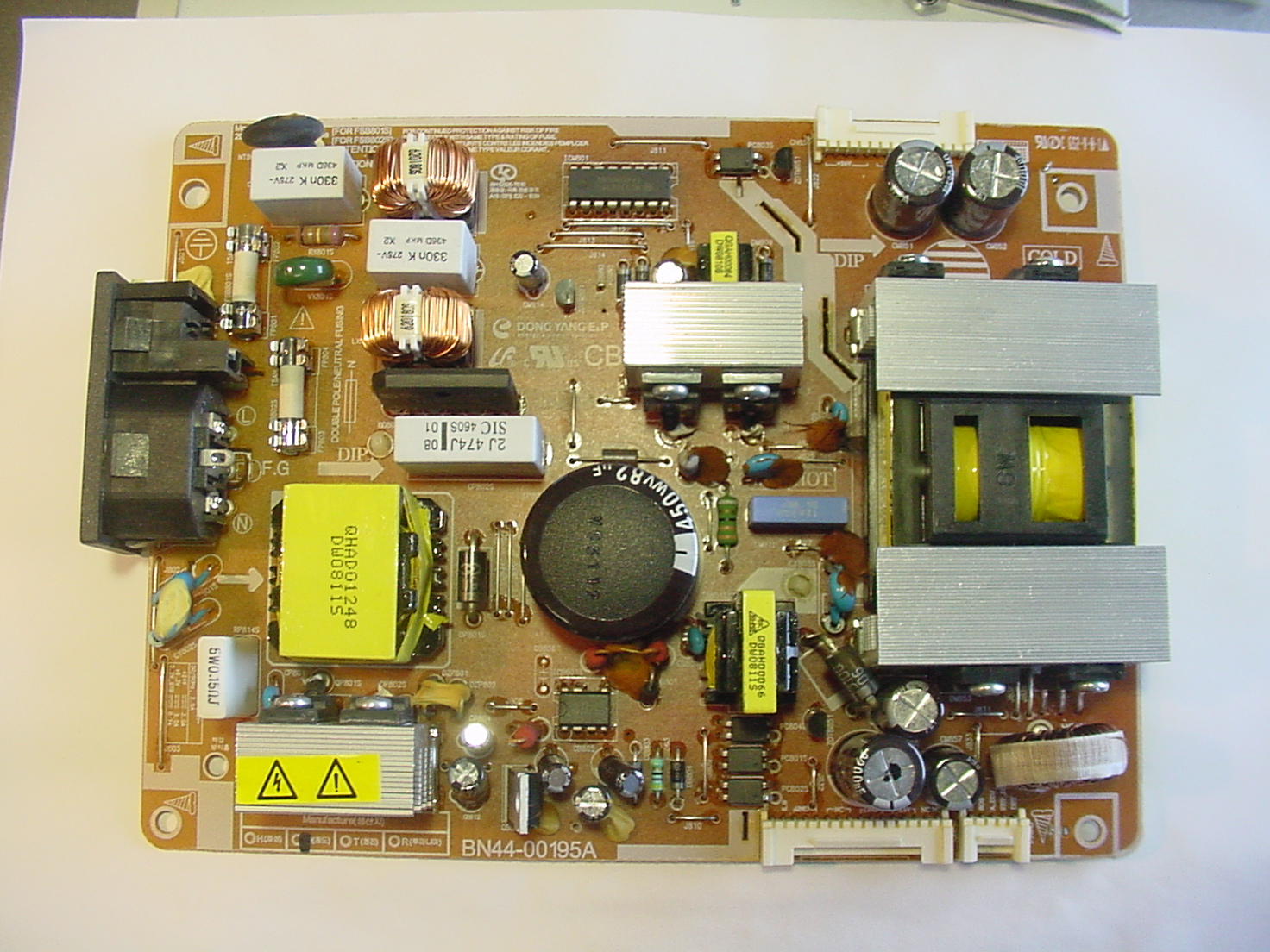

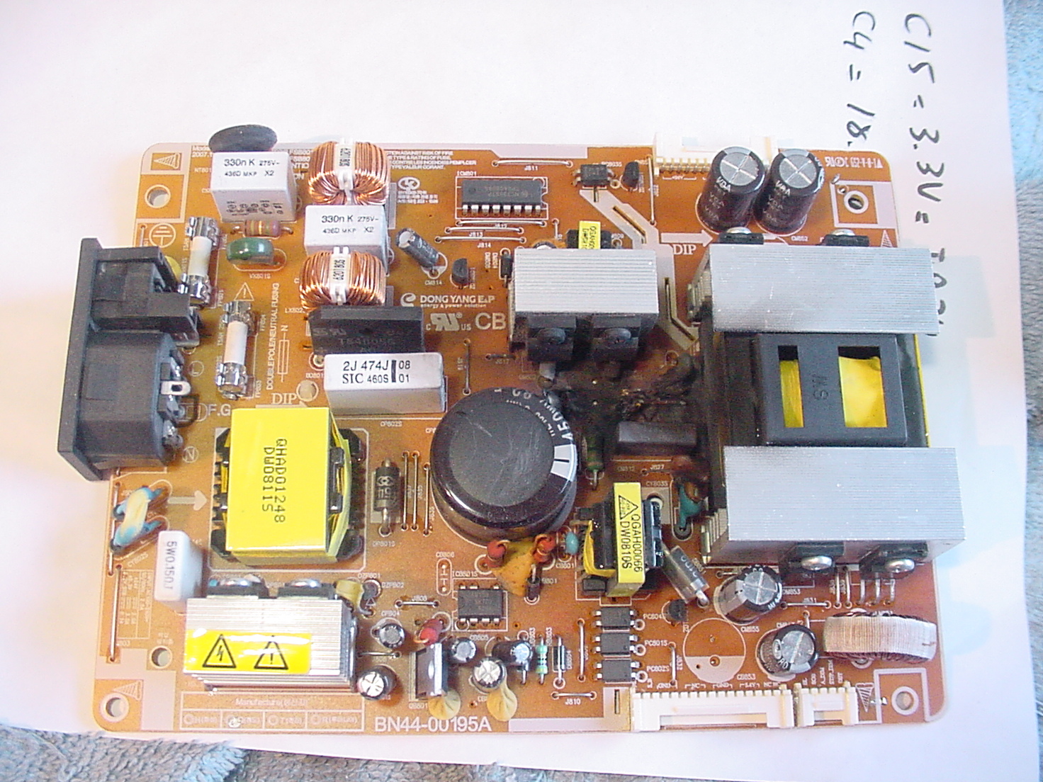

What bad glue can do to the board

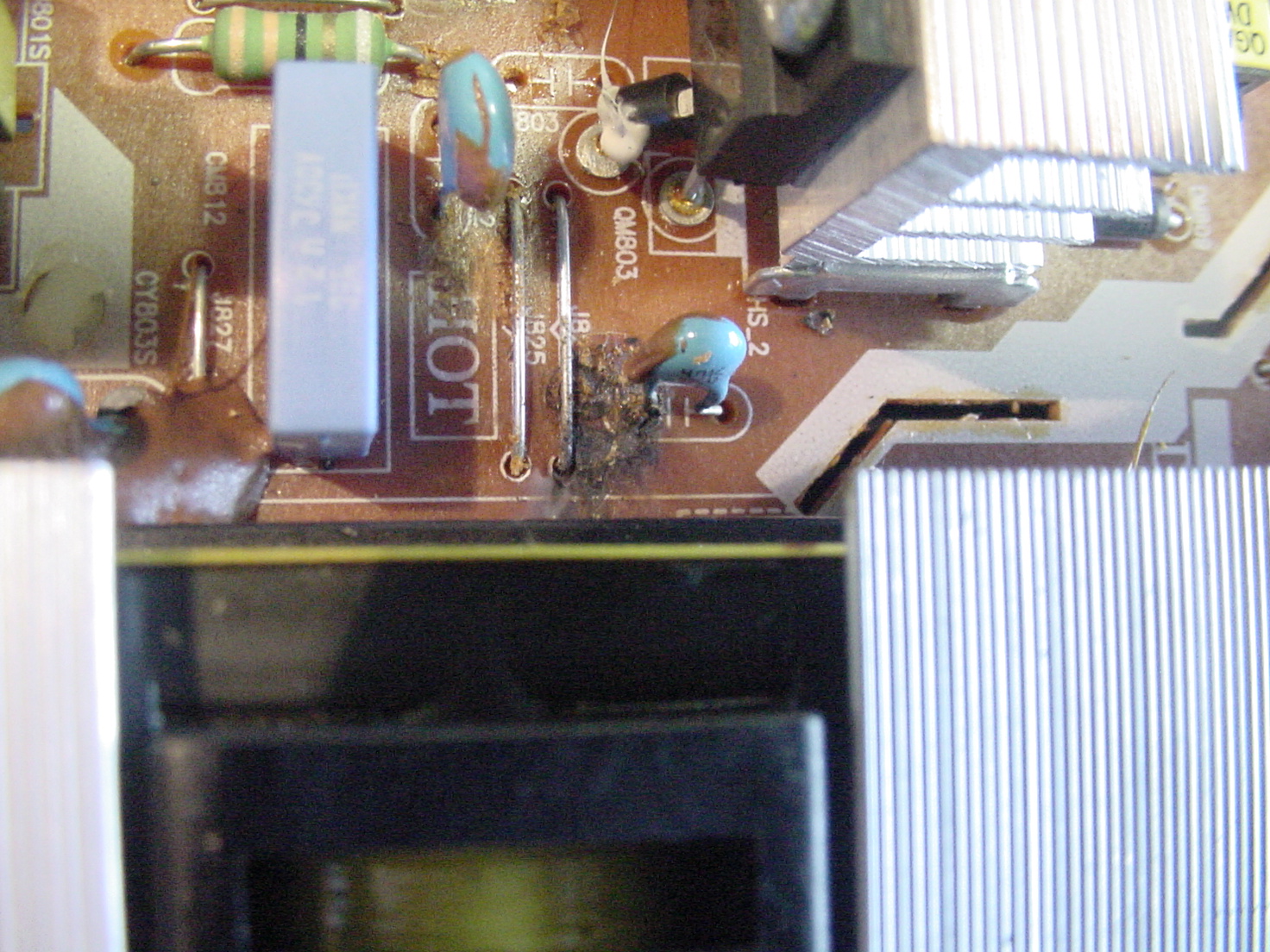

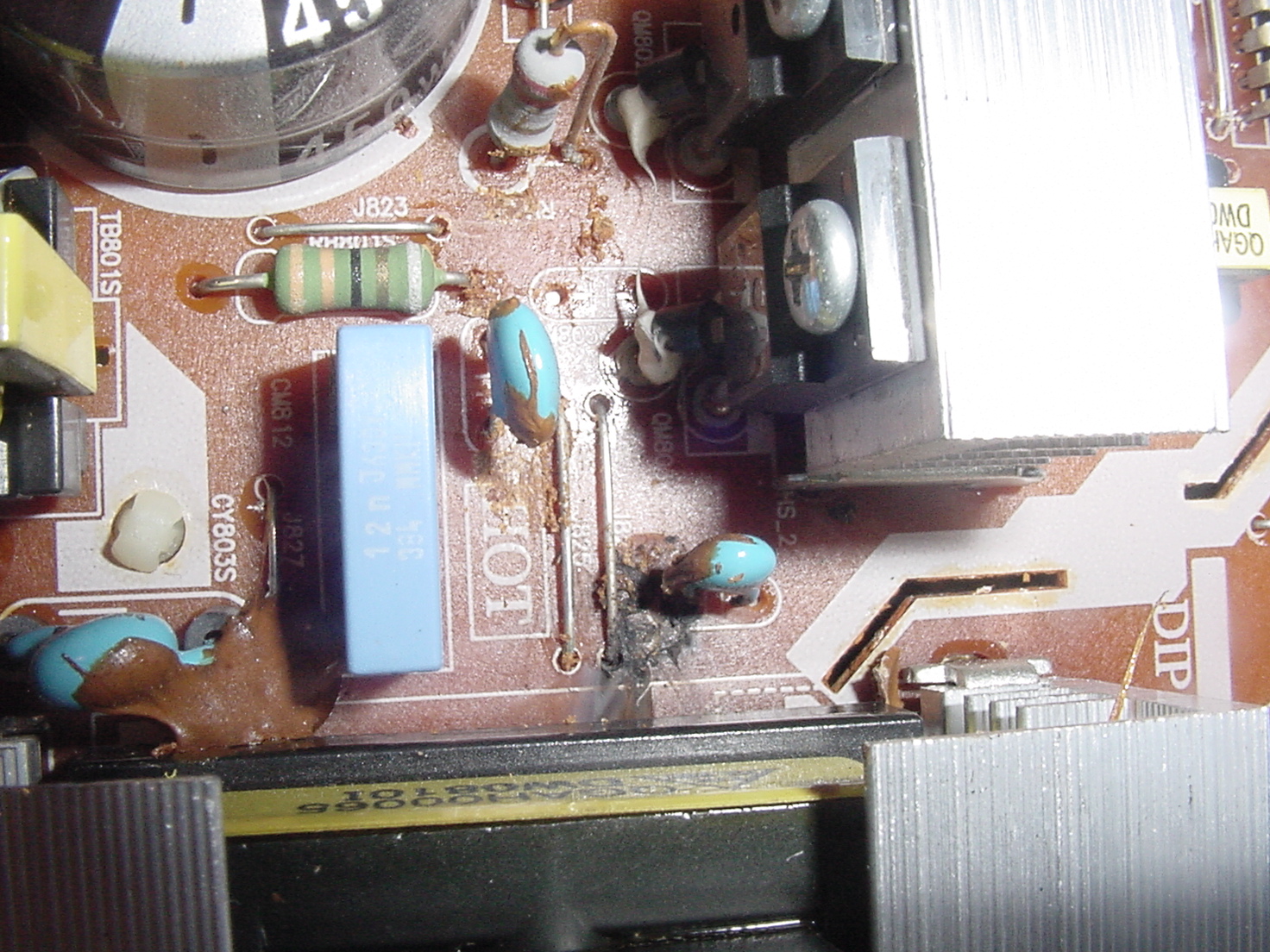

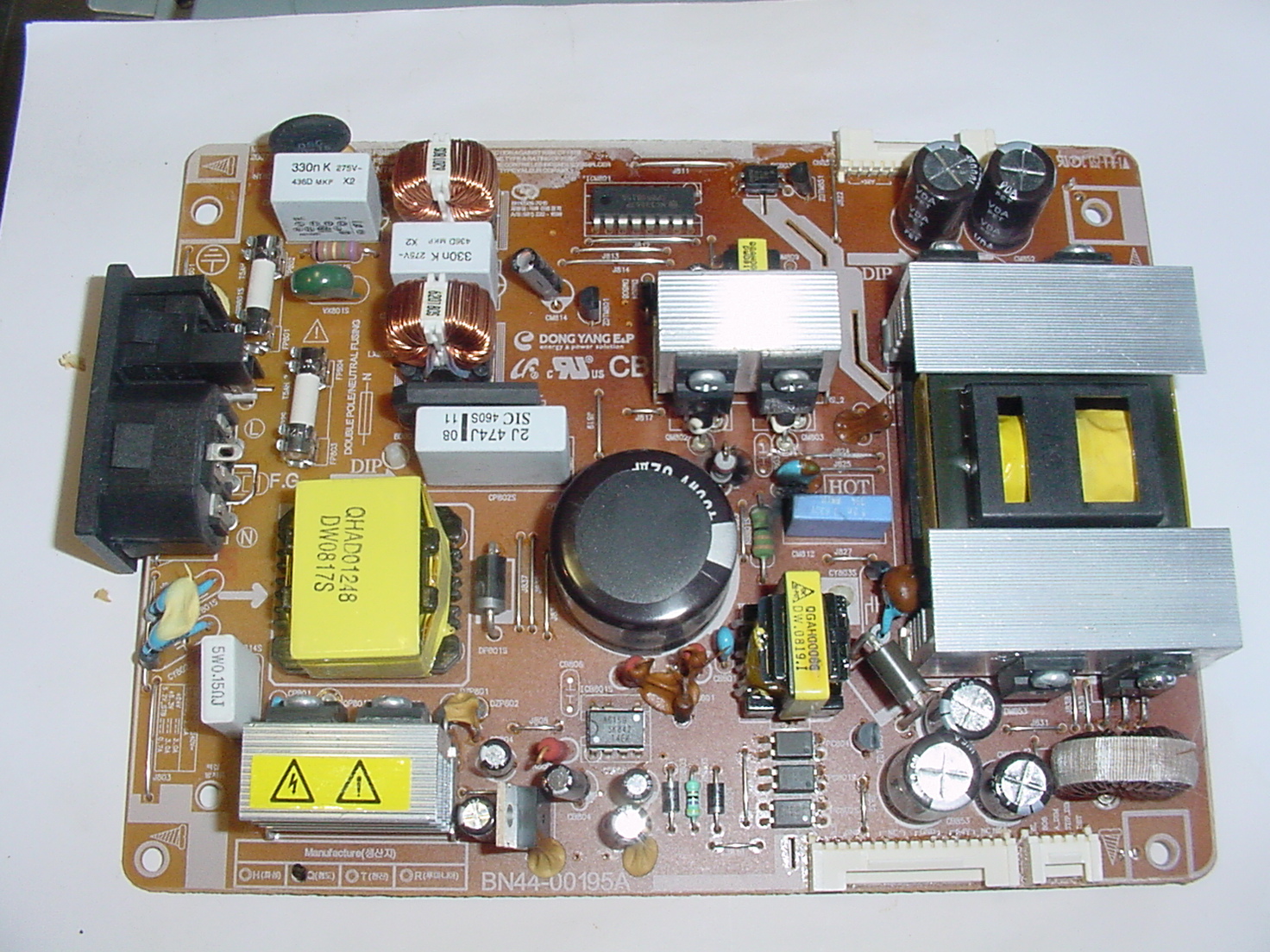

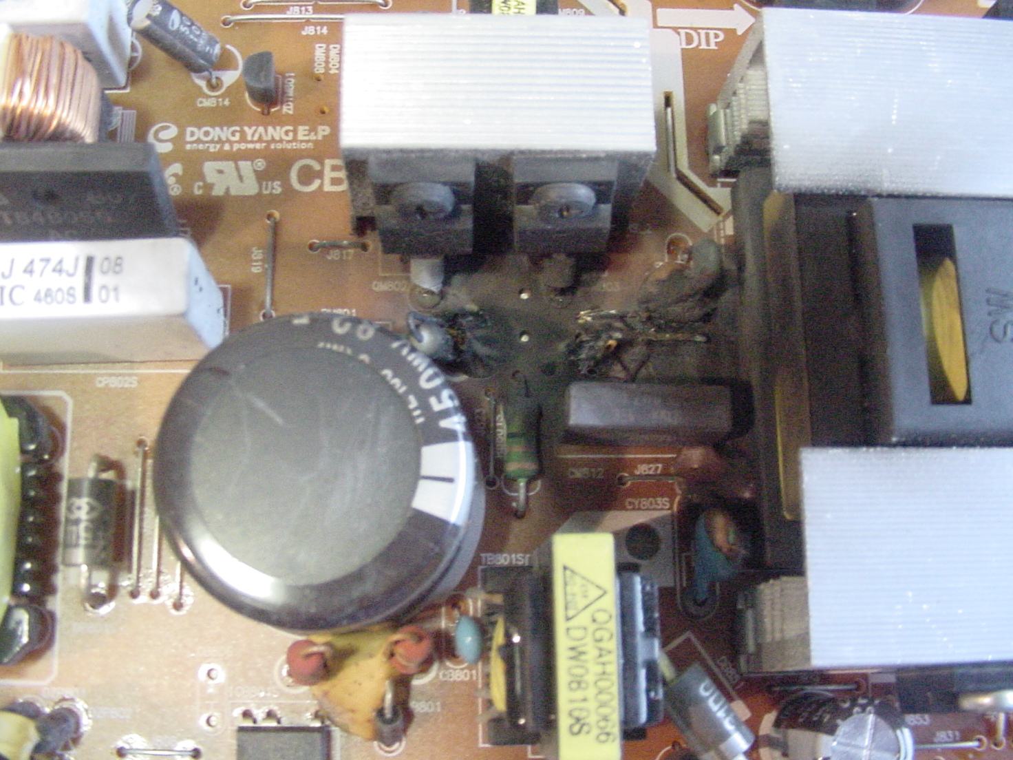

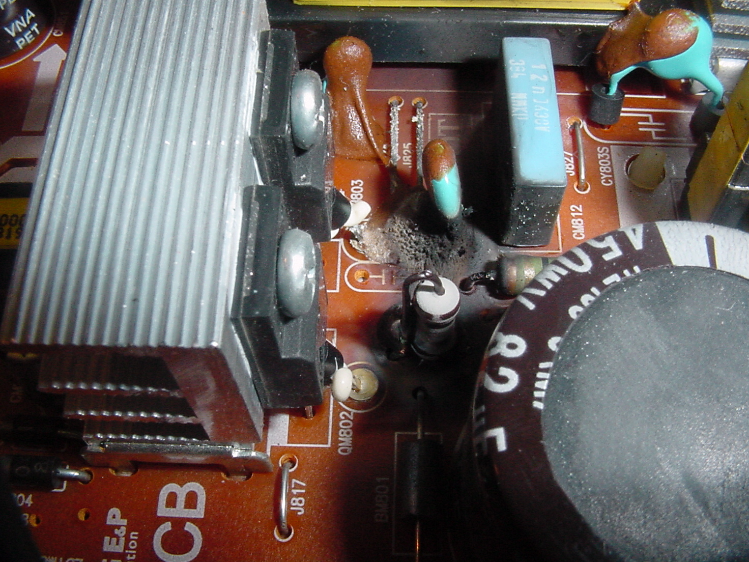

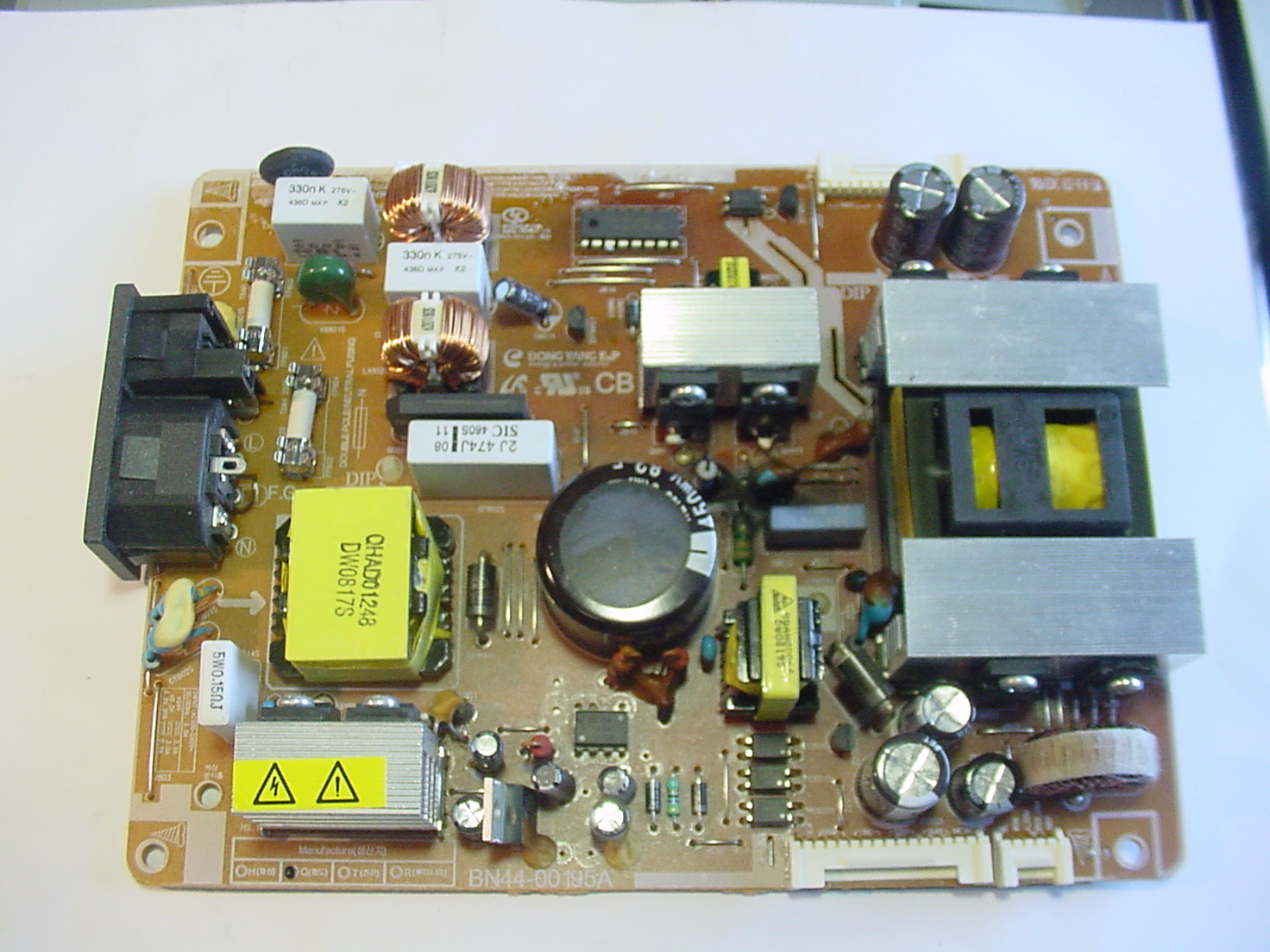

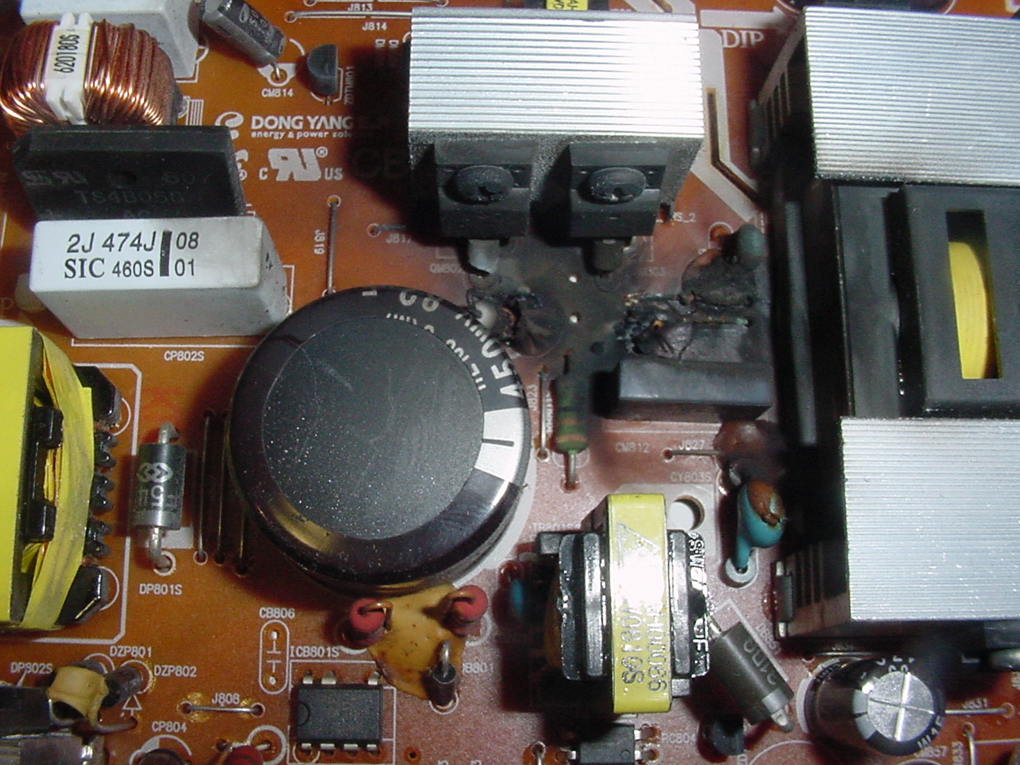

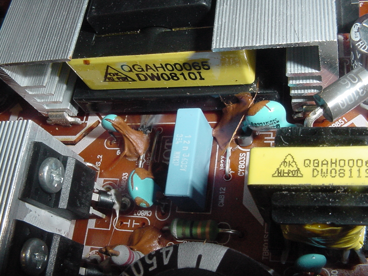

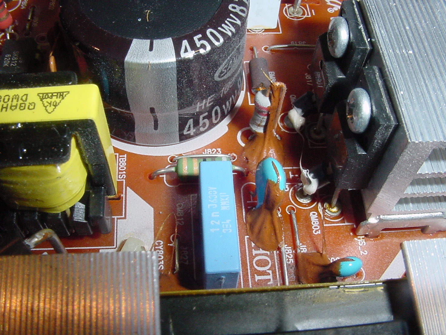

    Got 6 Samsung 245bw in, 3 were fixed by just removing bad glue, other 3 are badly damaged (will have to do more repair later).
    Re: What bad glue can do to the board
    wow! thats glue? it looks like chocolate salt water taffy!

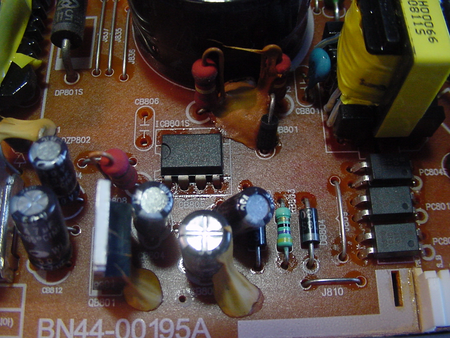

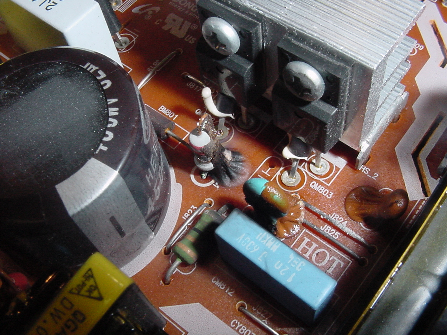

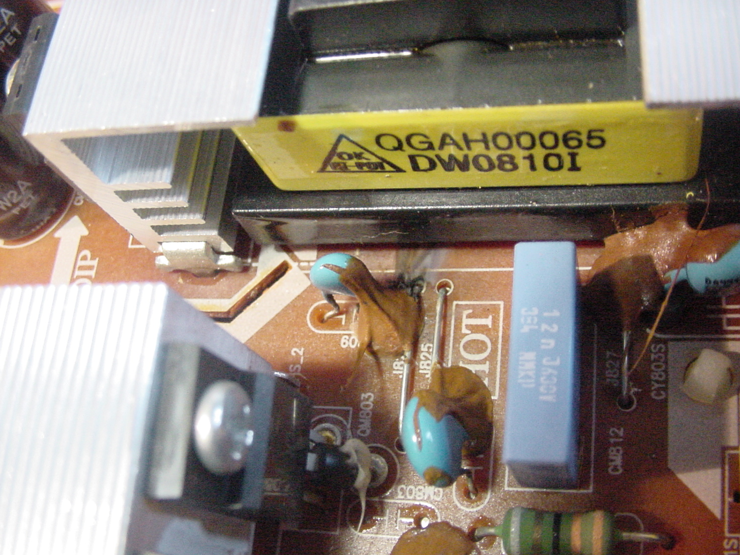

      I'm a bit confused? They are smart enough not to put glue that conducts electricity.
      What happened to this glue? What caused it to make such a mess?
      Temperature, chemical reactions or something else?
        I have dealt with this glue problem since the 70's. They get old, turns dark brown then becomes conductive and corrosive.

                There is no issue with the glue it self, the one who placed it over the PCB he added too much, and caused a violation regarding the Creepage distance in a HV circuitry.
                  That's absurd... Conformal coating covers the entire board. The problem lies in the conductivity of the glue, not in "creepage distance".

                        I have dealt with this problem since the 70's (some of you were not even born yet, or not getting into electronics yet), it is the chemical in the glue being used, some Chinese companies still use this glue. If you have lots of experience, you will know why it has nothing to do with creepage and clearance. I also use conformer coating in my board design that are used in high moisture location. I also use potting compound on the whole board. BTW, our lab is UL and CSA certified for safety testing. Done lots of HI-POT test @> 3000V.
                        If the glue is not conductive, you actually increase the creepage distance.
