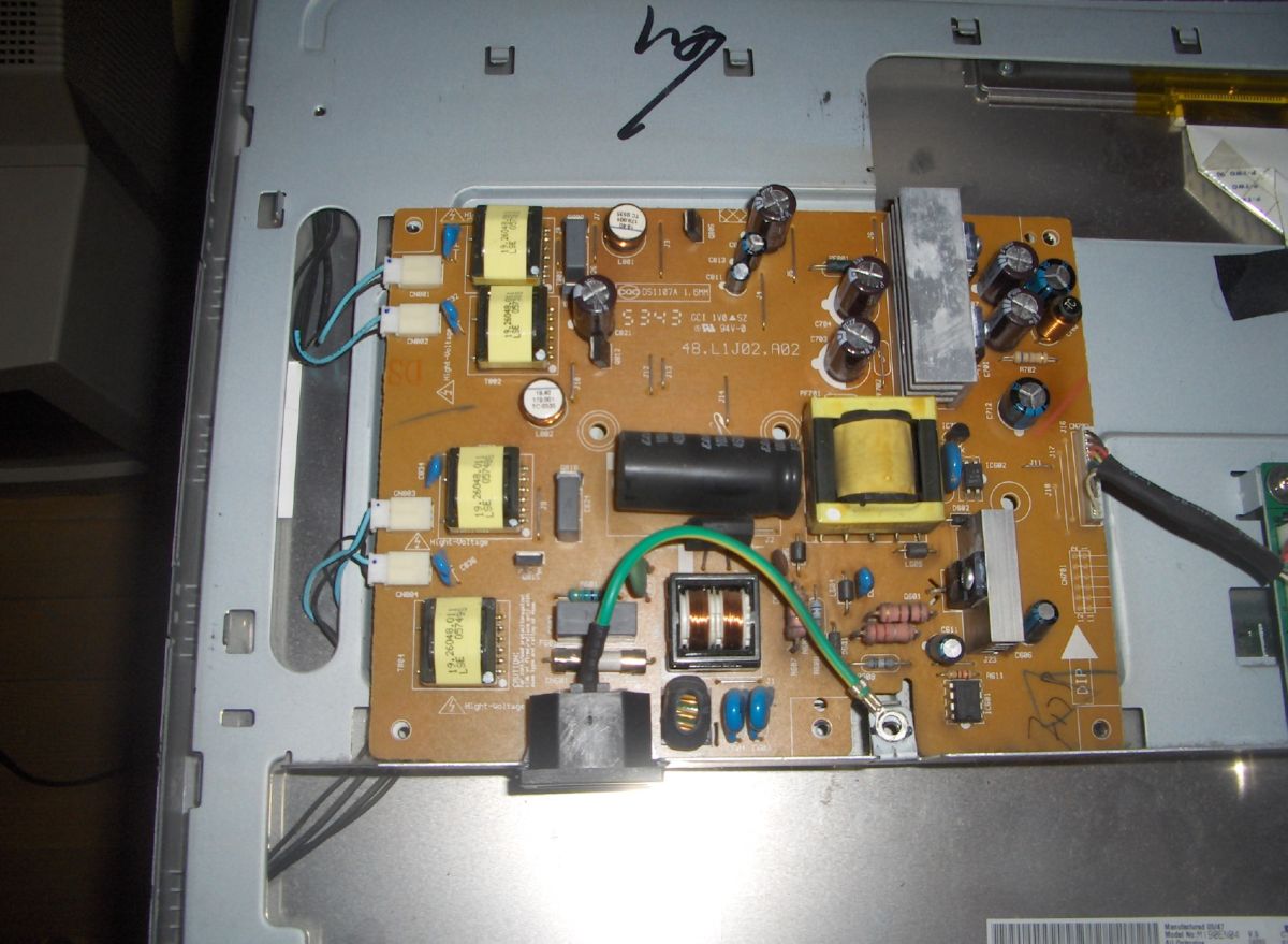

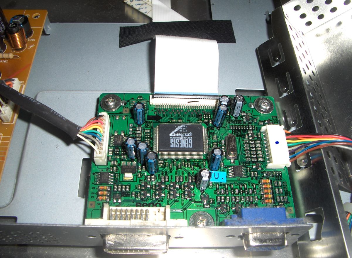

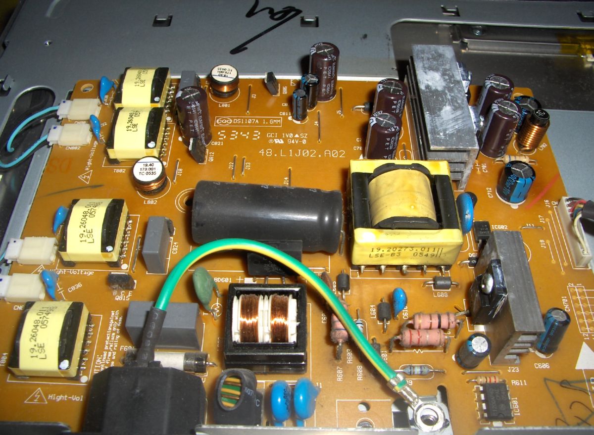

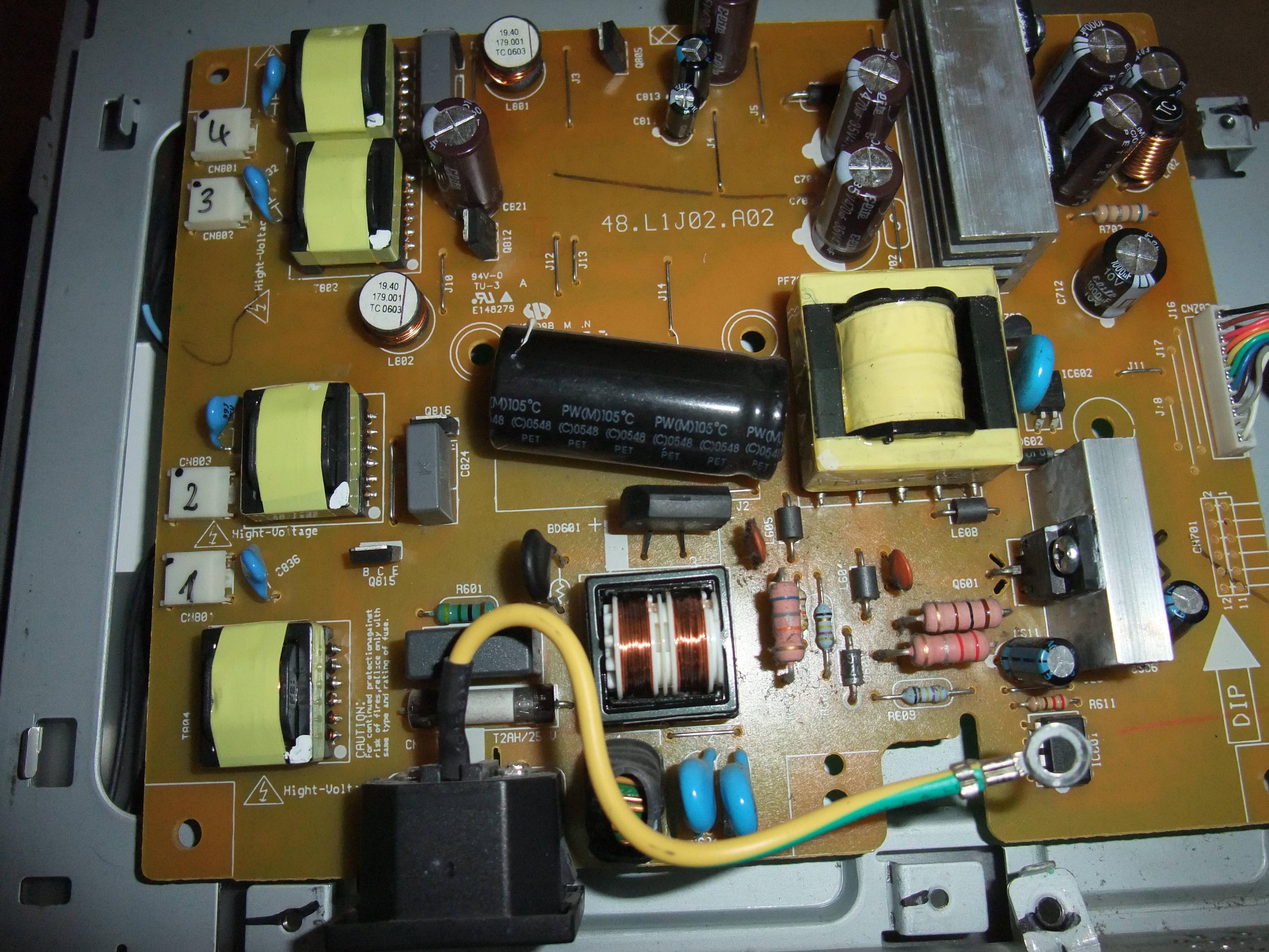

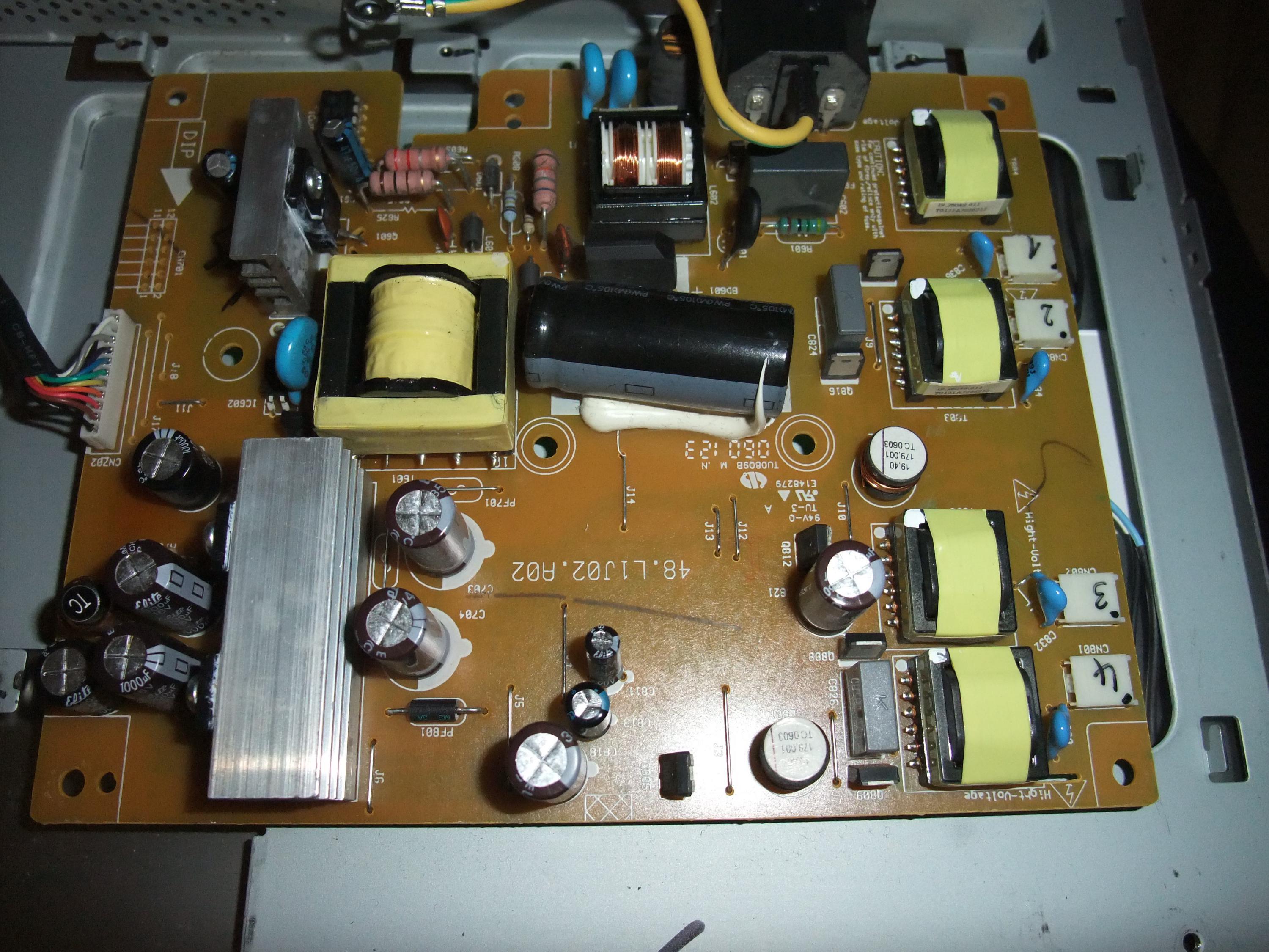

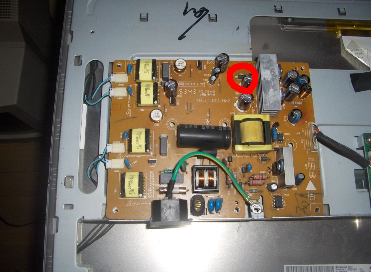

          I got a very similar problem and exactly the same board! If I switch the monitor on, the green led lights up and for a fraction of a second I see the blue benq label on the monitor. Then the monitor is dead again.
          I already checked the black fuse PF801 and the LDO regulator on the logic board, there I measured to voltages 3.3V and 1.8V.
          I couldn't find the C5707, please give me a hint. The capacitors all look very good, none is curved or vented.
            Re: BENQ FP91G+ problem
            Just to be sure, you need to upload good clear pictures of YOUR board for us to look at.
            • mejohn
              • Mar 2015
              • 8
              • germany
              Here you are. If you want specific pictures, please don't hesitate to ask.
                "I couldn't find the C5707"
                Q808, 809, 815, 816.
                These boards are know for having lots of bad solder joints in the inverter section (transformer legs, transistor legs, cap legs etc), and bad tuning caps (grey rectangular caps, lose its capacitance).
                  If I might add budm - I'd also check Q812 & Q805. I've had one of them go on occassion.
                  And resolder those transformer legs etc, as budm said, or it will happen again.
                    I checked all components including the mosfets (Q805, Q812) and found that two C5707 are gone (Q808 and Q809). In approximately 4-6 weeks I get the parts from china and I am going to post the result.
                    Thank you very much!
                    • mejohn
                      • Mar 2015
                      • 8
                      • germany
                      Success! After replacing the two faulty c5706 and resoldering a lot of legs the monitor works fine again.
