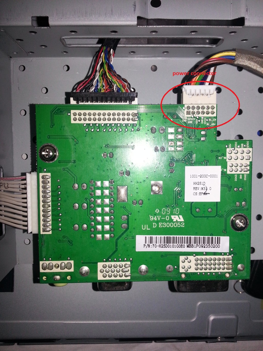

    Re: Hanns-G HH251 no power
    Connected PS_ON with 5.2v a 1k resistor with no result.
    Same thing with INV_ON
    Selldoor, did you mean connect 5v to BRT too ?
    In attach there are pictures of the mobo.

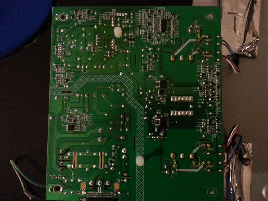

          Can I get the straight shot pictures of the bottom side of the power supply board? It looks like the the 12V is used for the audio amplifiers.

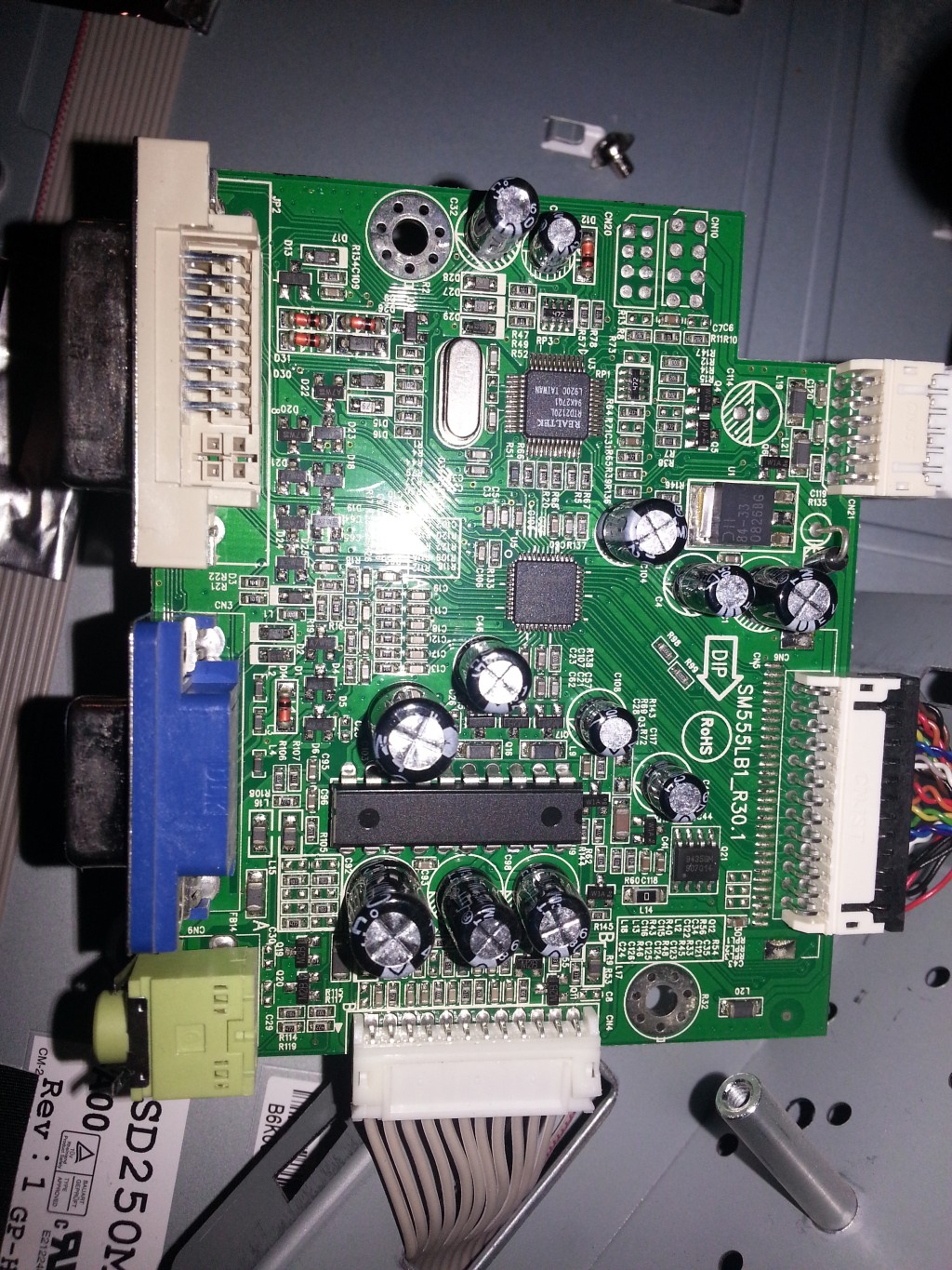

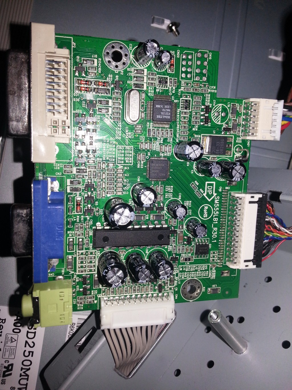

              @davi.p
              on mobo chip 84-33
              picture attached

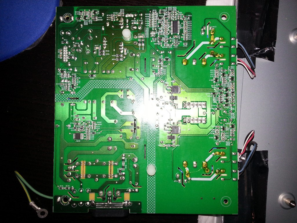

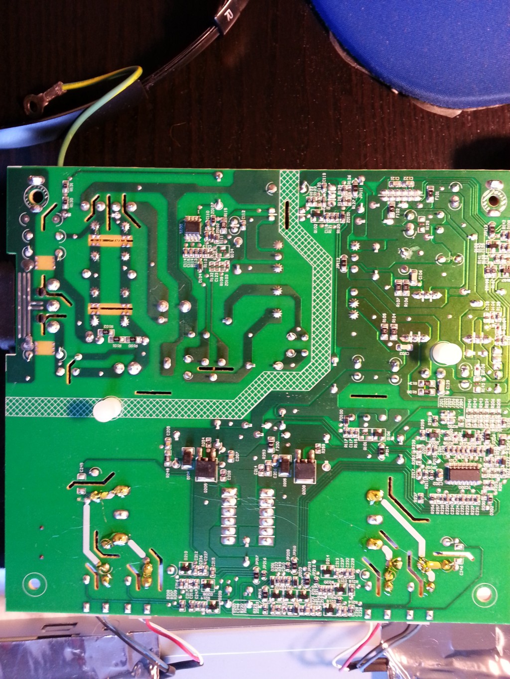

                @budm
                pictures of bottom side of psu

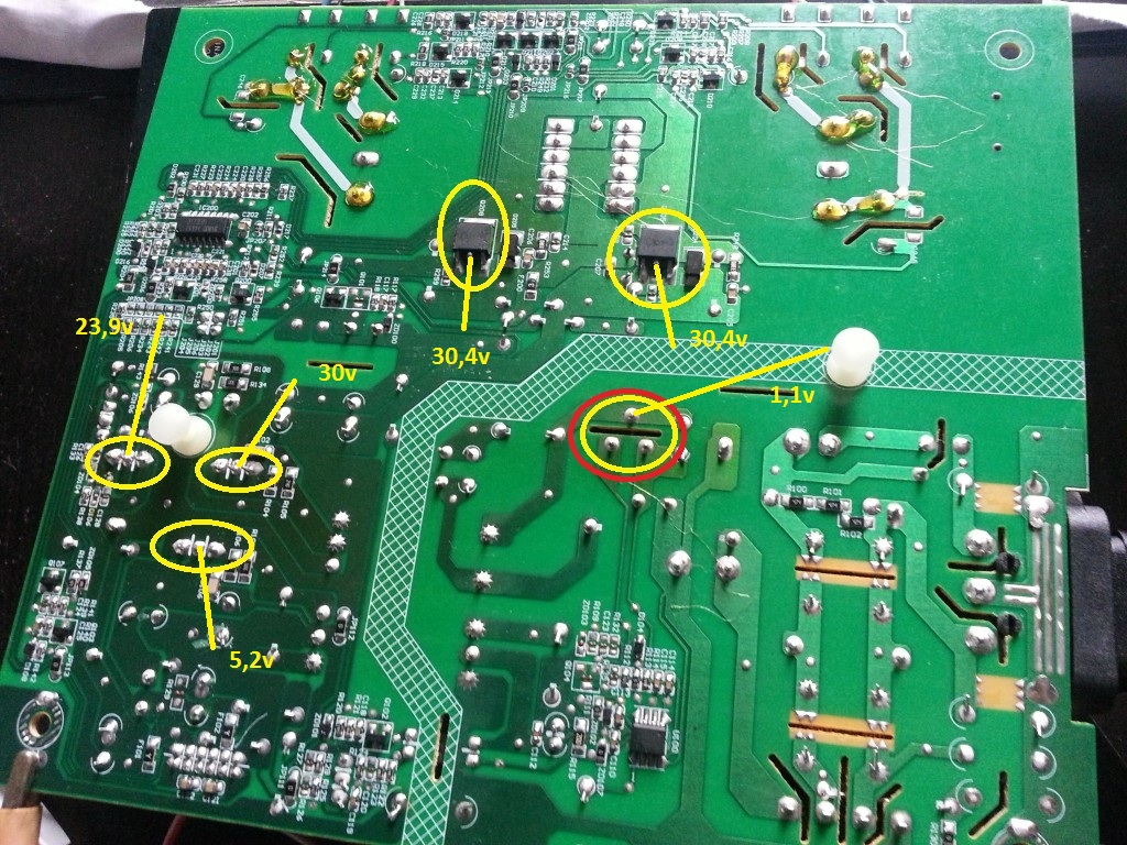

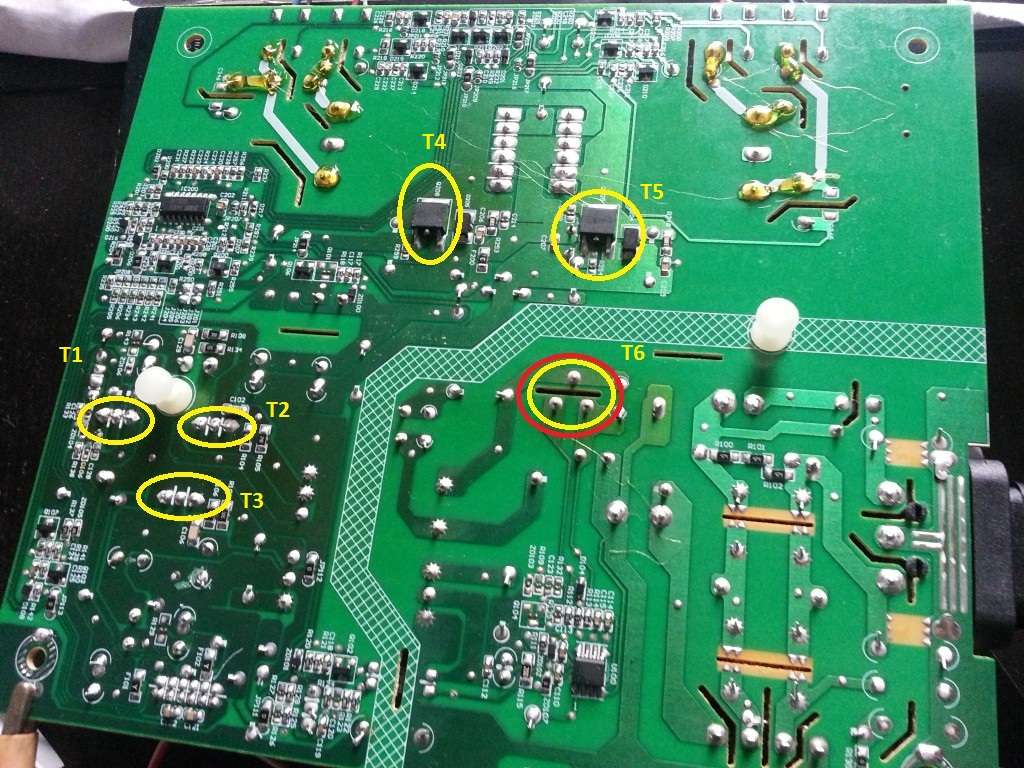

                  @davi.p
                  i made again the measures on transistors with mobo attached to the psu.
                  In attach there are the readings.
                  • Davi.p
                    Hobbist Tech
                    • Sep 2009
                    • 4467
                    • Italy - Milan
                    #29
                    i know that you've made many photos already but is difficult for me to see well, in particular the part of the secondary of psu is difficult to see traces.. if you can make better one; now measurements has more sense, anyway i don't find how the 23v output serves to.. in the photo where you put measurements the 3-leg chip where you measured 23,9v can you measure all 3 pins and tell me its part number? Bye
                      #30
                      You need to use 3 resistors on
                      PS_ON, INV_ON, BRT. If that does not work then I will need to trace out the circuit of the inverter section, you have to do the resistors connection without having the logic board connected.
                      BTW, that red wire on that connector looks dangerous, it looks like it is touching the pins next to it.
                      You also need to verify the 24v and the 30vdc readings, what do you use for the ground ref point for the secondary circuit?
                      The board has 3 power supplies as shown in my redlined picture.

                        #31

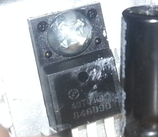

                        @davi
                        The reading on that transistor with mobo disconnected is 15.5v
                        With mobo connected voltage range is from 21v to 29v in different times.
                        Hi res photo of transistor in attach

                          #32
                          @budm
                          very beautiful schema!
                          i have tried to connect 5.2v to those 3 pins but the tft won't switch on.
                          I have changed the red wire with something more useful just to be sure
                          The grounf ref point is the monitor chassis connected to the boards with crocodiles and to the multimeter with another one.
                          Soon i'll post the readings for all transistor with the 3 pins disconnected and then connected.

                            #33
                            Is that an H on the end - perhaps this is datasheet
                            http://html.alldatasheet.com/html-pd...AP40T03GH.html

                              #34
                              @budm
                              All measures with mobo disconnected:
                              Pins connected: (PS_ON, BTR, INV_ON)
                              T1 12.5
                              T2 17.6
                              T3 5.2
                              T4 17.6
                              T5 17.6
                              T6 0.20~0.40
                              Pins disconnected (after some minutes 'cause voltages on T1 T2 T4 and T5 slowly vary after disconnection of pins):
                              T1 increase up to 24v than decrease and stabilize to 18.8
                              T2 25.7
                              T3 5.2
                              T4 25.8
                              T5 25.8
                              T6 0.3

                                #35
                                Whoopee ! Think I have spotted another fuse F200 Between T4 and T5
                                  #36
                                  @selldoor, good eyes! I did not even see that. The Voltages are about right. No need to do T6 reading since it is on the primary side which you cannot use the chassis ground (cold side ground) as the ground ref. for the meter.
                                  So check the F200.
                                  • maudam
                                    • Dec 2013
                                    • 24
                                    • Italy
                                    #37
                                    F200 is ok
                                      #38
                                      OK, since the two MOSFETs T4, T5 which drives both inverter transformers in half-bridge setup and they are getting voltage, it means that the PWM IC (to the left of the T4) may not be driving the Gate of the MOSFETs. There is a SMD 18 or 20pins IC which is the PWM IC. Can you read the P/N as printed on the top?
                                      BTW, What dc voltage do you get at both ends of the F200 fuse with ref to chassis ground?

                                      • maudam
                                        • Dec 2013
                                        • 24
                                        • Italy
                                        #39

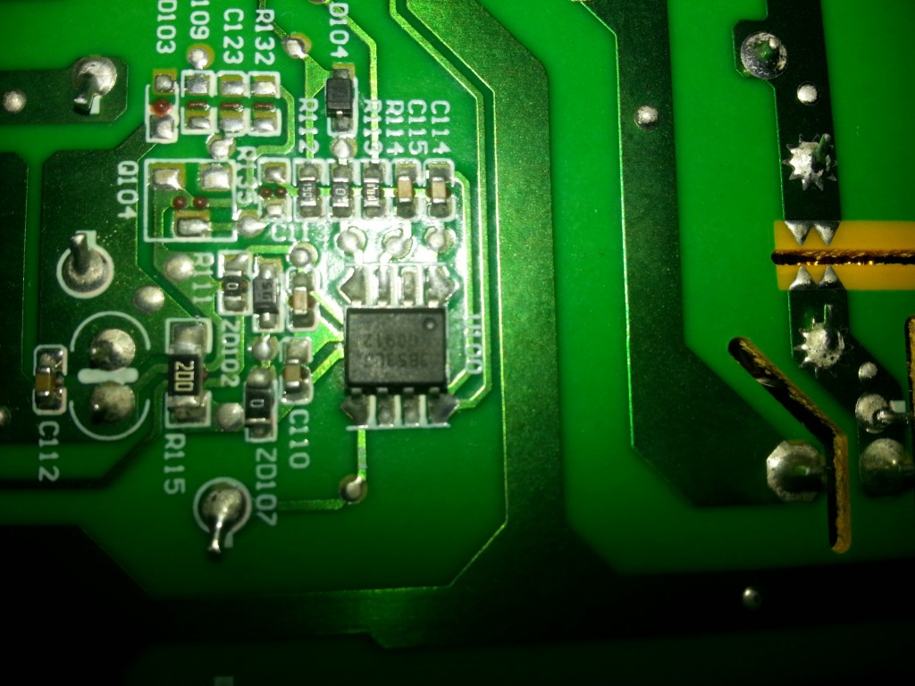

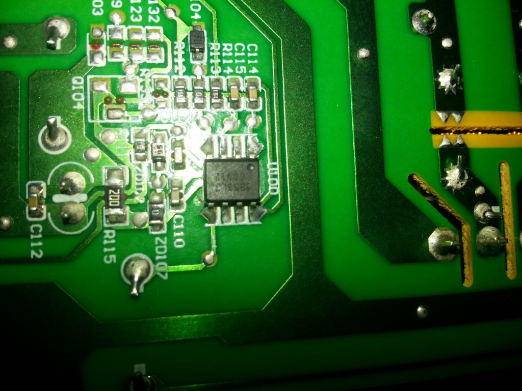

                                        Tomorrow i'll make all measurement.
                                        This is the IC you asked for.
                                        There is also the picture of the other chip smd located down to the big cap.
                                          #40
                                          BIT3501 is the one we need to look for the spec sheet.
