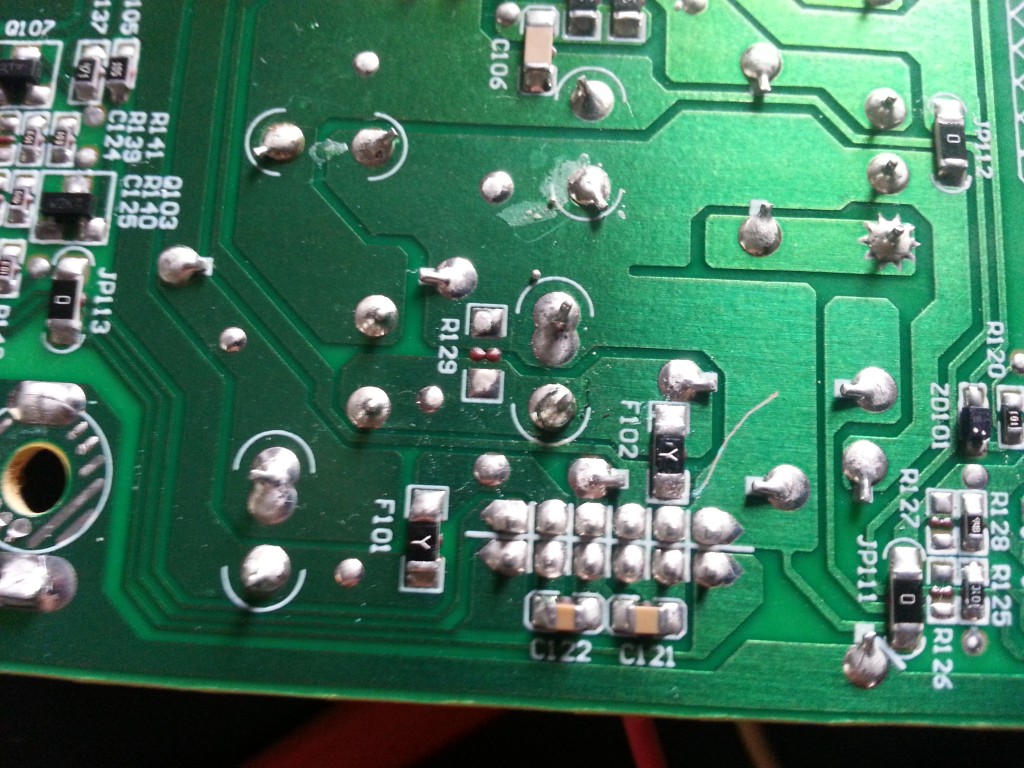

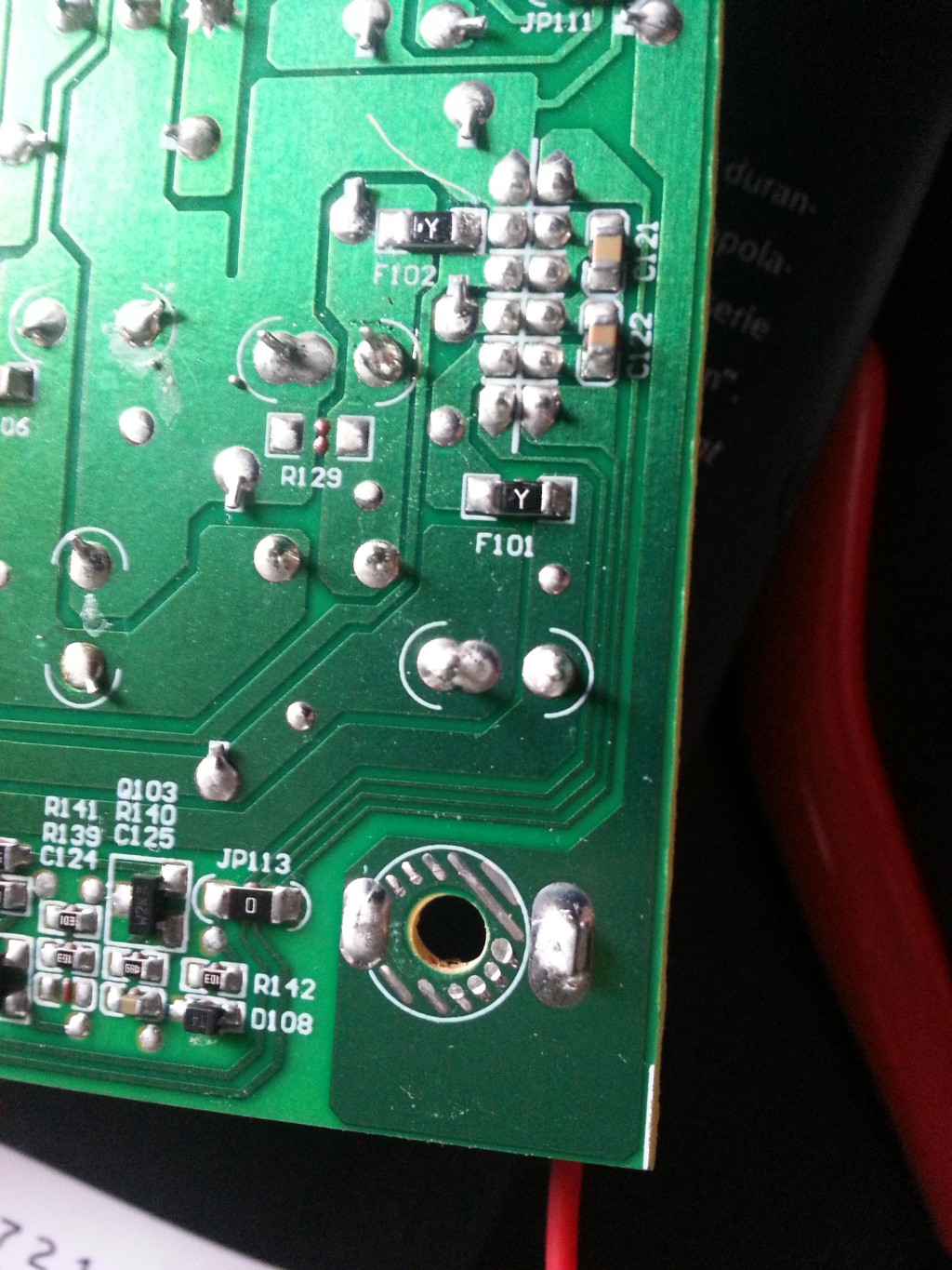

    The smd fuse F102 (Marked with Y letter) seems broken, but i wasn't able to find this fuse or any oher info at any place.
    The board output should be:
    5,2V 3.1 A
    12V 0.7 A
    so the 5.2 line protected by F102 should be 3.1A but the same fuse is on F101 that should be a 12v 0.7A
    12V line is not active. Maybe the monitor have to power up before 12v are activated ?

              I have just tried.
              The fuse is bypassed with the external fuse 250V 3a but the monitor won't power on.

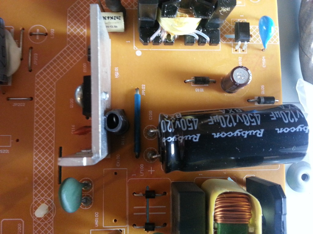

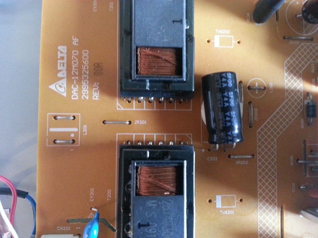

                  Can you test the voltage across the BIG cap It will be HIGH voltage so careful.
                  Put your meter on 600vDC and place a probe on each leg of the capacitor.
                  • maudam
                    • Dec 2013
                    • 24
                    • Italy
                    Re: Hanns-G HH251 no power
                    Well.
                    290V on C100 (bigger cap)
                    29V on C203 (near transformers)
                    0V on C105 (brown cap just up to external connector)
                    No 12v on pin 10 of external connector
                    5v ok on pins for external connector
                    Fuse F100 ok
                    Davi can you tell me which are voltage regulators and how check them ?

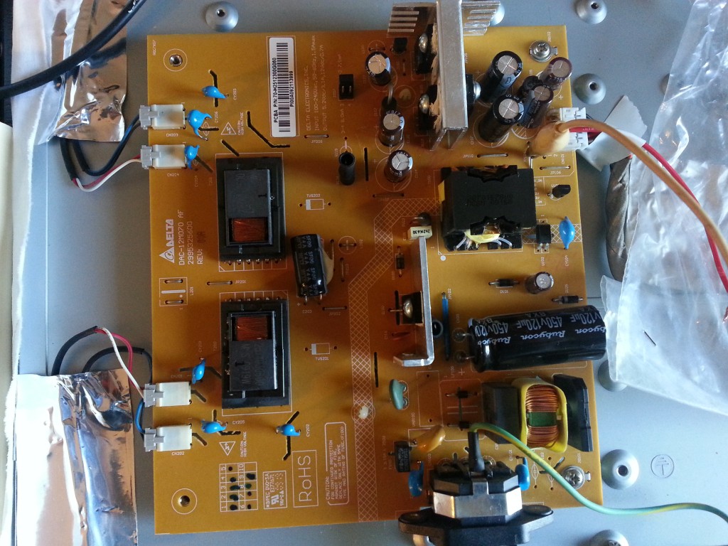

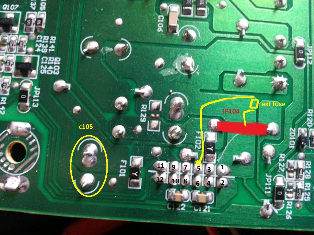

                          Ok - Still not sure how you have connected the fuse are you getting 5 v on both sides of it. Which pin is connected to C105?
                          The voltage regulators are on the main board if you can post a good clear picture of it.

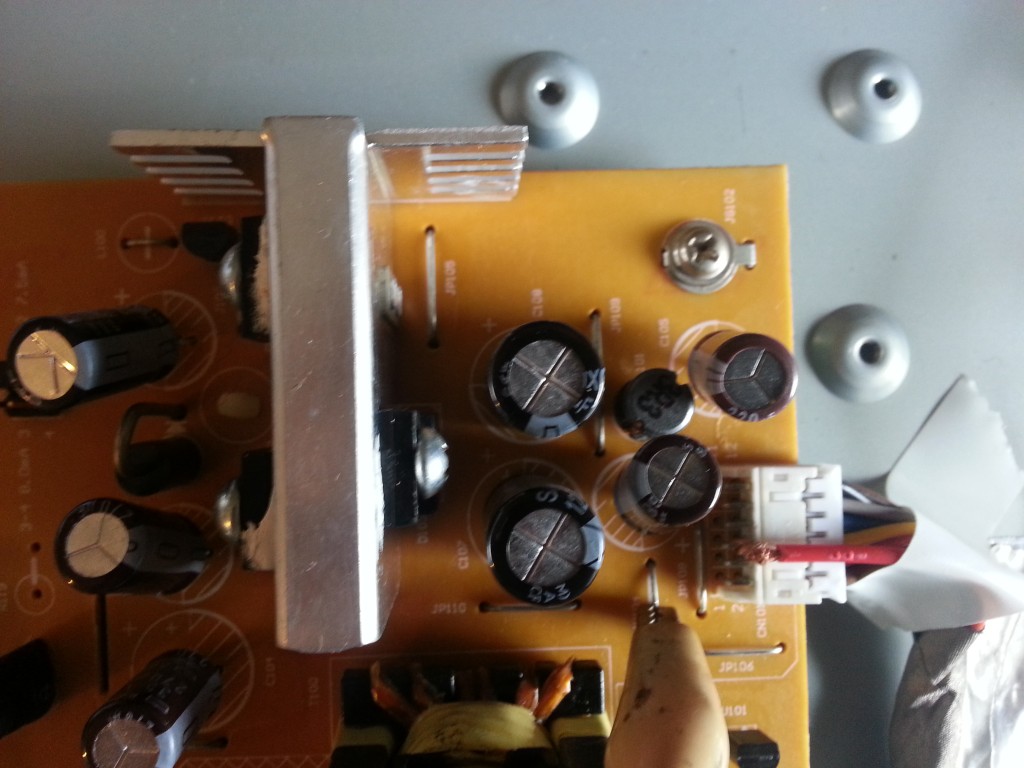

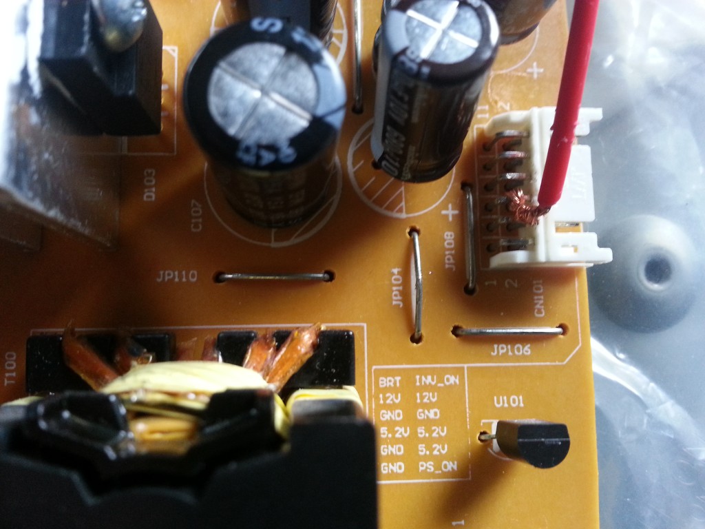

                              For the fuse, i made a bridge on pin 5 of external connector, that is directly connected with pins 4 and 6 and one side of broken F102, and JP104 that is directly connected to the other side of broken F102.
                              In attached pictures you can see more details.

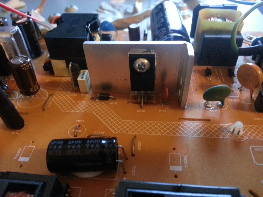

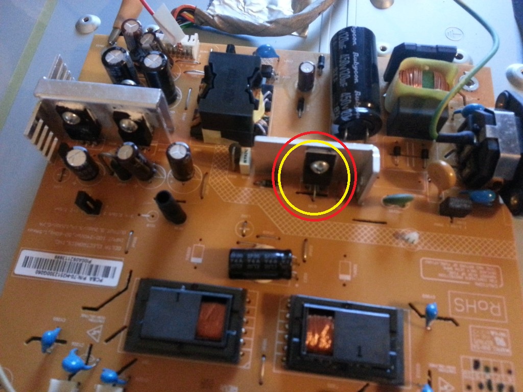

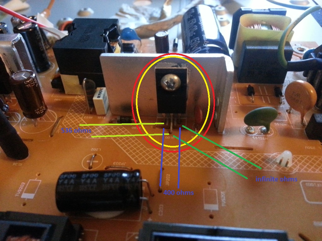

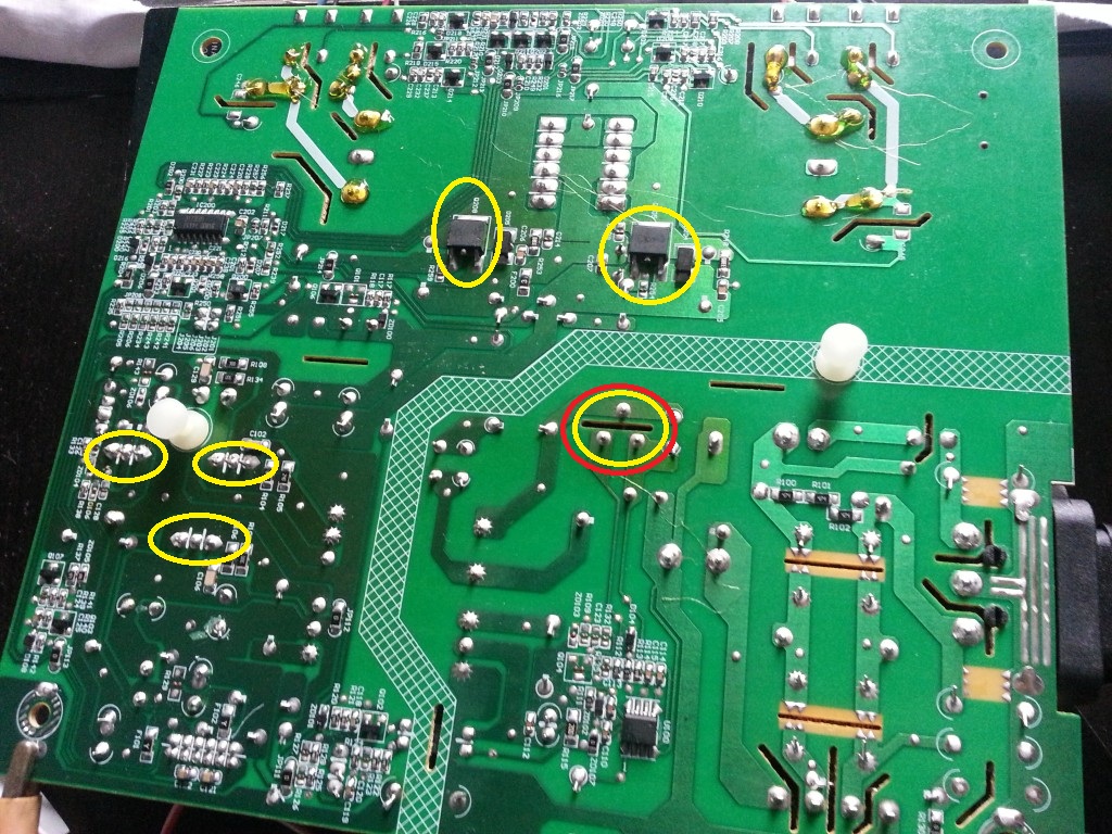

                                  All transistor in picture marked with yellow circle is ~20V on central pin.
                                  Transistor with circle red and yellow is 0V on central pin.
                                    Transistor readings
                                        Your last pics are much nicer and i can see better, your psu is probably OK, PS_ON is a return signal from ma.bo. and need to hook it to get 12v to work. We need a picture of the main board so we can mark where to measure.
