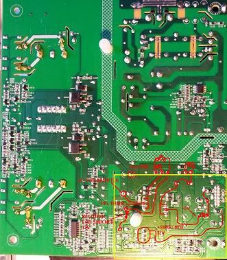

    Can you make me a new photo in the area that i've marked in yellow? It seems that something is not driving the mosfet you've photographed from near, also measure the 3 pins of the little transistor near the previous, the one that has a section with "D" shape from the up.

      Looking at the post with the three pictures - the last two at the right hand side
      there are two solder joints that look bad - may be just the picture but better check

            Re: Hanns-G HH251 no power
            Can you test JP113 well visible in third photo in post #15? In that post it seems that you shortcircuited 5.2v pin with gnd! ..
