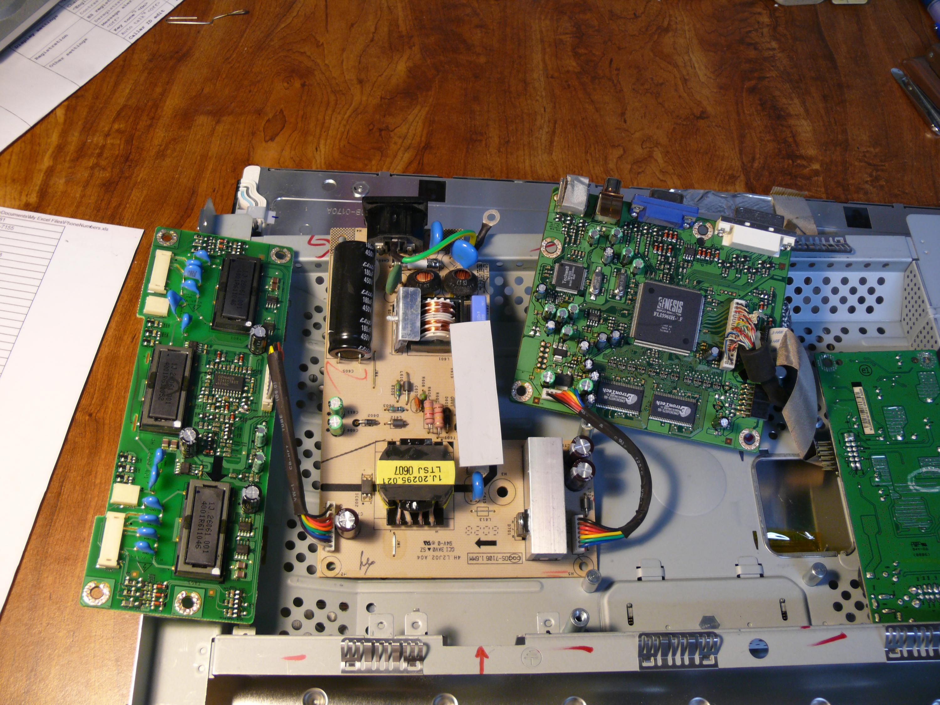

                Re: Dell monitor 2007FPb will not stay on
                the PSU is the Power Supply Unit, Will have a large capacitor on it. Its the one the has a cable that goes to your mains plug
                Even for me reading this it is confusing :S Sorry Davi.p
                Open the back up and take a picture of the entire back so we can see all the boards and connectors, then take one of each board closer up.
                  I opened it up and see the PSU but what is the trick to take it out. I removed the three screws and can wiggle the board but it will not separate from the power socket and it does not come out with the socket.
                  So how do I get it out?
                  The board is 5D*L2J02001 0211 612 GUND48D 297741 if this means anything to you.
                  Photo of all the boards is attached. I point to the PSU with a red arrow.
                  Thank you for helping.
                  Nathan

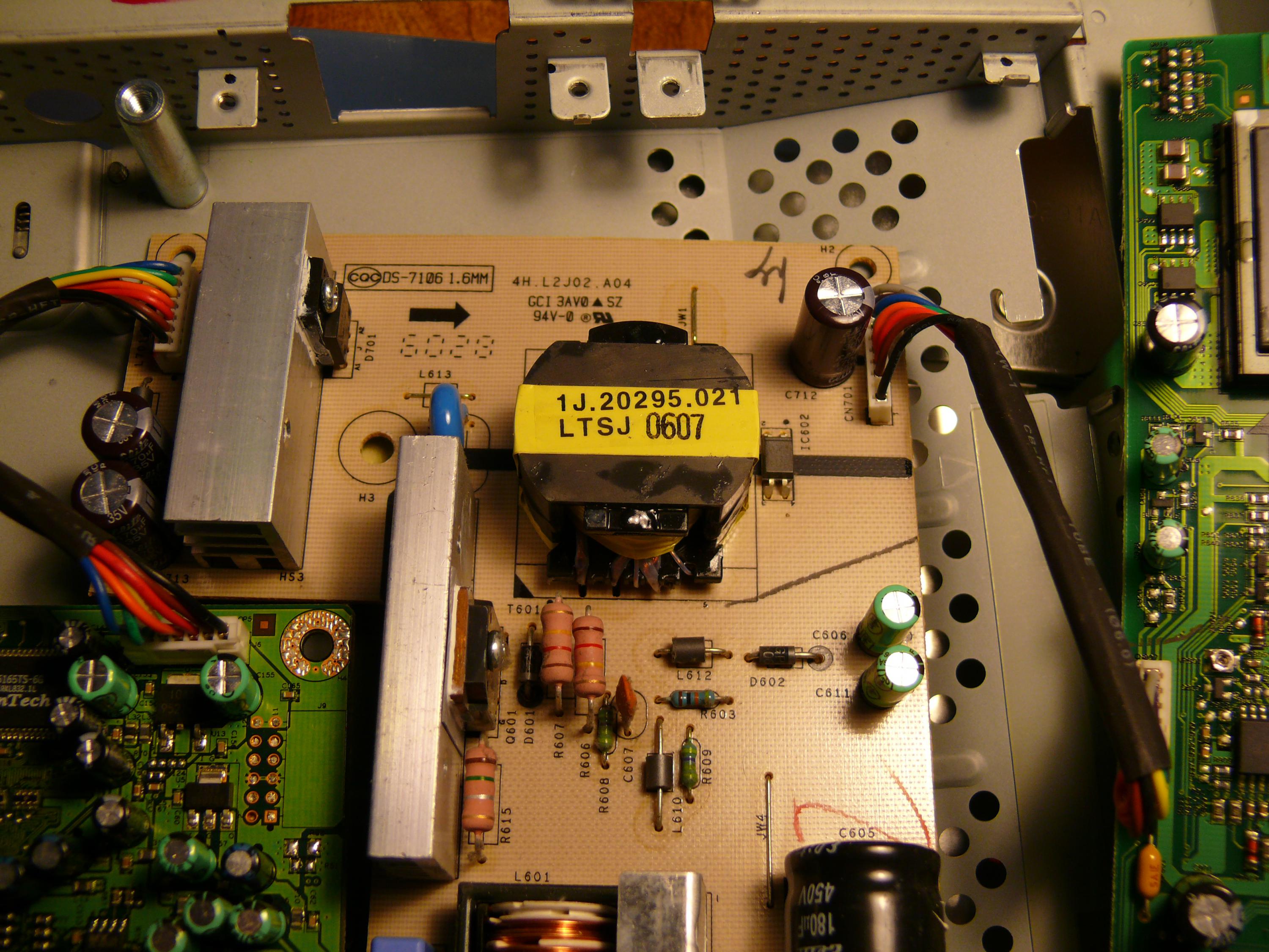

                      Thanks I got it. Am able to see all components now. Don't see any leaking or bulging capacitors. From reading this forum I understand that the capacitors on the PSU board are often the problem. Should I just replace the five capacitors and hope for the best? The problem was that the monitor was cycling on/off about every 30 seconds.
                      Photo of three board components is attached. The fourth little board has just two USB ports and two more ports which I don't recognize.

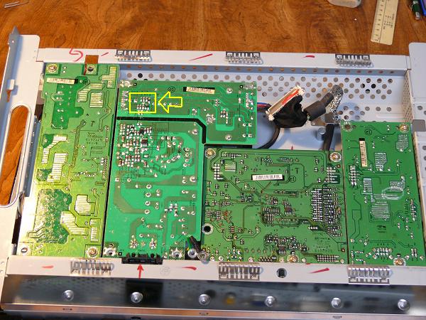

                        Can you make me a new photo of a particular area around IC702? it's a 3 leg smd chip on the PSU board in the bottom side near the big transformer.. i have to read the markings on the resistors and see their position..

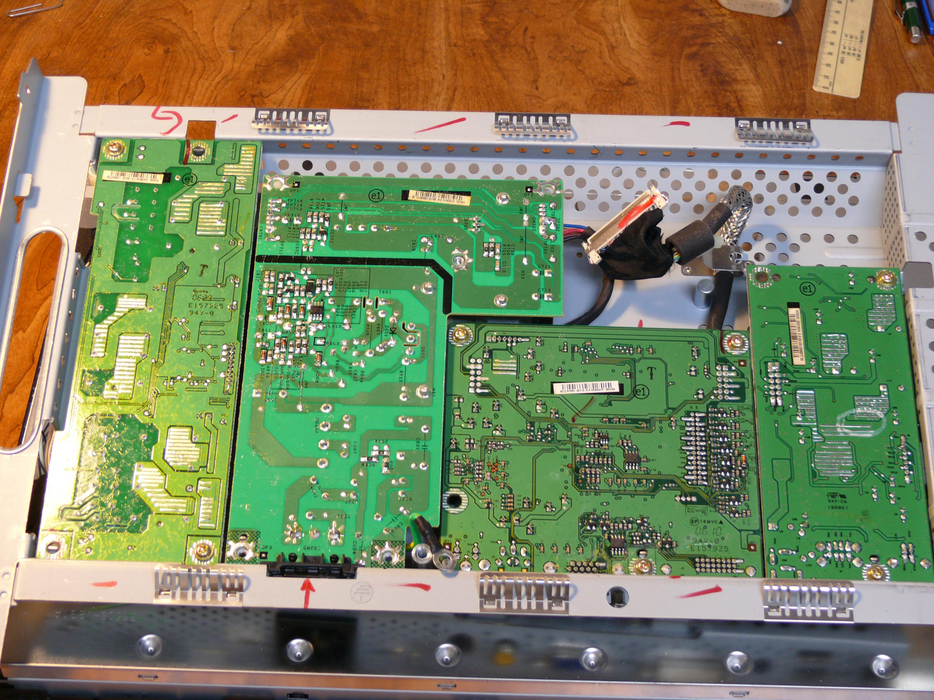

                        • ngutman
                          • Dec 2013
                          • 9
                          Is this the area that you are looking for?
                            NO, i mean here:
                            The reason for why i asked this is that i want to find the normal output voltage so you can test the monitor with an external psu, but if you feel not good to do this type of test try to buy those capacitors (low ESR types) and hope, i don't like that way..

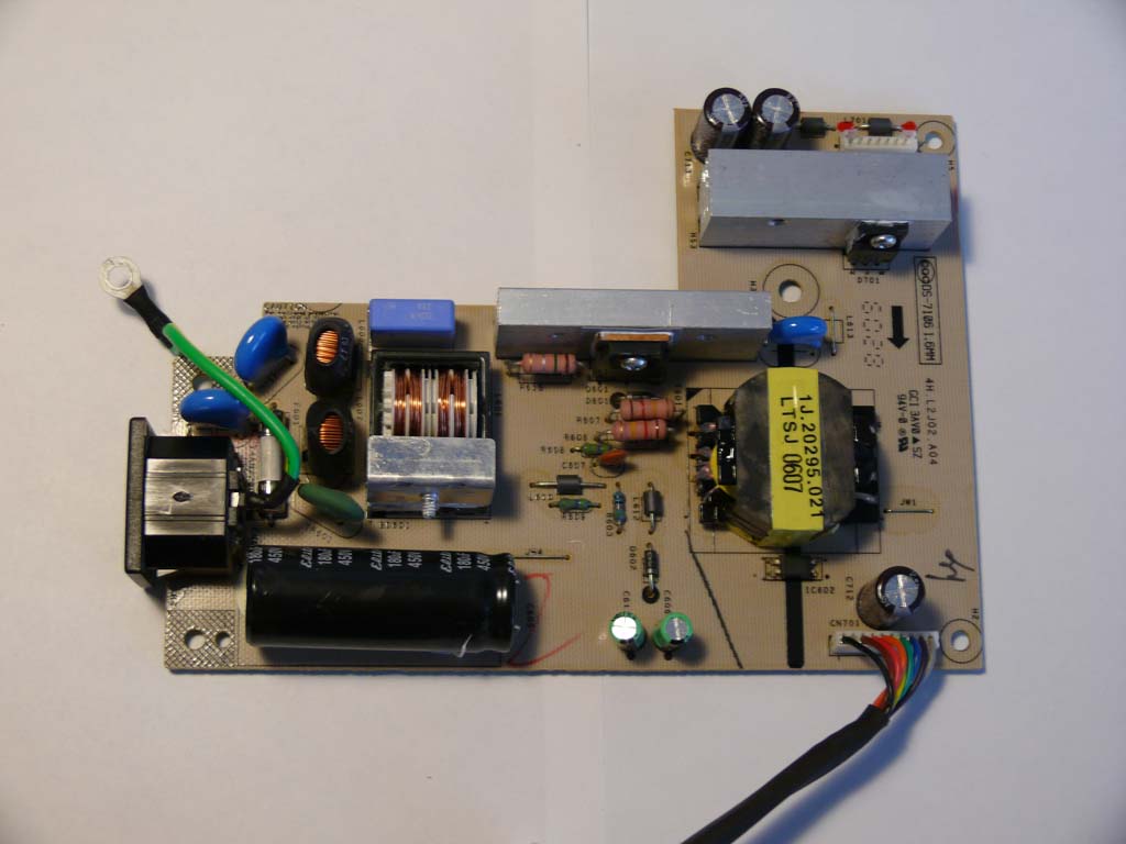

                                    I replaced the 5 capacitors on the PSU board. The monitor performed a little better but still continued rebooting every few minutes. Eventually it went off and it will not turn on. Pressing the power button does nothing.
                                    Is there anything that I can still do to revive it or is it ready for the landfill?
                                    I posted the PSU board. I am just an amateur tinkerer so please be specific about what component to replace and where to get it.
                                    Thank you all for holding my hand so far.
                                      What make/series caps did you use - they are the same color in that pic as in the first one?
                                      • ngutman
                                        • Dec 2013
                                        • 9
                                        The photo shows the old capacitors. I got the new ones from a reputable US company.
