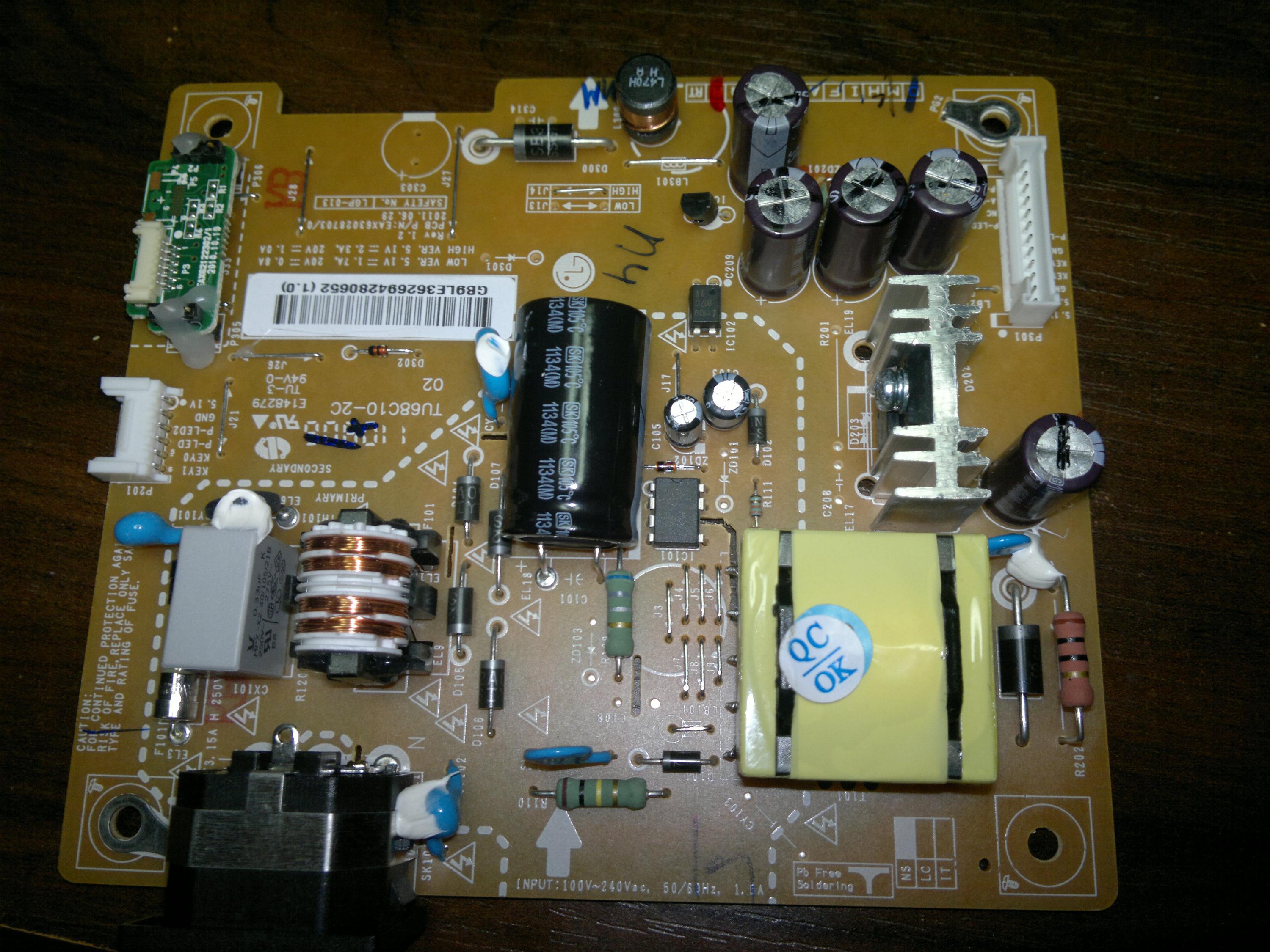

        Hi guys I have problem, i buy this monitor and in the power board there is missing
        C303( i dont know the value and voltage:/ The number for board is EAX63028703/0 and version HIGH. Meaby you have service manual or know values

          Is this a working monitor when you bought it? Pictures of the area around that C303 capacitor, as well as description of the circuit leading to C303 capacitor (possibly a partial schematic) may help us guess. Sometimes there are empty spots where the manufacturer simply changed their minds at the last moment and decided not to put a component there..

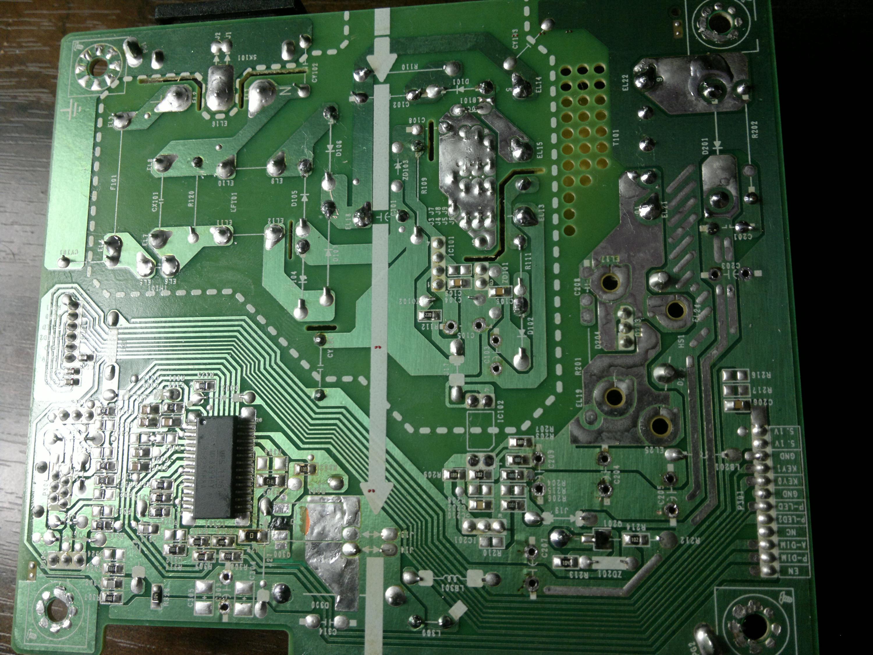

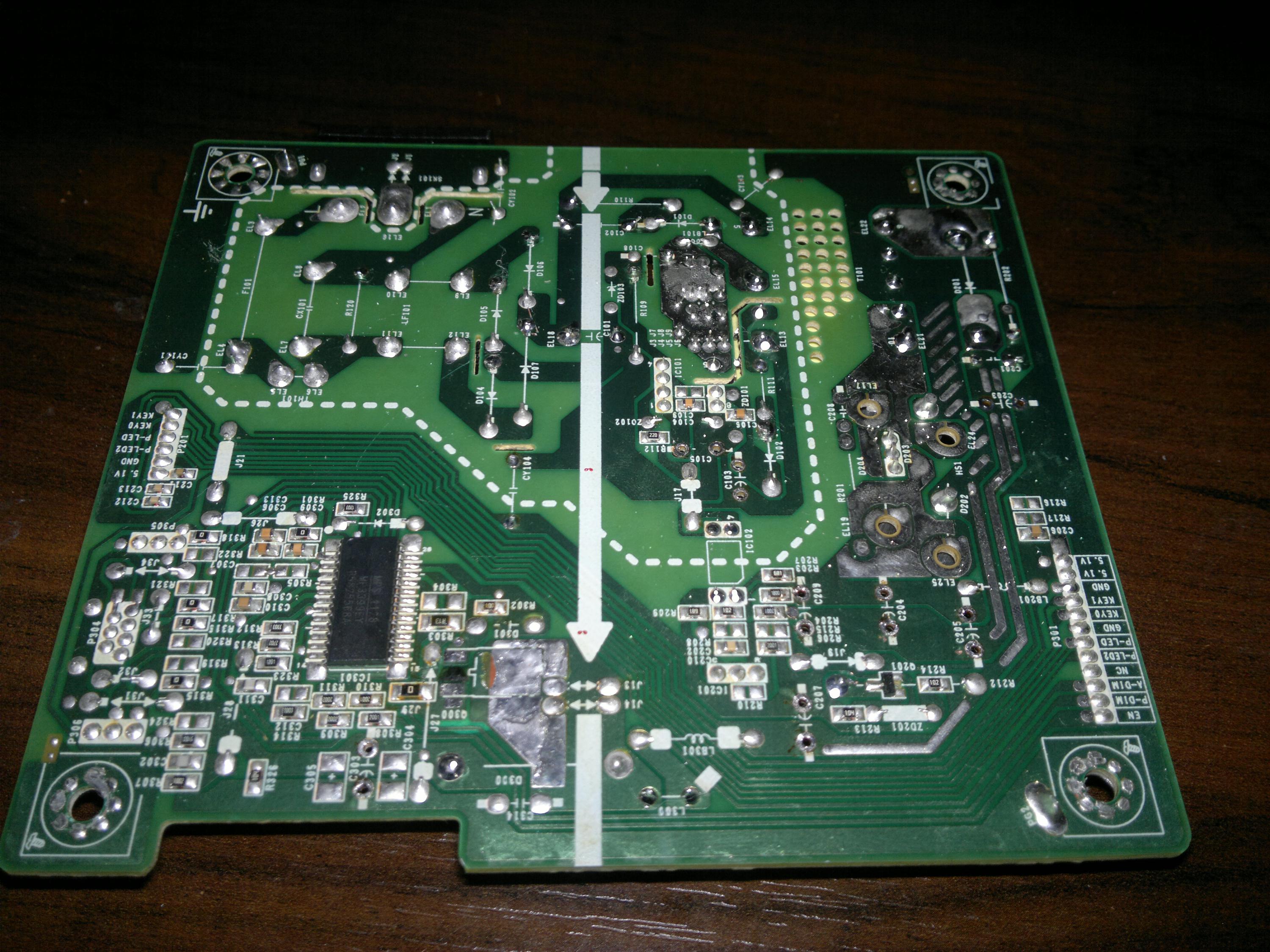

            I buy the monitor for repair and when i dissasemply i see that someone desolder the C303 and other capacitors meaby for test, solder the rest but no the 303. Monitor is dead when i buy, no led power I check the mosfet 18T10GH and is shorted, C303 is connected to that 18T10GH with positive leg

              Not good enough description. Please post pictures of that area. If possible, some partial (self-drawn) schematics as well. Is that capacitor surface mount type, or through hole type? Is this MOSFET in the inverter section?

                No the capacitor is normal through hole Electrolytic Capacitor, Su'scon shit The mosfet is connected to the led driver mp3399ey, this is led screen. I check all components in the upper layer, capacitos,diodes... all ok

                  Does it look like Q300 has been removed also.?
                  Looks like a big mosfet?

                    Looks like part of a boost converter, with that inductor/choke then followed by a rectifier diode. Could be anywhere from 4.7uf to 47uF (or higher). The voltage rating for that capacitor could be at least 100Vdc (and higher). According to MP3399EY datasheet sample schematics, its 22uF 100VDC although the inductor used was 33uH (while this board looks to be using 47uH)...

                      I remove the Q300 mosfet, test it and is shorted i upload the pictures after remove yup the inductor/choke is 47uH i test and is 45uH The diode is good I dont have that capacitor value, if i have i test the board replacing for good brand I emai a guy who sell identical board on ebay, the picture is above and i dont see the values

                        Hi guys i repair that monitor, the capacitor is 100V 47uf, 5v is stable
