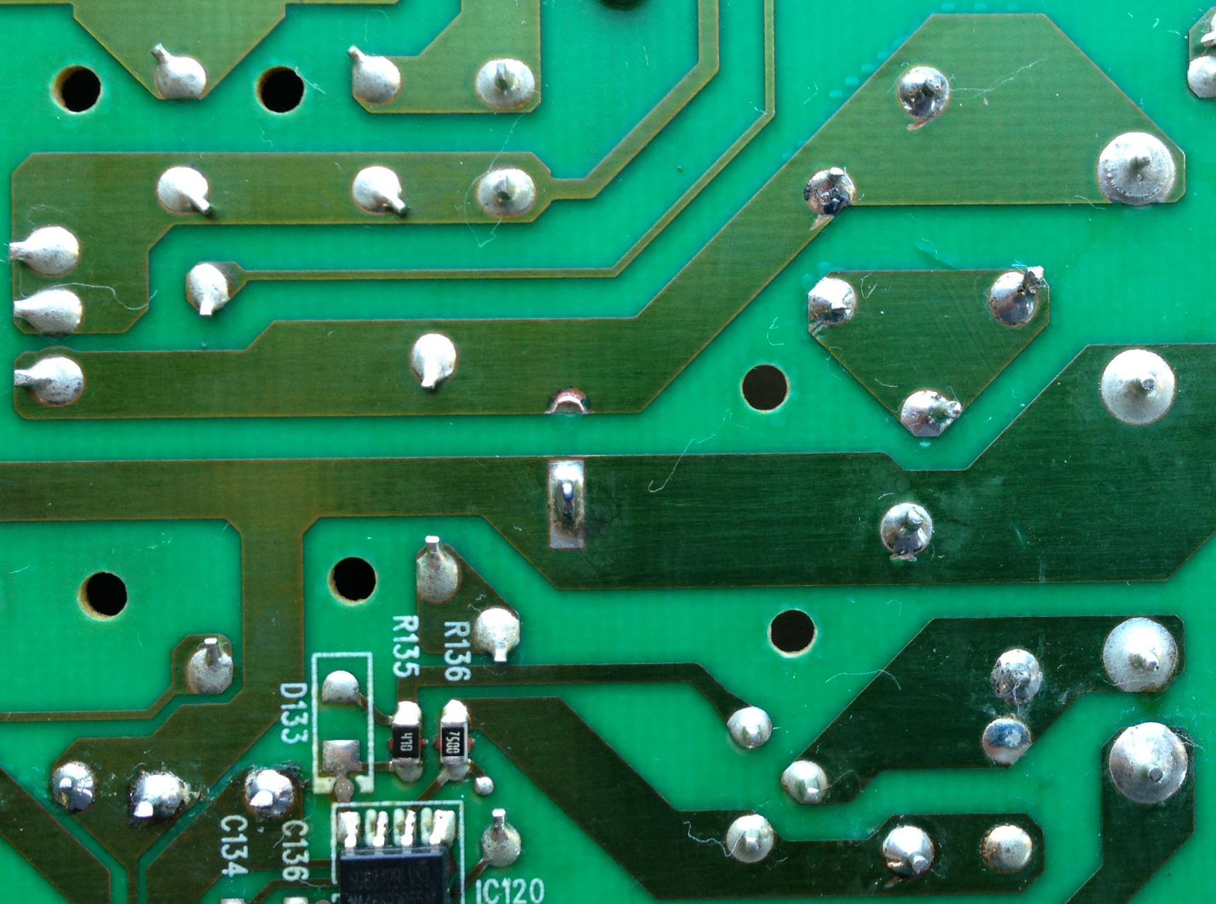

    OK, on pictures 1, you have black rectangular showing the two pin line up, but the third picture, the two pins are offset so I am confused as to what I am seeing, The solder joint of the bottom connection (round pad) on picture #3 looks bad too me.
    In picture #1, you are seeing the post and above it is where the trace was slightly exposed and where the spark / short jumped across and further exposed / damaged that trace. In picture #3, I agree that joint looks bad but if you look at the new picture is looks fine. I think lighting / reflection / angle or something made it look that horrible.
    Here is a new picture showing the post and the damaged / exposed trace above it.
    What could have caused the current to jump there? What do I need to do to remedy this?

      Re: Dell 3007wfp No Image
      That was high current arcing, enough to melt copper. May be there was piece of wire or metal object under the board that shorted out the two traces?
        When I removed the board, I noticed Thermal Paste which had smeared under the board (I didn't notice it when I re-assembled it). It wasn't much but that's the only thing I can see. The paste was Arctic Silver 5 which is not suppose to be electrically conductive but the manufacturer does state it can be slightly capacitive. If it was that, the monitor had been on for about 72 hours so ... what do you think?
        Is it safe to re-assemble? Should I look for something else? This happened right in that snuber circuit you described. Coincidence?
        Do I need to cover this exposed copper trace? What do you recommend I use?
          "electrically conductive" there may be contamination?
          I do not know but what ever it was, it conducted enough current to melt copper, you can put clear finger nail polish on the expose copper or just leave it, there is enough electrical clearance between the two traces.
            That's what I thought ... I'll add some clear nail polish on it. Make sure the board is ultra clean and re-assemble. It's kind of scary not knowing what exactly caused this. I can't help but think I got lucky that it didn't blow up any parts.
