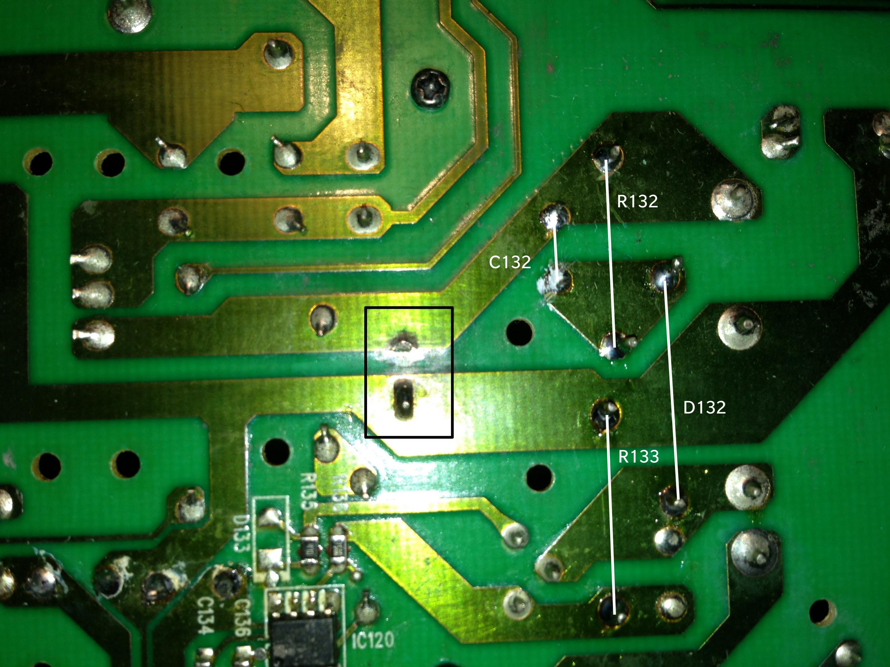

    The R132 (75k), D132, and the cap is part of the Snubber circuit to protect the MOSFET from damaging by the spike. You may want to check or replace the diode and the cap and verify if the resistor is still at 75 K).
      Re: Dell 3007wfp No Image
      Will check those and let you know the outcome.
      Thanks for the help

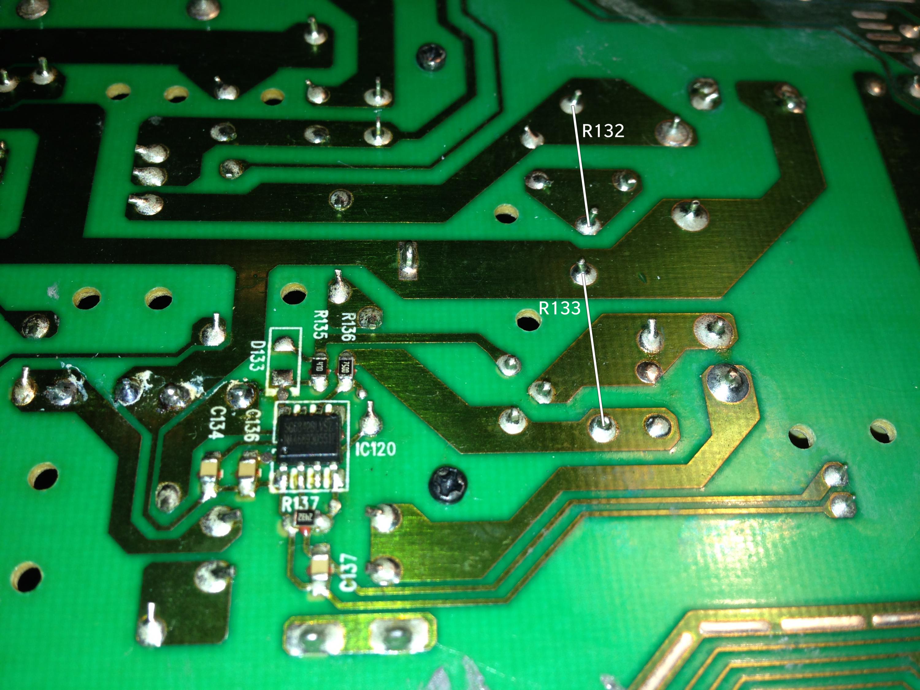

        By the way, the Source resistor R133, Can you look under the board to see if it has a Diode connected in parallel with that resistor?
          I don't see any Diode connected in parallel underneath but just in case, have a look.
            OK, just want to make sure, similar design will have a Zener Diode in parallel so the spkike voltage will not damage the current sensing circuit inside the SMPS IC, when the diode shorted out there will be very very current feedback to control the circuits, other person discovered that failure mode before due to squealing sound the power supply was making.
              The cap you are referring to is the C132 (472K 500V) right next to R132 (Correct)?
              R132 is 75K and its power rating 2 Watt?
                Yes, the Ceramic disc next to the 75K resistor, if it reads 75K within 5~10% then it is OK.
                  I just removed the resistor and it read 74.9K ... I removed the diode and it seems fine as well (450mv one way and Zero the other).
                  I removed the 2nd resistor (.36 ohm) and it reads .4 ohm but that's the accuracy of my meter (i believe).
                  I don't have anything to test that capacitor. If not this capacitor, what else, the MOSFET? How do I test that thing? Doesn't the issue have to be near this resistor (75K) which is making that high-pitch noise?

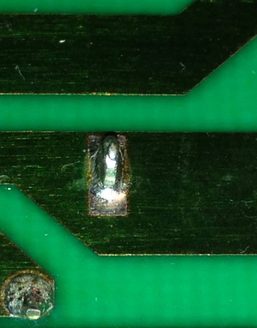

                                    Monitor worked fine for over 48 hours. About 30 minutes ago, while I was using it, a big electric zap (spark) sound occurred. After this sound, the monitor was still operational (image being displayed was all fine) but for obvious reasons, I unplugged it.
                                    I took it apart again, and found the area where the spark / short occurred. It is right in the area of C132, R132 and R133. Something is definitely going on there.
                                    Given my limited understanding of electronics, I have no idea what is causing this. R132, R133 all check out. D132 is fine as well. C132 was replaced but it is of different tolerance -20% to +85% vs original cap 10%.
                                    Could it be that Mosfet K3265 (Toshiba part)? If so that part is obsolete so what would be a good replacement?
                                    If not that, what else do you suspect could be wrong?
                                    Added a third image showing where this Jump / Short occurred. You could see a slight part of the trace exposed.

                                      That looks like poor solder joints, the post of the heat sink is used for electrical connection, you should re-solder those two joints in the #3 pictures, use good soldering iron and flux.
                                        #39
                                        I'll redo the soldering on that post but neither of those visible in that image had been altered by me. That's original solder.
                                        Looks like it current jumped from that post to the trace above it where a slight part of the trace was exposed.
                                        Should I cover that exposed part of the trace above that post? If so what do you recommend I use?
                                        What may have caused this?
                                          #40
                                          OK, on pictures 1, you have black rectangular showing the two pin line up, but the third picture, the two pins are offset so I am confused as to what I am seeing, The solder joint of the bottom connection (round pad) on picture #3 looks bad too me.
