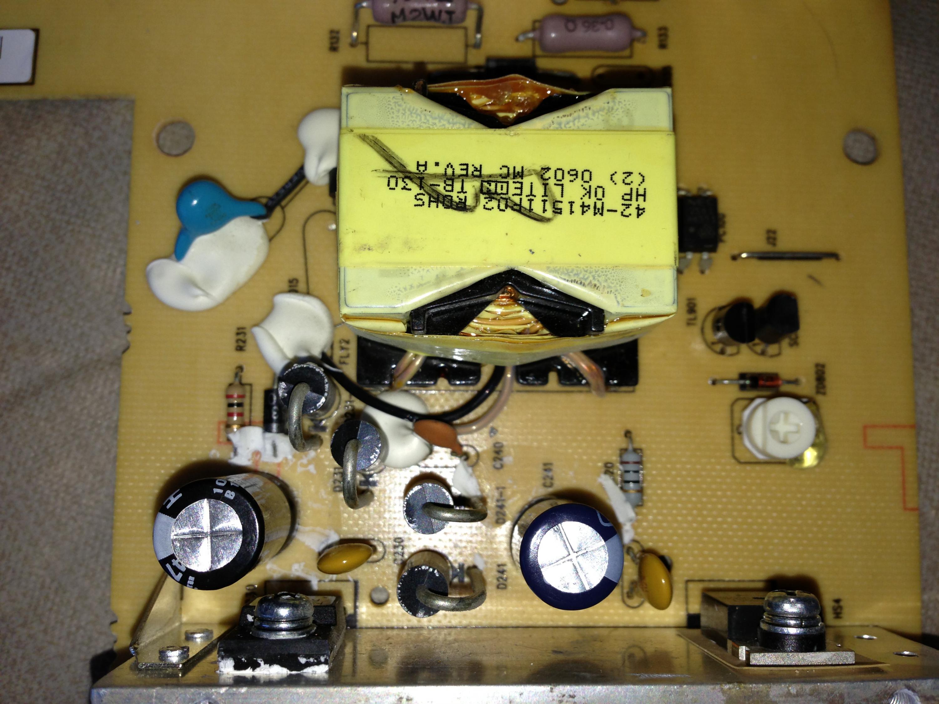

                        Ok. I changed the Capacitors on the PSU. I also replace the surface mount fuse on the controller board.
                        I connected power to the monitor and it is now going into test mode (which it was not doing anymore). I'll connect it to the PC but I am assuming it is ok.
                        However, I do hear some slight humming / buzzing coming from the power board... What might be causing this?

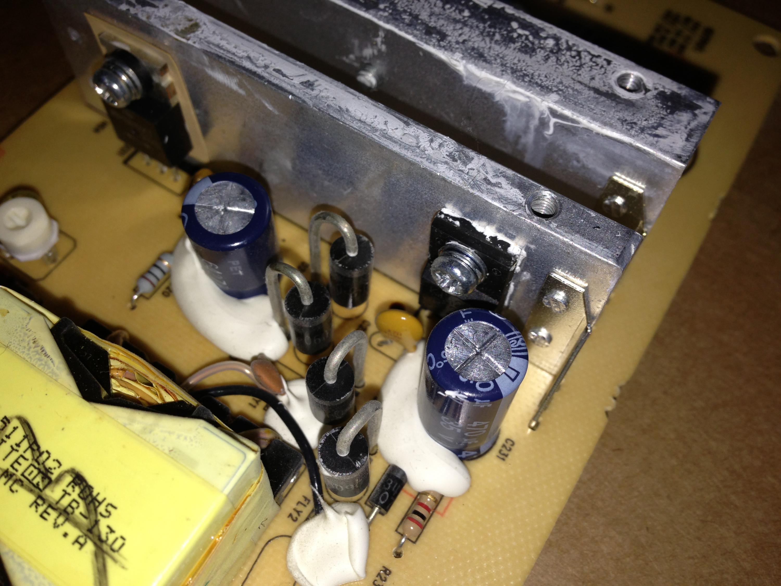

                            Quick update: The faint whistling sound is coming from either the 330uf 50v or the 470uf 35v ( i think or some part next to them). When I connect power to the board, I can hear the capacitor charging (sound wise)... the sound is slightly louder when it is charging and then it gets quieter but still makes a faint high pitch sound.
                            So is it one of the capacitor or something else causing it?

                                Right now the monitor is disassembled. It is doing this faint high pitch sound with only the power board connected and powered.

                                  Re: Dell 3007wfp No Image
                                  The monitor works now but I just need some feedback on this faint high-pitch noise.
                                  Is it normal or not?
                                  Is it that capacitor or maybe something else. What should I look at to isolate / fix this (if it is something of concern)?

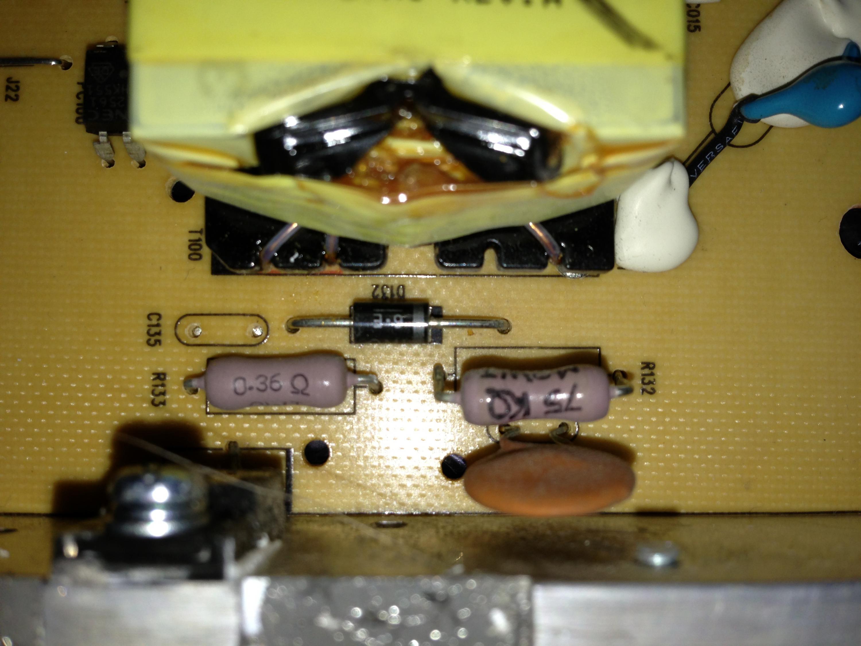

                                    Here is a picture of the part of the power supply board where I believe the high pitch noise is coming from.
                                    Could this 102M KX250 X1Y1 capacitor be responsible for it? Should I replace it or could some other part near it be responsible? All other capacitors have been replaced and even re-swapped with no change on this high pitch.
                                    I just need this last bit of feedback to wrap this up. Like I said the monitor now appears to be working but I don't want to put it back together if this faint high pitch noise is likely to result in some other damage in the near future.
                                      If you push it with wooden stick, does it change its pitch? It may be running at the wrong frequency also, hard to tell.

                                        When I press (with a wooden stick) on this 75 Kohms resistor, the pitch does change. It doesn't completely stop it from making that faint high pitch sound but the frequency of the sound changes / become significantly dampened (like absorbed by the wood).
