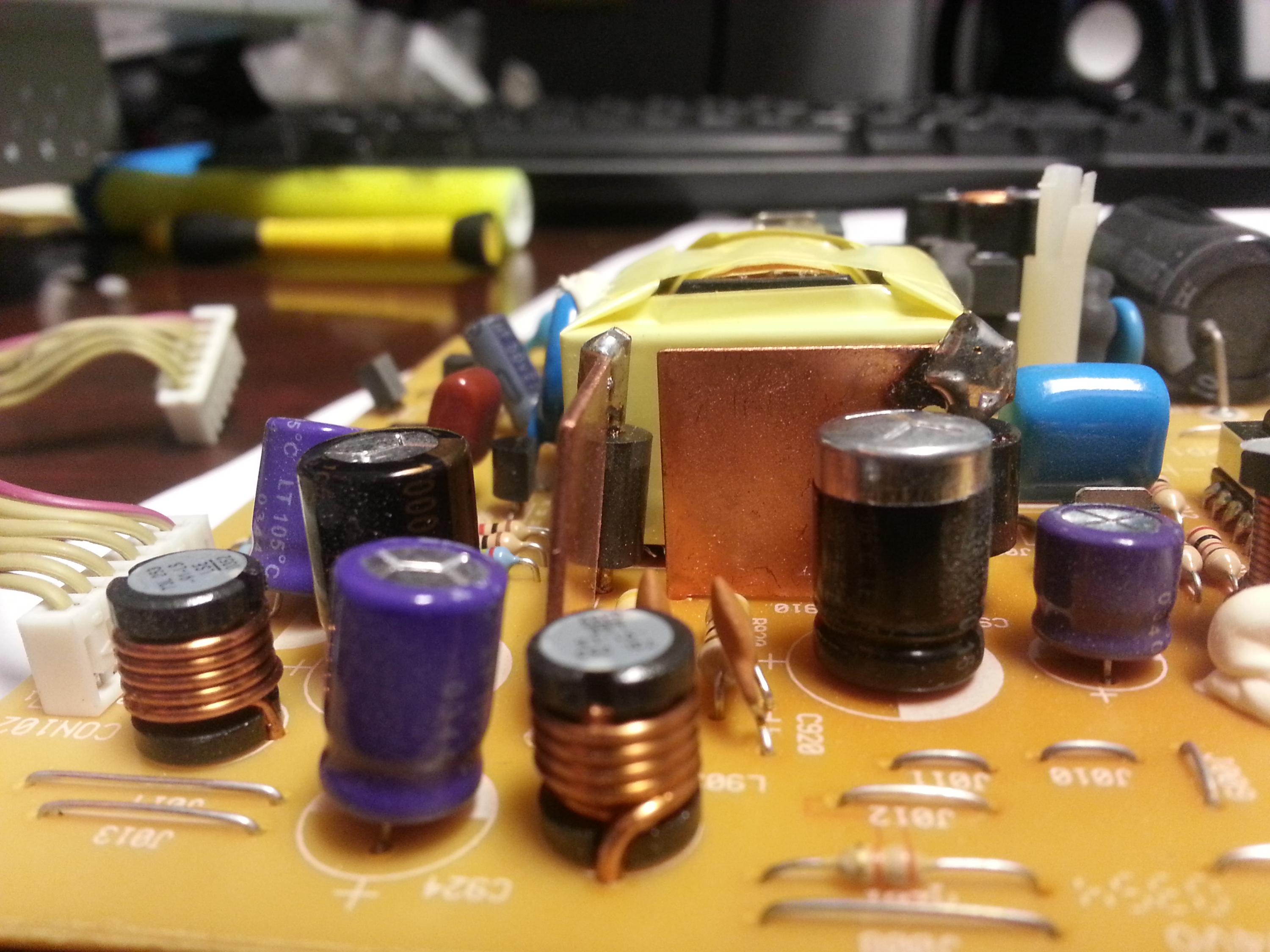

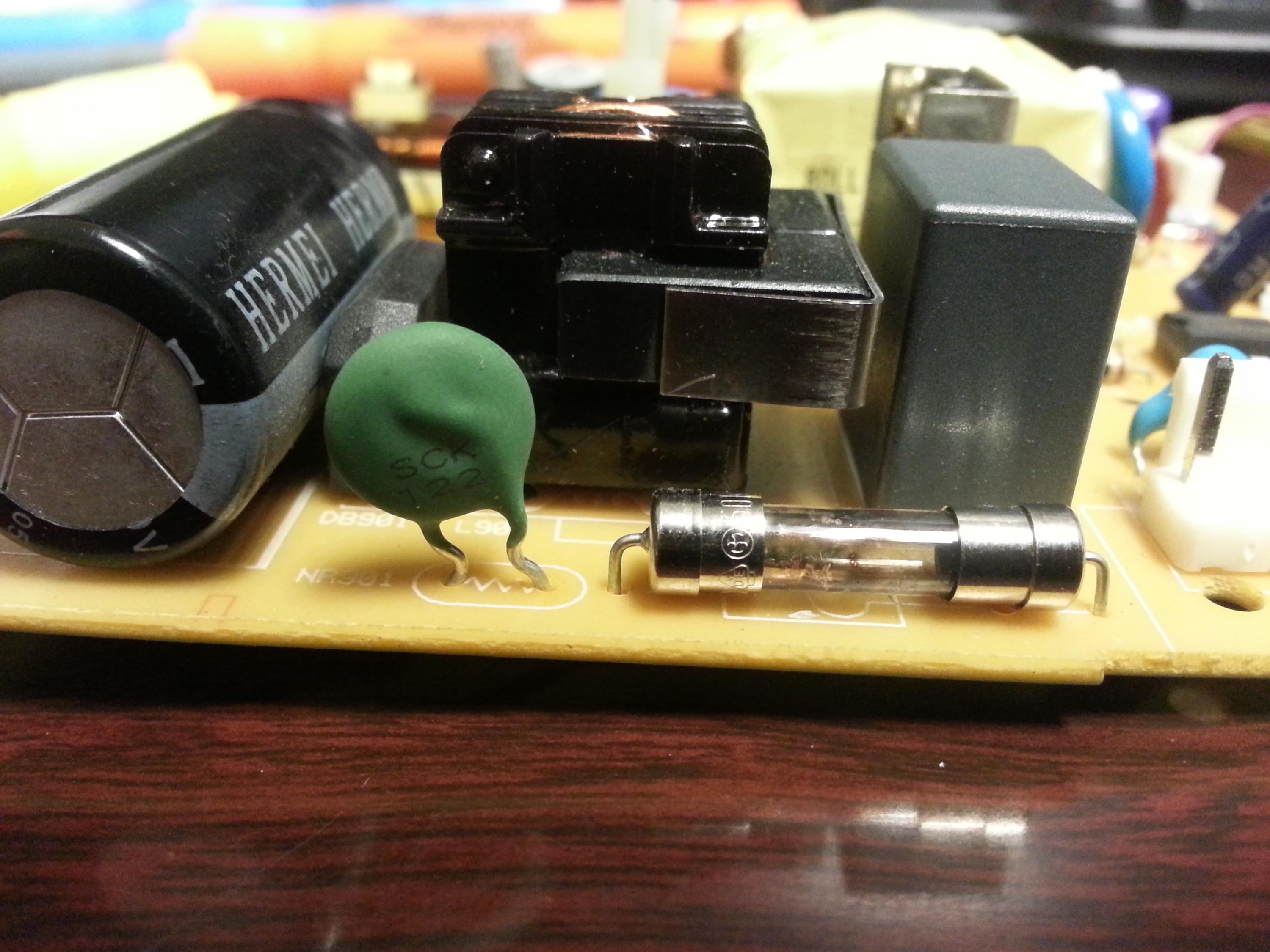

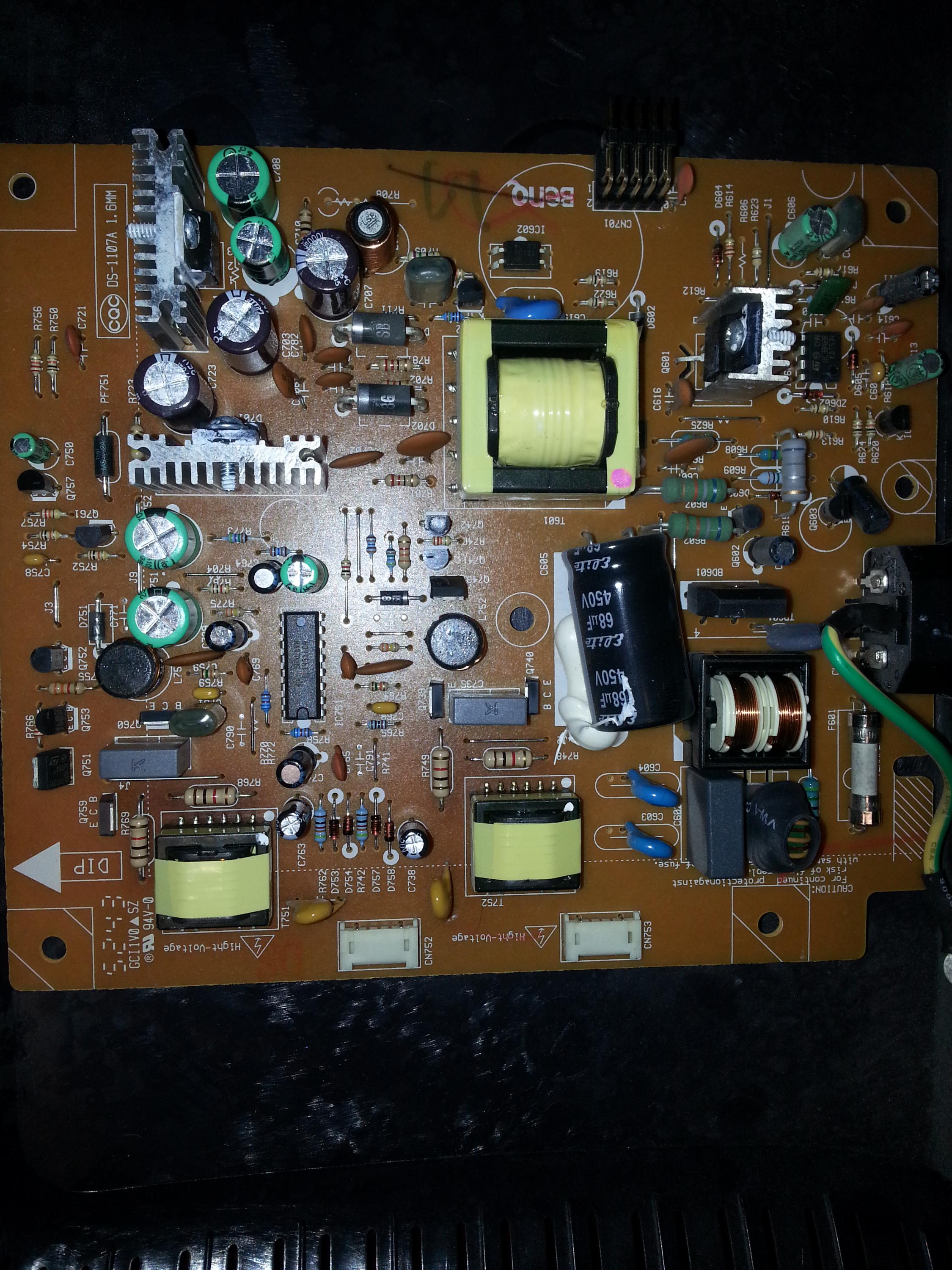

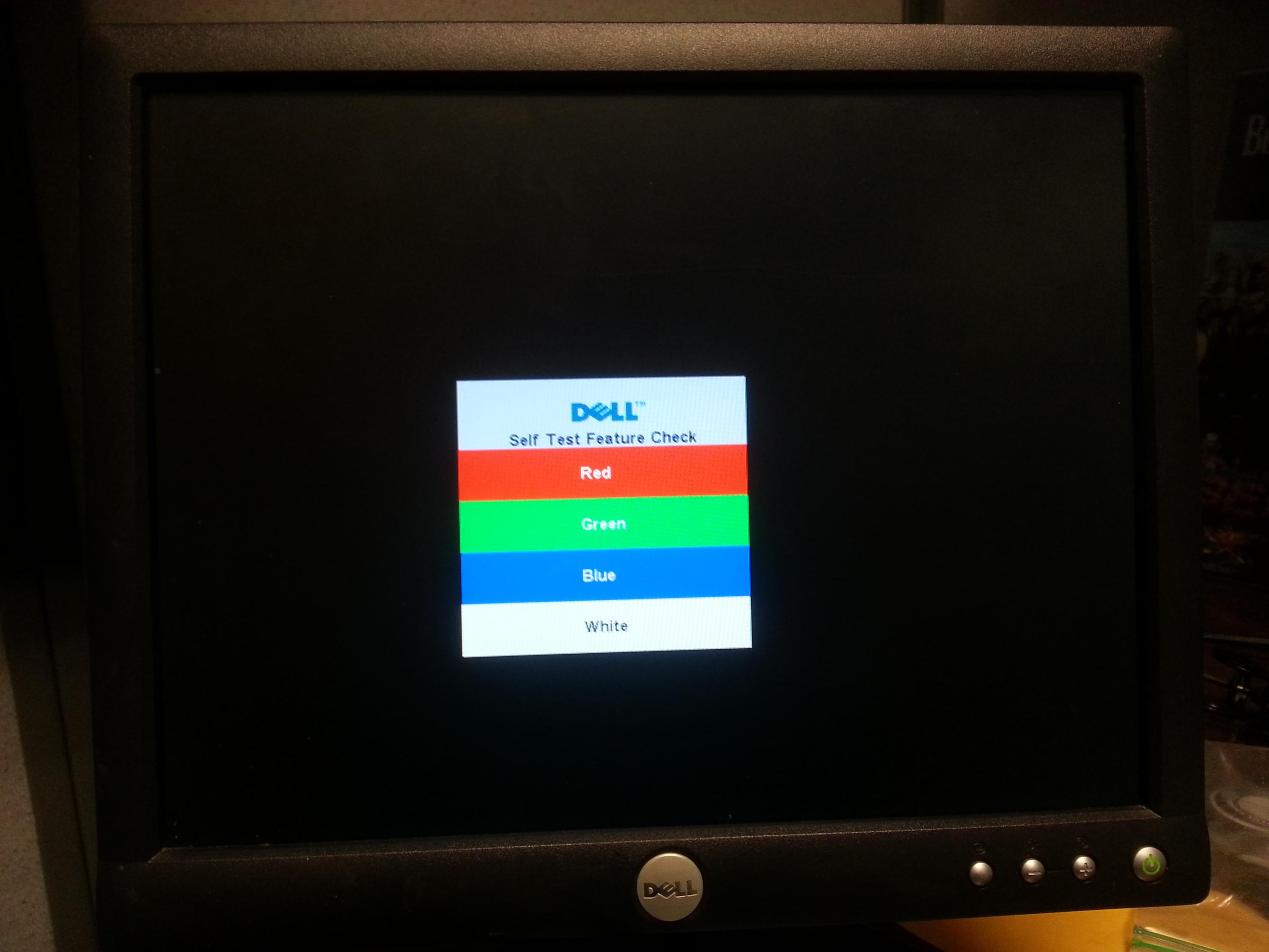

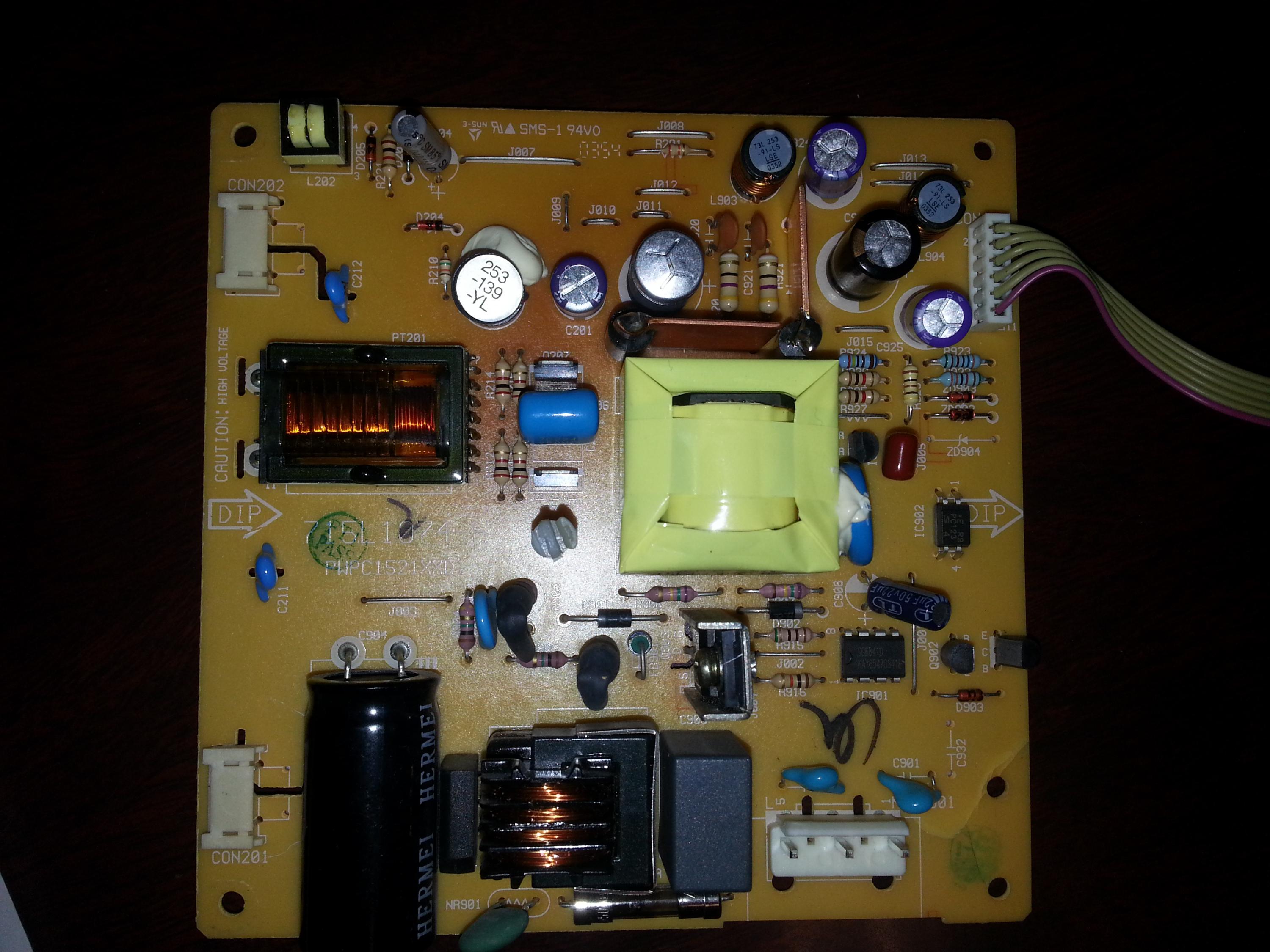

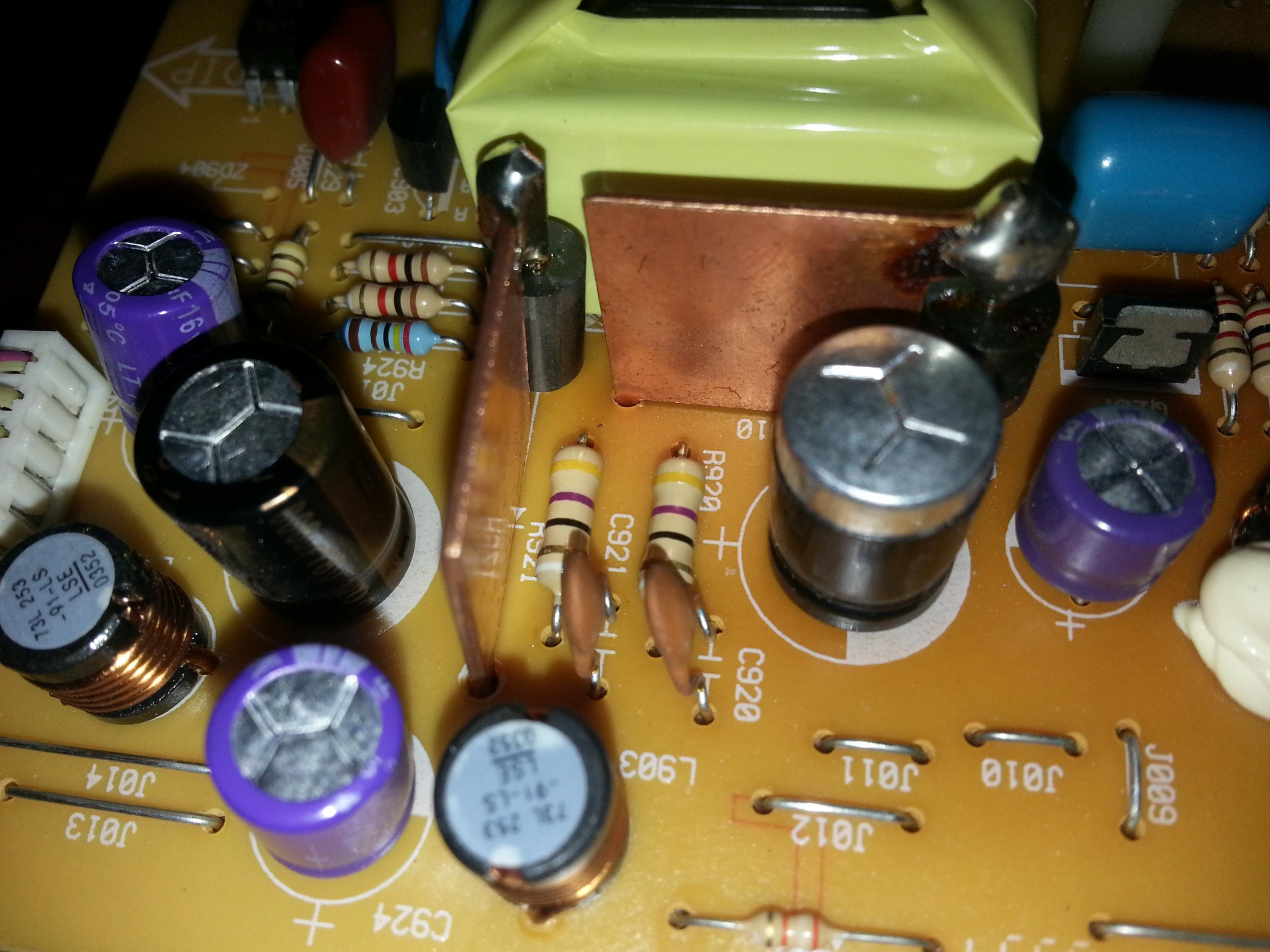

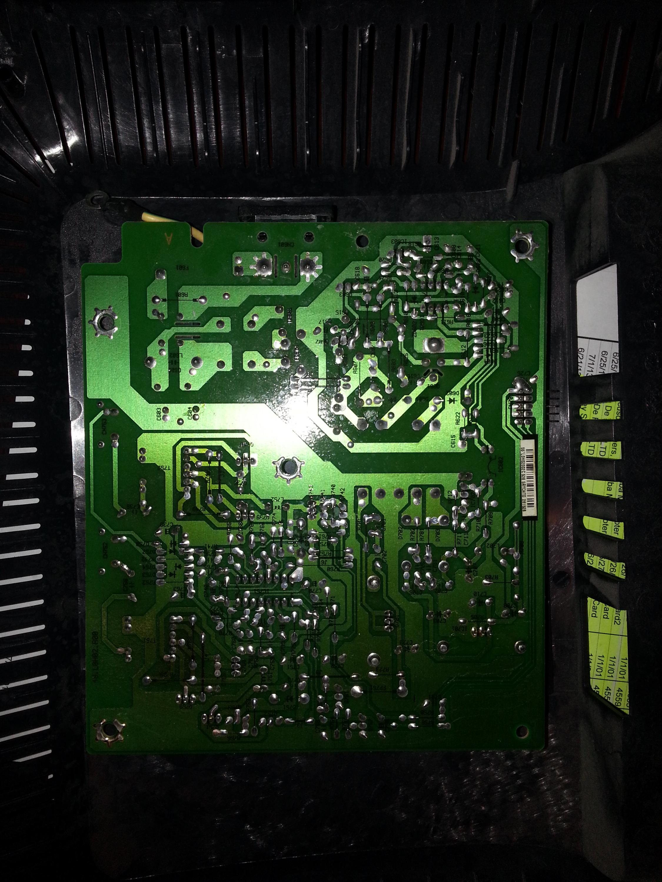

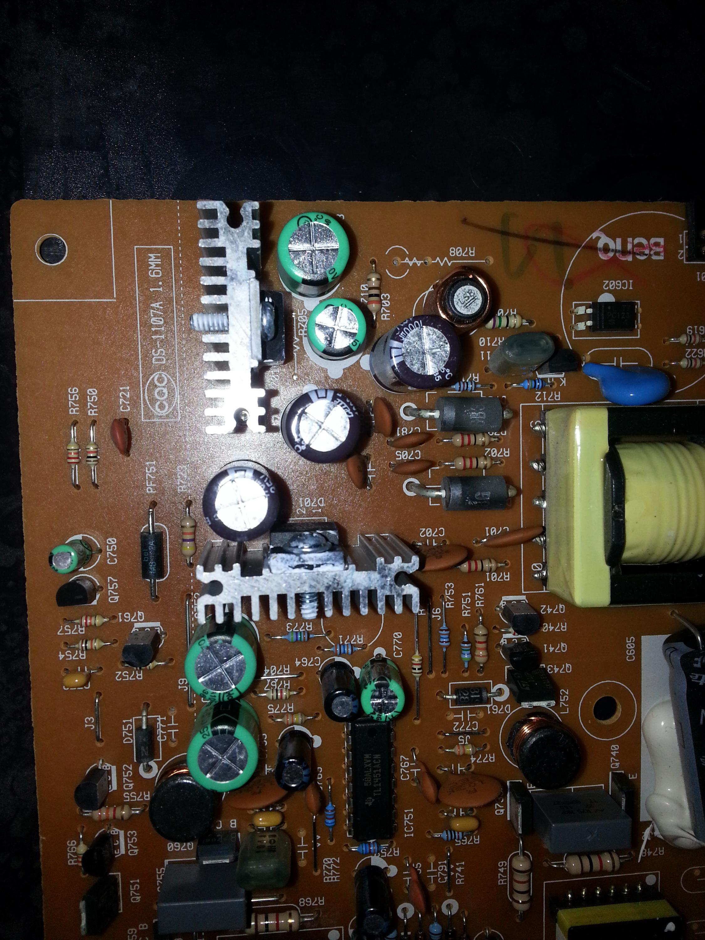

Dell e152fpc
+ More Options
Posts
  • domyanite
    • Jul 2013
    • 11
    Dell e152fpc
    Hi all, so around my office we have a few of these dell e152s which are fairly old and now dying. One with 2 seconds to black and one with no power at all. I am fairly certain the caps have gone bad as you will see in the photos. On the one that will not power on, the fuse is blackened. Do I just unsolder that the same as the caps to replace?
  • Rtech
    • Jul 2010
    • 1095
    Re: Dell e152fpc
    Changing the bad caps is correct,BUT fuses do not normally fail for no reason,so suspect there may be another problem !!A photo of the whole Board fom the top may also help.
    • domyanite
      • Jul 2013
      • 11
      Re: Dell e152fpc
      Ah, sorry about that, here is the whole board. So the bad caps won't kill a fuse? that is too bad. At least I still have one I can try to recap if blown fuse is bad news.
        Re: Dell e152fpc
        When fuse is blown and has blackened inside, it was exposed too very high current. So you need to at least check the bridge rectifier and the MOSFET that drives the power trnasformer to see if they are shorted out or not.
        • Rtech
          • Jul 2010
          • 1095
          Re: Dell e152fpc
          As advised by Budm, I have ringed the two components for you ....
          • domyanite
            • Jul 2013
            • 11
            Re: Dell e152fpc
            Huh well that does seem a bit more complicated, do i just run current though them with a multi-meter via the pins on the bottom of the board?
            • Rtech
              • Jul 2010
              • 1095
              Re: Dell e152fpc
              testing the Bridge Rectifier.......http://www.youtube.com/watch?v=dqkT6hF0O3E
              testing the Mosfet.........http://www.4qdtec.com/mostest.html
              • domyanite
                • Jul 2013
                • 11
                Re: Dell e152fpc
                Partly good news! I did not remember to bring my multi-meter with me, but I recapped one of the other dead screens and it appears to have been a success! I used Rubycon caps, the 16v1000uf's seemed a bit taller than the old ones but they fit just fine. Have only had it on for a short while but it has not gone black yet!
                Thanks for the help so far!
                • Rtech
                  • Jul 2010
                  • 1095
                  Re: Dell e152fpc
                  So far so good.......and next !!!!
                  • domyanite
                    • Jul 2013
                    • 11
                    Re: Dell e152fpc
                    Ugh the next one is a different revision it appears once I got it apart. Totally different boards. This one has a much larger powerboard that was directly connected to video board through some pins. Also some new components to me.
                    This display would constantly cycle it's screen on and off. The caps look ok to me but I am no expert and one does seem taller than the others of same type. I figure recap it and see how it takes it?
                      Re: Dell e152fpc
                      Check the resistance reading of that fuse PF751, it should be less than one Ohm, this fuse when it is bad, the resistance will be > 5 Ohms.
                      Also re-solder all the joints on the transformers' pins, transistors, etc. Check those transistors next to the grey tuning caps in the inverter section.
                      http://s807.photobucket.com/user/bud...tml?sort=3&o=0
                      http://s807.photobucket.com/user/bud...tml?sort=3&o=1
                      http://s807.photobucket.com/user/bud...tml?sort=3&o=8
                      http://s807.photobucket.com/user/bud...?sort=3&page=1
                      • domyanite
                        • Jul 2013
                        • 11
                        Re: Dell e152fpc
                        Yes now that you mention it and examining the board a bit the power connector has a broken solder joint and it wiggles quite a bit, can even see the pin move around on the bottom side.
                        • domyanite
                          • Jul 2013
                          • 11
                          Re: Dell e152fpc
                          Okay fixed up the solder for the power plug and so far it seems to be functioning properly. 2 for 3 repaired so far i think!
                          • Bowline
                            by Bowline
                            06-11-2025, 10:13 AM
                          • corrize
                            by corrize
                            10-19-2023, 09:58 AM
                          • F R 2568
                            Dell Latitude 5420 does not start (no post) need help to find the reason why
                            by F R 2568
                            Hello all,
                            this is my first post, so if I make mistakes please do not hesitate to point them out, thank you in advance.
                            I got a Dell Latitude 5420 (Service Tag: 7RFM6D3, Motherboard: GDF40 LA-491P Rev.: 2.0 (A01)) which does not start and I want to repair it. These are the symptoms:
                            If the laptop is only connected to the AC adapter (battery removed):
                            When I press the power button, the keyboard backlight and the display backlight are turning on. Caps key light is lightning, but key does not respond to pressing it.
                            The power/battery...
                            01-08-2025, 05:45 AM
                          • diamon
                            Looking for Dell Latitude 5520 / 5530 / 5540 RJ45 network connector replacement
                            by diamon
                            I have a Dell Latitude 5530 with a damaged RJ45 network connector. See the attached pictures.
                            Have already searched on Farnell / Aliexpress / Ebay and had contact with several suppliers on Aliexpress and Ebay, but they cannot deliver this connector.
                            Is there someone inside the EU, who has these connector(s) or perhaps defective motherboard(s) for these laptop models I have mentioned in the topic title.
                            Pictures of these boards:
                            Dell Latitude 5520 https://www.ebay.com/itm/256052956663
                            Dell Latitude 5530 https://www.ebay.com/itm/125844181534
                            Dell...
                            02-28-2024, 12:51 PM
                          • lalle-
                            Dell G5 SE 5505 - "Invalid memory installed" after BIOS update.
                            by lalle-
                            Hello!
                            I have a problem with a Dell G5 SE 5505 laptop that I hope someone can give me a few pointers on.
                            [OK, it's not really a laptop, I'm running the motherboard on my desktop with only cooling, RAM and an M2 drive attached.]
                            I had some performance issues, so I decided to update my BIOS from 1.7.0 to the latest version, 1.20.0.
                            The computer restarted and the update dit not want to continue without a battery connected, even though I used dell's method of bypassing this requirement.
                            I tried updating to a custom BIOS from Reddit user Satori_Nori https://www...
                            08-11-2024, 02:01 PM
