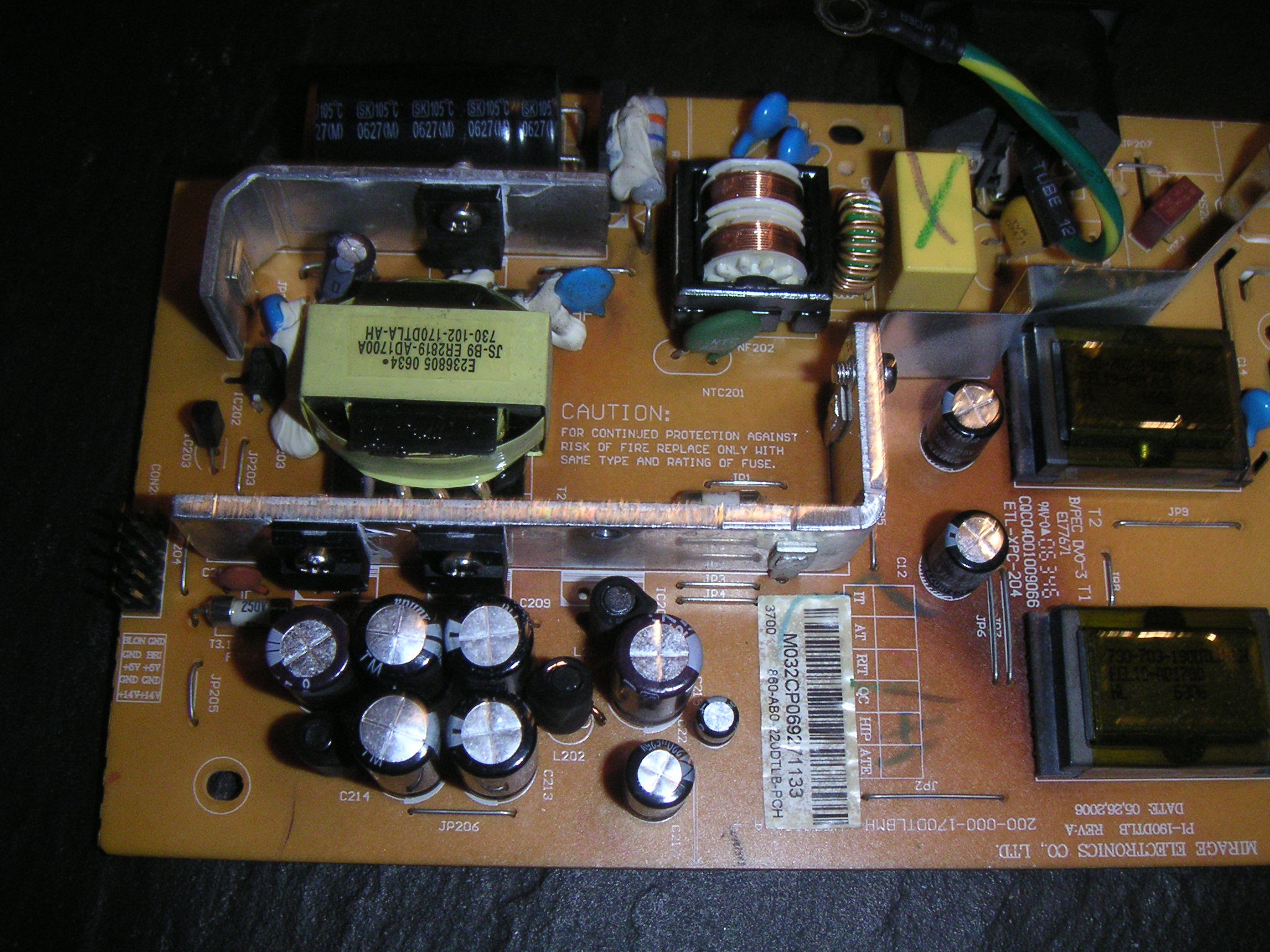

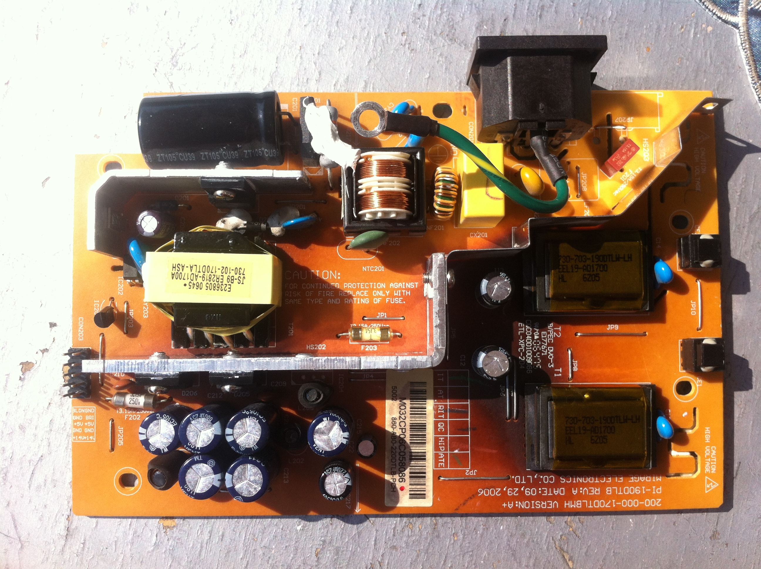

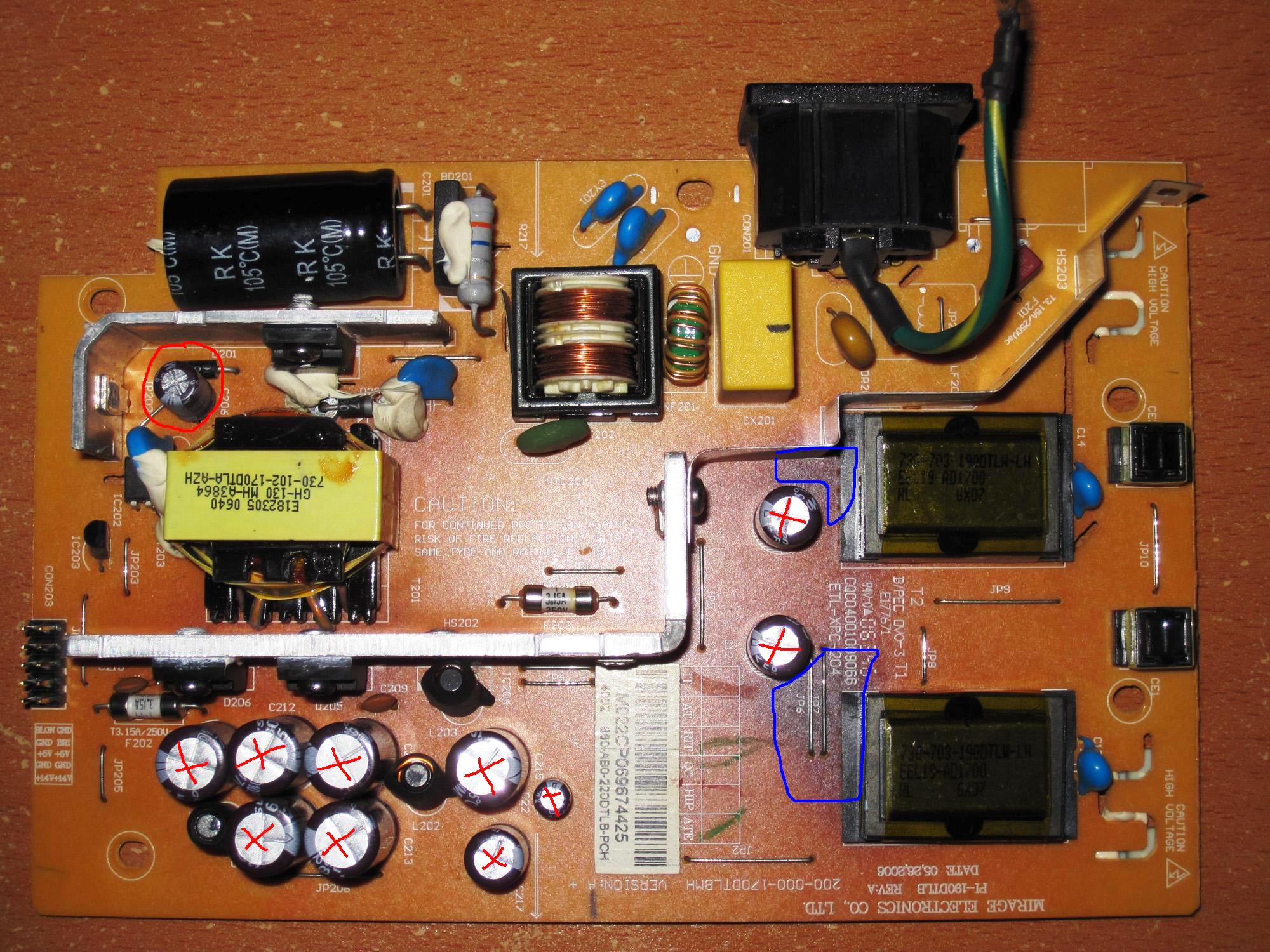

    I collected this display for free yesterday, was advertised as a non working unit.
    The previous owner explained that the display stopped working, now only showing a white screen.
    I have removed the back cover, and the power supply has 3 bulging caps
    The bads ones are Xunda brand, so probably a chinese poor quality product.
    (2 x 220 µf 25 v and 4 x 680 µf 25v)
    Also two Su Scon caps on the same board (taiwan ?) (470 µf 25 v)
    I will probably remove all those and try a recap.
    What capacitors will do the job ?

    Panasonic FR range should be good.Make sure that the Physical sizes of the new caps are similar to the original,if there is a cover over the top etc.

      Thanks,
      No no cover over the top, the board is connected upside down.
      I have found a set of Rubycon XYG but those are 330 µf 35 v and 680 µf 35 v
      will those be suitable ?
      • sabre504
        • May 2010
        • 449
        • United Kingdom
        Re: Fujitsu Siemens 23" LCD Scaleoview
        Hi i would change all the ones mrked in red
        and stay with the same uf but you can go up in voltage as long as they are the correct size and fit

          Hi, thanks,
          Most of them already removed, will let you know.

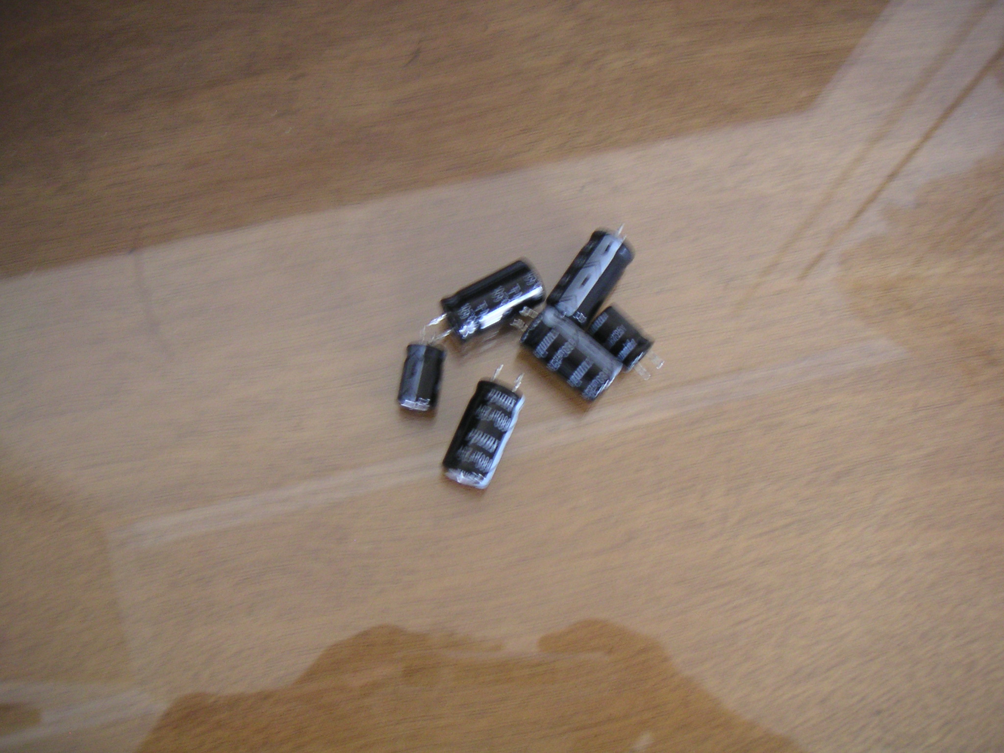

          • bibilit
            • May 2013
            • 20
            • Montrouge

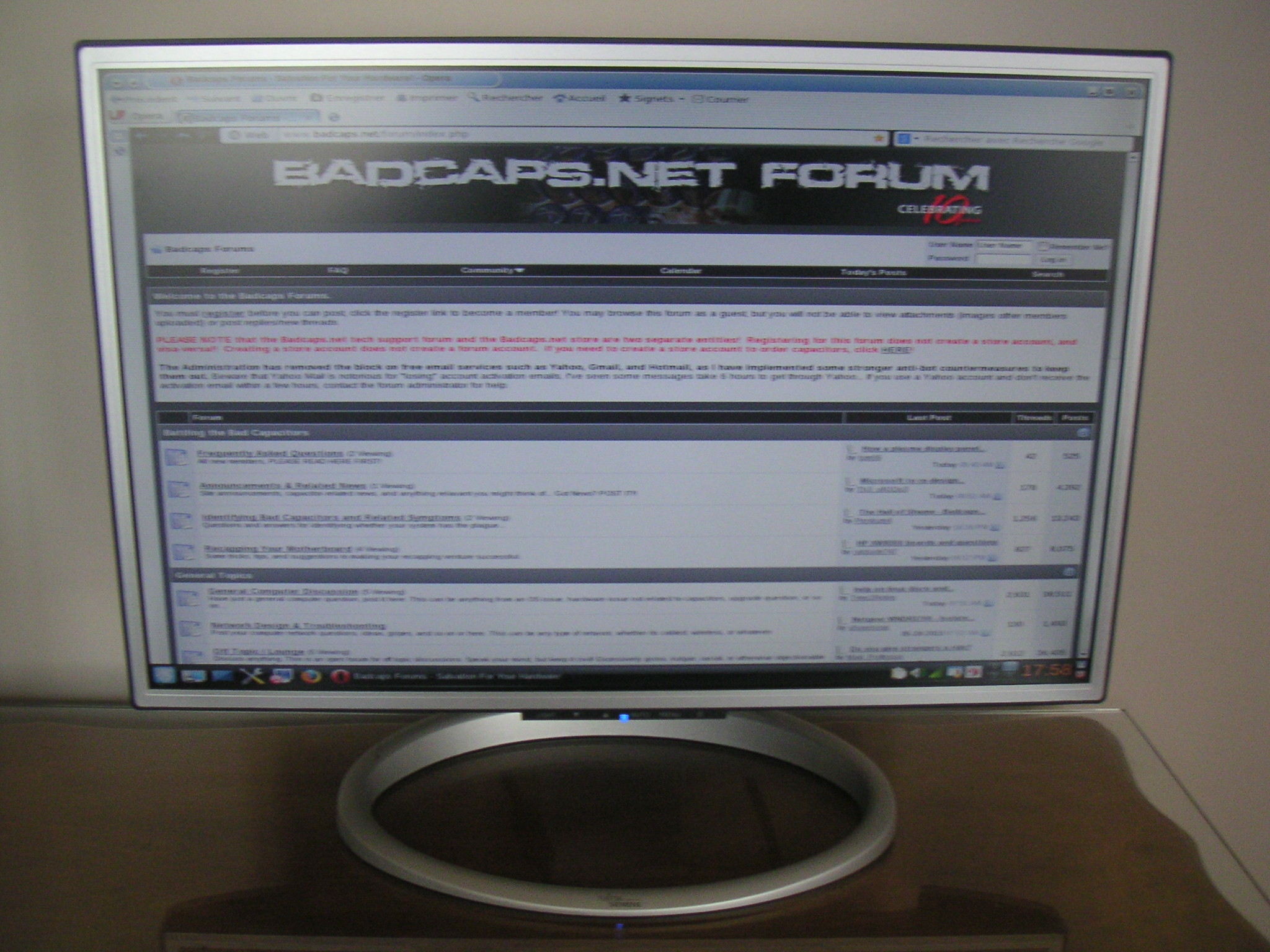

            So just a quick update, i removed all advised caps, collected the required units and soldered back (Panasonic FR)
            And the display came back to life
            ps: sorry for the bad pics

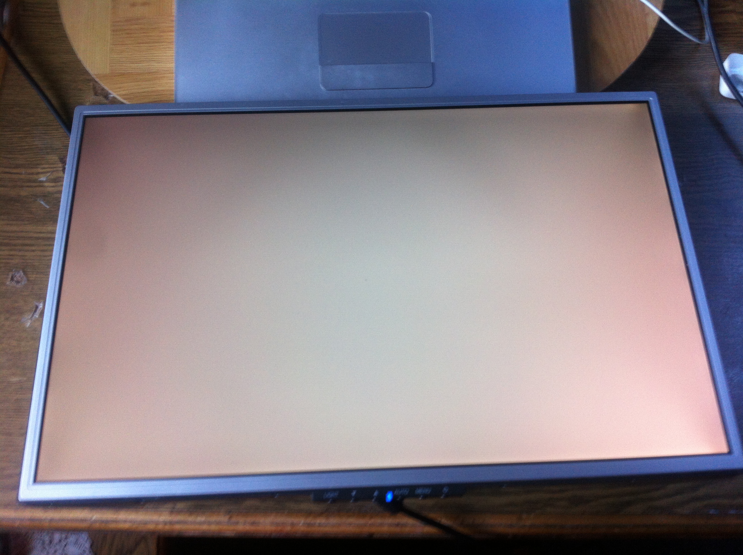

                i have the same problem with my Scaleoview 23" monitor
                but i dont see any bulging caps do you have any suggestions?

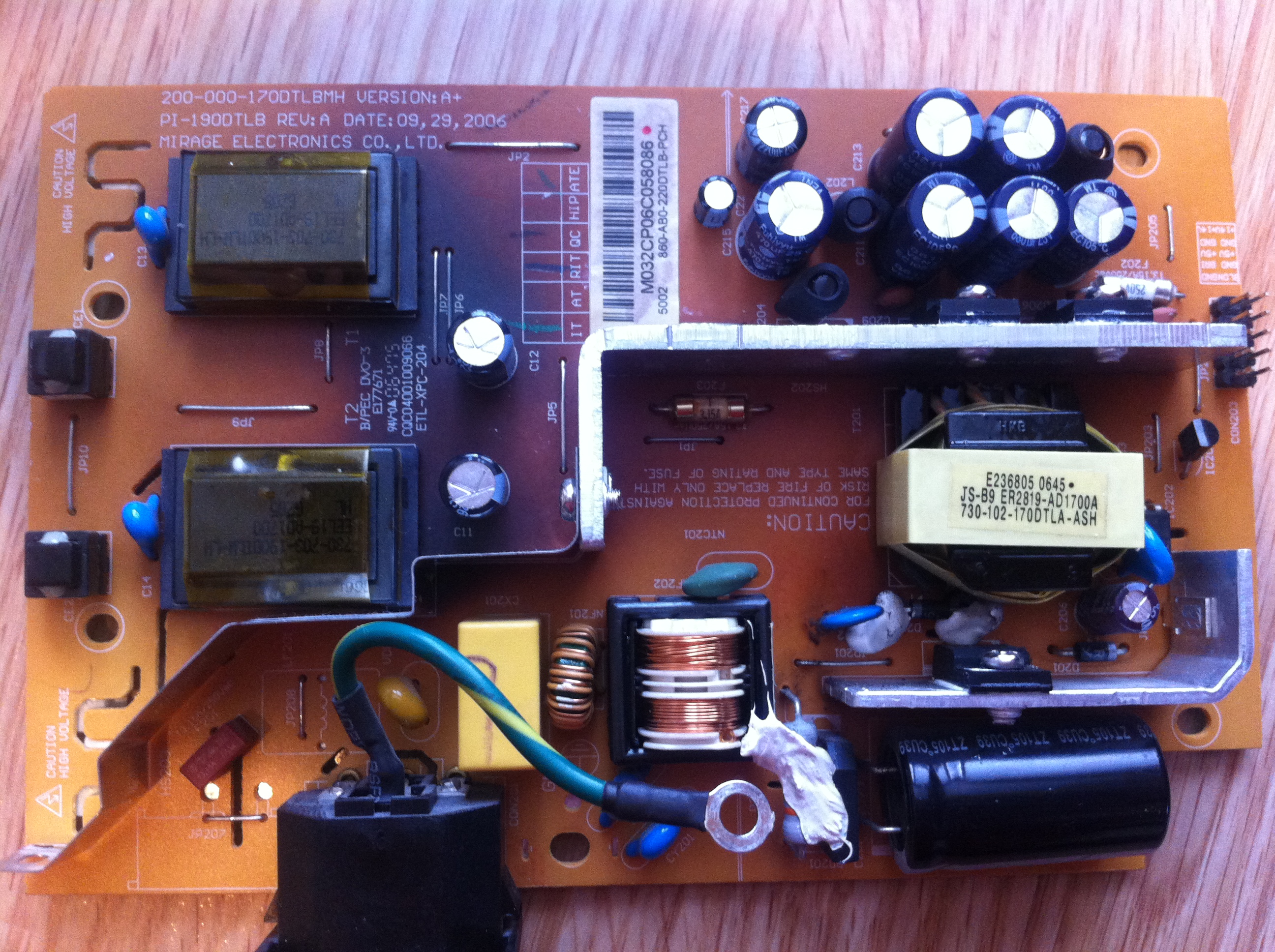

                      • 0burn0
                        • May 2014
                        • 16
                        • Serbia

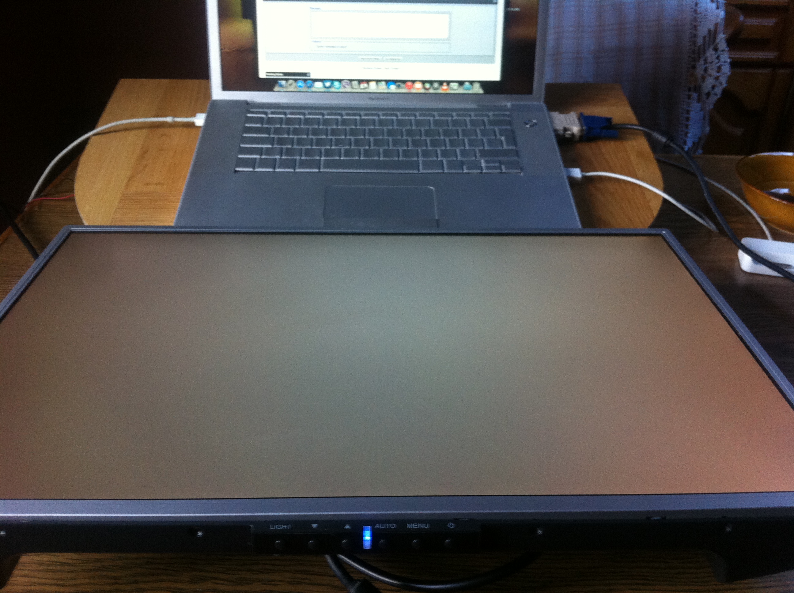

                        Display is not flashing for a second its white and lights are working
                        i cant see menu when i press menu button its just white screen
                        heres photo of PSU

                          yes power button turn on and off led indicator
                          its not flashing i got constant white screen

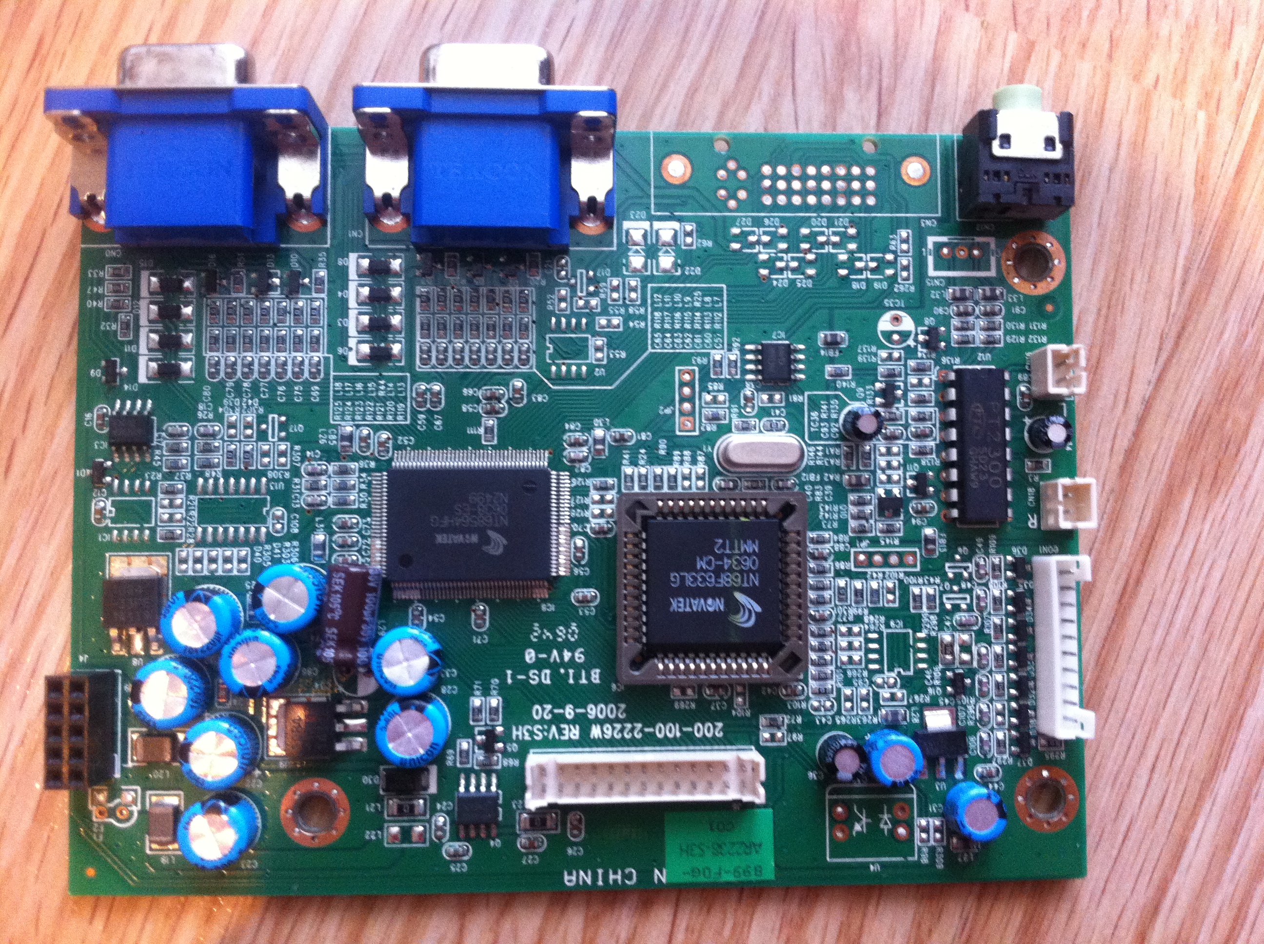

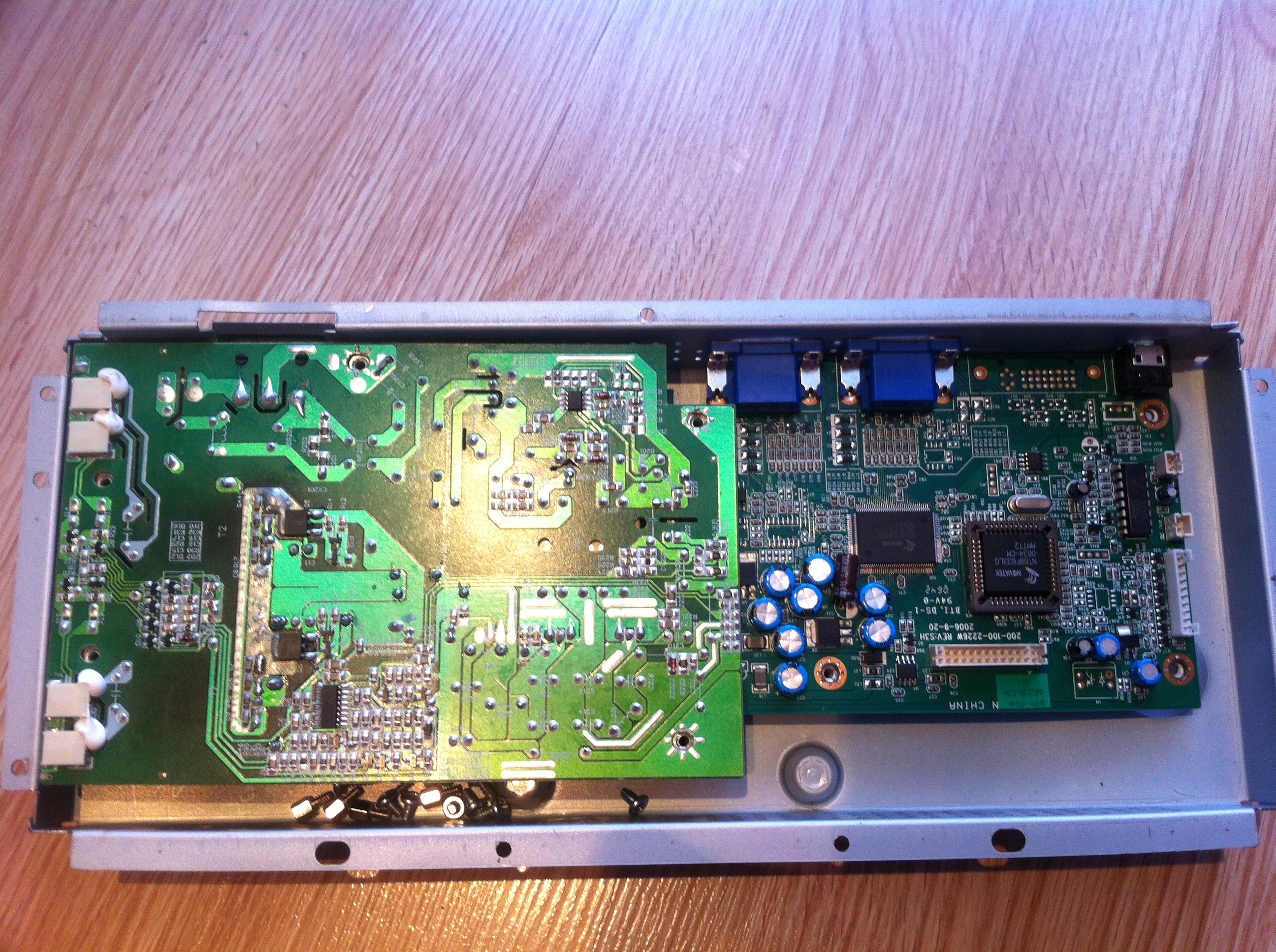

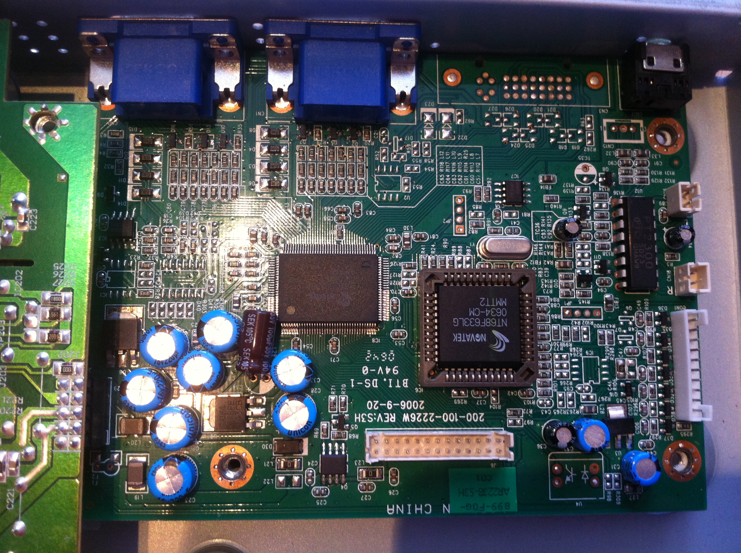

                          • bammbammfran
                            • Apr 2014
                            • 476
                            ok
                            You are going to need to post pictures for any further help
                            One picture should show the entire back of the screen with the boards in place
                            and then at least one of the main input board and one of the power supply
                            I think that the power from the main input board is not getting to the lcd panel
                                  heres photo of PSU

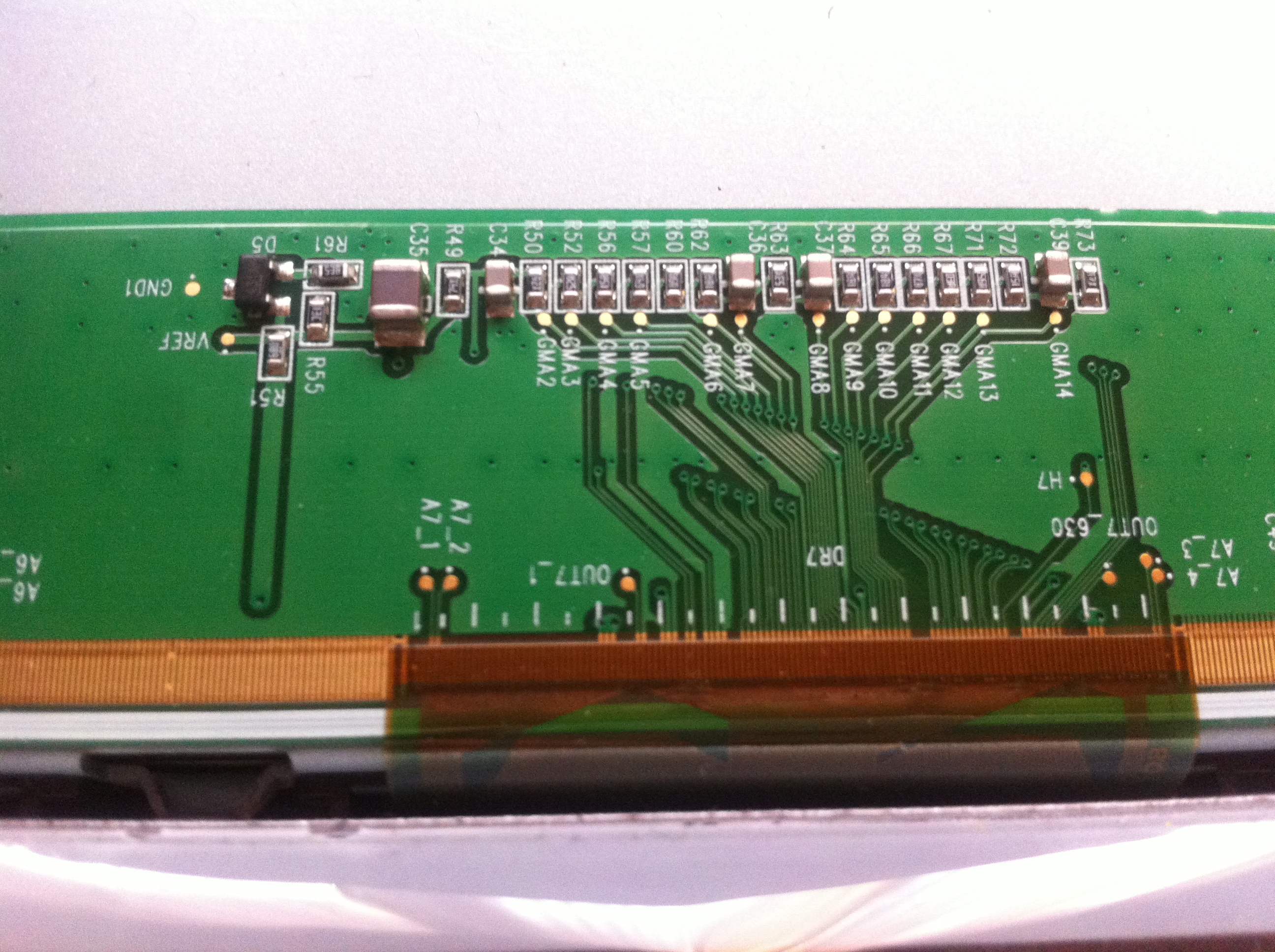

                                  Can we see the screen shot of this symptom?
                                  • 0burn0
                                    • May 2014
                                    • 16
                                    • Serbia
                                    Originally posted by budm
                                    can we see the screen shot of this symptom?

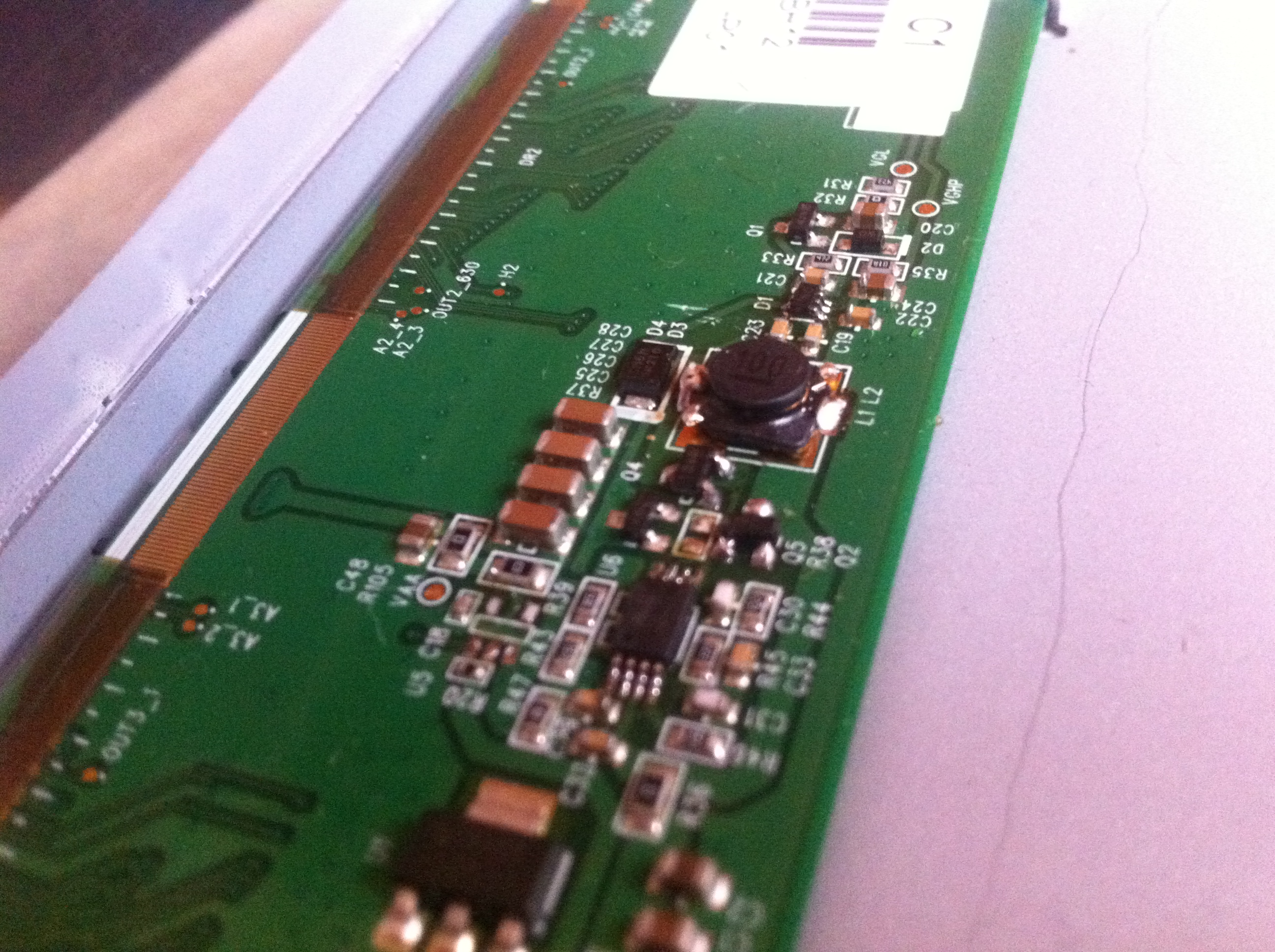

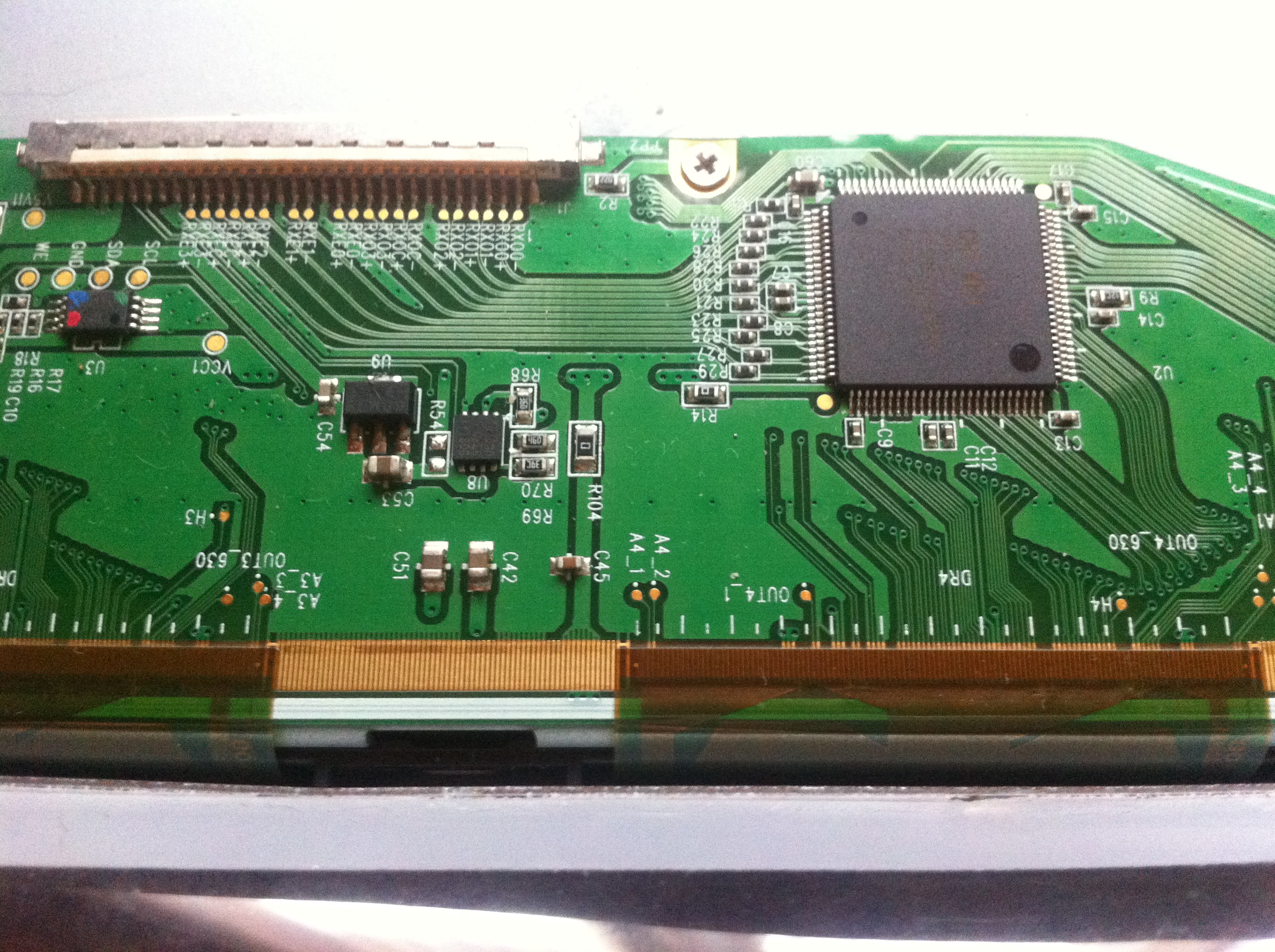

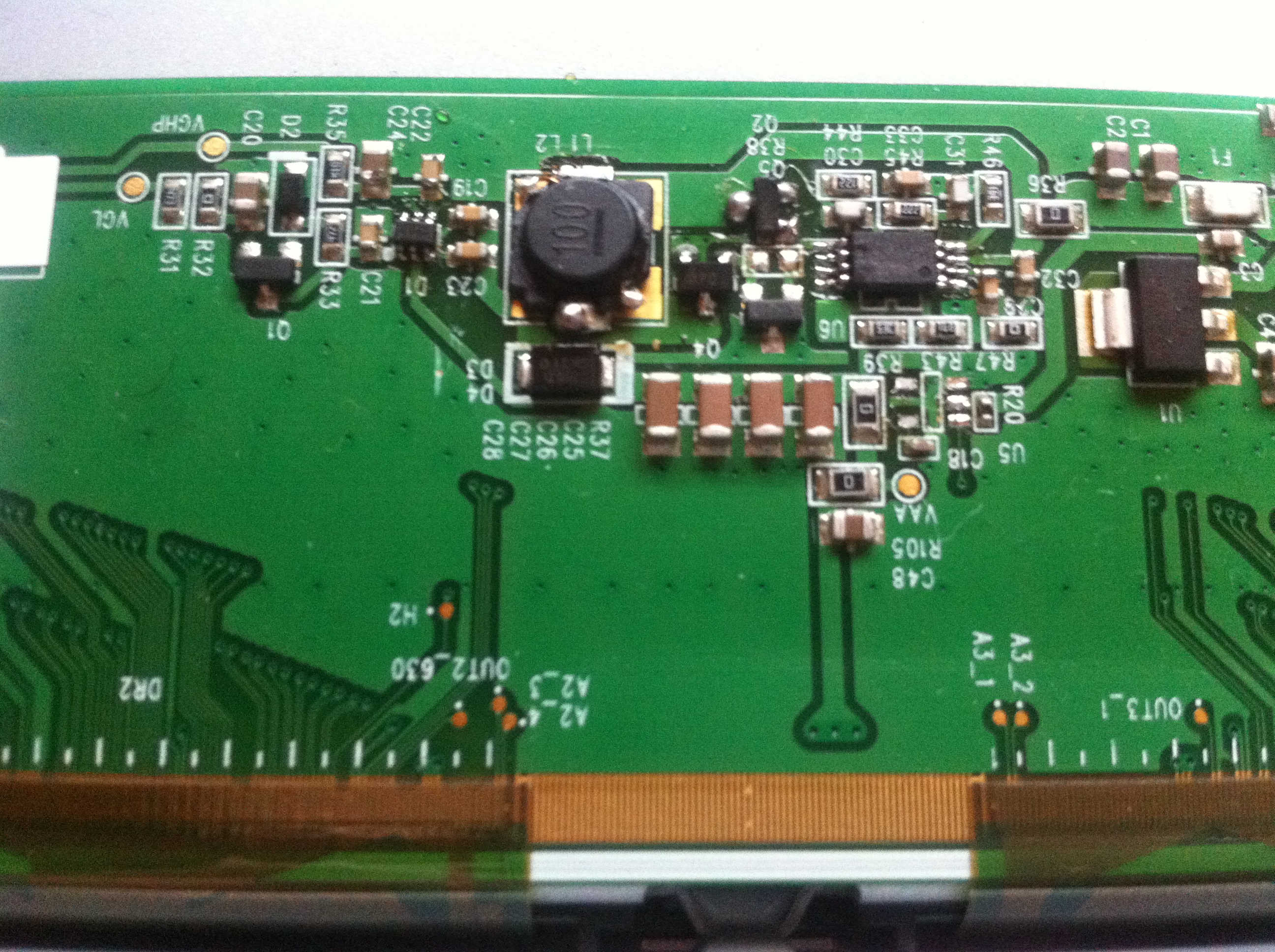

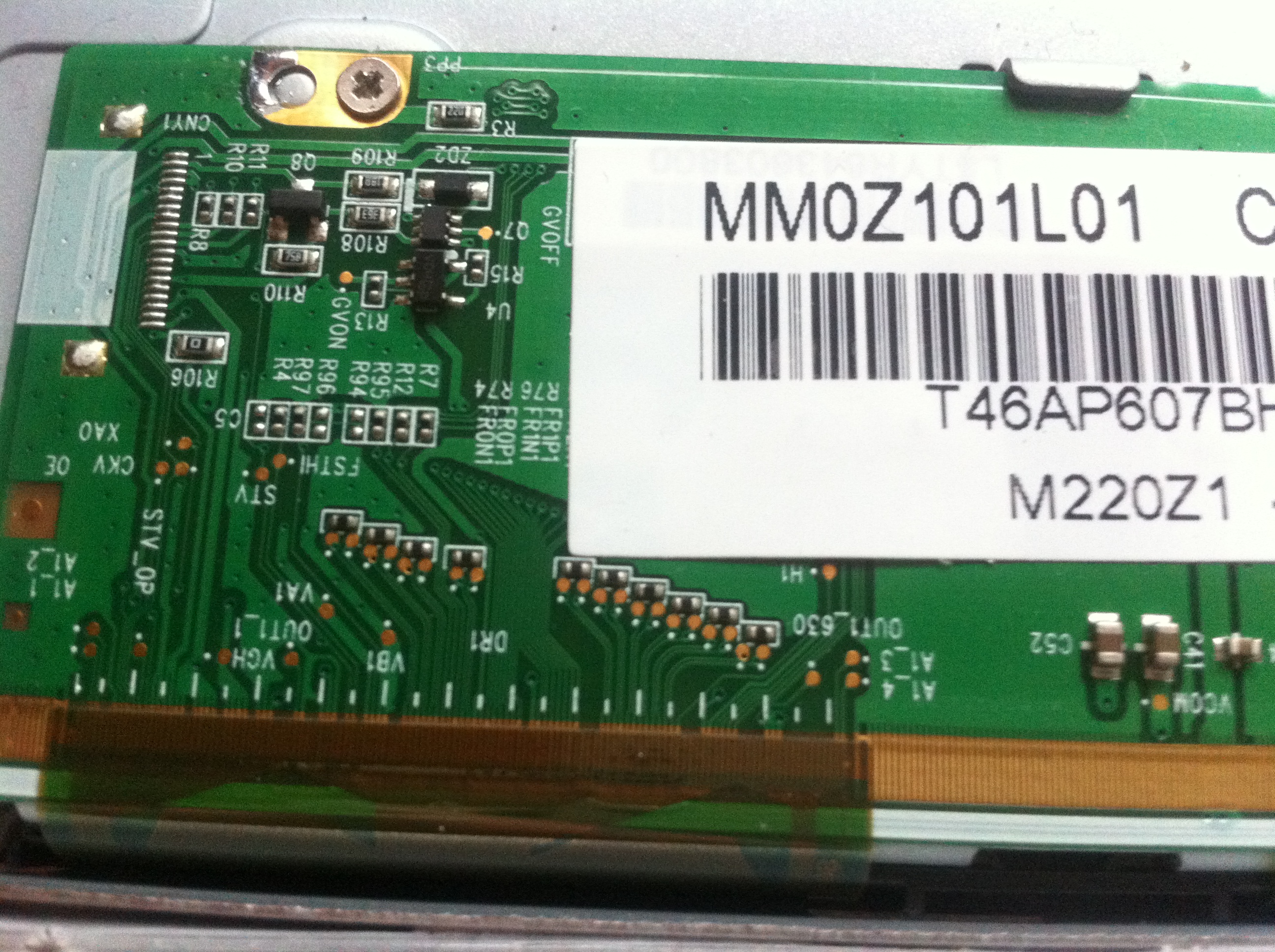

                                      It looks like the T-CON board on the LCD panel is dead due to not getting the power from the main board, the connector (LVDS) is not installed corectly, blown fuse on the T-CON. Please recheck your works.
                                      • 0burn0
                                        • May 2014
                                        • 16
                                        • Serbia
                                        here is panel psb screenshot's
